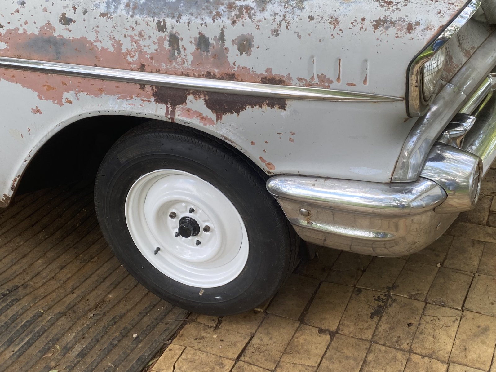

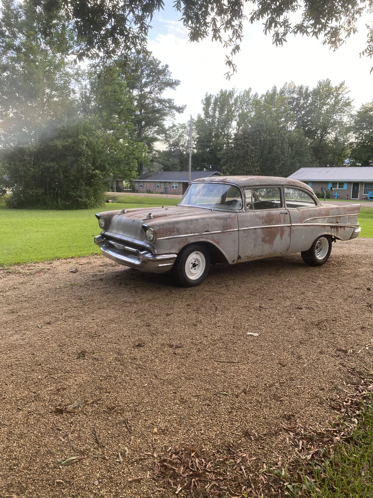

  2. Mitchell Rish
    Joined: Jun 10, 2007
    Posts: 2,335
    Mitchell Rish
    from Houston MS

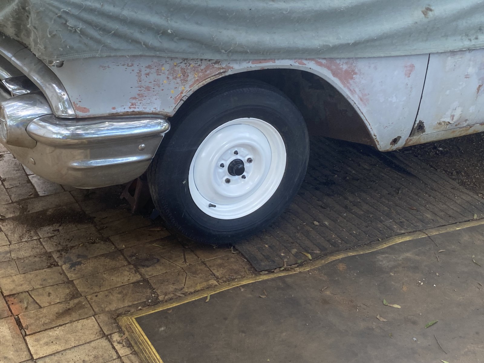

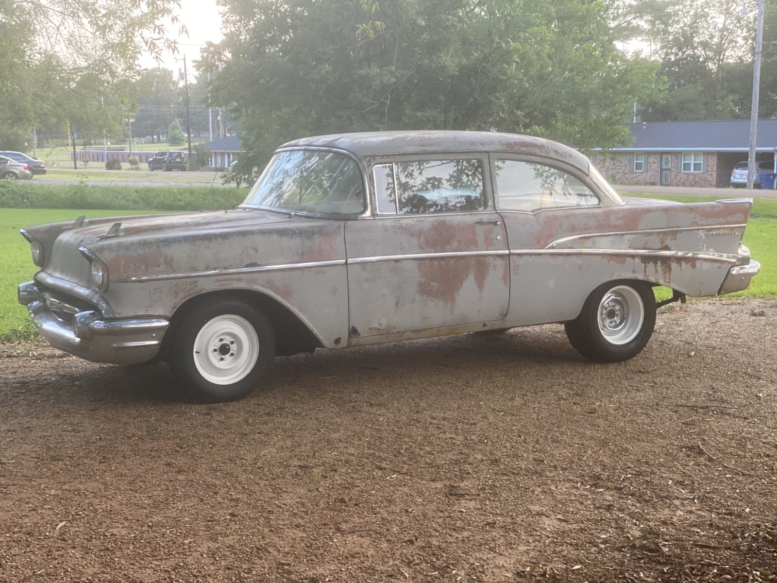

    Again thank you and still gotta get front disc on and exhuast.

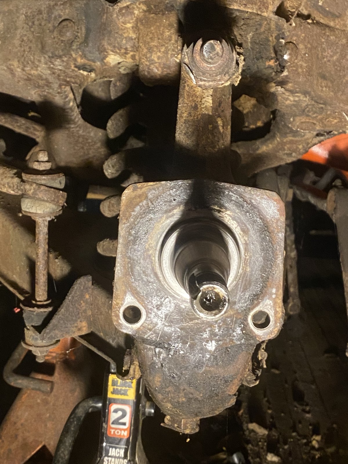

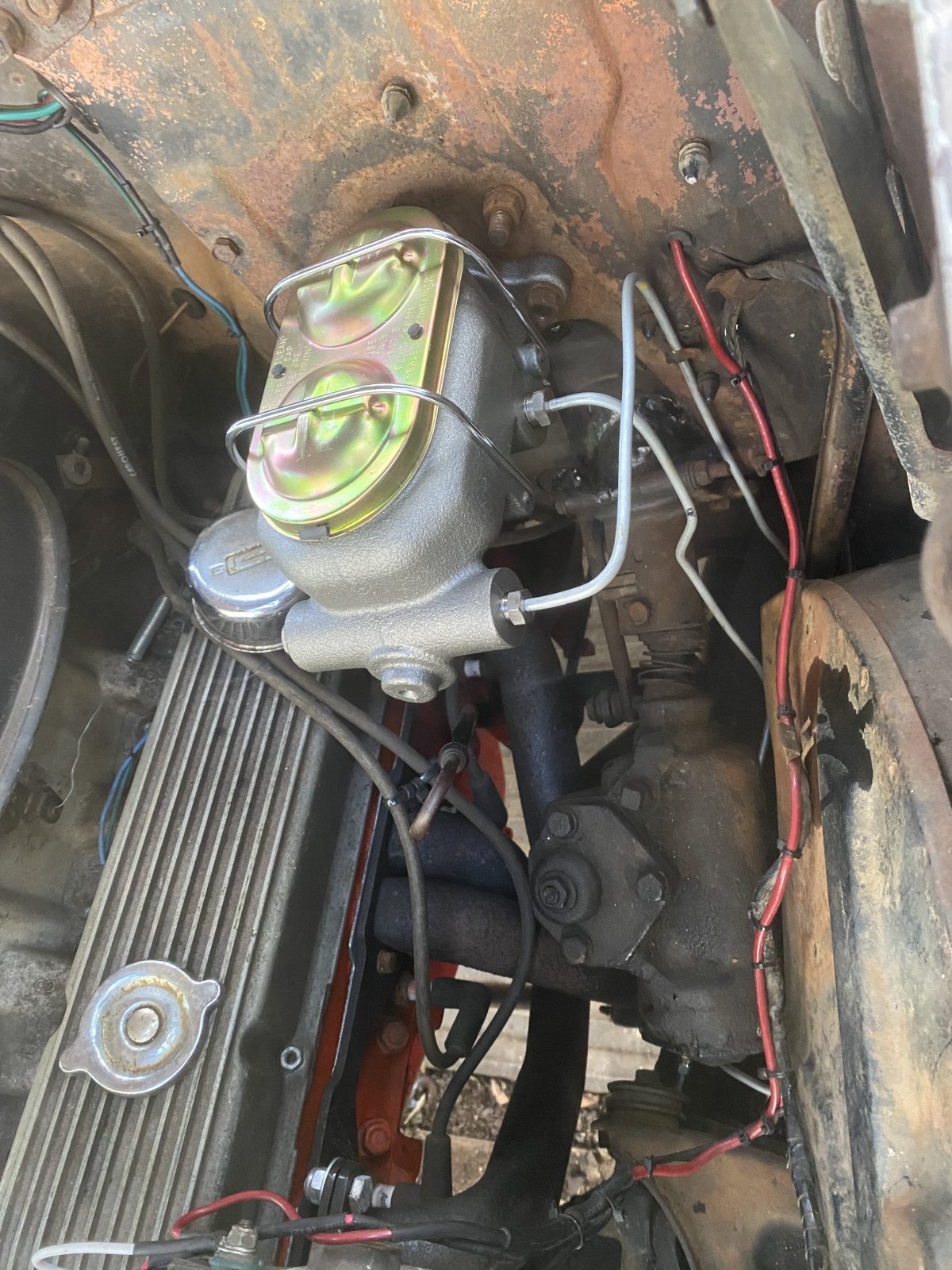

  4. Mitchell Rish
    Posts: 2,335
    Mitchell Rish
    from Houston MS

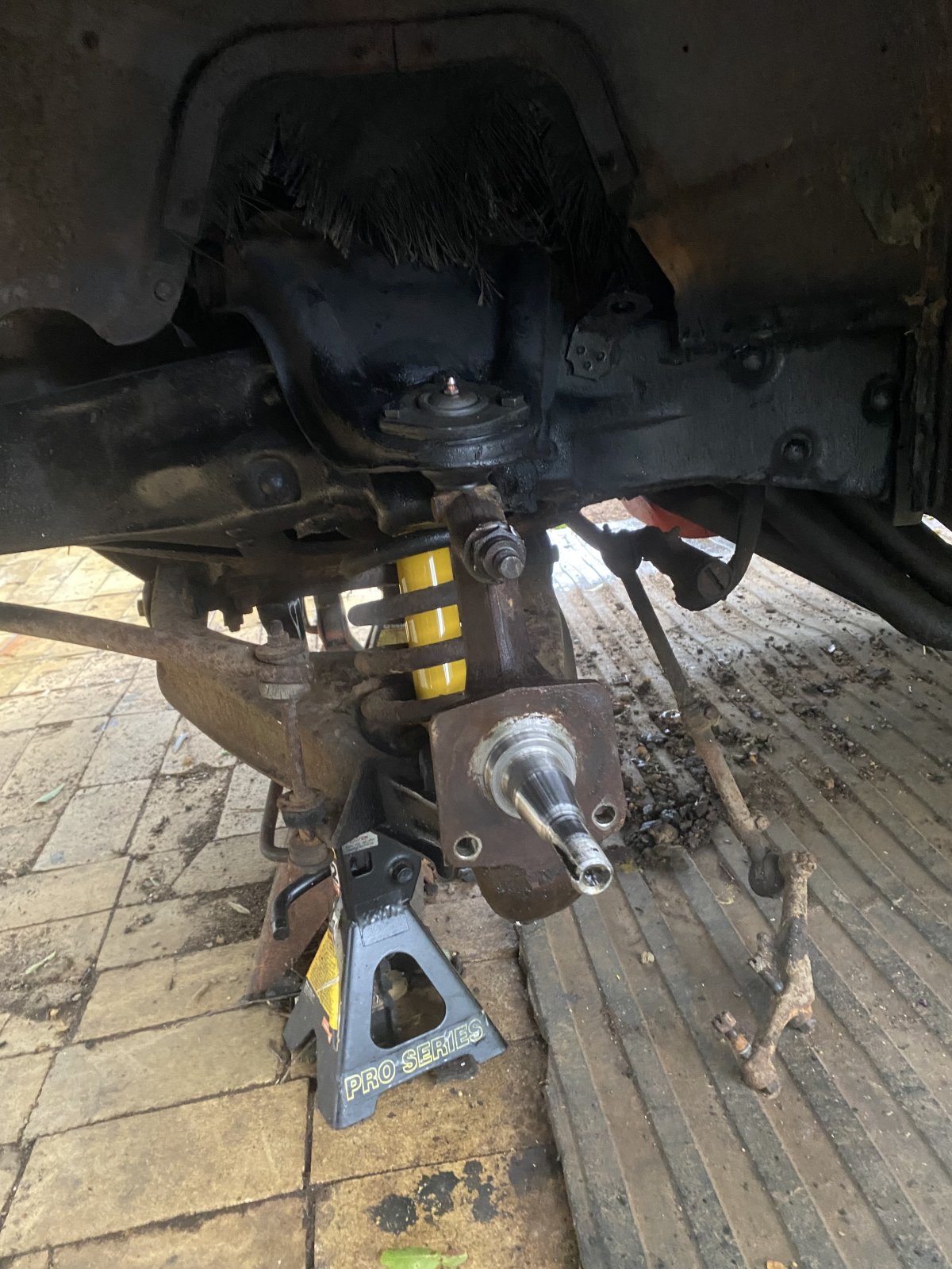

    And it begins.
    Stripping the front end down to do ball joints /shocks / bearings and brakes. Got a question. Why would the driver side spindle backing plates bolts only have 2. And the passenger side have 4. Strange.to me. And I don’t remember this on other tri fives. Maybe I just over looked it. IMG_0818.jpeg IMG_0819.jpeg IMG_0825.jpeg IMG_0826.jpeg
    Thor1 likes this.
  5. Squablow
    Joined: Apr 26, 2005
    Posts: 18,451
    Squablow
    I think the 4 bolt ones were from '55 and they went to 2 bolt in '57, although I might have those backwards. I had a*****ty spindle on my '57 and replaced it with one from a '55 and ended up with the same thing, now one side has 4 bolts and one side has two, otherwise they were identical. I'm pretty sure the 4 bolt one came from a '55. I'm not sure what '56 had. You probably had one side swapped out sometime earlier in the car's life.
    Thor1 likes this.
  6. Mitchell Rish
    Posts: 2,335
    Mitchell Rish
    from Houston MS
    Gotcha. Makes sense. I just had never paid attention. With the dual m/c I am installing /I am going to disc front set up I have. Sorry but I like stopping. That just isn’t an option for me. My old 56 and all my old tri 5 trucks would stop decent but they were always a source of constant attention.

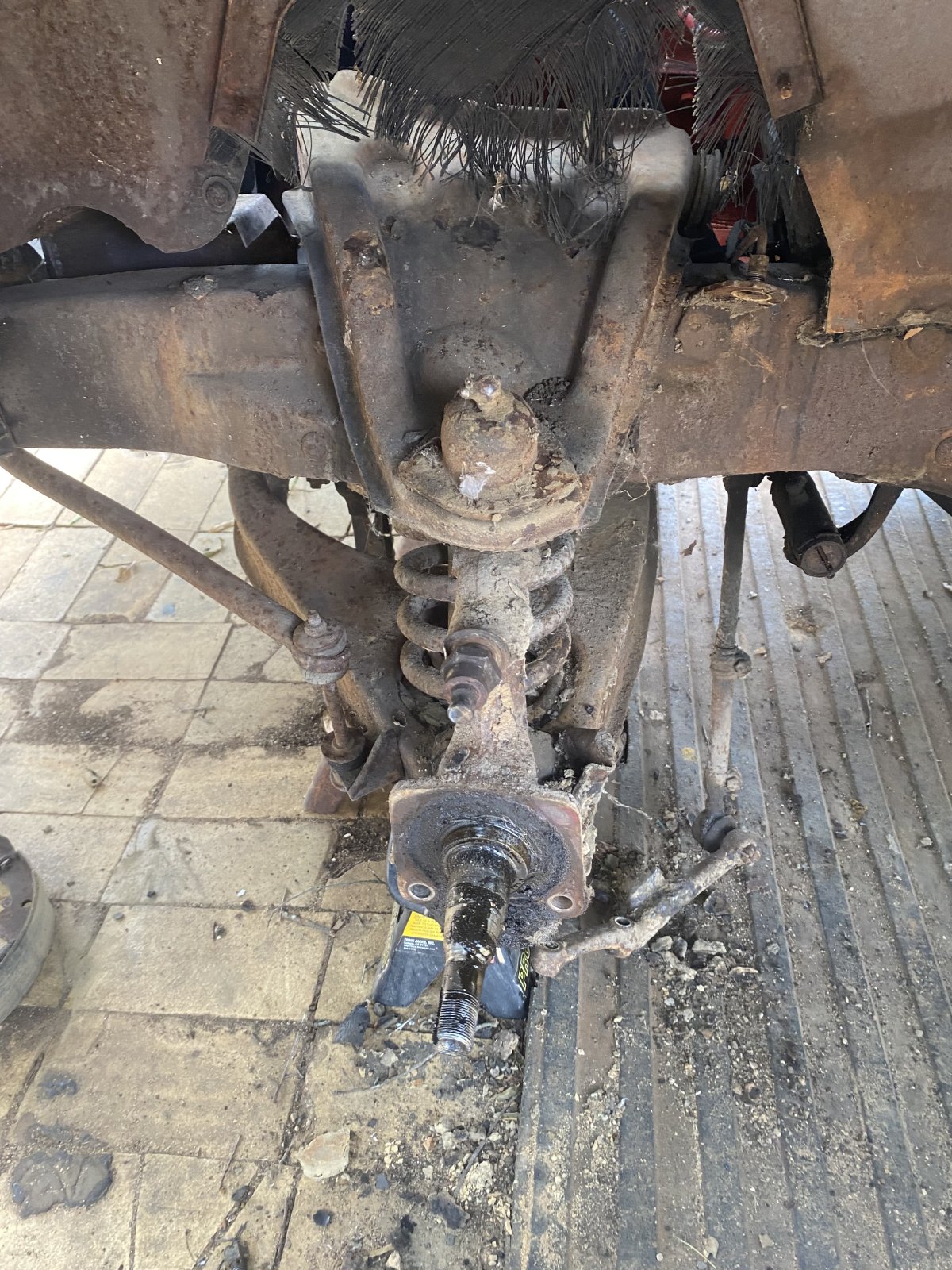

  7. Mitchell Rish
    Posts: 2,335
    Mitchell Rish
    from Houston MS
    Ok. When all else fails read the little yellow slip that NAPA put in the ball joint box.
    Ball joint on top. Rubber boot on the bottom. NOT whole thing from the top or bolted to bottom. And the rain sent me back in. Oh well at least I didn’t tear up any parts and caught it before I had it all back to get her. IMG_0830.jpeg IMG_0829.jpeg
    SS327, brEad, Thor1 and 2 others like this.

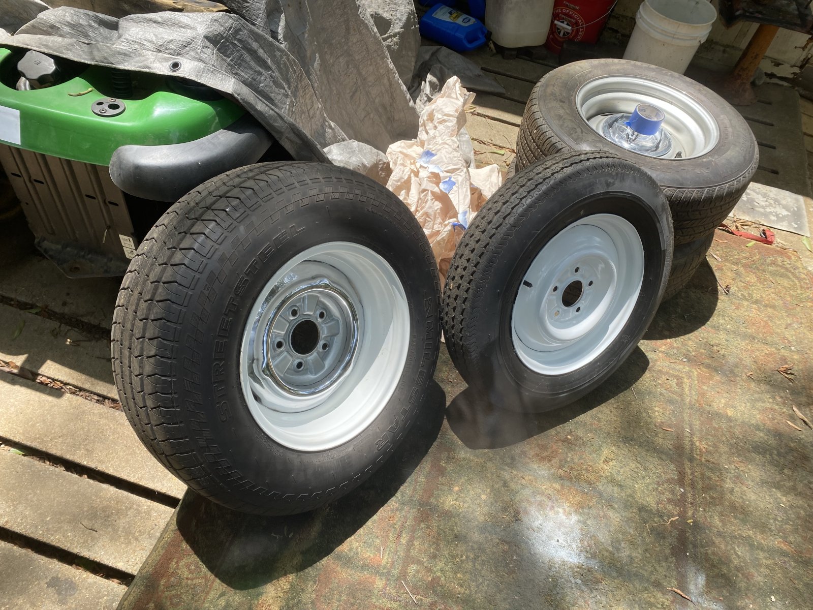

  8. Mitchell Rish
    Posts: 2,335
    Mitchell Rish
    from Houston MS

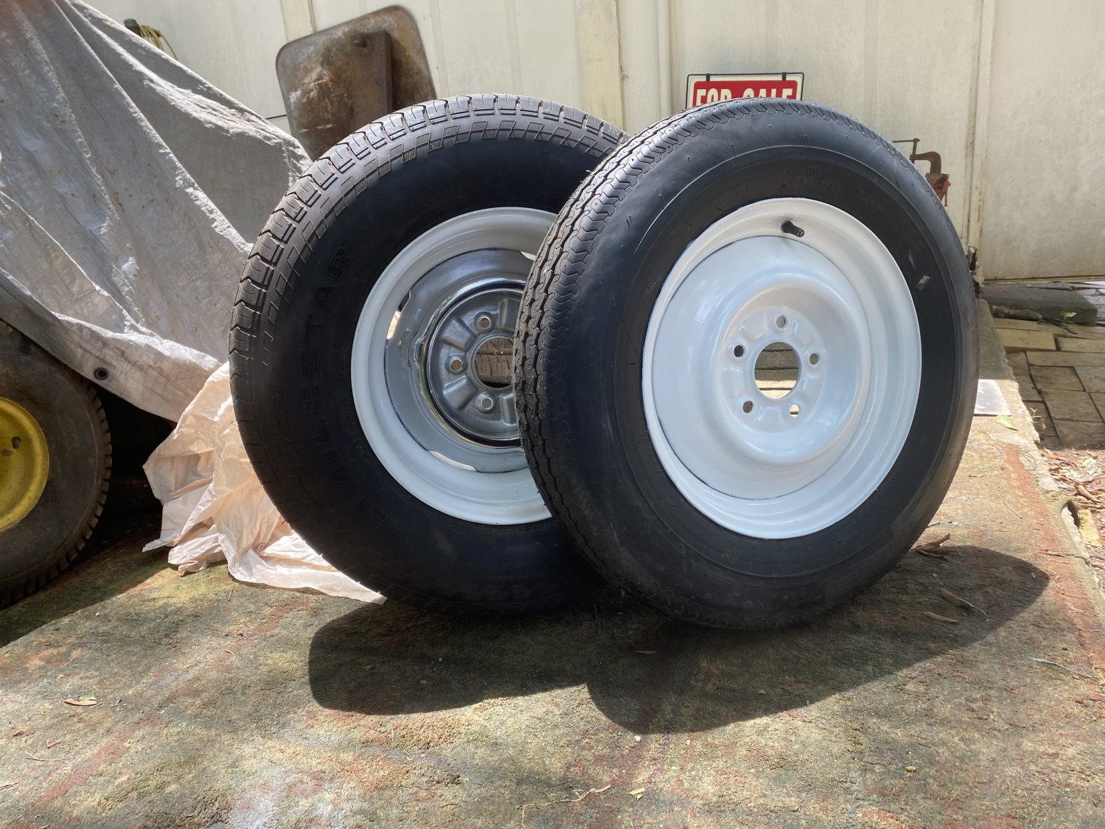

    Ok so the rain is back. Not complaining it cooled things off.

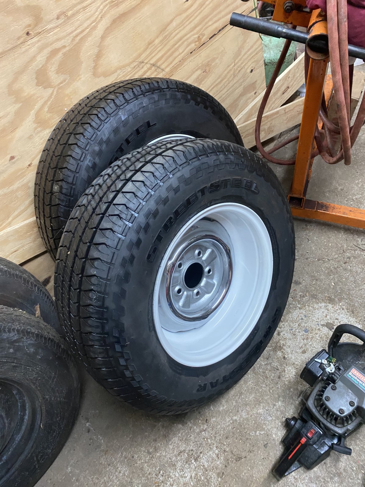

    Also meant I just took my other rear wheels and mounted some 235s on em. When I paint the front narrow steelies( 4 wide) it’s gonna make the look it think. I have a set of 7 inch rallies like the short centers to match what’s on but I am not certain I am going to leave those on. I also have another set of 6 inch steels stock to match these. They were almost dead on balance wise and his machine said they were as good as any he had seen. When it stops raining might get a chance tonight. If not no matter there is always tomorrow IMG_0834.jpeg IMG_0833.jpeg
    brEad, Squablow and Thor1 like this.

    Wow those wheels turned out looking great, I'm in the same boat with a set of 16 inch wheels that I'm needing to replace the outer part of the wheels [little crusty] and then have them rechromed. Congratulation on your retirement hope you have more time to work on projects

  13. Mitchell Rish
    Posts: 2,335
    Mitchell Rish
    from Houston MS

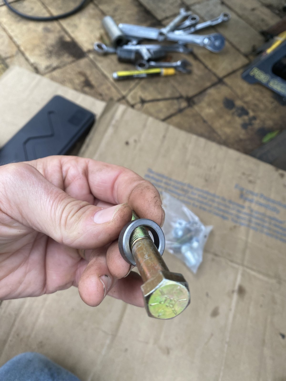

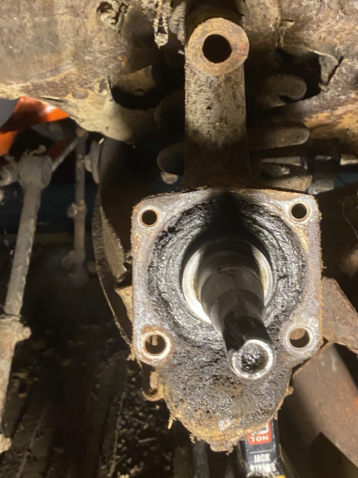

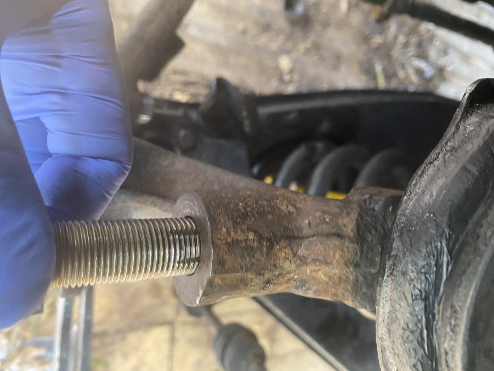

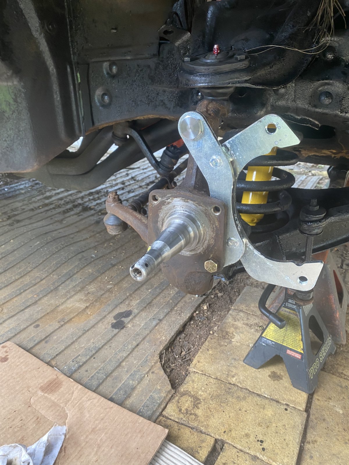

    Ok. Caliper brackets on. Kinda. I’ve used some kits from this company before but two warnings.
    1. The hardware( bolts ) are not shouldered like the originals. And yes the originals will work and they even have a hole for a cotter pin.
    2. The spacer they sent for the steering arm leaves much to be desired.
    I think I’ll hit the hardware/machine shop and look for a specific washer/spacer that is 1/4 thick and fits the bolt exact. I think I had rather have a set of washers that fit right than a price of pipe/tubbing cut like that.
    I am pretty ticky about the small details. It’s never failed me. IMG_0849.jpeg IMG_0848.jpeg

    I don't blame you, that hardware looks pretty sketchy. Hopefully the rest of the parts are better engineered than that.

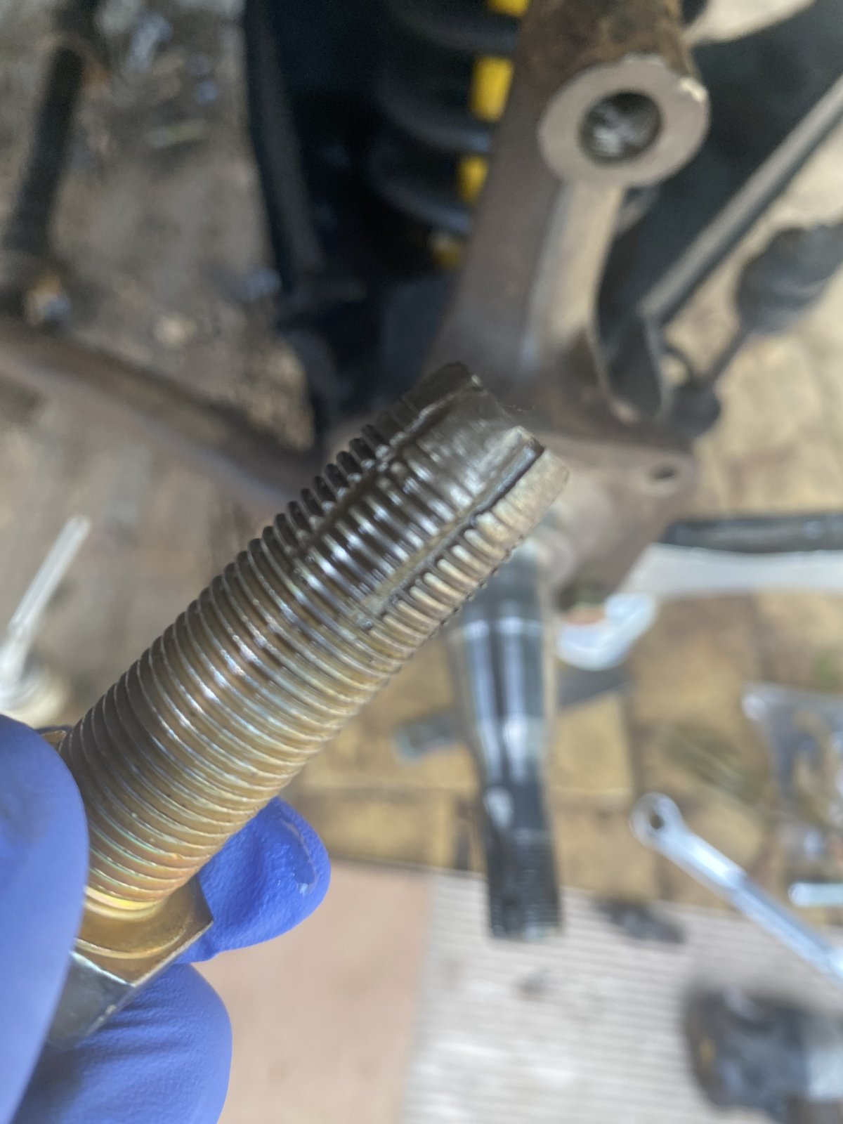

    Second side fighting every step. Had to make a thread chaser/tap. Used to do it all the time when I didn’t have many tools. . And the hardware on this disc brake kit*****s.
    I am not at the river today so I didn’t have all of my machine shop access that I normally would. Farmers and loggers know this trick by heart. Did I mention the hardware speaks chinesium. Dont 71079012078__D24E3169-322E-4CA2-AA93-63A0B9DC4FC3.jpeg IMG_0878.jpeg give me any grief. My son in law was born there. But by grace of God we converted him early on as a child. Or I wouldn’t have given my blessing

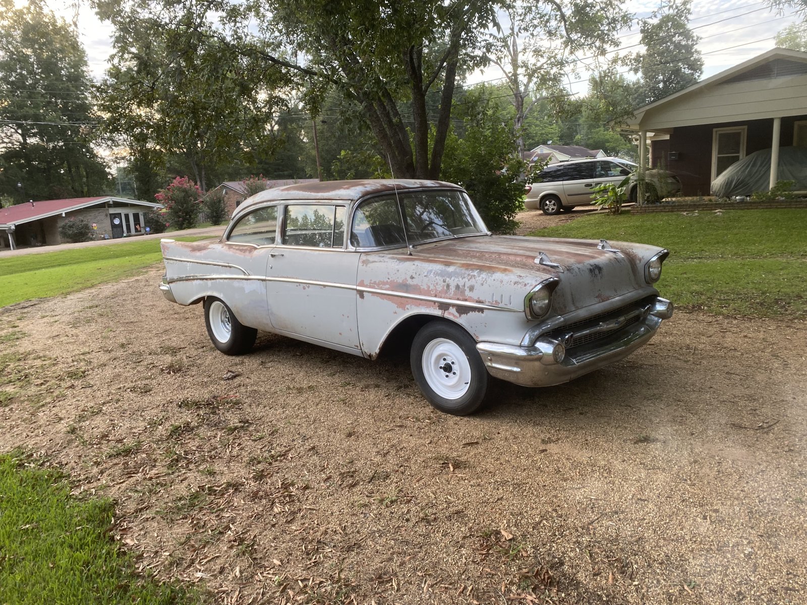

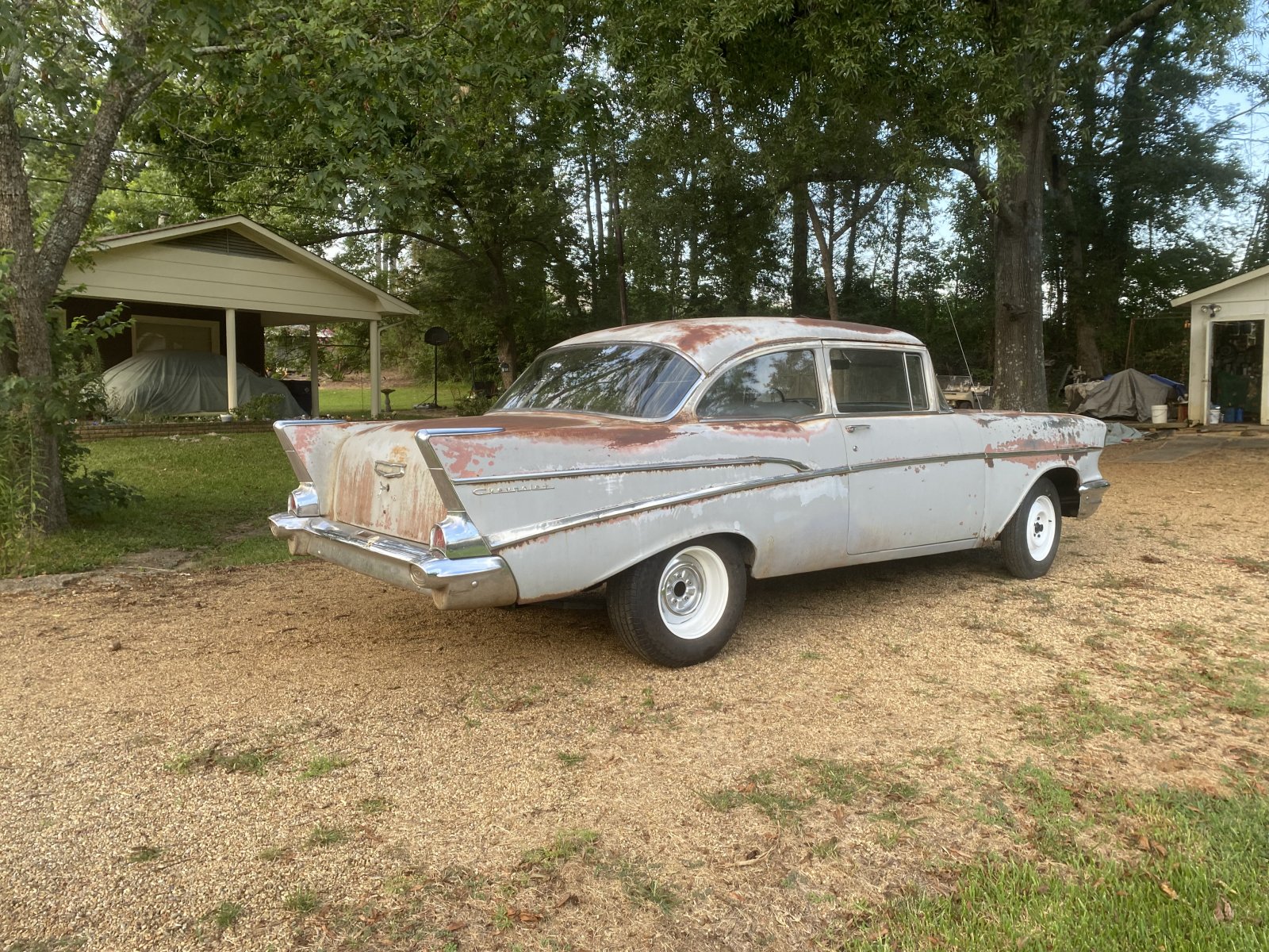

    IMG_0881.jpeg IMG_0883.jpeg IMG_0886.jpeg Ok. So this is the results. I left the calipers off until I get ready to run brake lines etc. I am not sure I like the way the wheels sit. They are 4 inches from the fender lip. Yes they are 4 wide but I really think the 6 wide will look better. 7 will clear the 8s will not. This kit widened the track 3/4 of an inch according to the instructions.
    The factory wheel was a 5 wide X 14 I think. 55-56 were 15s. And I gotta find a set.

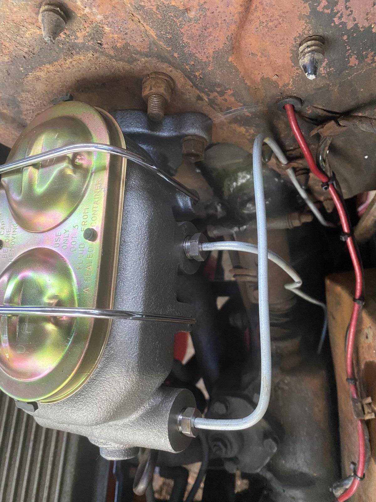

    Brakes on. Pedal feels decent. Disc front drums back. Prop valve leaked but after checking top valve nut it was loose from factory. All good now.
    Gravity bled for a few hours /but will pressure bleed as well later. Time for a tire/wheel change.

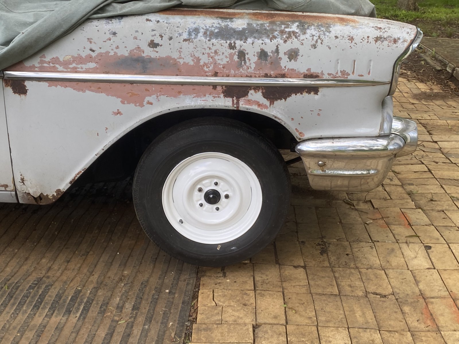

    IMG_1030.jpeg IMG_1031.jpeg IMG_1032.jpeg IMG_1033.jpeg IMG_1034.jpeg IMG_1036.jpeg IMG_1035.jpeg IMG_1037.jpeg IMG_1035.jpeg IMG_1037.jpeg IMG_1039.jpeg IMG_1038.jpeg Ok. Brakes are acceptable. Took it for a short spin today. Didn’t get into 4th was just kinda creeping around the block so to speak. Open headers and all. Was kinda fun annoying one of the neighbors.
    Even the Muncie with the 2.52 has a really close ratio. 3:55 rear gear is ok. I am still a 4:11 guy at heart. I like instant whiplash effects. But that pretty much kills anything over 60 mph so I’ll live with it. Still got a ton to do.
    This damn heater core and I are fixing to go a round. Tiny leak. And only sometimes. Figure I will need defrost per say.
    Still need to do headlight relays. ( they all work perfect but I don’t want to over load switches.)
    Little things.
    the tires and wheels look decent but
    I still think I am going to a wider front wheel and tire. I just don’t think the front runners will survive on the street. I also have to hook up front torsion bar. Don’t know what it came off of but Wes picked a perfect one.

    Looks good, I kinda like the skinny tires up front. A few longer test drives will determine how they feel though. Should be easy to steer/park at least. The rest of the car looked white before those wheels went on! Front sway bar makes a world of difference on these things, I put an Addco one on the front of my car this spring and I was shocked at the handling difference.

    These are 5x15L tires. Not rated for much in speed or load. I can get some of those VW radials and as I always do turn the white walls /letters inside.
