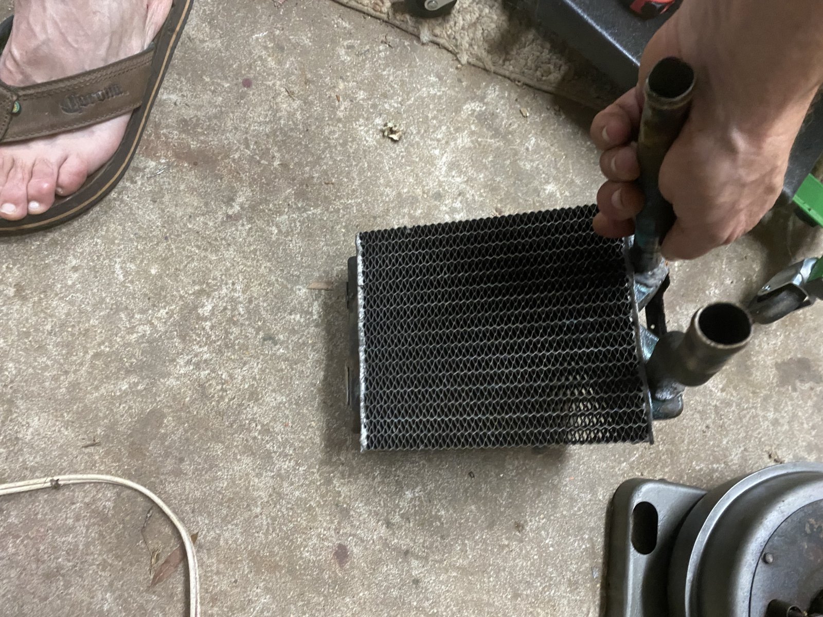

  3. Mitchell Rish
    Joined: Jun 10, 2007
    Posts: 2,335
    Mitchell Rish
    from Houston MS
    Got it out. I put 25 psi to it in a soap vat. Short of recoring it’s gone. I am looking for a later design heater core that will swap out. And a cheaper one too. IMG_1044.jpeg IMG_1045.jpeg IMG_1046.jpeg IMG_1047.jpeg

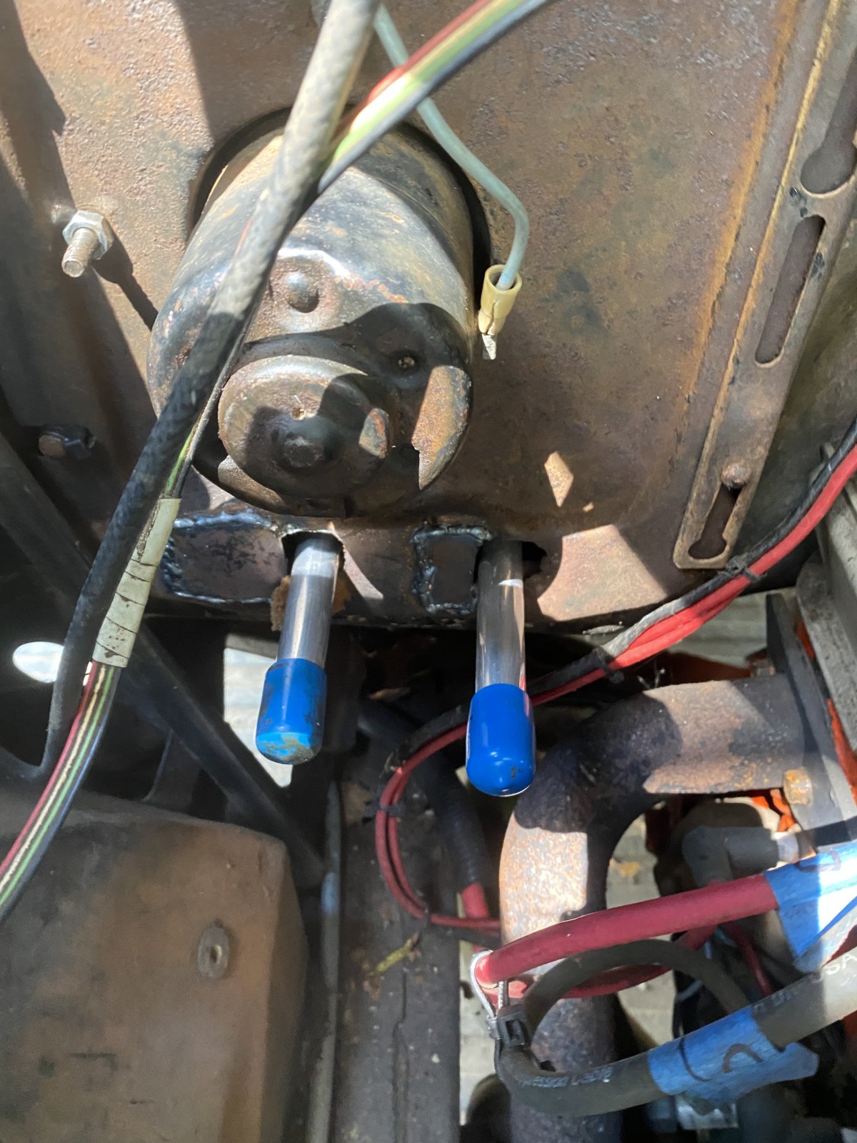

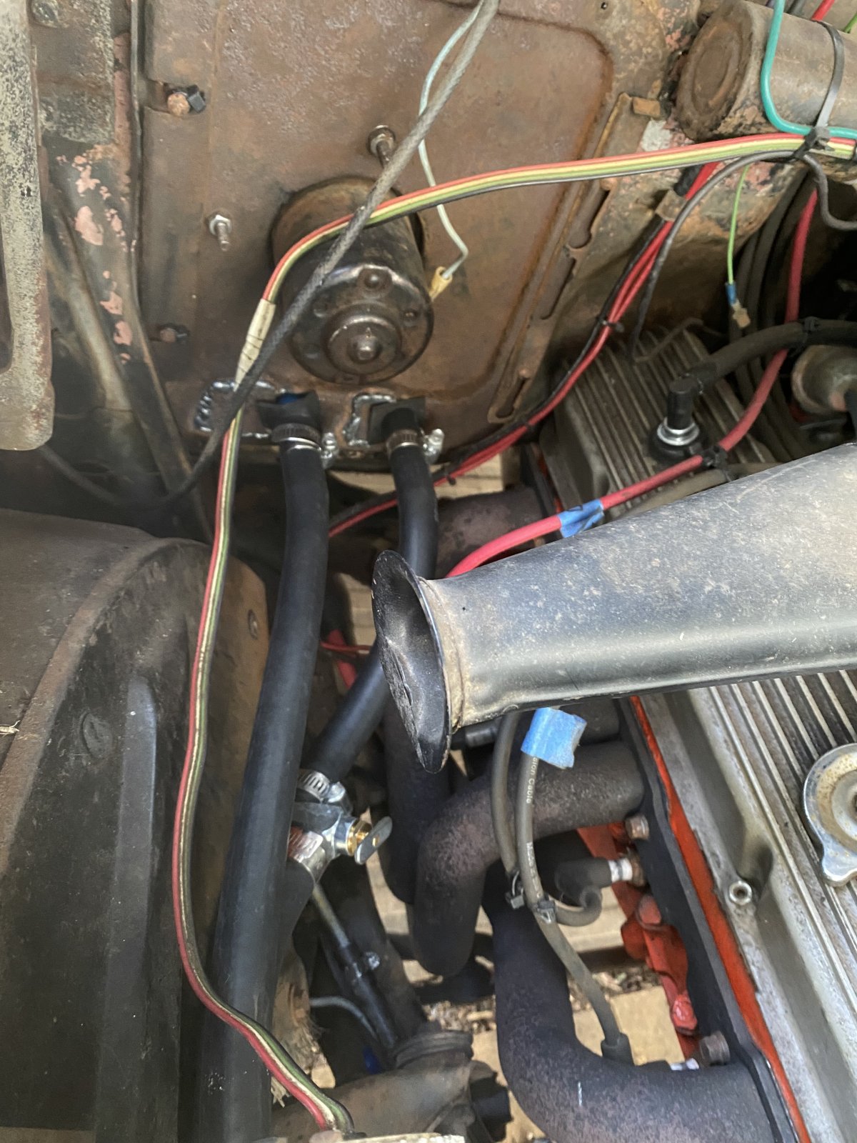

    Under hood view. Even with 100 degrees today I let it run and get to temp. Still blows hotter than the outside air.Mick tells me I am strange. Lol. I put a manual cut off valve in the 3/4 hose. Used it to step down to the 5/8. Can’t tell it by looking. After it ran through a cycle. No leaks. Now to deal with the rear seal leak on the Muncie. I have a ****er yoke to swap out also. If I remember there were some groves on the old one. IMG_1100.jpeg
    chryslerfan55, brEad, Thor1 and 4 others like this.

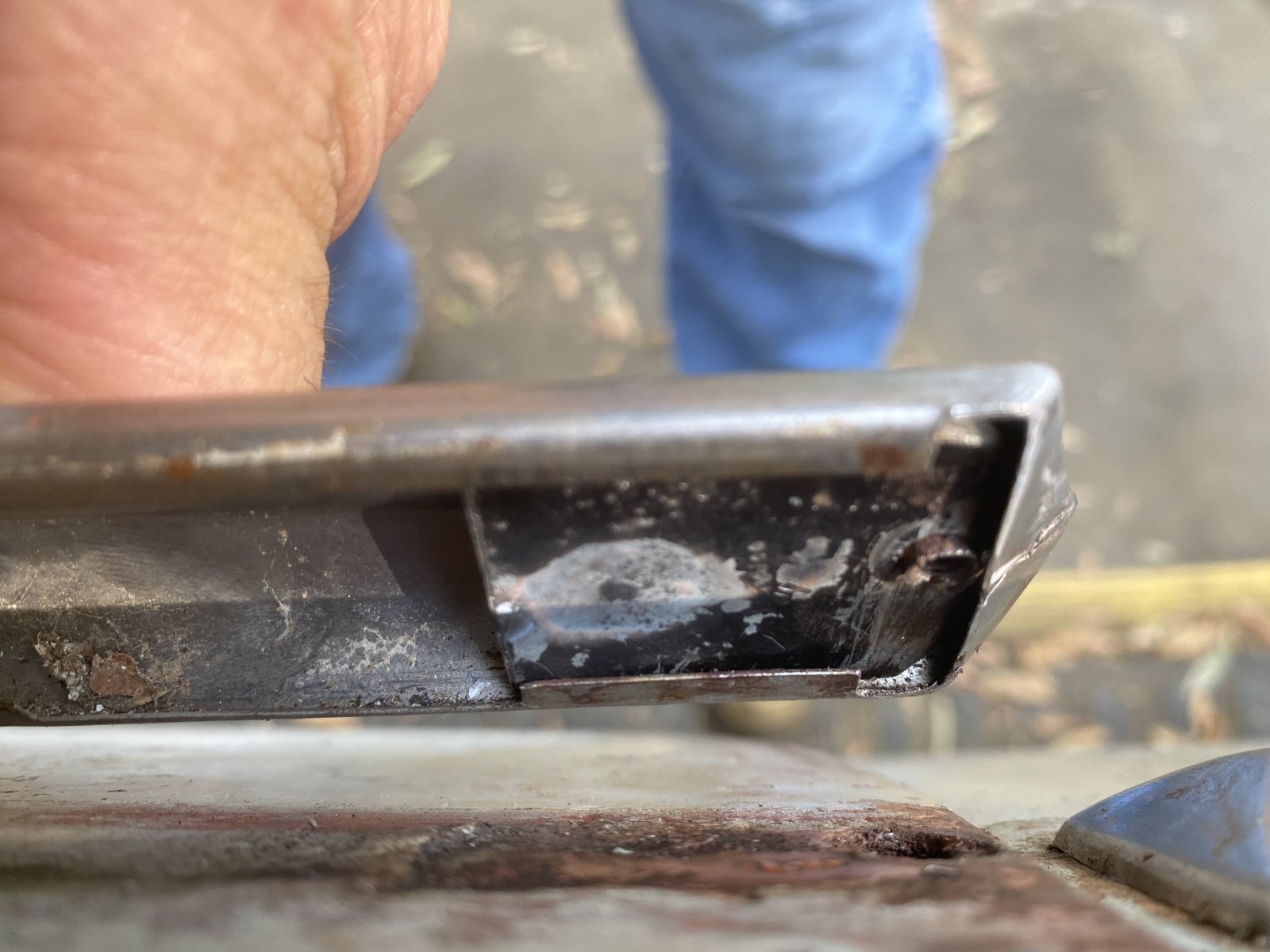

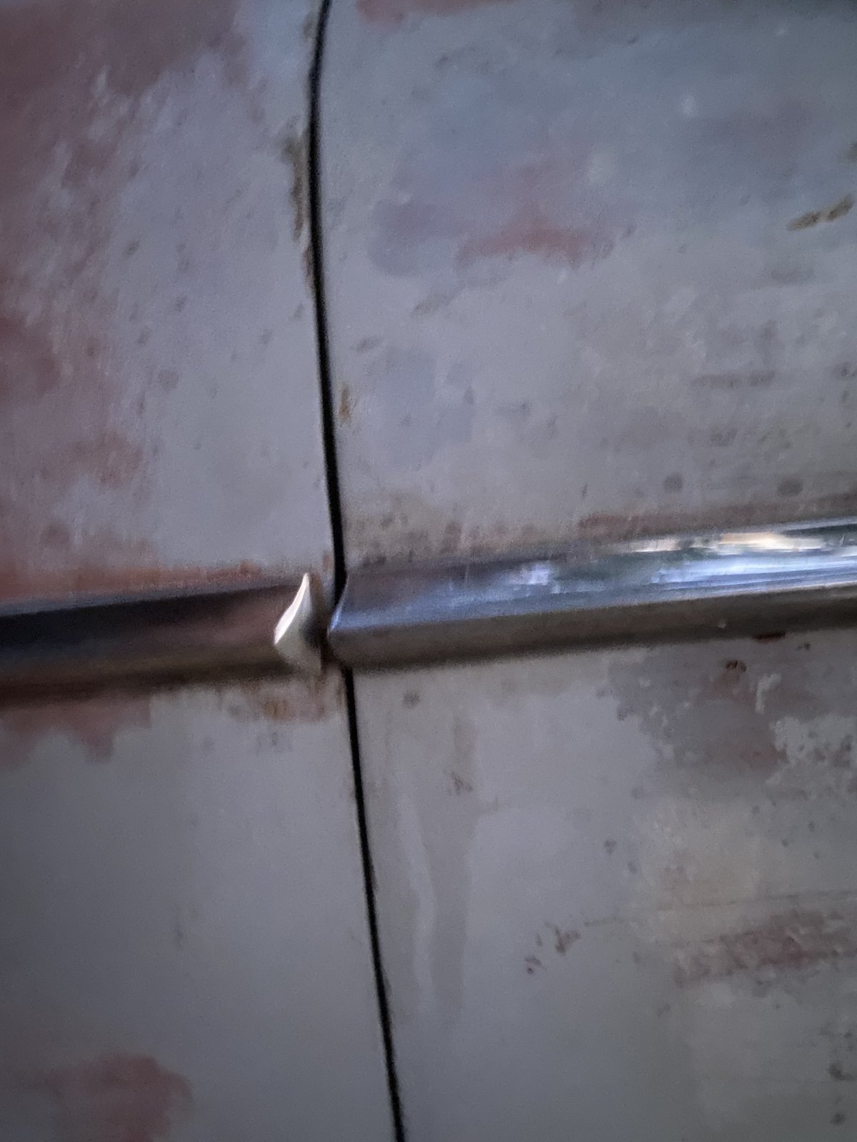

    Ok. Need some of you 57 guys to look in your spare parts/trim buckets and see if you have a single trim clip that holds the front of the trim on the 210 door. It looks like a dog tag and Its threaded for a single screw and no springs. The reason my front trim edge won’t sit perfect flush is that one clip is split. Only need that one
    I would be very gratefully.

    I just checked my stash and I've got none to offer. I've got a bunch of loose moldings but none have any clips left in them (they tend to rot away to nothing here in Wisconsin). I've got a drawer full of random trim clips too but none of that specific one in there. Wish I could help.

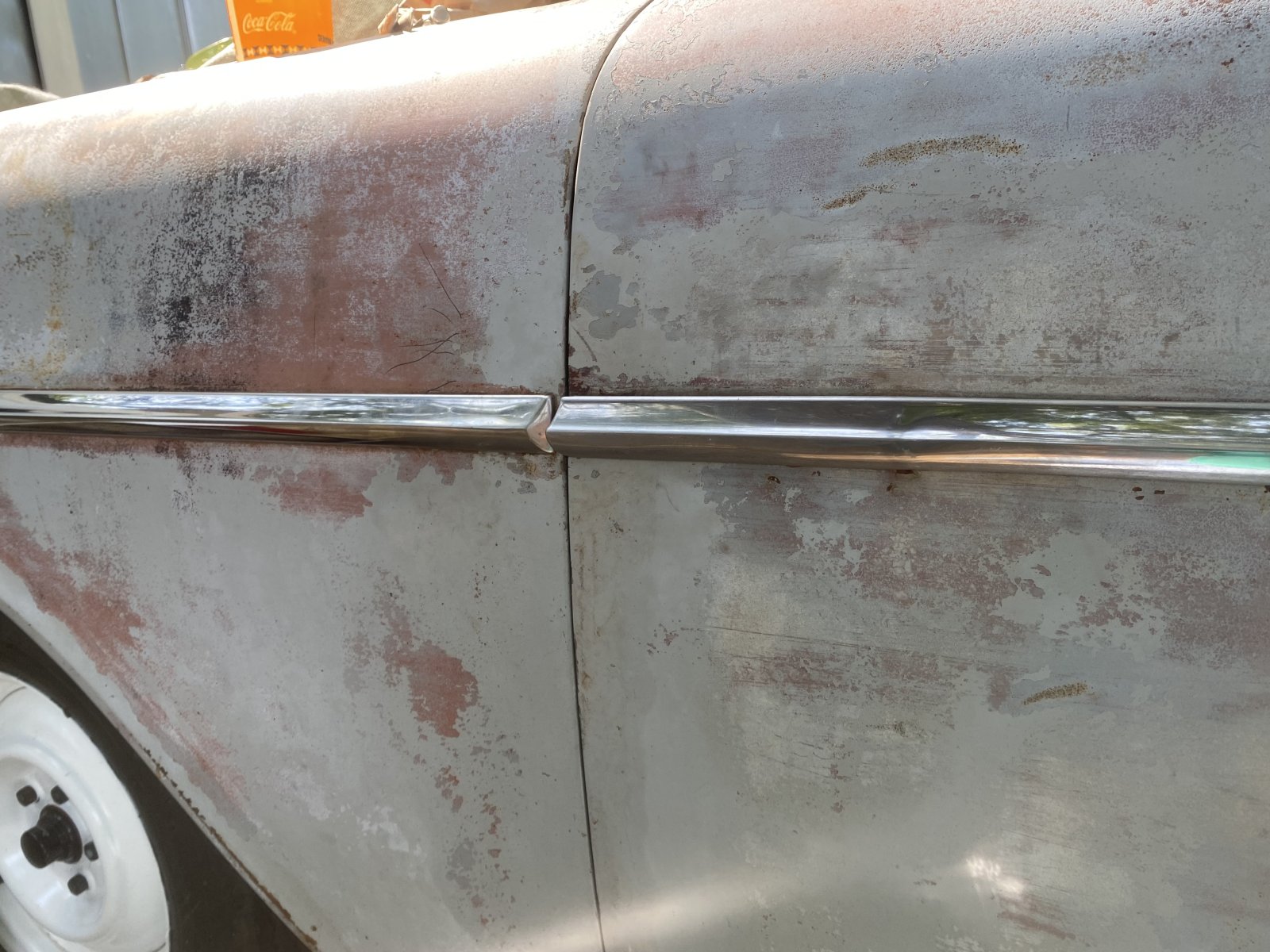

    It’s all good. I actually took it down and cut a piece of steel ( from a Chevy truck hood. ) and drilled a hole/ bolted the factory clip to it and spot welded it. Went to hardware and got some new 8-32 screws. Cut to length. All good
    Thanks for looking though. It wasn’t the cost it was just getting them here and only needed one. But it’s all good now. IMG_1109.jpeg IMG_1110.jpeg

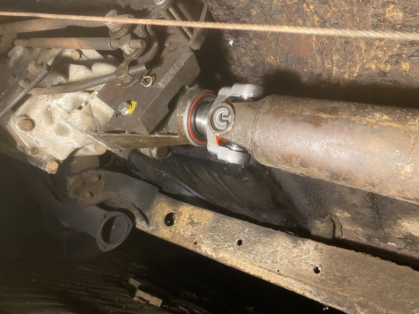

    New yoke on and rear seal in the Muncie. Back U joint was good so installed and called it. IMG_1113.jpeg IMG_1115.jpeg IMG_1114.jpeg

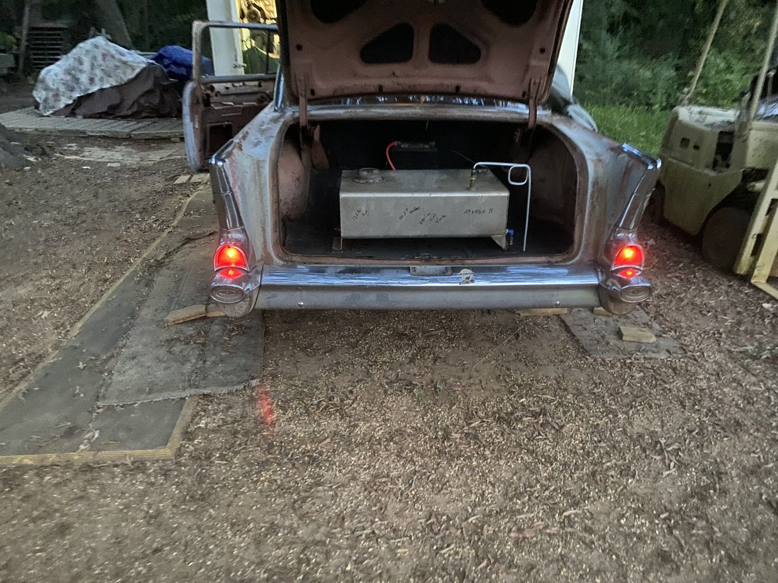

  13. Mitchell Rish
    Posts: 2,335
    Mitchell Rish
    from Houston MS

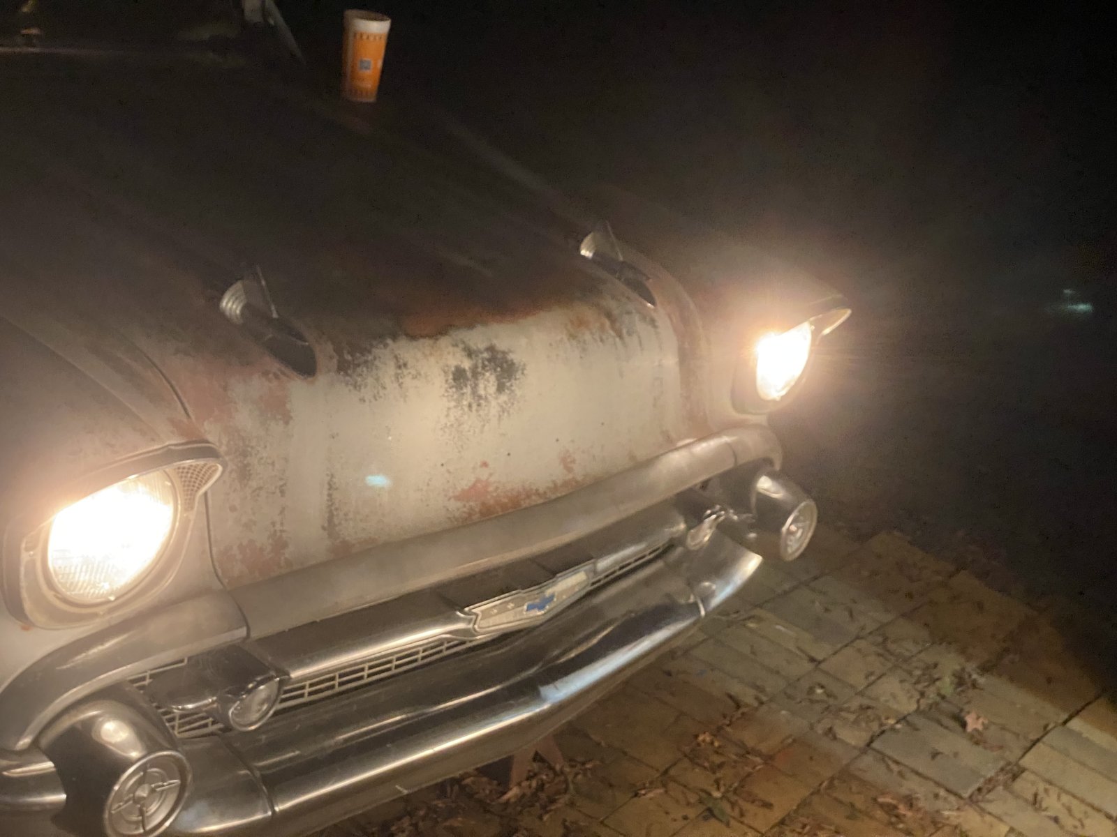

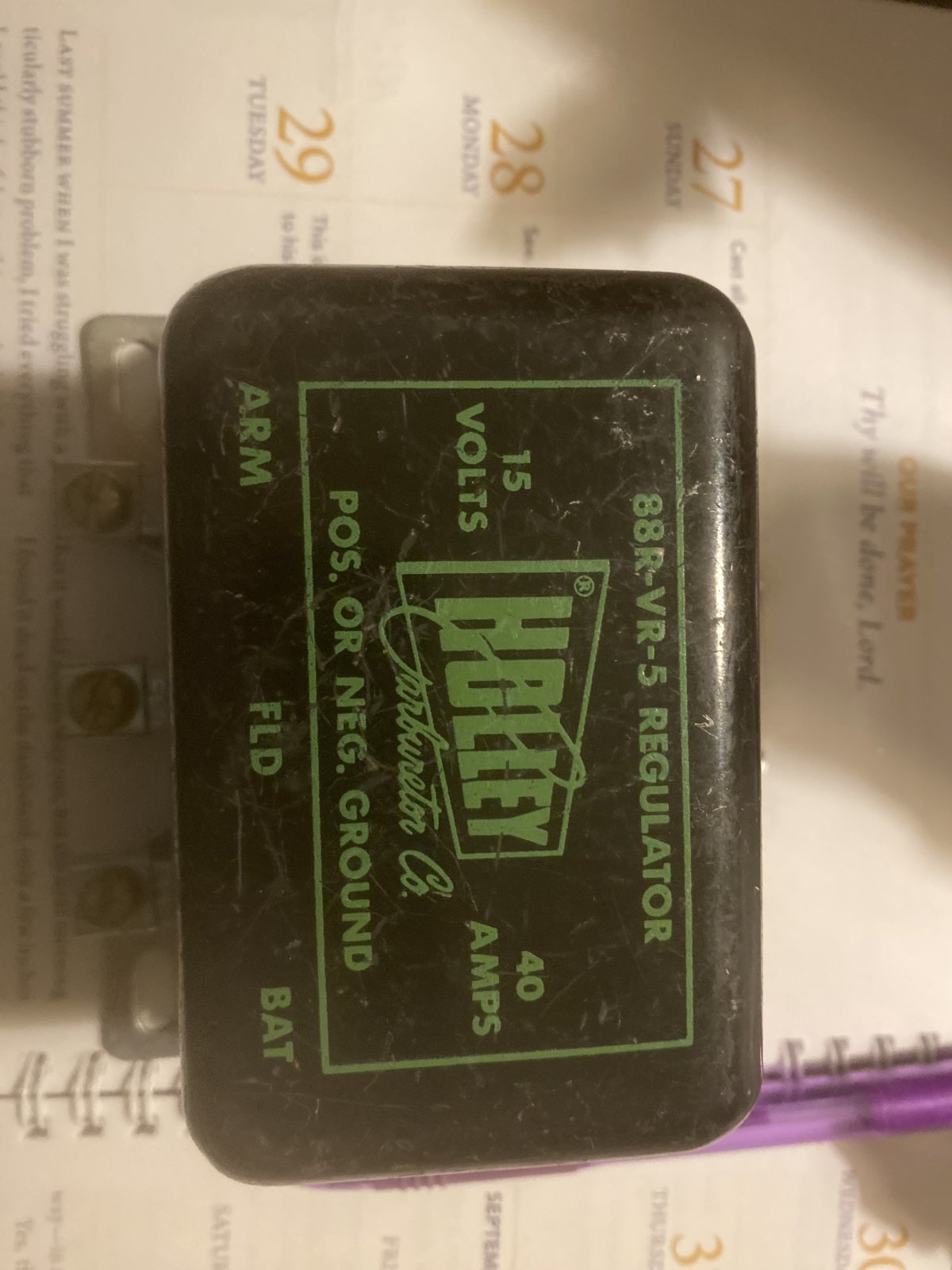

    Relays and harness modifications to headlights. Much better. Gonna use a voltage regulator cover to hide the relays. Need to find one of the big Delco Rem cover maybe like on big trucks etc. 3X2X 1 1/2 deep. IMG_1127.jpeg IMG_1128.jpeg 71513608020__B99188A2-7124-4A3B-8B8D-E2AC77E2DFE2.jpeg
    chryslerfan55, brEad, Thor1 and 2 others like this.

  15. Mitchell Rish
    Posts: 2,335
    Mitchell Rish
    from Houston MS

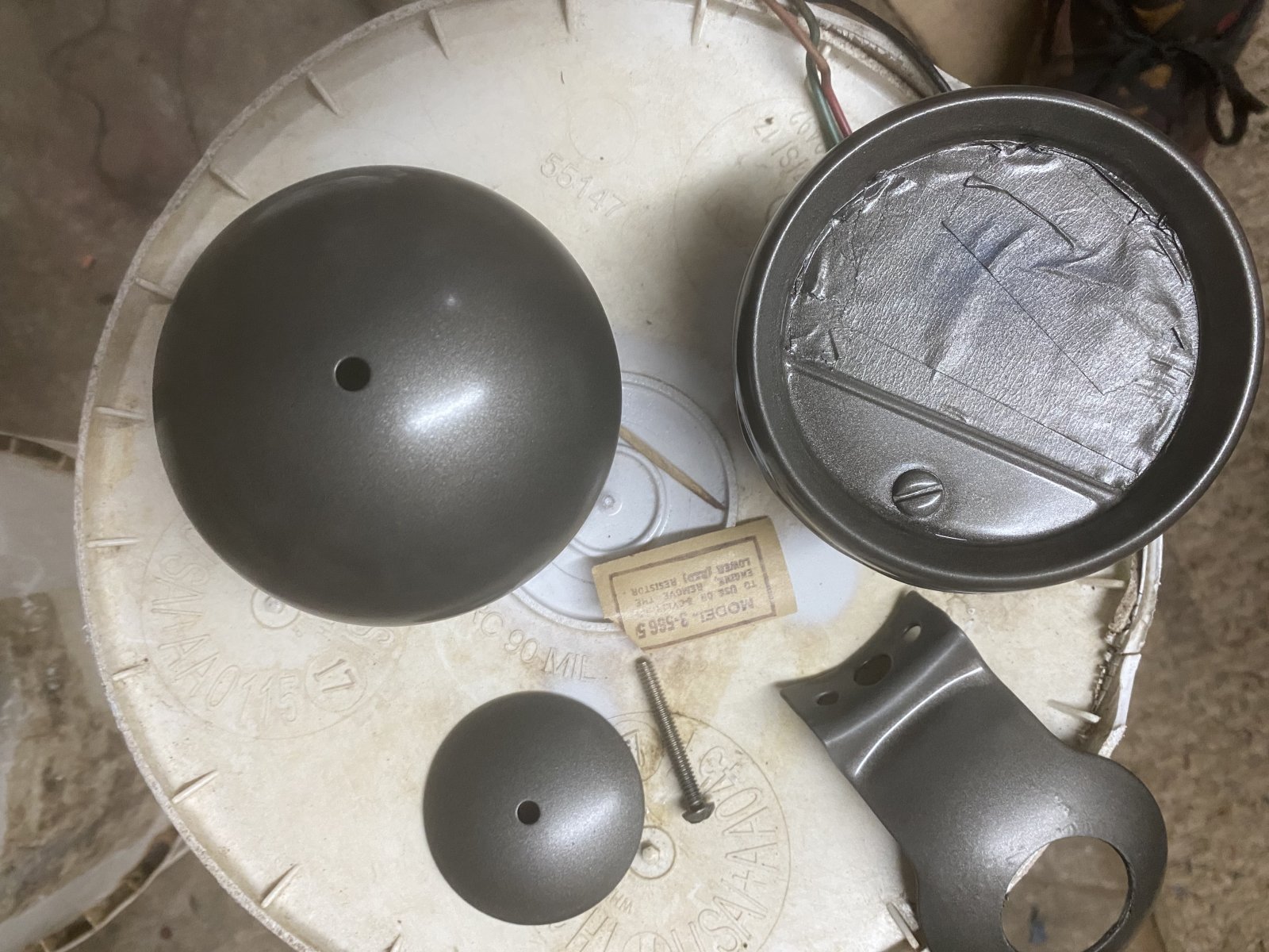

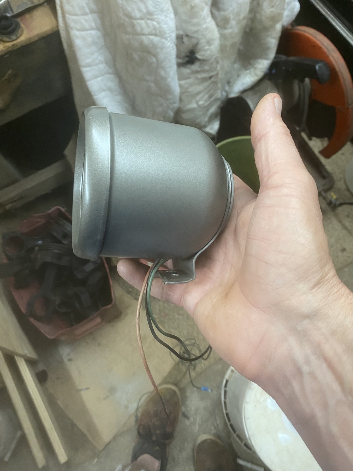

    I took a little time to clean up /attempt to polish the tach that Wes put in the 57 originally.
    Almost all of the rust was removed but after a lot of time trying to polish it ain’t gonna happen. Got the rust gone for the most part or as much as is possible - but the pits are there to stay.
    SO- I decided to paint it the color of the top of the dash and the bottom dash belt line.
    Remember the insert and column are a metallic silver so this should set off about right.Lens IMG_1181.jpeg IMG_1182.jpeg IMG_1183.jpeg IMG_1186.jpeg IMG_1187.jpeg IMG_1188.jpeg IMG_1189.jpeg cleaned up well enough.

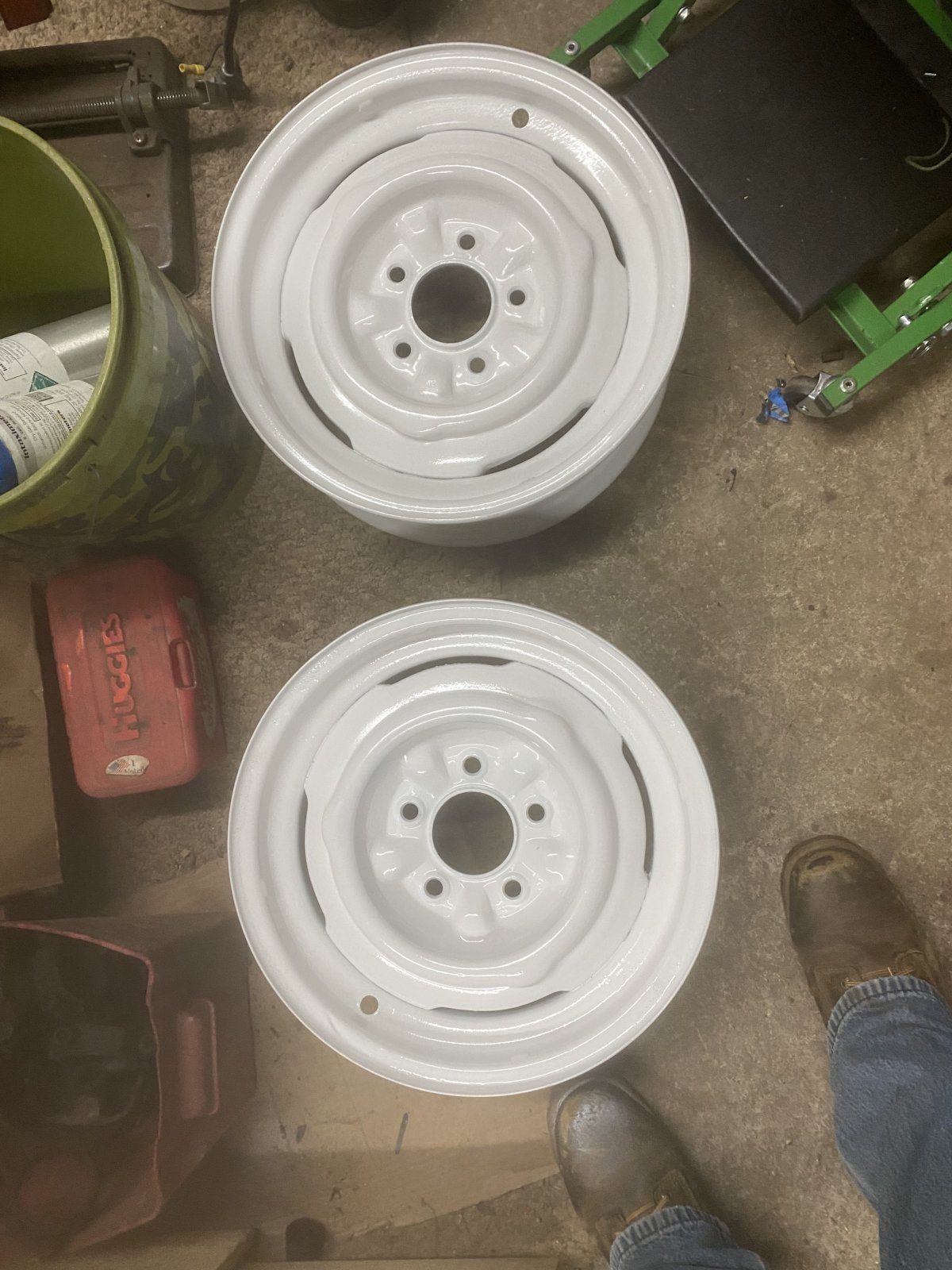

    Ok wheel showed up today. Welded up the holes they drilled for slicks. And painted to match the other one.
  19. squirrel
    Joined: Sep 23, 2004
    Posts: 59,848
    squirrel
    you're welcome! looks like a matched pair now....
  20. Squablow
    Joined: Apr 26, 2005
    Posts: 18,458
    Squablow
    Those will look good on there. Period correct, and just wide enough to put a bit more tire on there without being too wide.

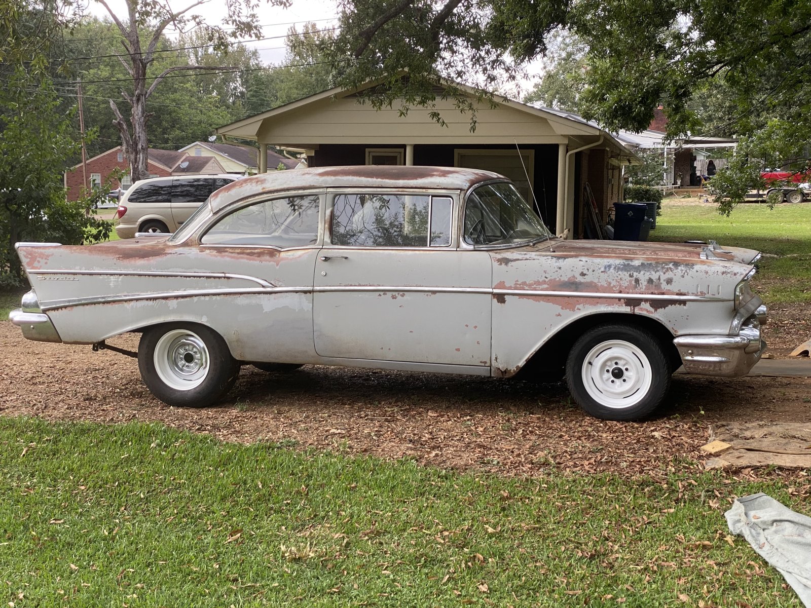

  24. Mitchell Rish
    Posts: 2,335
    Mitchell Rish
    from Houston MS
    New wheels and tires. I like that the wheel and tire sits closer to the edge of the fender lip but not to close. Seems to fill the wheel well up more. This is a 195/65R/15. That alone makes the rake a little more tolerable. Came off the rack for 100$ for the pair so I may learn to like them. The first photo is with the other steelies and 6x15 bias ply. The last 3 photos are of the new combo.

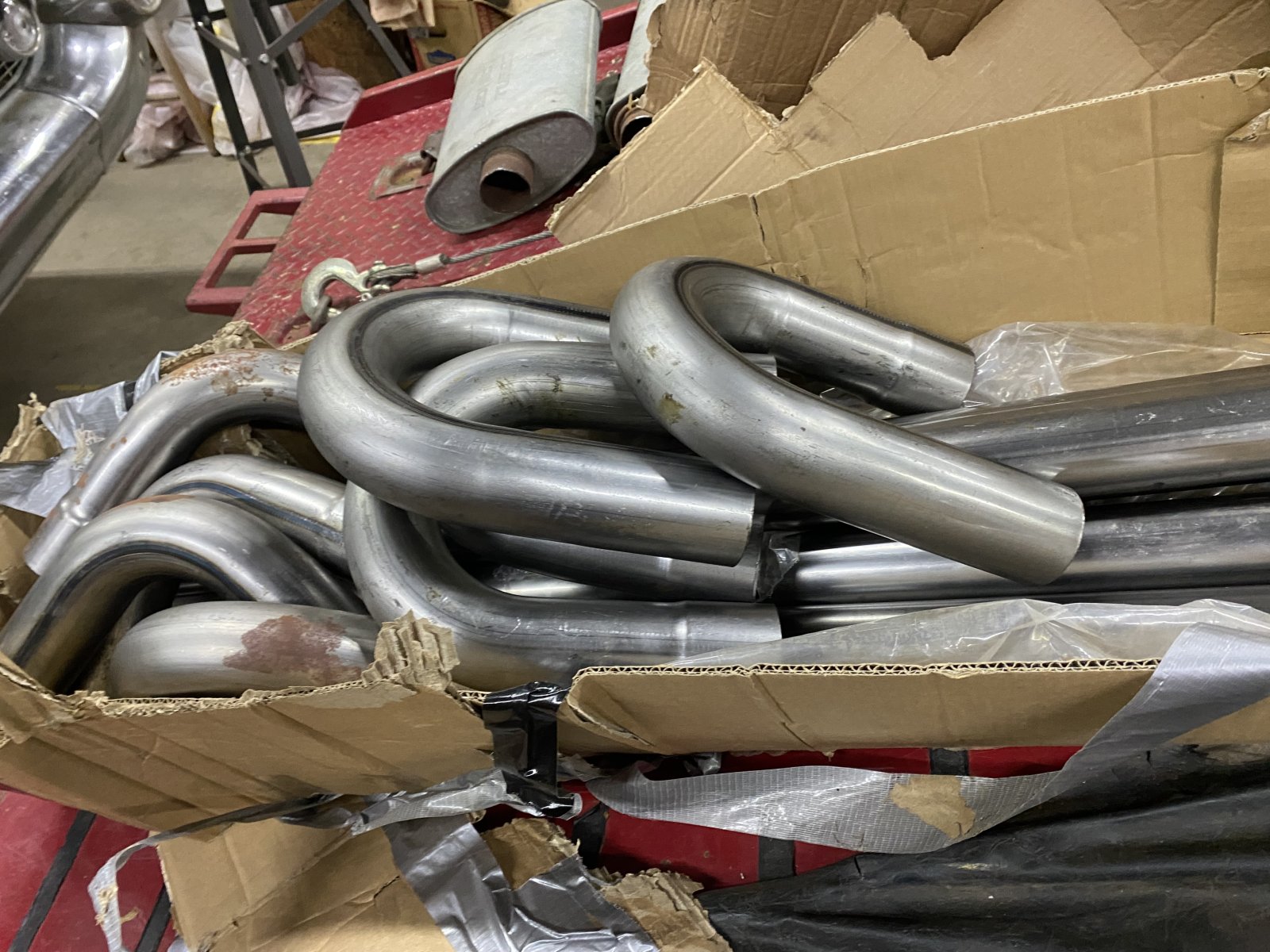

  28. Mitchell Rish
    Posts: 2,335
    Mitchell Rish
    from Houston MS

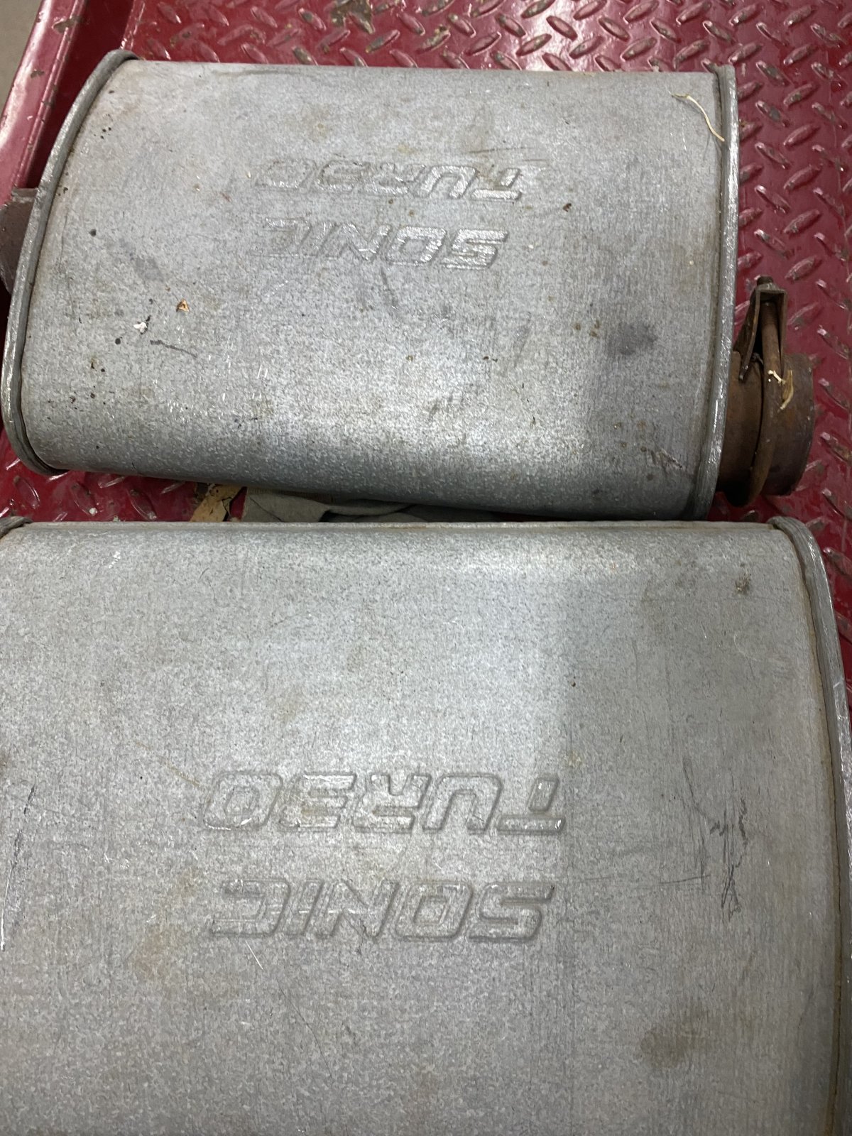

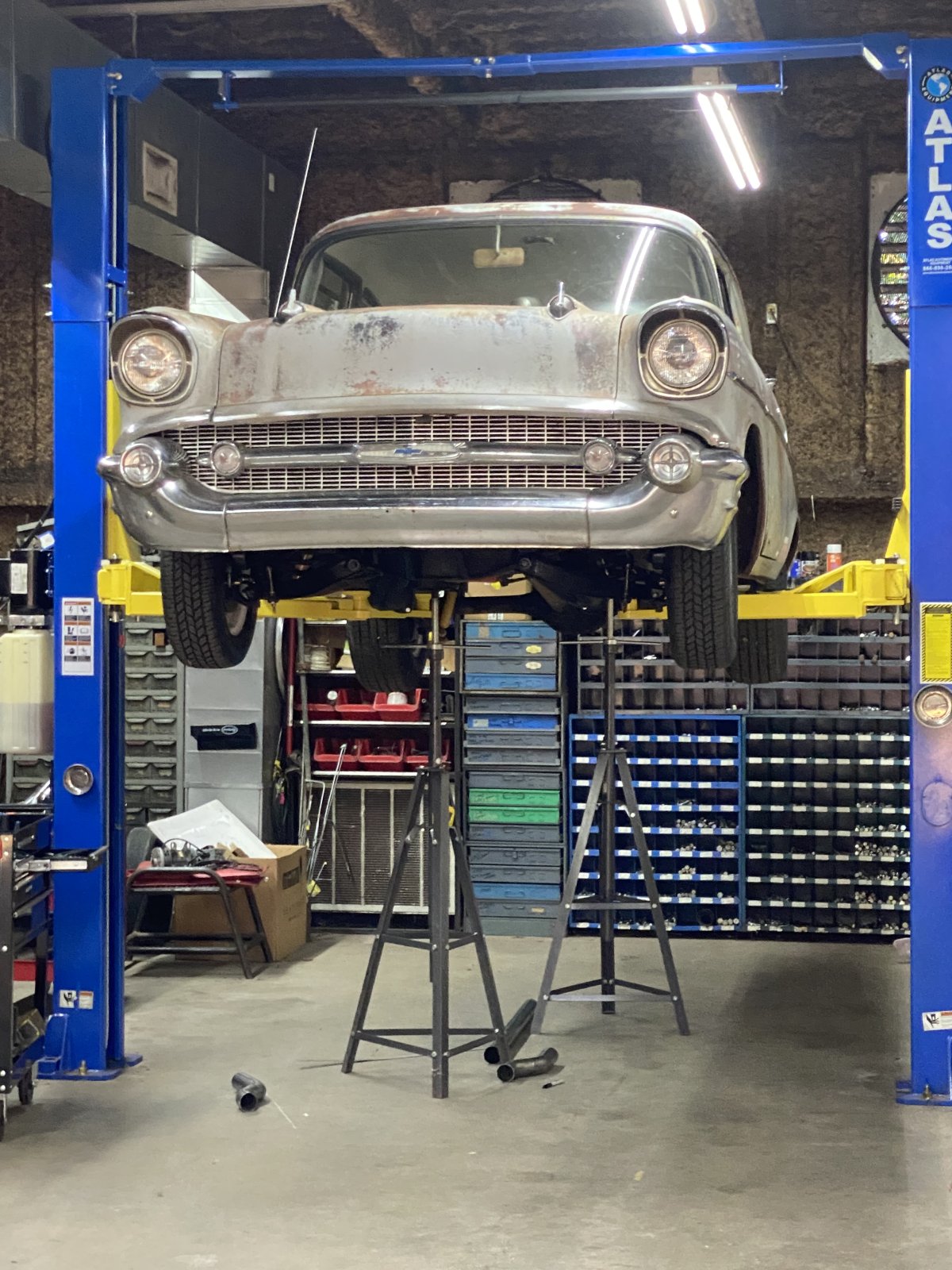

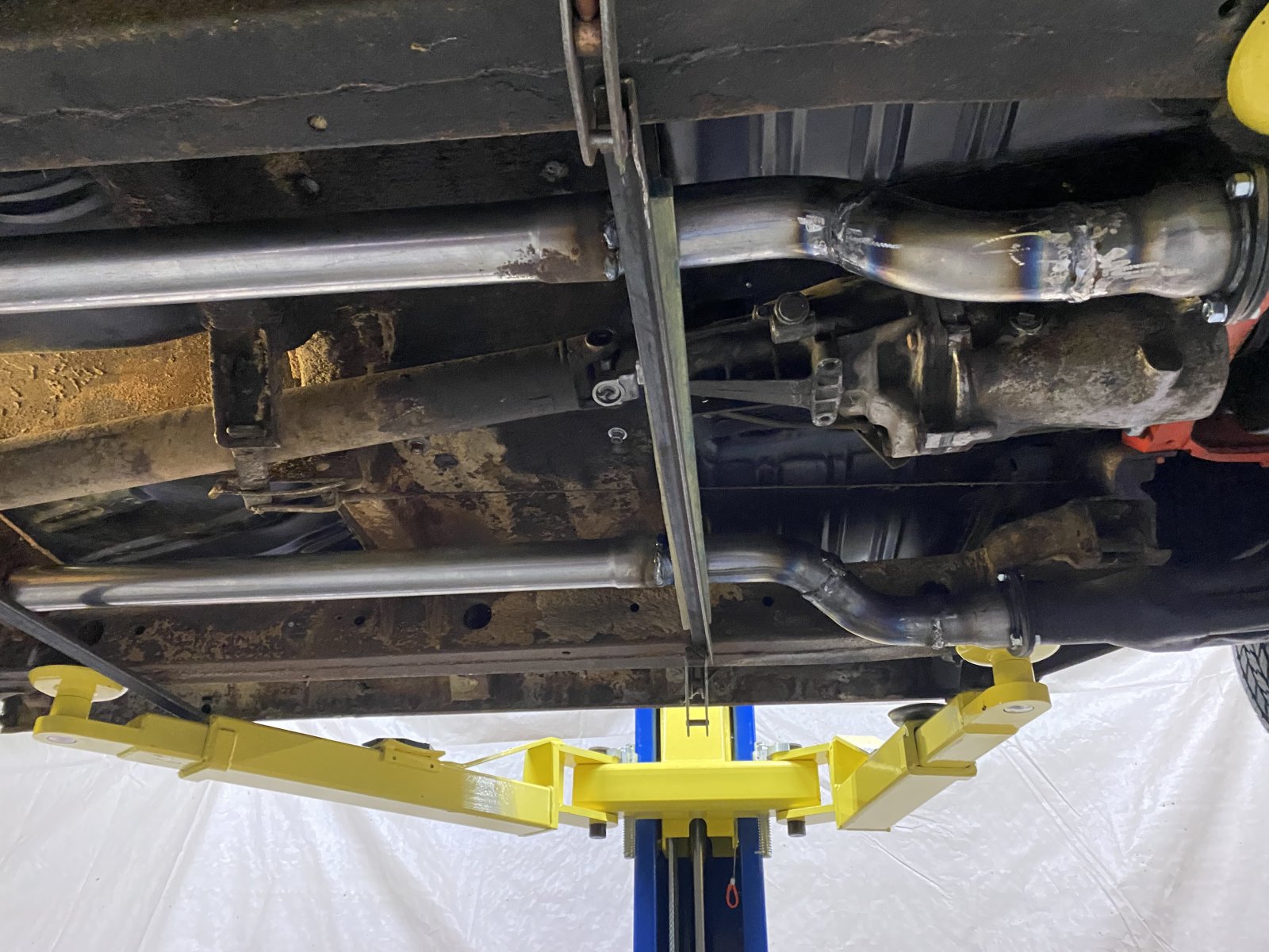

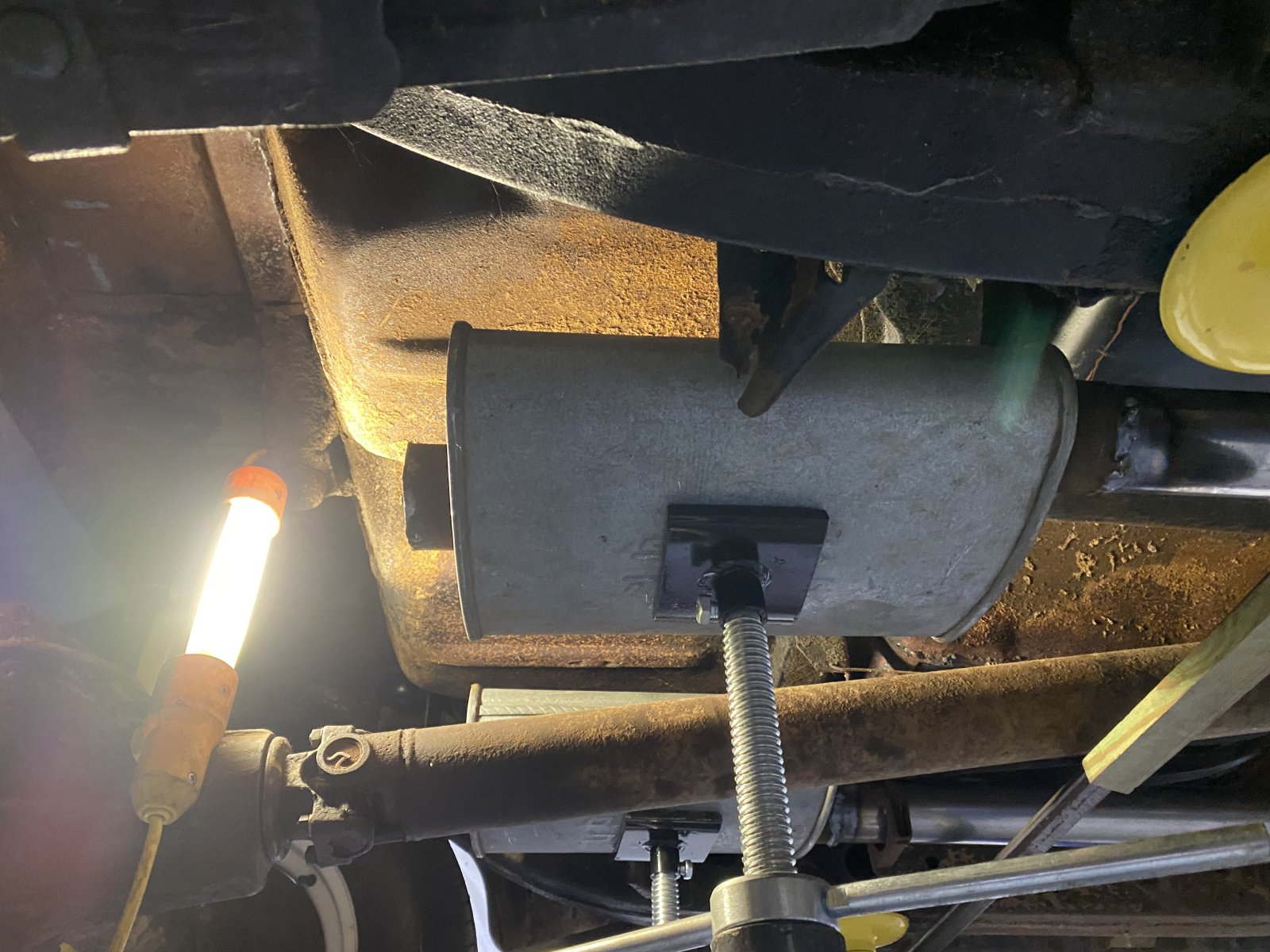

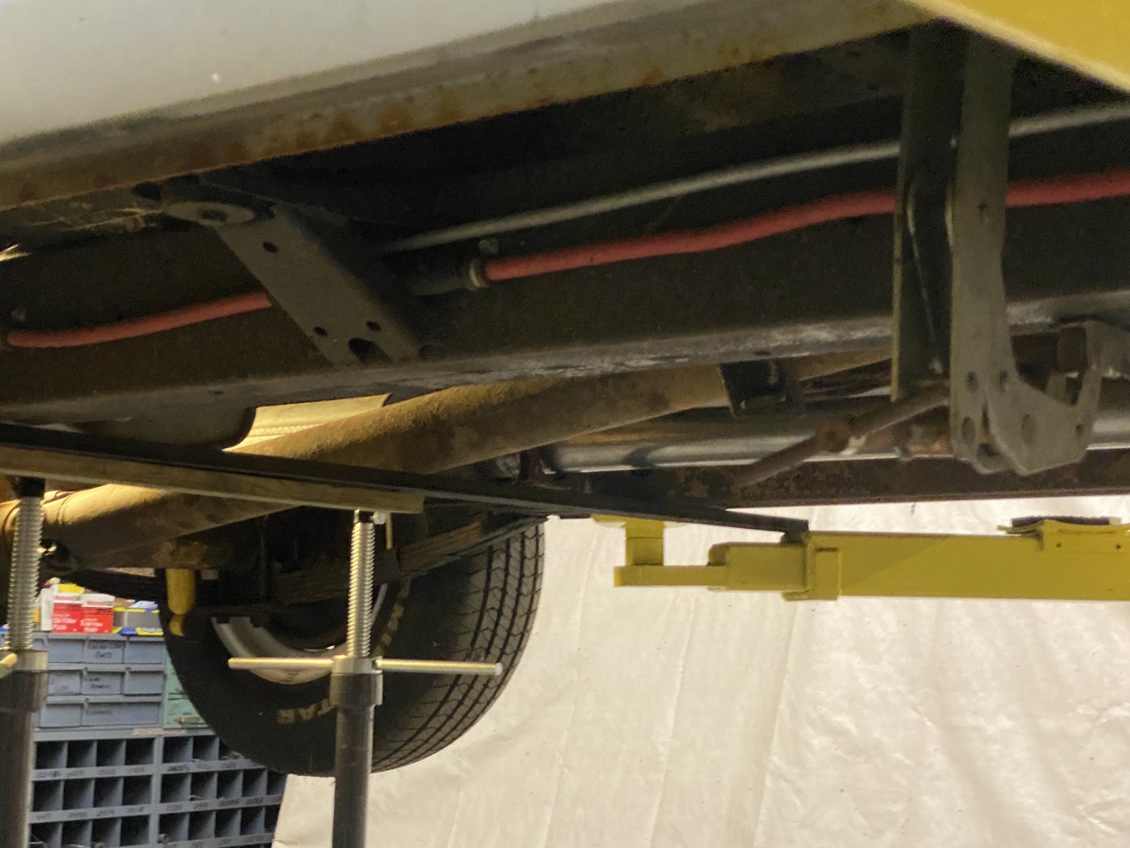

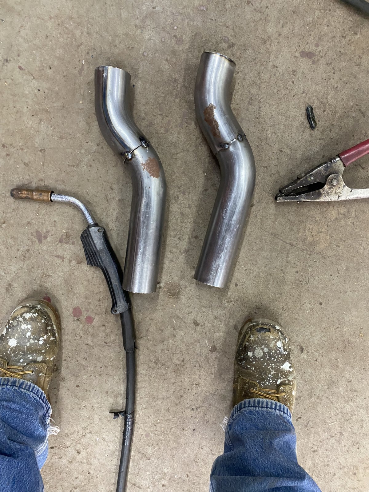

    Took 57 to the river to put on the lift and start the exhaust.Wes was Big Boss today. Probobly the first time he has seen the underside in many years.
    Forgive the left side spot welds. I forgot to turn on the shielding gas. Looks rather ruff. Got the first two bends completed and spot welded.
    Bought a tubing kit and I’ve had these big sonic turbos for ever. Might as well use them. IMG_1279.jpeg IMG_1280.jpeg IMG_1274.jpeg IMG_1275.jpeg IMG_1277.jpeg IMG_1278.jpeg IMG_1276.jpeg

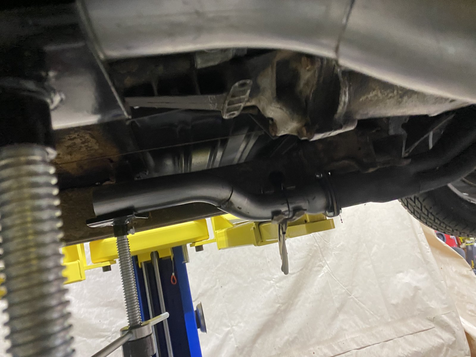

  29. Mitchell Rish
    Posts: 2,335
    Mitchell Rish
    from Houston MS

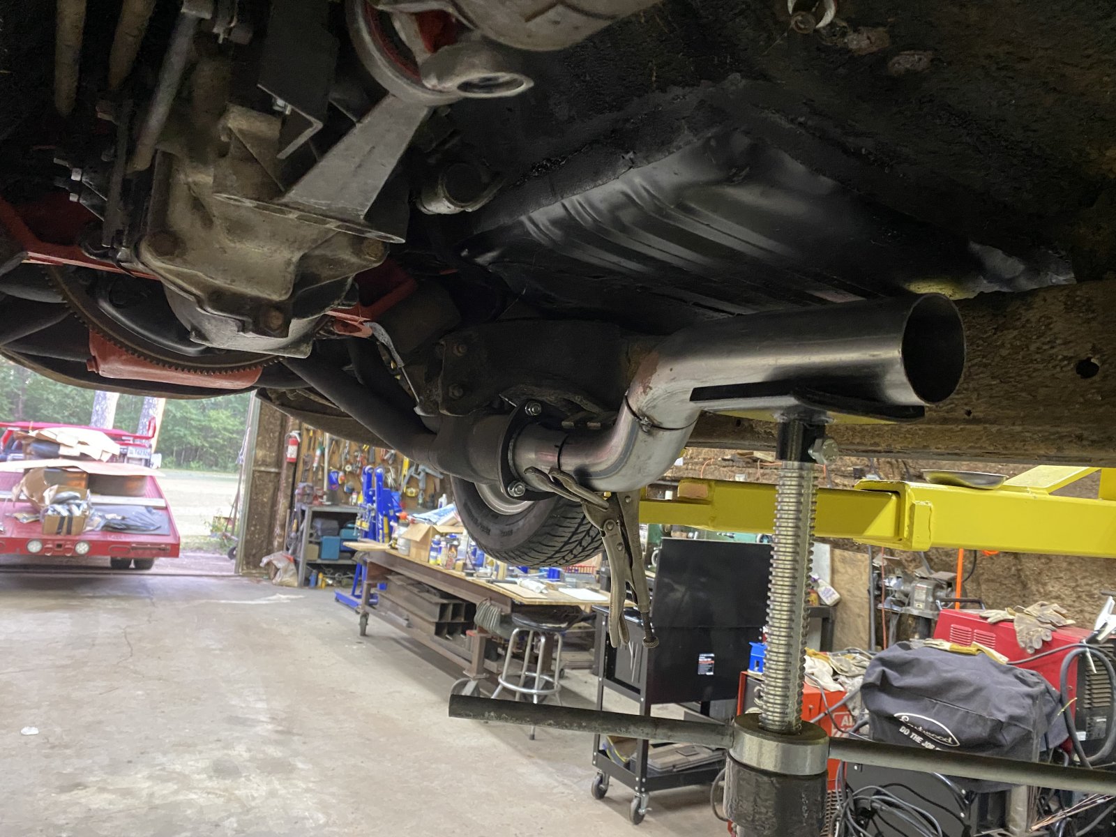

    Exhaust back to the rear end complete . Over the rear end and last tail pipe sections now. I removed fuel tank( fuel cell in the trunk) and spare tire well. The tail pipe will tuck in and up and won’t be visible. Turn down just at the bumper IMG_1302.jpeg IMG_1305.jpeg IMG_1304.jpeg IMG_1303.jpeg

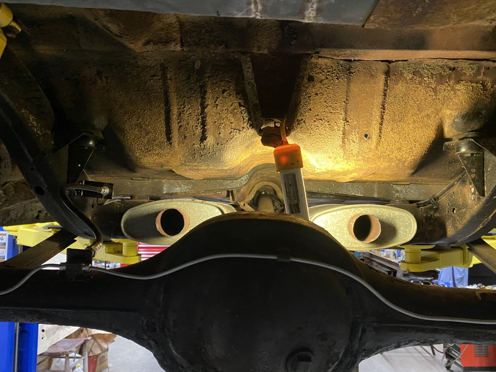

  30. Mitchell Rish
    Posts: 2,335
    Mitchell Rish
    from Houston MS
    Exhaust system complete. And I am pleased.

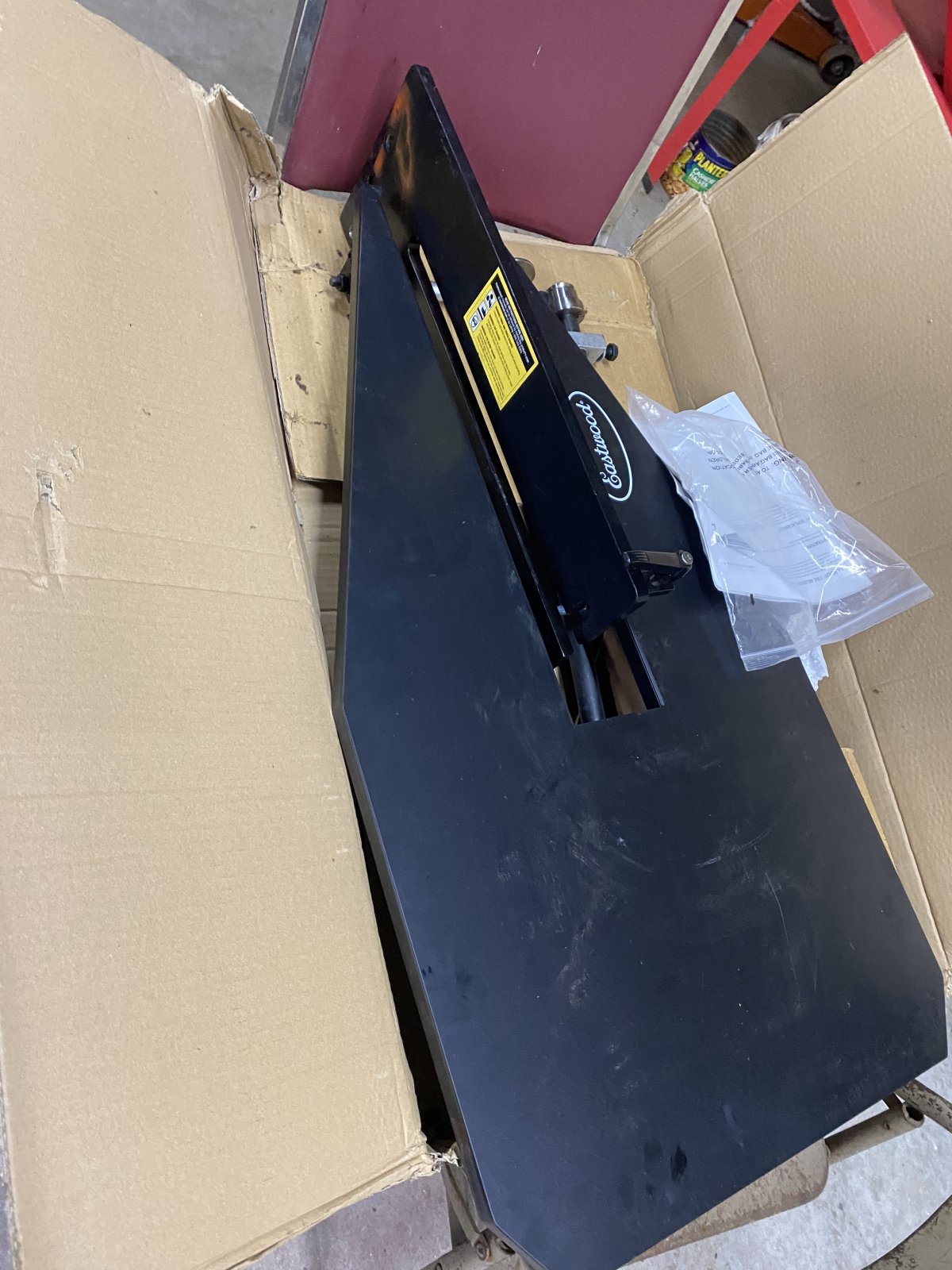

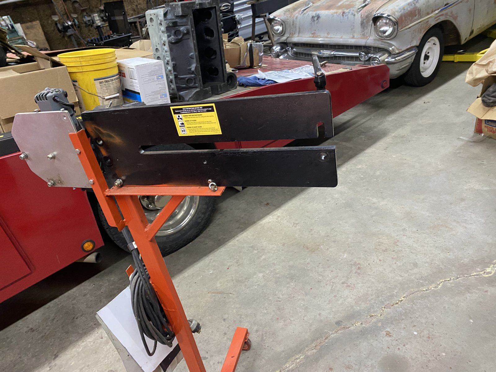

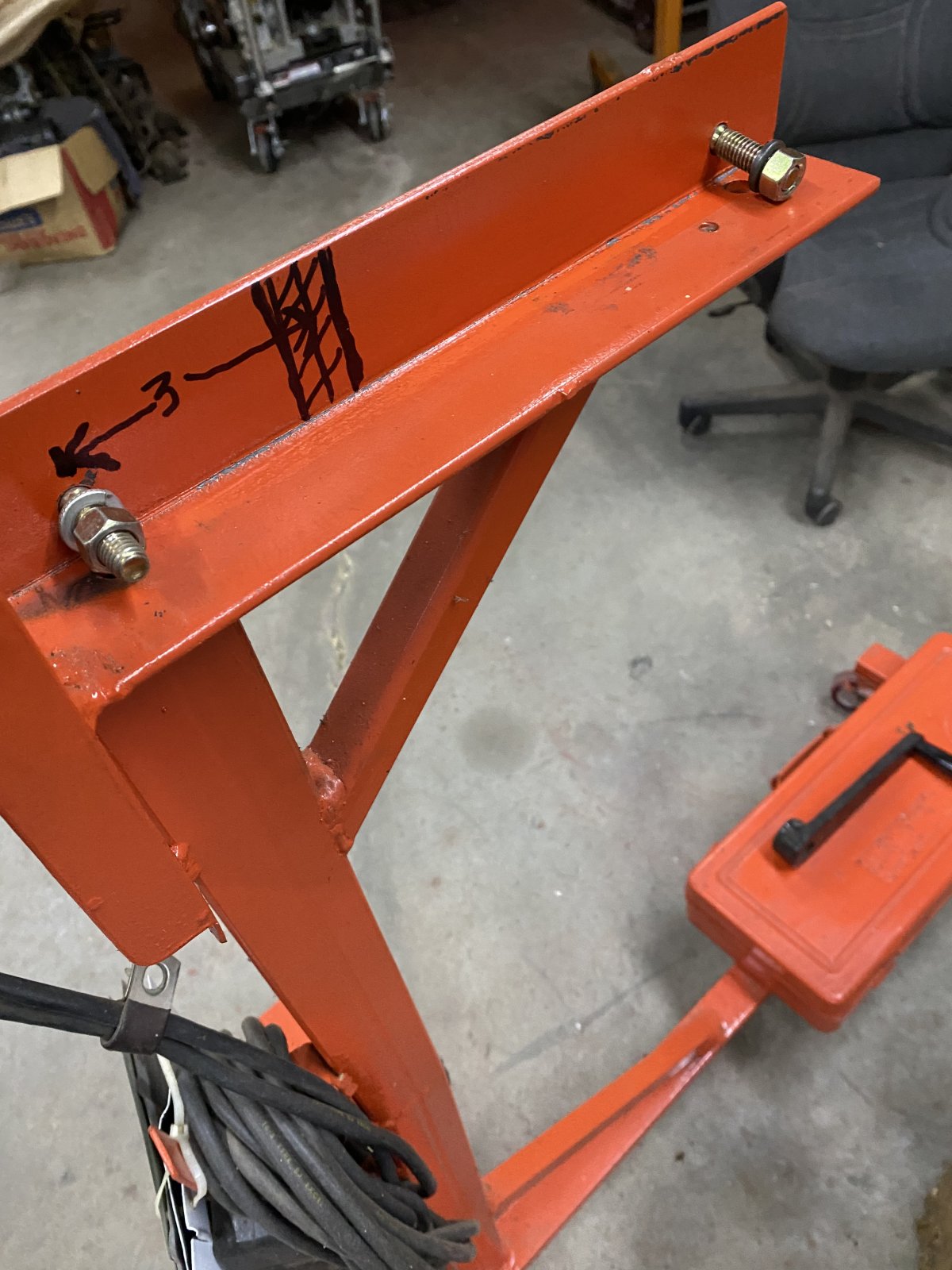

    Putting the table and fence on the bead roller. Gotta cut one more slot and then back together.This will allow me to move pretty quick as I make foot/1/4/kick panels. I also need to make a wider set of door seals. IMG_1337.jpeg IMG_1338.jpeg IMG_1339.jpeg IMG_1340.jpeg
    brEad, Thor1, Squablow and 2 others like this.
