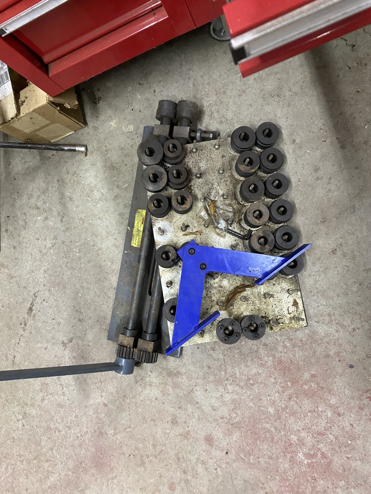

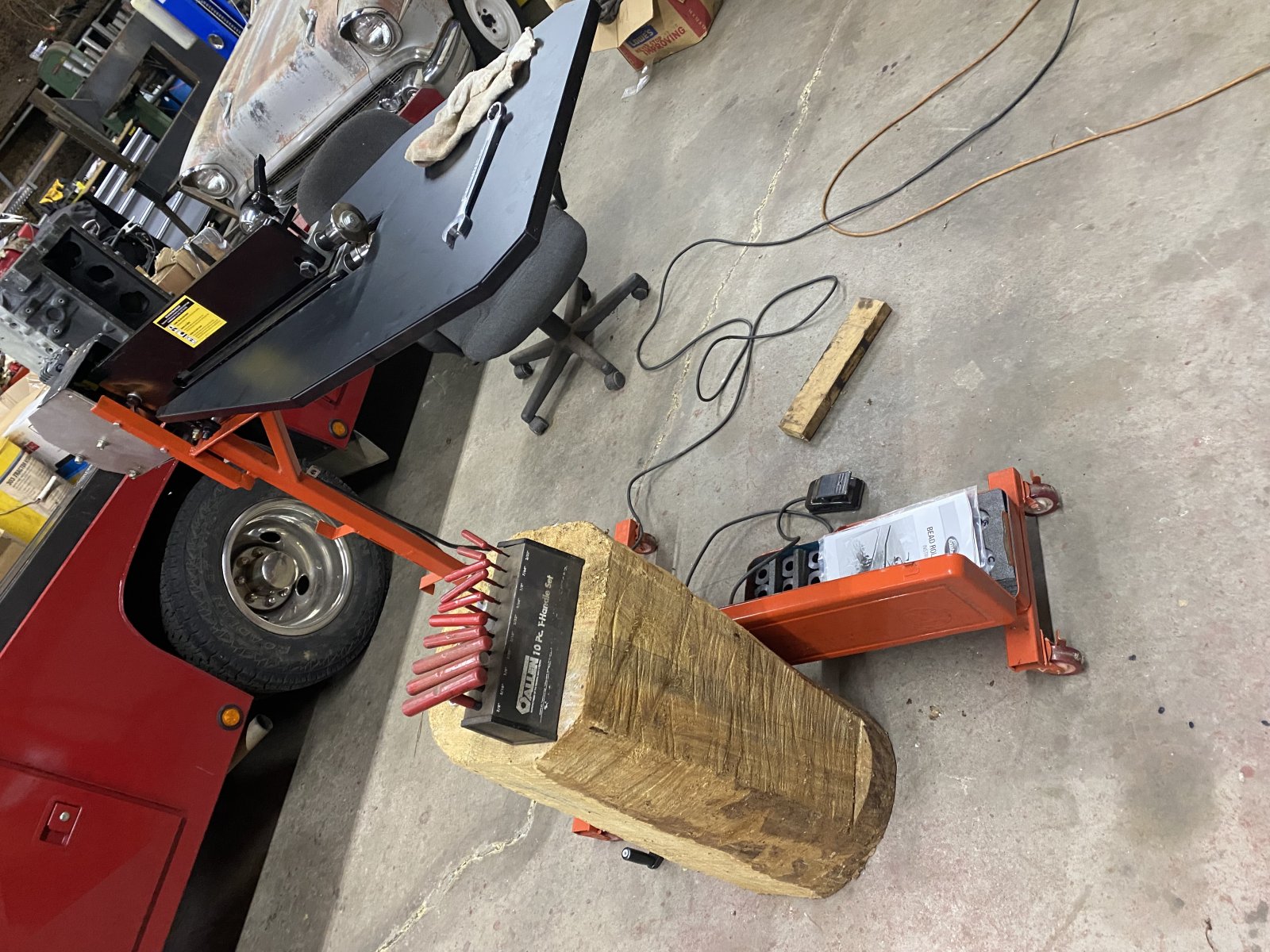

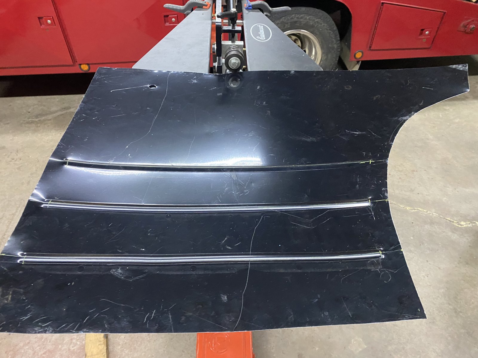

    Finally have the table on the bead roller. the fence will not work with the table but that’s not a problem I can use a 1X2 and clamp to the table on both ends and use it accordingly.
    I will put the fence on the bead roller that Wes brought in from his gin. ( shop).
    Will be able to set both up if needed with different sets of dies and do a production line kinda gig.
    Started the door panel patterns. I’ll play with the designs and see what I like best.
    I have made a card index using 4X12 inch aluminum (.040) for each die set and they are labeled so I can make a quick reference. They are hanging on the orange stand with the foot switch IMG_1357.jpeg IMG_1358.jpeg IMG_1359.jpeg IMG_1360.jpeg IMG_1361.jpeg

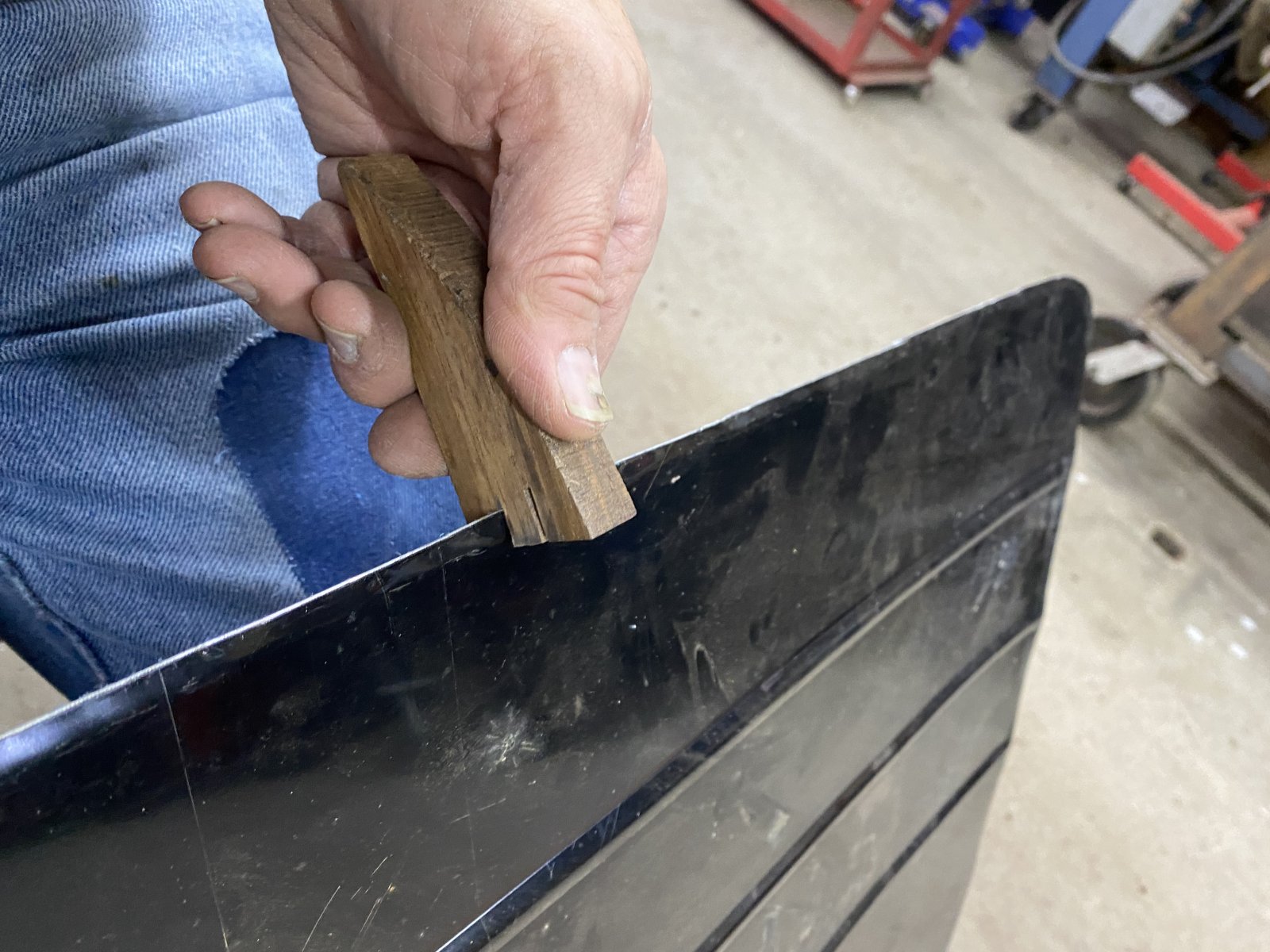

    Finally got the door panel pattern done.

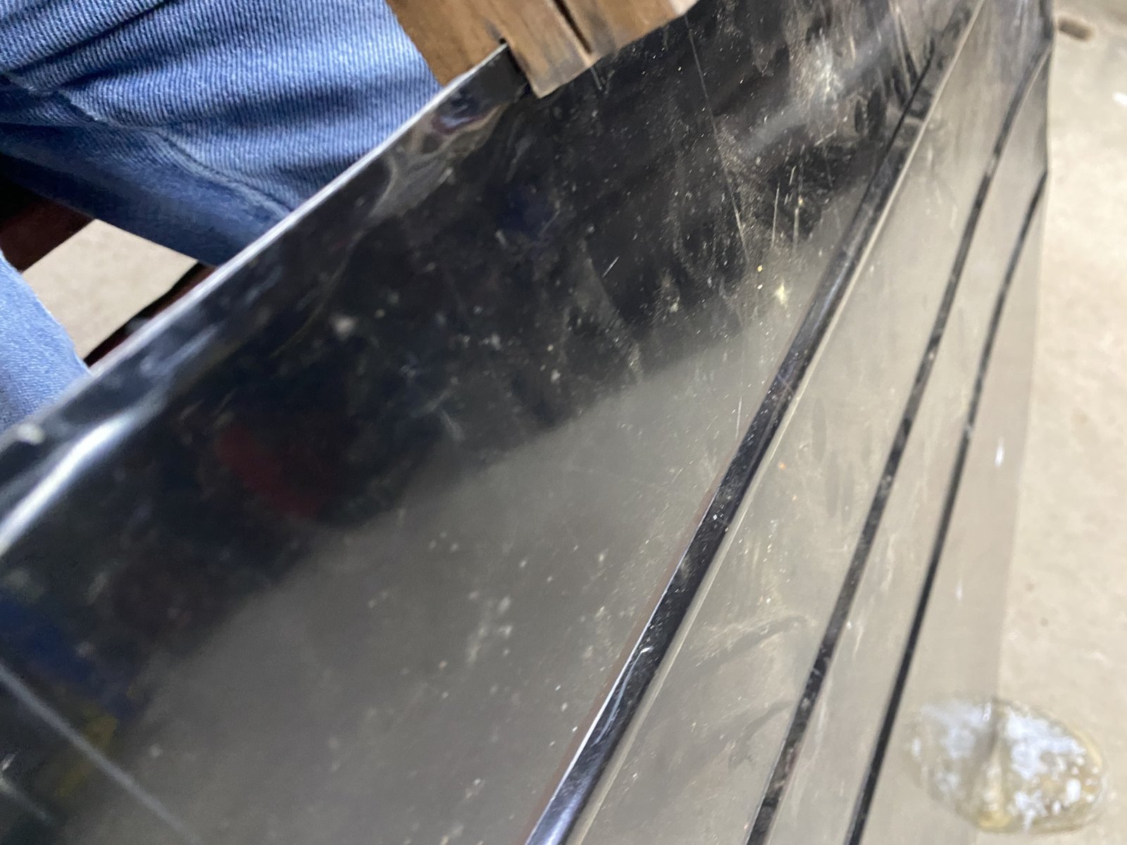

    Table makes the bead roller easier to deal with. I left the plastic covering on to hopefully keep gouging down. I’ll use the baked on enamel as a primer and paint the same as the interior. I need to enlarge the regulator openings. I will use counter sunk screws and washers spaced accordingly. I will also use a little bit of English wheel work IMG_1368.jpeg IMG_1368.jpeg IMG_1369.jpeg IMG_1370.jpeg IMG_1371.jpeg to turn down the edges if I need.

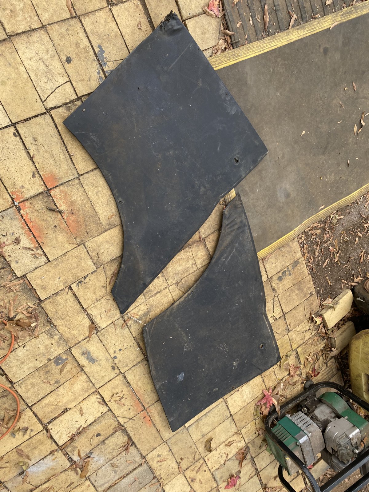

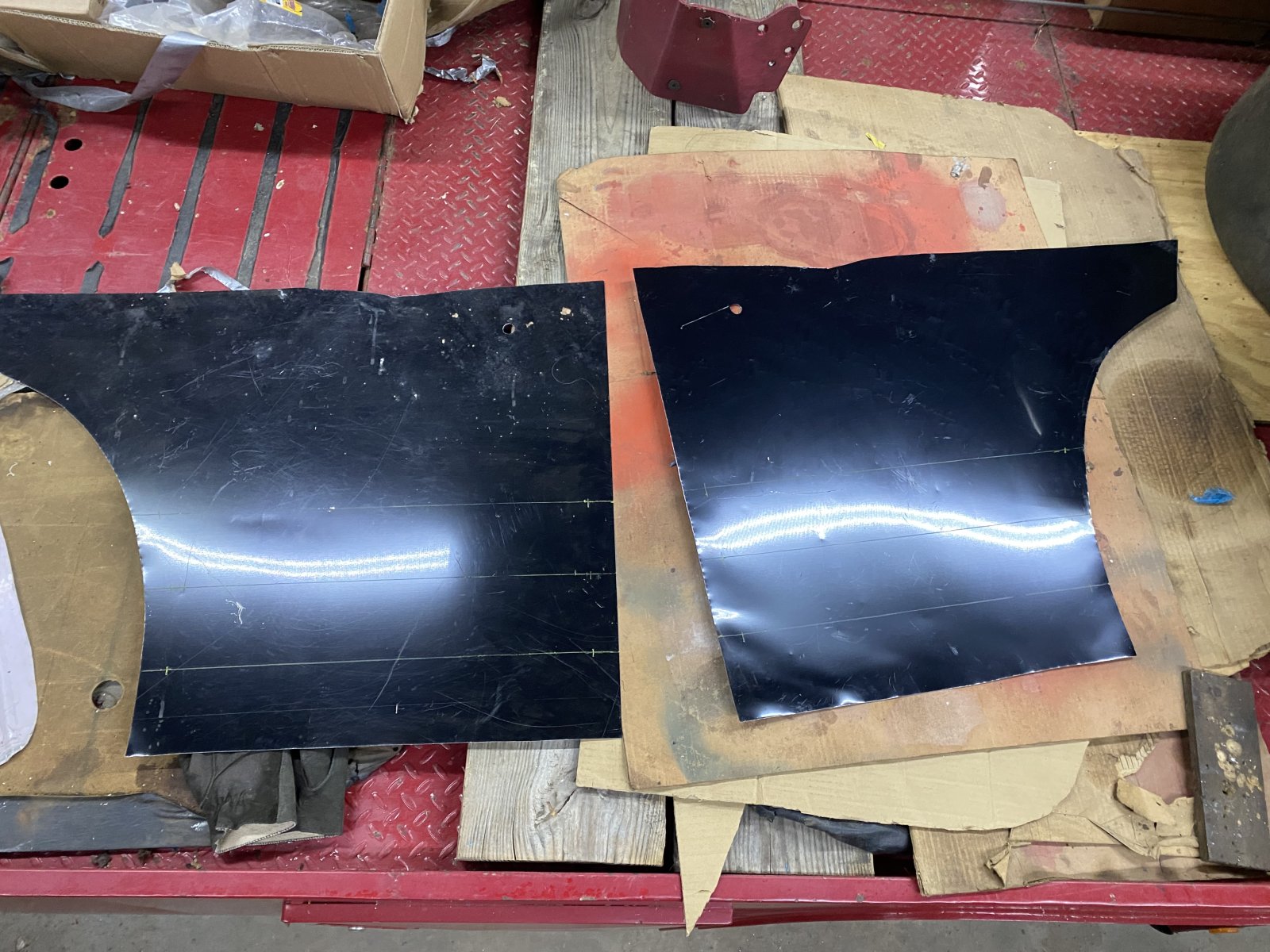

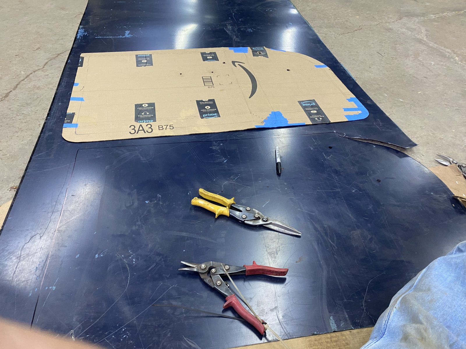

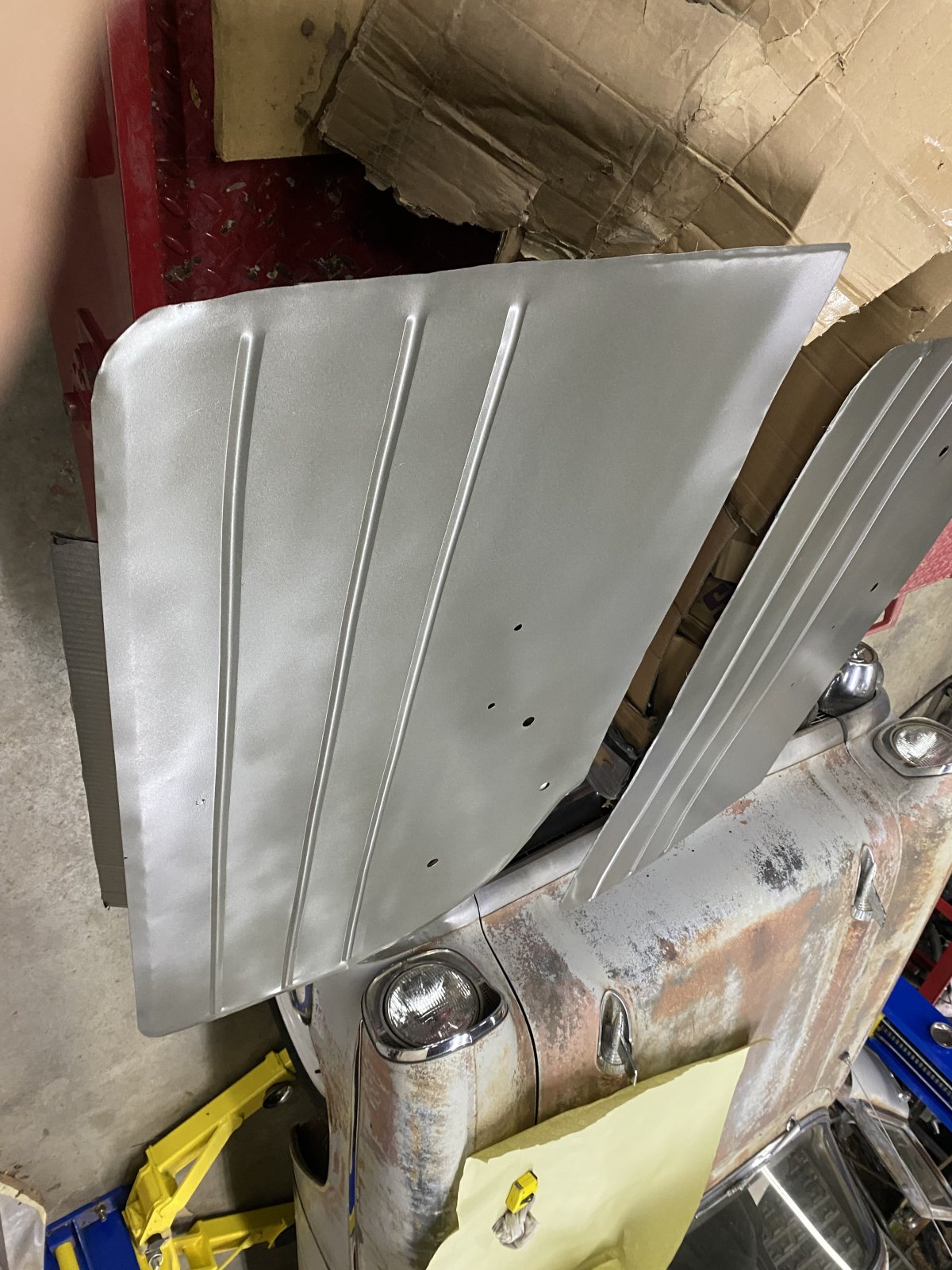

    Kick panels (factory replacements) came in and I used them as my pattern to duplicate in aluminum. As before I’ll use the baked on enamel as a primer. Paint to interior color . I need to test got and see if I need bead roll in a few spots to stop flex. IMG_1376.jpeg IMG_1377.jpeg

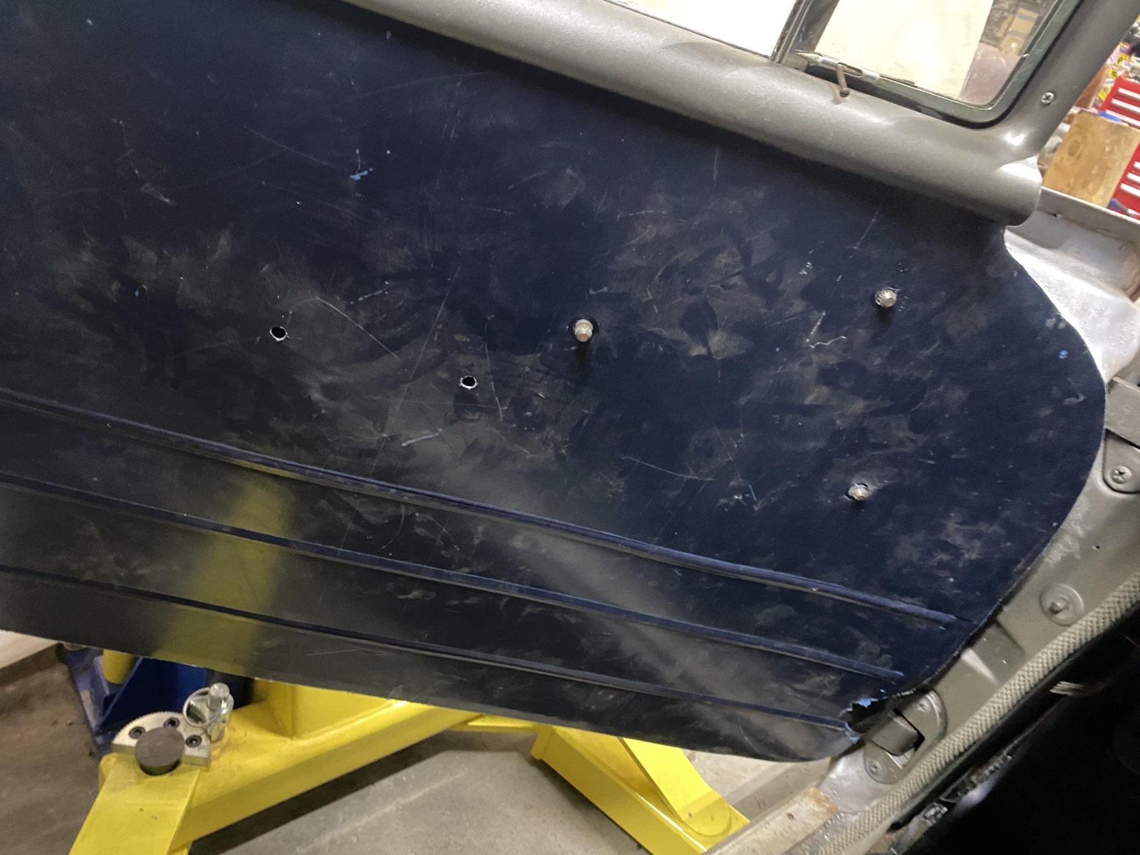

    IMG_1378.jpeg IMG_1379.jpeg Ok. Got a question. The bottom tab does it bend to the dimmer side or do I cut it off?
    brEad likes this.
  6. 427 sleeper
    Joined: Mar 8, 2017
    Posts: 3,366
    427 sleeper
    It bend's to the dimmer side and gets covered by the carpet or floor mat.

    Ok since the ones I am going to install are aluminum and there will be no carpet I can cut them off and attach as needed?
    I am figuring I’ll run a bead or two with bead roller and stiffen up so there is no rattling when tightens down.
    Use nut clips and a couple of screws on the bottom. Possibly counter sink holes on the windlace side and let the guid screws hold both the guid track and the panel.
  8. 427 sleeper
    Joined: Mar 8, 2017
    Posts: 3,366
    427 sleeper
    You could. You could also bend it to match the floor and pop rivet it to the floor to help hold it in place.
    Squablow likes this.

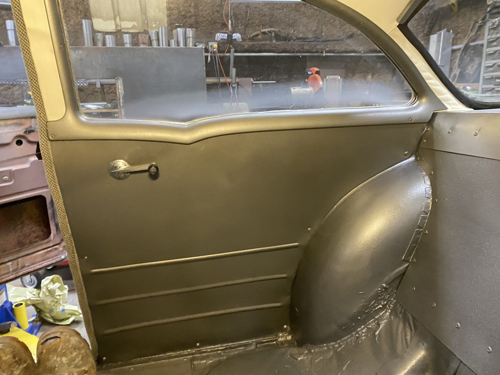

    Door panels are done. I am going to attach using screws with interior washers. Will also use some silicon beads to help fight the vibration possibility. Will scotch brite and paint interior color. Also used edging tool to get a slight in word curve for the panel edges. IMG_1398.jpeg IMG_1396.jpeg IMG_1397.jpeg IMG_1395.jpeg
    brEad, Stogy, lothiandon1940 and 3 others like this.

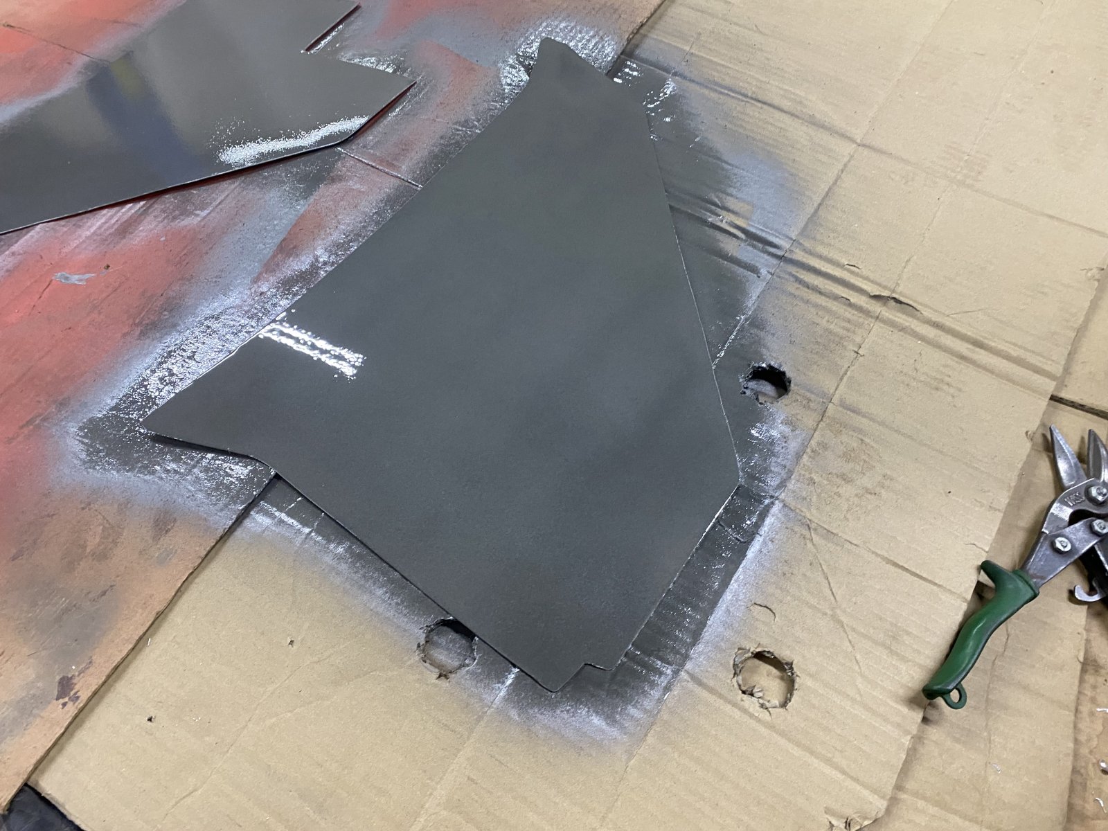

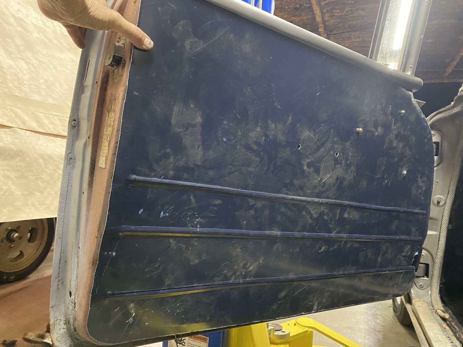

    Painted door panels today. Dried looked too glossy. So wiped with lacquer and flattened them out. Will look better when dry. The quarter window panel pattern is going to wind up being a multiple piece and then taped together pattern.
    All of these panels will go in with small screws with upholstery washers set in counter sink holes. Edges will be re rolled also. IMG_1407.jpeg IMG_1408.jpeg IMG_1409.jpeg IMG_1410.jpeg

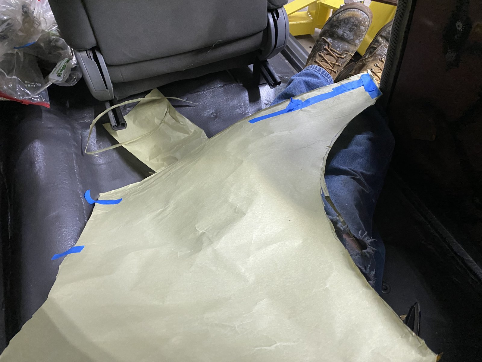

    Had just a minute to prop up and see if they are as good a pattern as I think. They are lol IMG_1419.jpeg IMG_1420.jpeg

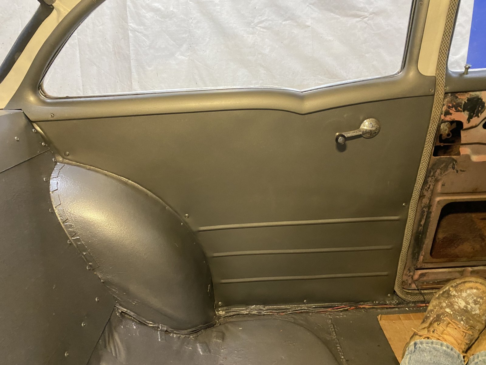

    IMG_1491.jpeg IMG_1492.jpeg Back qrt interior panels complete. Still need to radius ( turn down and in ) the edges. Gotta scuff and paint.
    Bead rolling is a 4 inch spread like the doors. Still gotta paint. Got counter sunk screws and washers.

    Rear quarter window panels complete installed. Passenger door complete. Screwed up and drilled one hole in wrong place. I have some epoxy and a quick touch of paint. Nobody will ever know.
    Leaves driver door and the kick panels. Might get to finish it by Saturday.
    Have some touch up to do. Several scratches on the install. Decided to do upholstery washers and screws instead of pop rivets for no other reason than working on the door regulators etc. IMG_1507.jpeg IMG_1503.jpeg IMG_1504.jpeg IMG_1506.jpeg

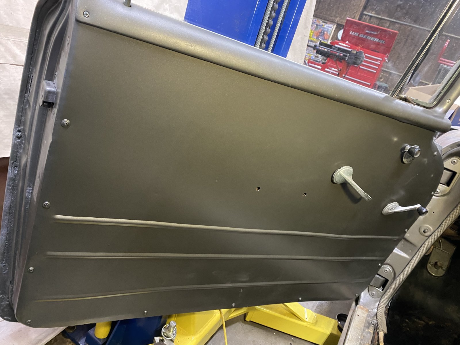

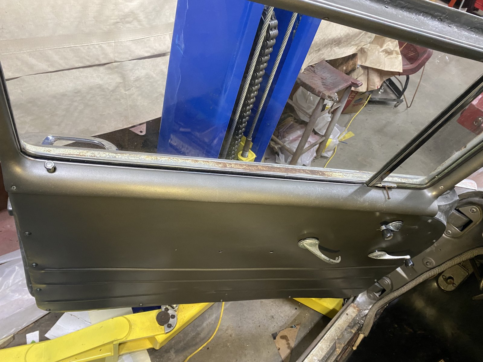

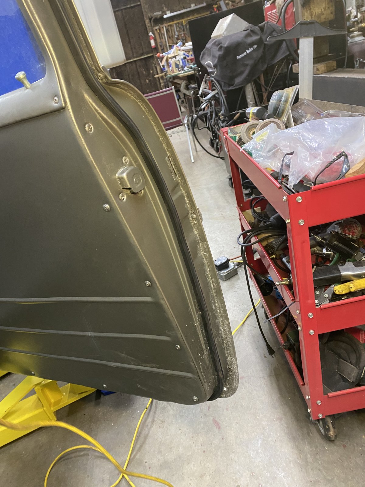

    IMG_1518.jpeg IMG_1517.jpeg IMG_1521.jpeg IMG_1520.jpeg Driver side door panel complete. Also painted kick panels. Cut a clearance opening for fuse panel access. I just don’t want to have to fight a side panel to access fuses. And you never can tell. Will add pics later for what ever reason they are not loading.
    brEad, Thor1, Squablow and 1 other person like this.

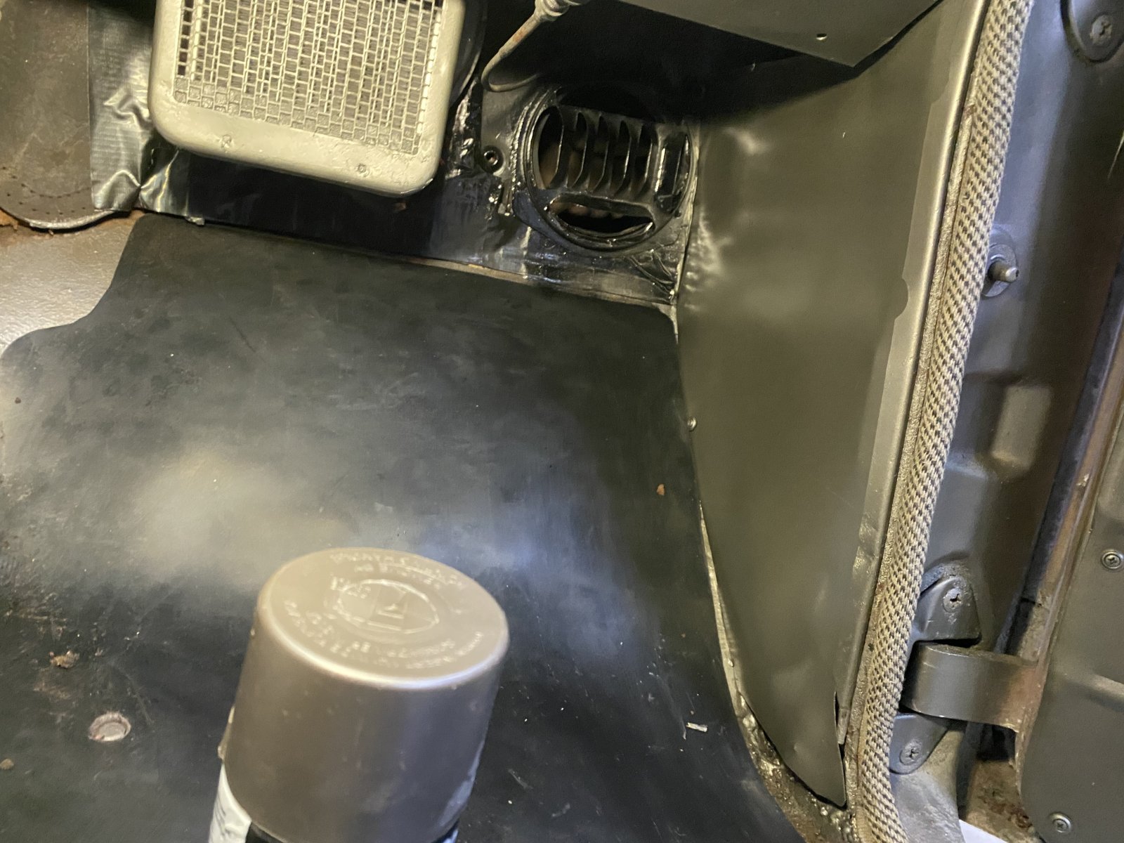

    IMG_1525.jpeg IMG_1522.jpeg Kick panels and grates covering fresh air ducts done.
    I didn’t bead roll. If I had I wouldn’t have been able to bend and drop into place. One screw close to the fold tab on floor secures. There is a little bit of a gap but that will be delt with using grey silicon/sealer.
    I cheated on grill/grates for fresh air. I got tired of the caged screw bosses tearing in the cardboard firewall padding so I drilled tiny tiny holes into the inlet rings from the inside the same way they are secured from the under hood side and put screws through the fire wall pad and tightened them down. They won’t move now.

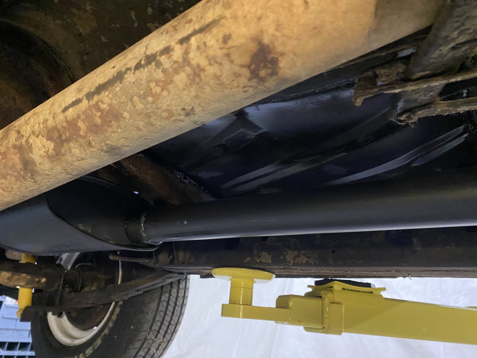

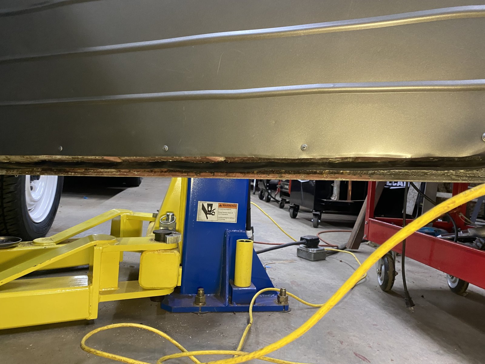

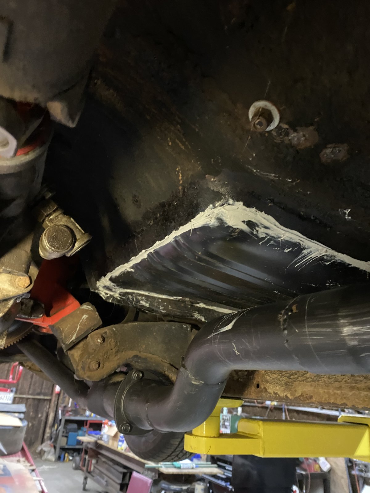

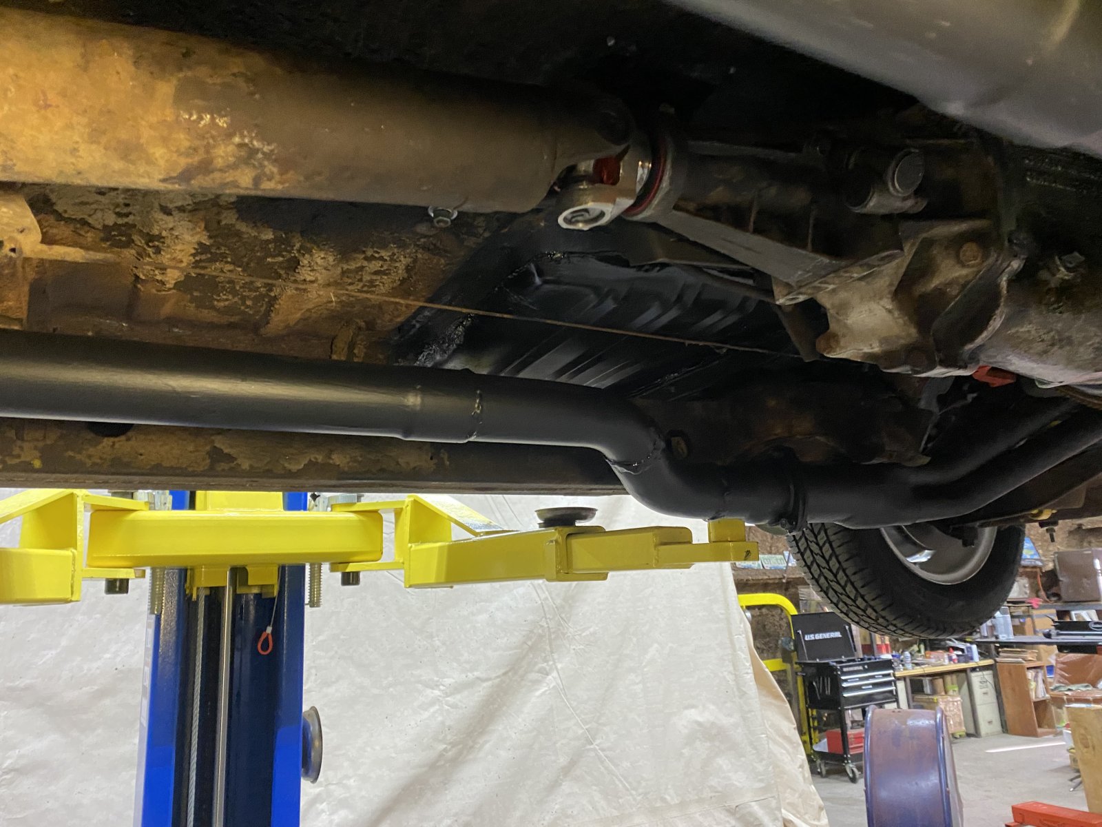

    Got the bottom seams sealed and painted over ( used aluminum gutter sealer). Also used some Extreme exhaust /high temp paint and put on two coats on entire exhaust system. Got two seams in the interior and it’s pretty much done.
    I had been in my eye view thinking my passenger rear was about a half an inch higher than the driver side. So I started checking. And bingo. Found it. Spring stack bolt head broke off and the stack isn’t tight so naturally it’s a little lower. Gonna fix that tomorrow. I am supposed to have some leafy spring stack bolts around somewhere. IMG_1526.jpeg IMG_1527.jpeg IMG_1528.jpeg IMG_1529.jpeg IMG_1530.jpeg IMG_1531.jpeg IMG_1532.jpeg
