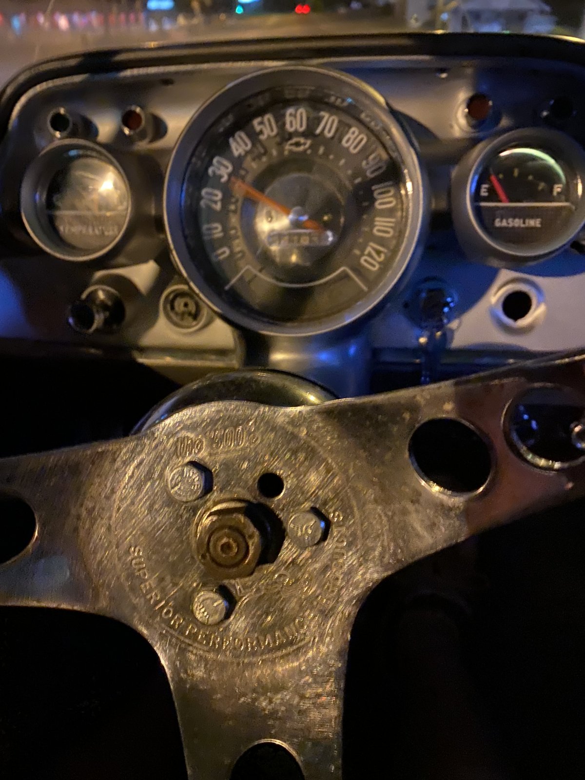

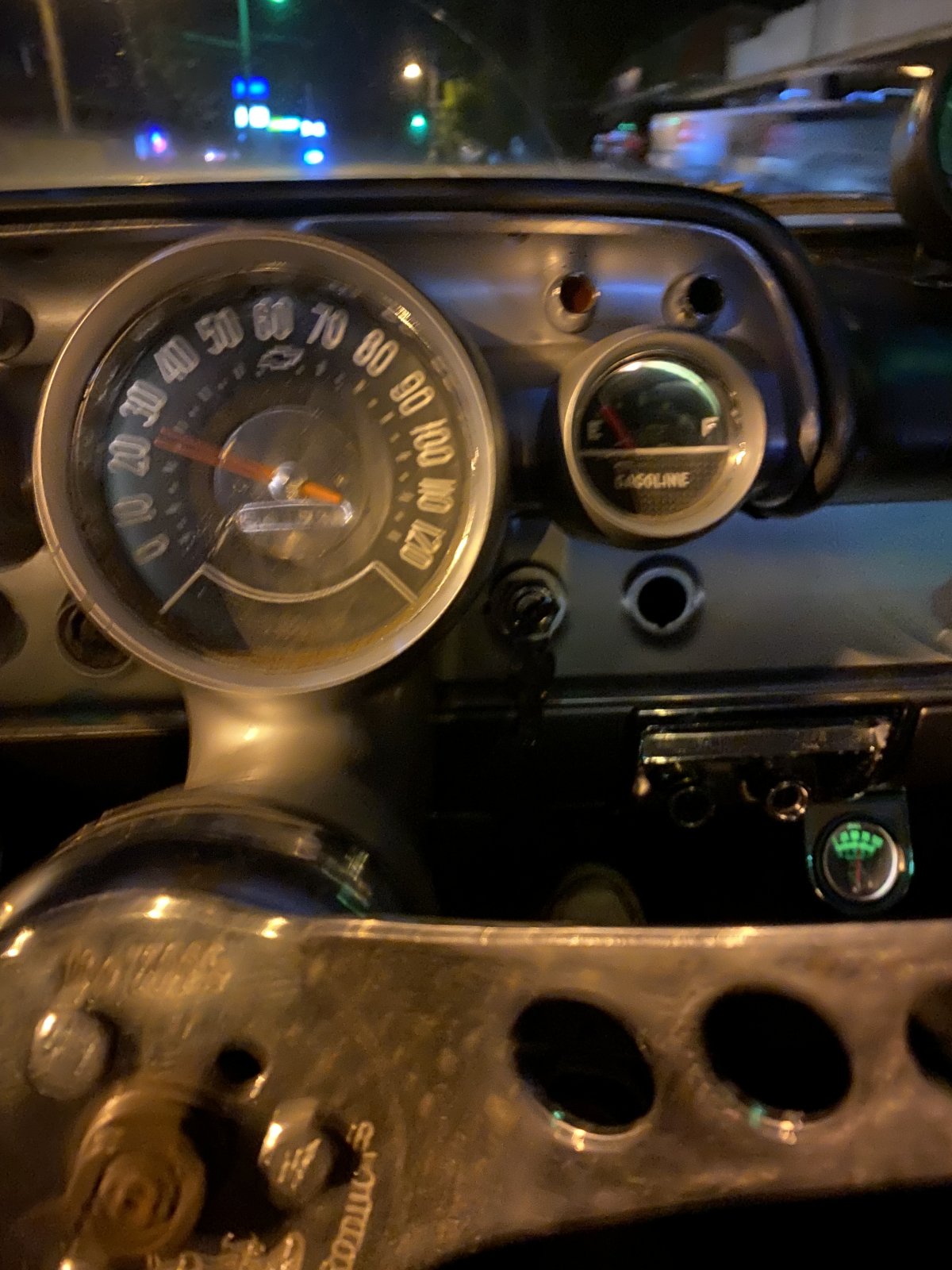

    Been putting a few miles on late at night when it’s cooler. Been a strange and changing last 60 days. Hope Mick approved. Even the speedometer is working lol IMG_2584.jpeg IMG_2583.jpeg

    better get some gas soon...

    Pat surf the gas gauge actually shows me with 5 or so gallons at E. I also have a measuring stick. I could bend the wire arm on the universal sender but I didn’t want to pull it out and mess with it. It’s averaging about 12 mpg. But I’ve been in city and running around the city square /sonic and such so I’m not using 4th much. I don’t like lugging one.

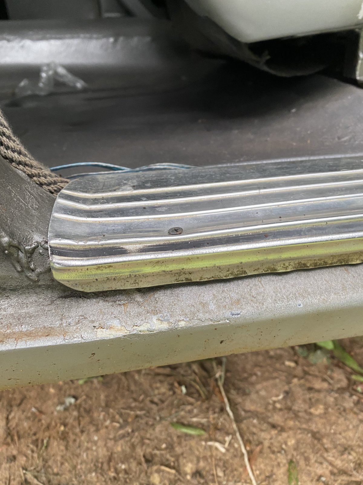

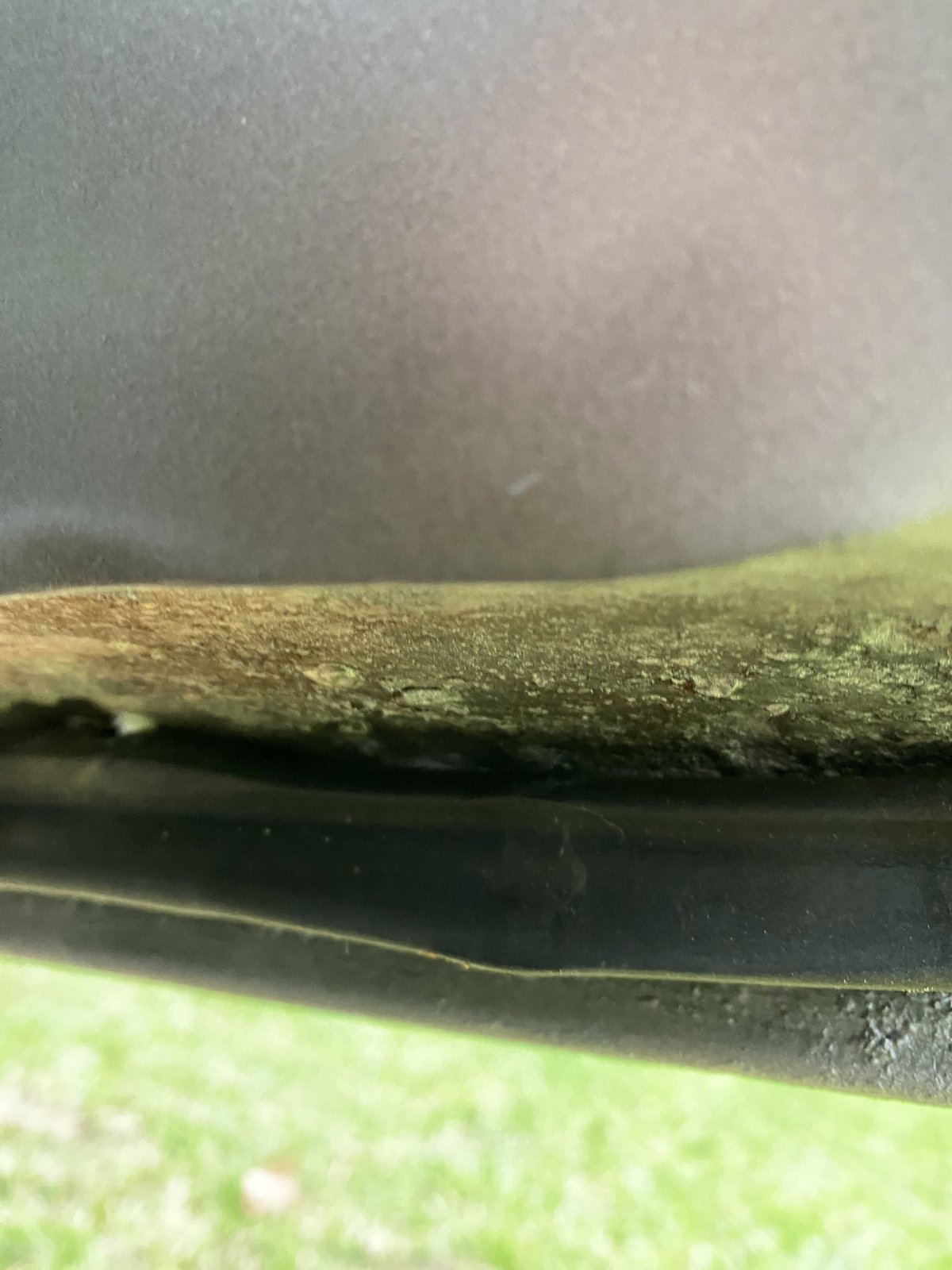

    My doors have a ledge that hooks into door panel about 1/2in above bottom. Does the 57 have same.

    Kinda. It’s the recess that the seal attaches to I think.ill have to look at it now that I think of it.

    Ok Doug here is what I got. One door shot one door sil shot IMG_2586.jpeg IMG_2587.jpeg

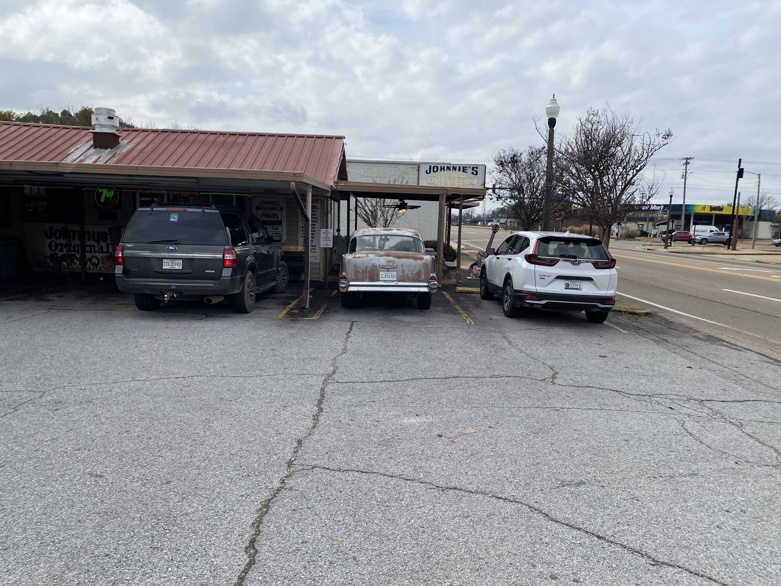

    Ok. Took a road trip in the 57 today. Total logged up near 150 miles. Went to Tupelo MS. Ate lunch at Johnnie’s Place. Oldest Dinner in Tupelo. And for those that are Elvis fans and historians you then know this was one of his favorite hangouts /dinners. I headed back before dark so I missed the opportunity to get a photo with the Neon Lights on. Maybe next time. IMG_3442.jpeg IMG_3443.jpeg IMG_3444.jpeg

    I love it. That drive-in looks like a perfect match for that car.

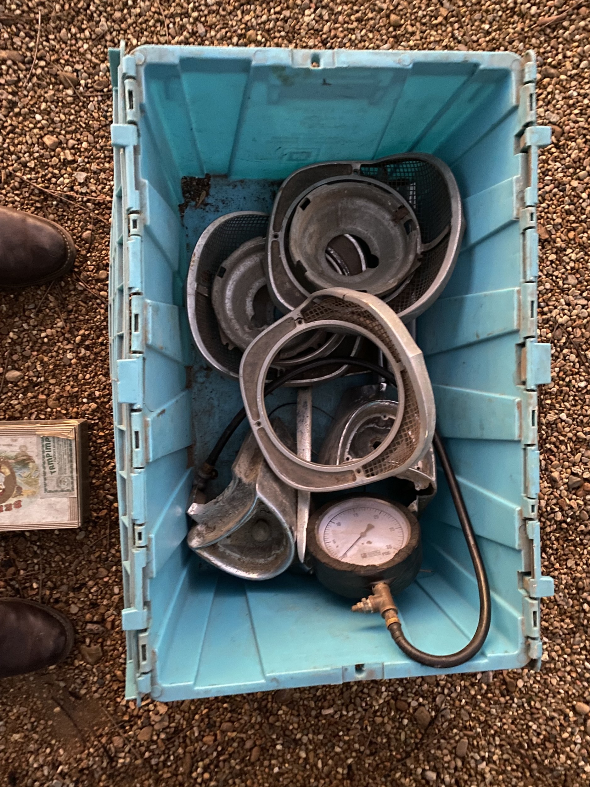

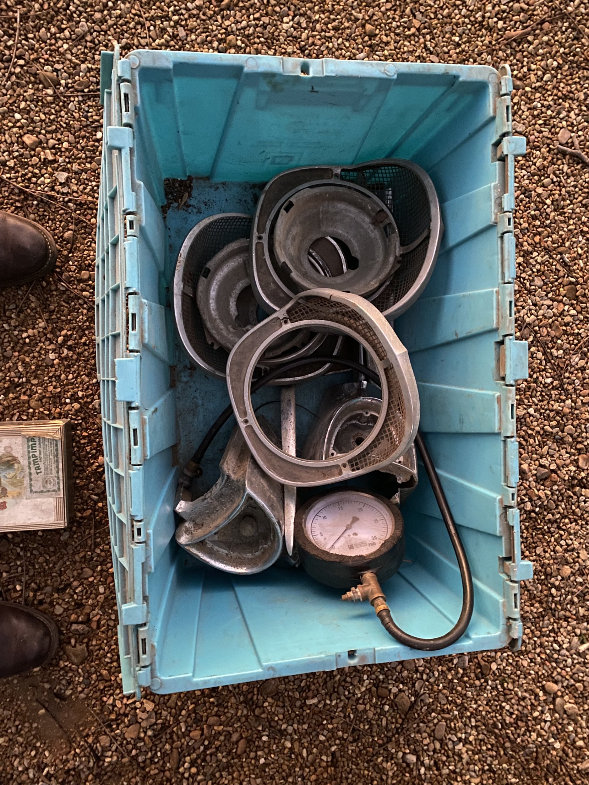

    Went to Wes’s old shop today. Found the last box of parts for the 57. And the 56 he used to have.( had the V 8 emblem for the 56) Headlight bezels and the back fin /bumper parts. I was looking for it in a cardboard box. Turns out it was in a mail carrier box. ( labeled no less. lol). also found an old set of Crower roller rockers 3/8 stude and locks. IMG_3617.jpeg IMG_3618.jpeg
  15. Mitchell Rish
    Joined: Jun 10, 2007
    Posts: 2,335
    Mitchell Rish
    from Houston MS
    And yes that’s a huge tire gauge. Told Wes I was taking it to. He said it was dead on. We will see but I love it.

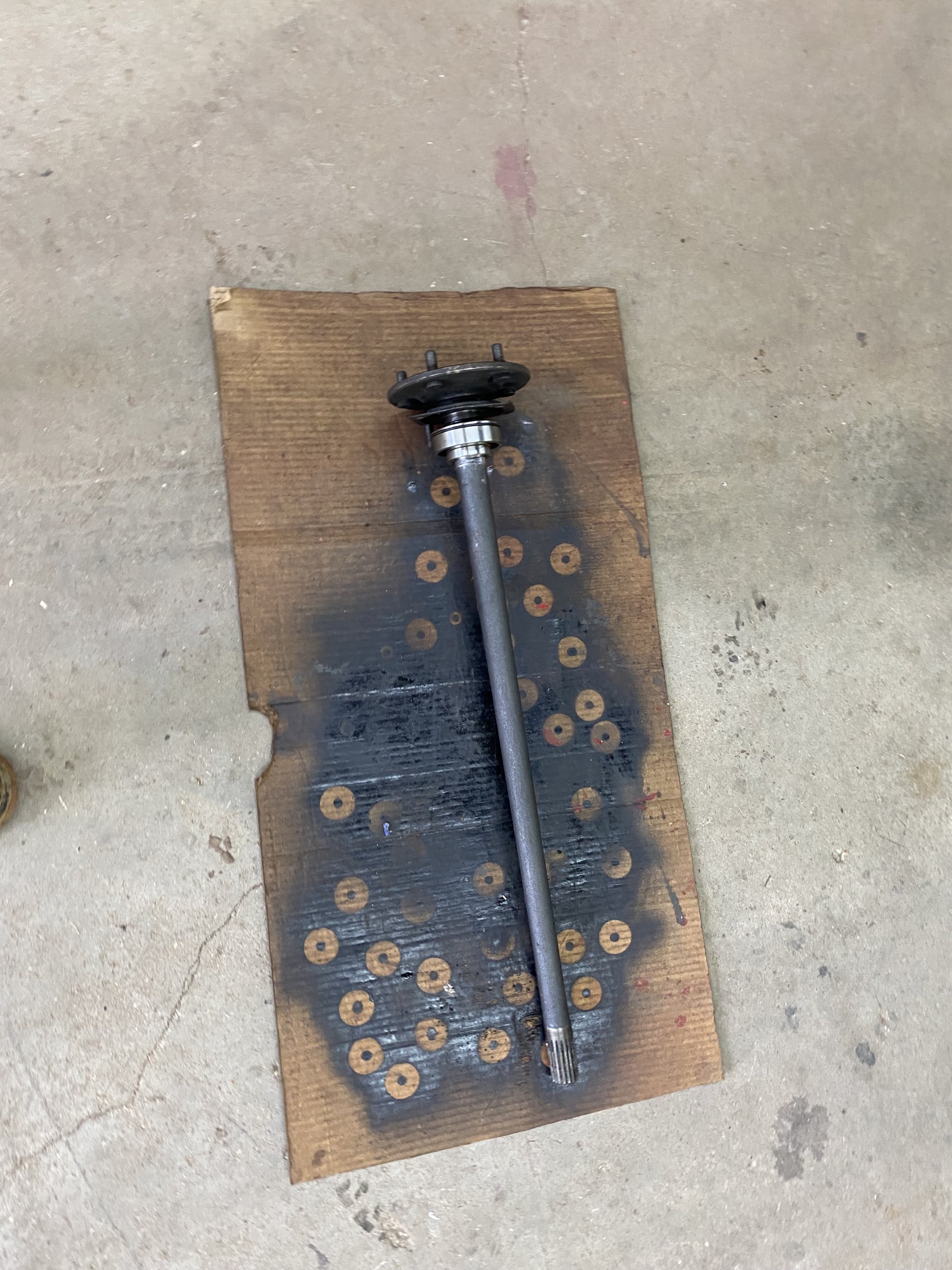

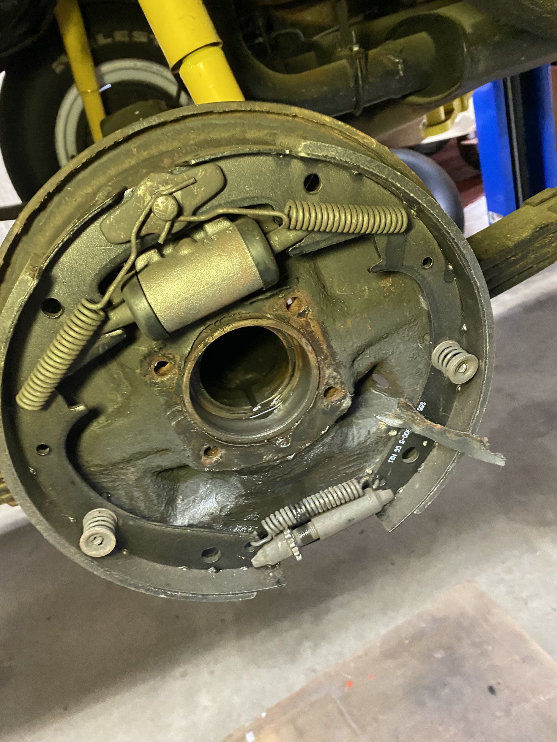

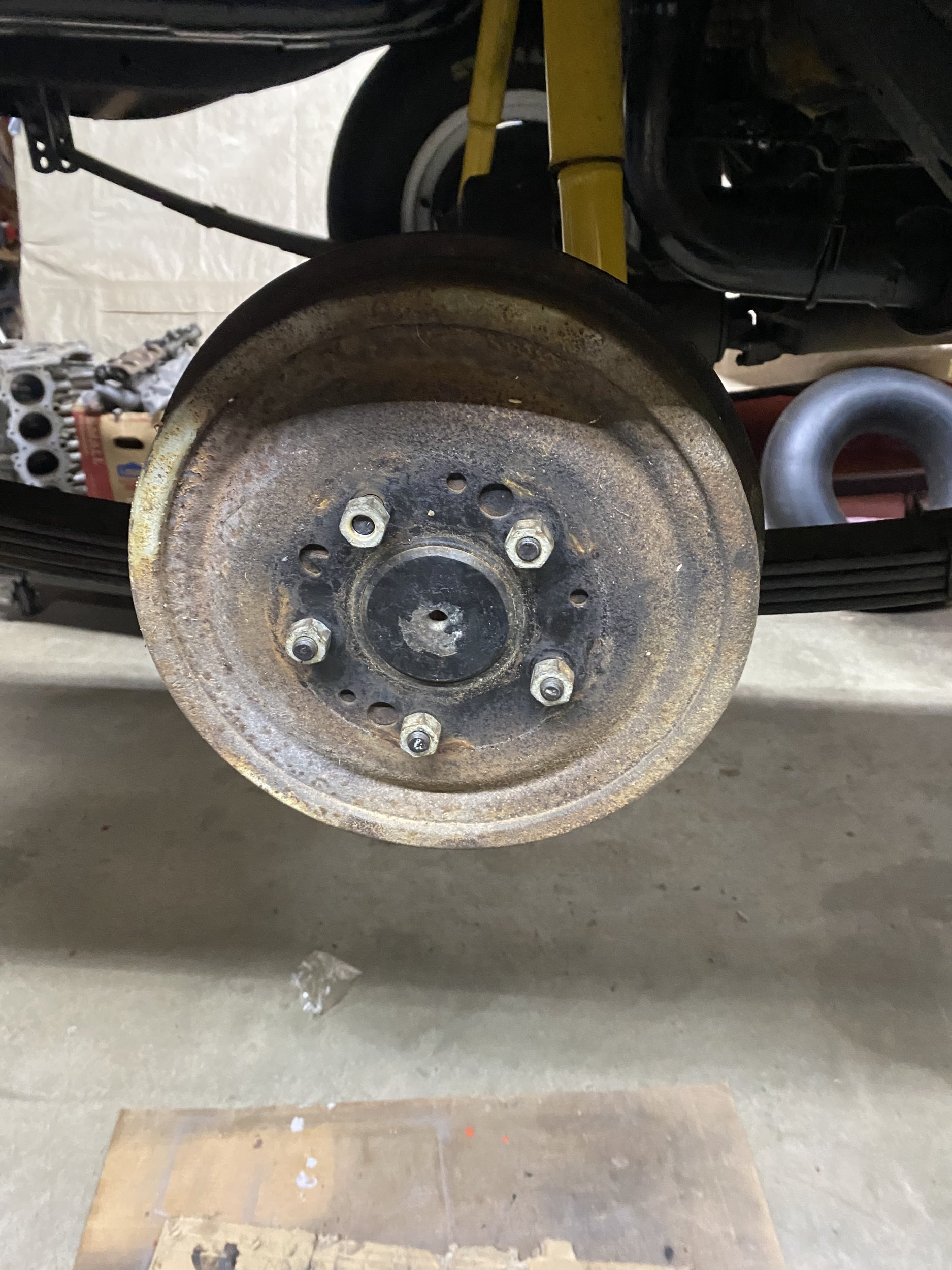

    Ok. Time to ask for help and info etc.
    right rear axle bearing started leaking.
    What is the go to rear axle bearing for my 57.
    For years I was always under the impression that Timkin. ( RW307R) was the go to bearing in just about anything. Ms Bearing Supply cannot get NOS bearings ( Timkin )for that number.
    Every article and thread I’ve read on the Hamb and tri five doesn’t speak well of the other bearings. So I need the next best option in bearings. Anyone got a confirmed bearing supplier that is a quality bearing with the right seal / and out side o ring.?
    Simply trying to cut to the chase and get the right /quality bearings.
    Thanks ahead of time.

    They're surprisingly expensive, but there's new/NOS Timkens on eBay you could get. For all the*****ing around it'll take to replace them, I personally wouldn't use anything else (unless New Departure made the same ones and I could find some NOS ones of those).
    I luckily have not had to pull my rearend bearings out. But I do know that the new replacement fronts they sell are ultra cheezy, the ball cages were plastic in the new ones. I ended up finding NOS GM replacement fronts.
    Thor1 likes this.

    I got NOS A2/A6 for the fronts when the disc brake kit came in. Didn’t even consider using what came with the kit.
    I have a set of PrecessionBearings coming. Supposedly USA made and all rubber seals. Guy wouldn’t let me pay until they are here and we can take them outa the box and inspect. These were from Oriellys. But I can’t fault him because he was /is willing to do this and it’s a special order according to them.
    Napa is SKF and it also has the plastic seal and for 175$ each no less
    summit listed for 87 $ each but you can see the plastic seals in the picture(Timkin ).
    So we will see.
    I think the 57 is telling me in a nice way it’s time for the qc to go in.
    Being fair this Rearend hasn’t been out of this car since 79. All I did was add /check grease and add some possi additive and put on brakes and wheel cylinders and go

    Ok from what I can tell this Rearend has never had axle bearings lol. The bearing had some slack but the seal wasn’t awful but it was full of sludge etc on the back side where the spring was.
    The New bearings are dimensionally the same but the seal arrangement is different.
    Put a cutting disk on 4 inch and cut the lock ring and the outter cage and the inner race. One lick with the hammer and done. Not a mark on the axle.
    Machine surfaces looked good. Cleaned up well. Pressed new bearing on. Then Lock ring. Then a a coat of RTV up to the seal lip on the out side.
    Insert. It dropped in to place and two good whacks with my bfh to make sure the O ring seated. RTVed a small tear at the top of the flange gasket and then tighten down and back together.
    May be a day or two before I get the other side. Got the bearing for the other side so even though the driver side isn’t leaking it can’t be far behind. IMG_4055.jpeg IMG_4053.jpeg IMG_4054.jpeg IMG_4056.jpeg

    Also got lucky with how it leaked in the drain area as it was designed. Didn’t grease the brake shoes.

    Ok. Made a decision to leave the driver side alone. No movement in the bearing and with the drum off it’s bone dry.
    The QC is going under it sooner than later. This will let me ride until that time. If all else fails I bought a pair of bearings I can always install it. Just don’t want to fix if it isn’t broke.
