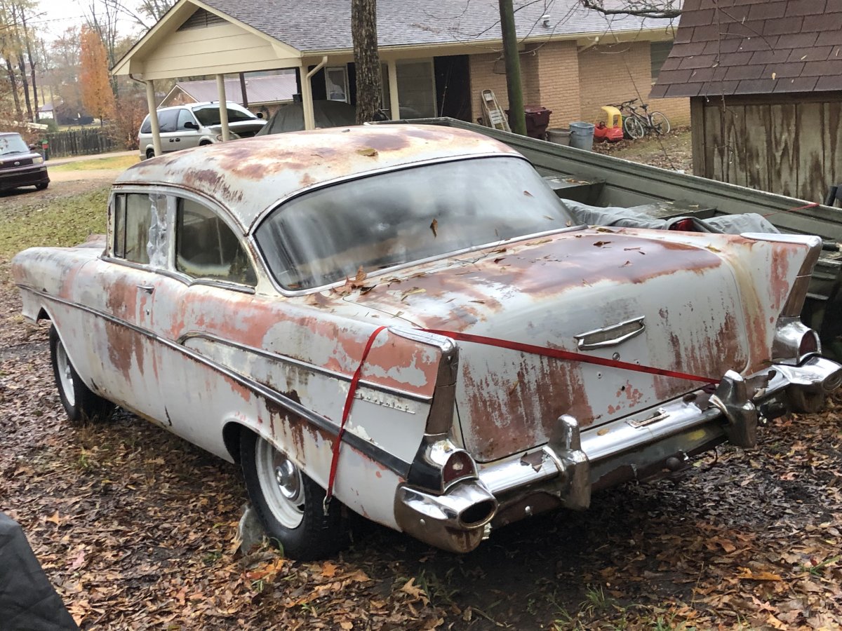

    Cool project Mitchell, keep us updated.
    Interesting rear bumperettes, are they stock?
  2. 56sedandelivery
    Joined: Nov 21, 2006
    Posts: 6,694
    56sedandelivery
    Those bumperettes look aftermarket, kinda J.C. Whitney-ish to me. I am Butch/56sedandelivery.

  3. Mitchell Rish
    Joined: Jun 10, 2007
    Posts: 2,335
    Mitchell Rish
    from Houston MS
    Don’t think so. I might even clean up the bumper /ball hitch and leave it. It’s been there a long time lol

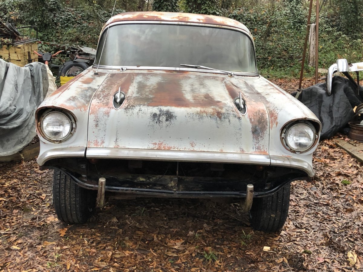

    I sure hope the headers fit. Man they have jumped in price. I can build but wow

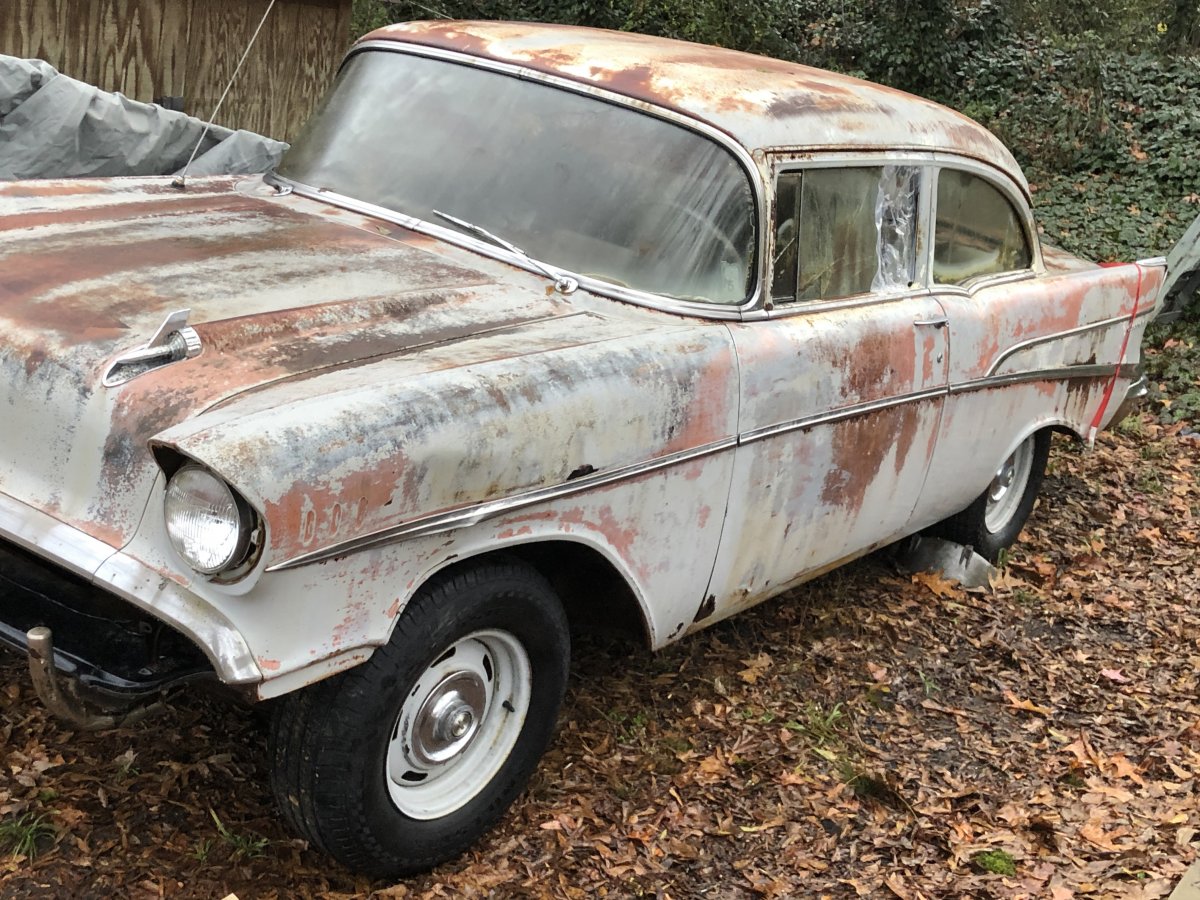

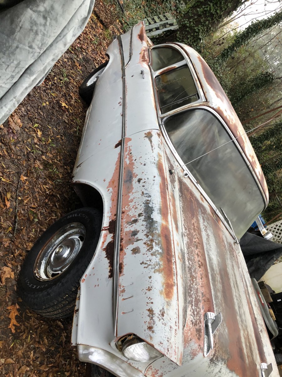

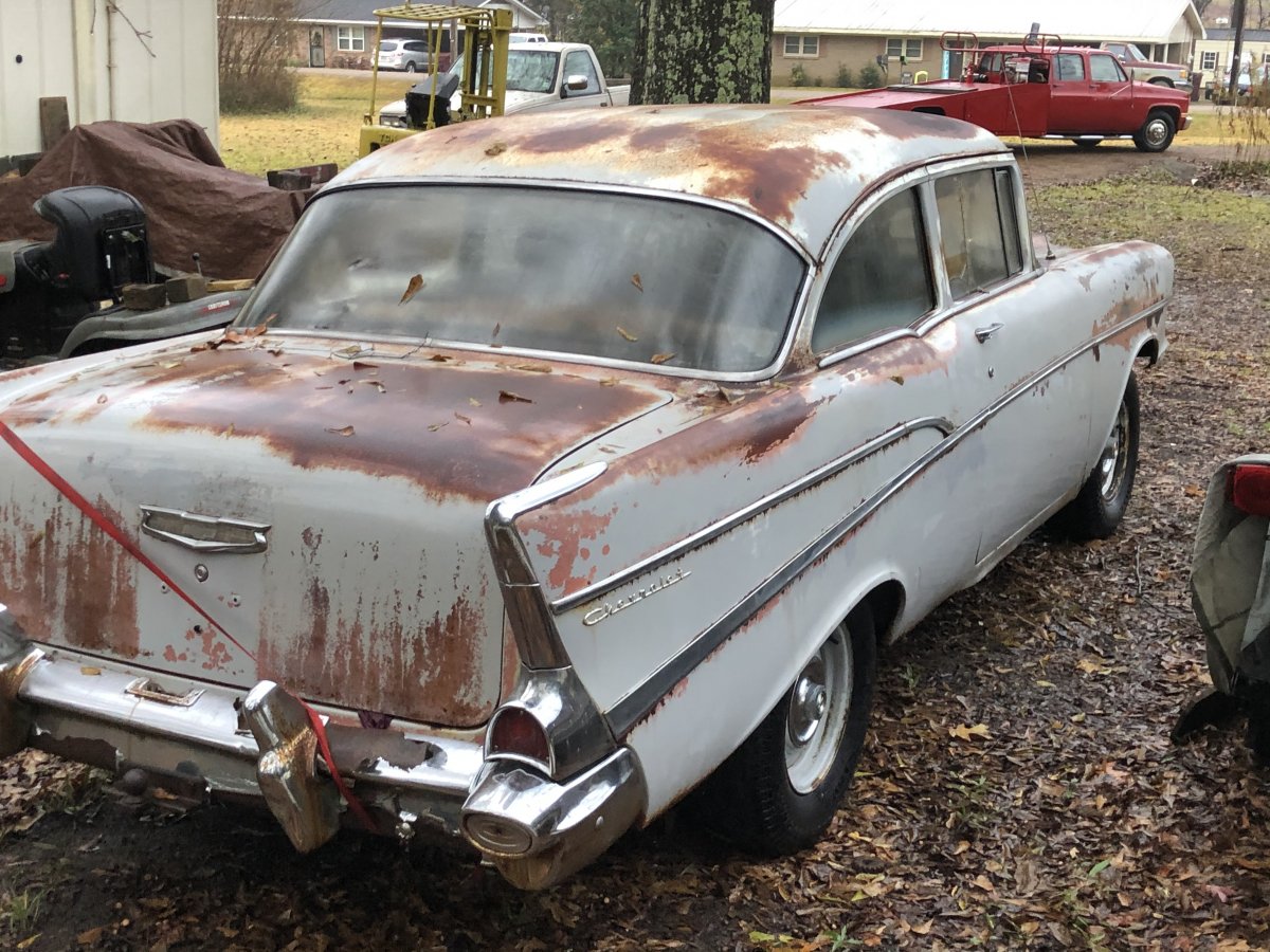

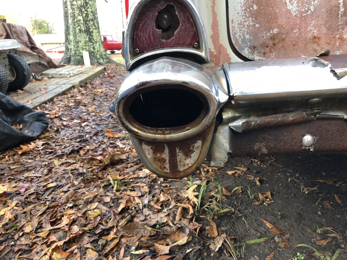

    Here ya go. Remember I have every piece of the front grill/bumper and grill bar. Lens’s are bad but hey they make new ones every day. Or even a good set of used. Also have headlight bezels.
    Now. Some questions.

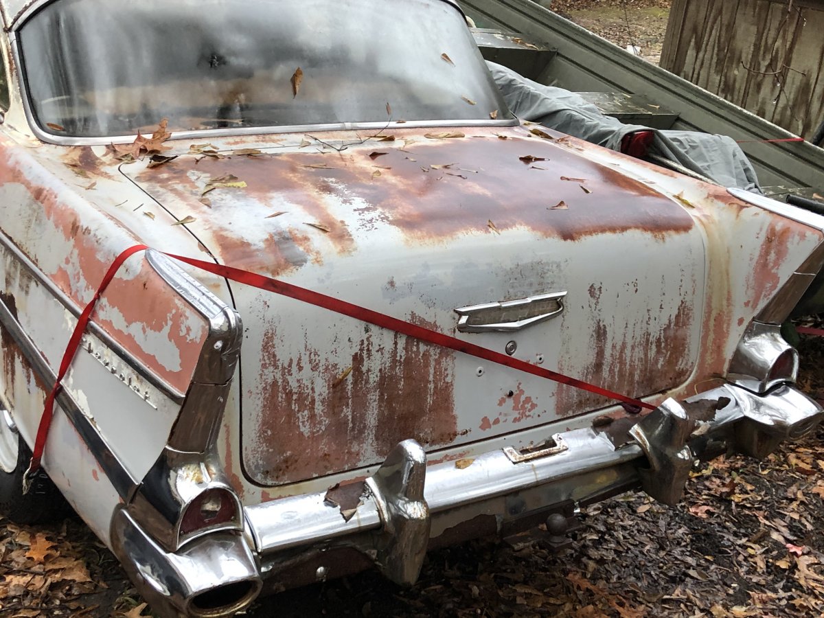

    1. What is the plate on the left side of the rear bumper. The oval hole. Where do I get one. Haven’t seen one by itself.
    2. Anyone got two used windows for a sedan door. I would rather have used because the others are aged but still in decent shape.
    3. Would you believe the windshield and rear windows are perfect.
    4.Who really has the best stuff for the 57 as in new if I have to do that route for the bent trim piece on the drivers fender.
    I really am trying to leave it as is guys. I know nobody believes I can. Lol

    This one ​

  9. 427 sleeper
    Joined: Mar 8, 2017
    Posts: 3,366
    427 sleeper
    That's where the reverse lights went. I think Danchuk and Ecklers have the delete plates for those holes. [emoji6]

  12. partssaloon
    Joined: Jan 28, 2009
    Posts: 794
    partssaloon
    Blank plate is just a filler plate, Bel Air's had the back-up lights there
  13. Squablow
    Joined: Apr 26, 2005
    Posts: 18,446
    Squablow
    I would call it a reverse light delete plate. Reverse lights were optional on all models, cars ordered without them just came with the little bullseye block off plate.
  14. chevy57dude
    Joined: Dec 10, 2007
    Posts: 9,617
    chevy57dude
    Get yourself a Danchuk catalog. Many USA made parts.
    ^ the plates
    And the lights.

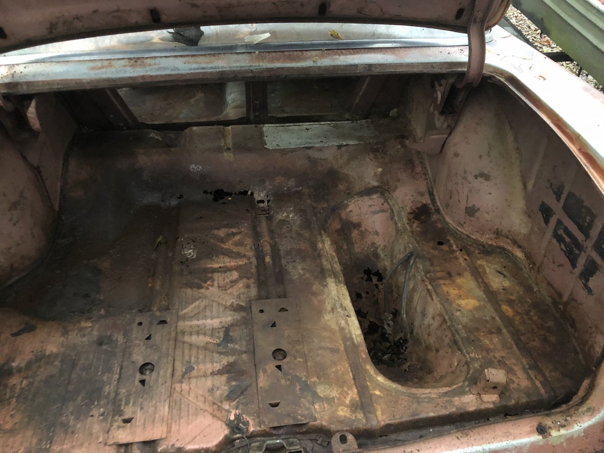

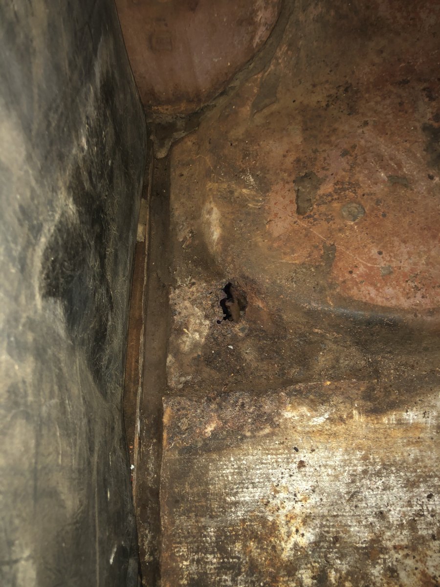

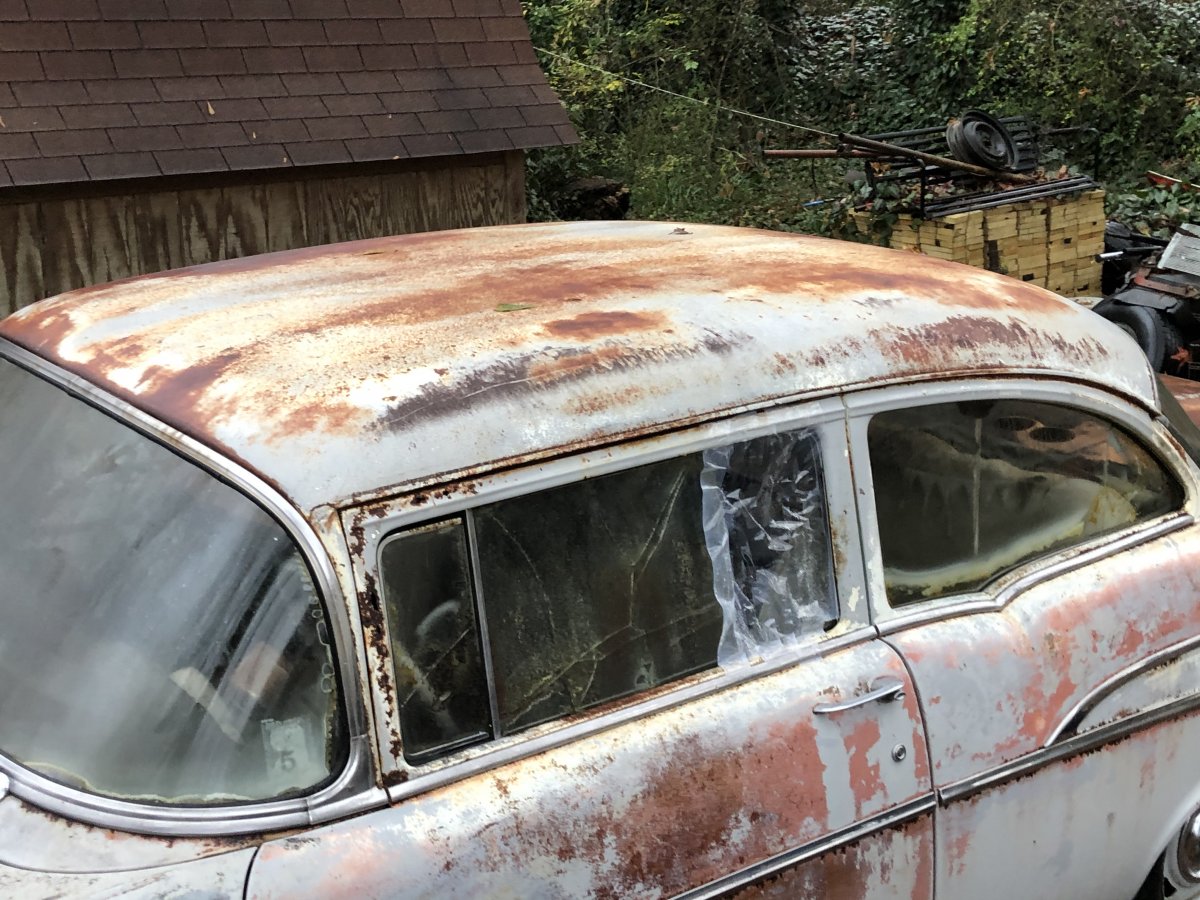

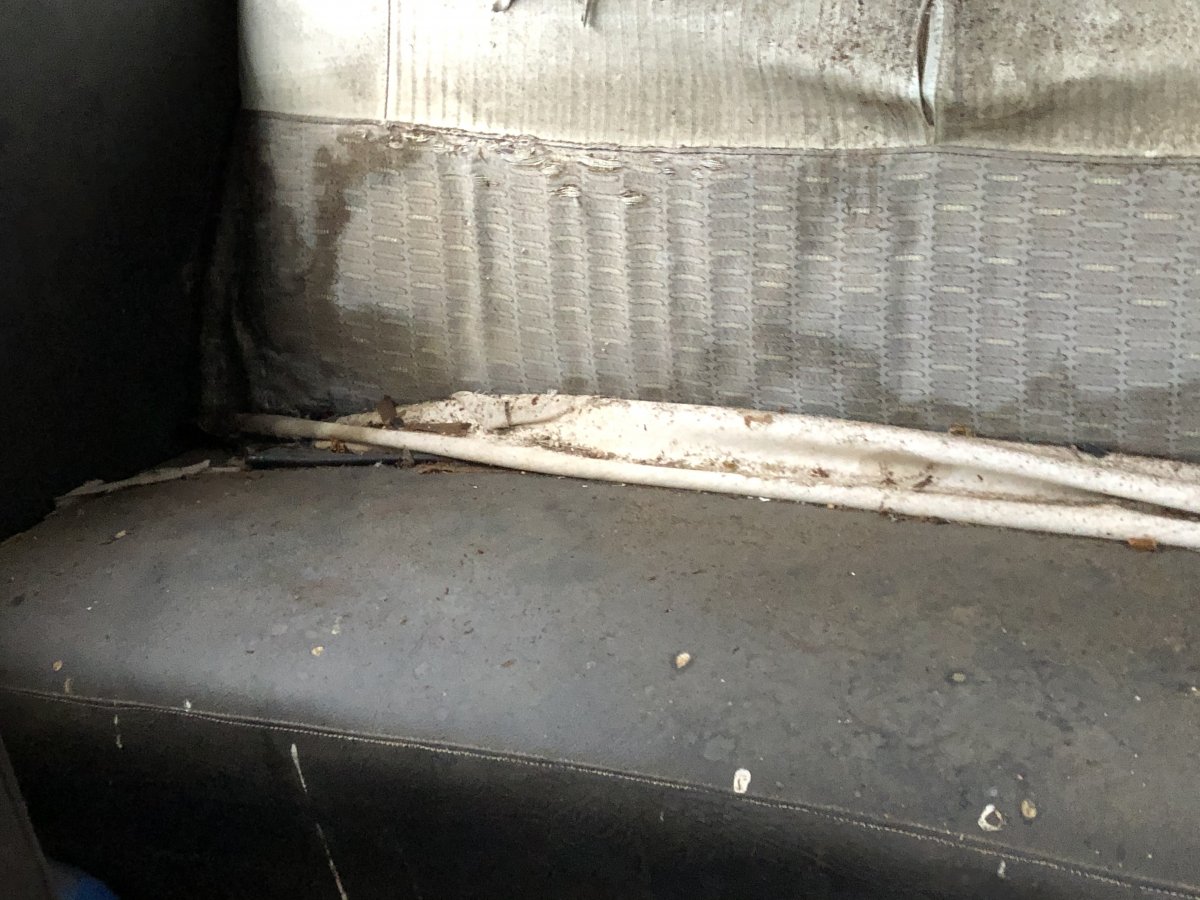

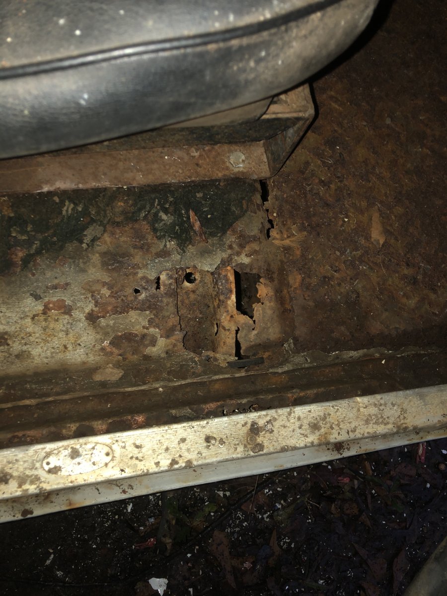

    Cleaned out the inside today. Found a few spots in the floor pan but for the most part none that will require a whole replacement. My normal test is a sharp punch and see if I can punch through with a good shot. And to drill in suspected areas to see if it actually is thick enough to weld and go from there. Wes used 1/8 diamond plate that was formed to the shape actually it is a good repair for the day. Can’t see it from the bottom.There was spot in the truck where Wesly had a trunk mounted battery. Will need some attention.I will Eliminate the spare tire dip all together. I think I will buy all four of the floor pans and do the partial. The two spots where it’s completely through Ill repair and but weld. I’ve never seen a tri five from our part of the world that didn’t rust in those two areas. Over all pretty solid for a car from this part of the world.
    1Nimrod, WC145, chryslerfan55 and 9 others like this.
  19. Mitchell Rish
    Posts: 2,335
    Mitchell Rish
    from Houston MS
    Also decided to eliminate the back seat all together. Like a business coupe. Bare and straight to the point. I kept the seats. But somebody needs the back one.
  20. Squablow
    Posts: 18,446
    Squablow
    Not bad at all, the inner rear wheel houses seem pretty intact, and that's a common spot for rot. By Wisconsin standards, that car is "almost rust free".
