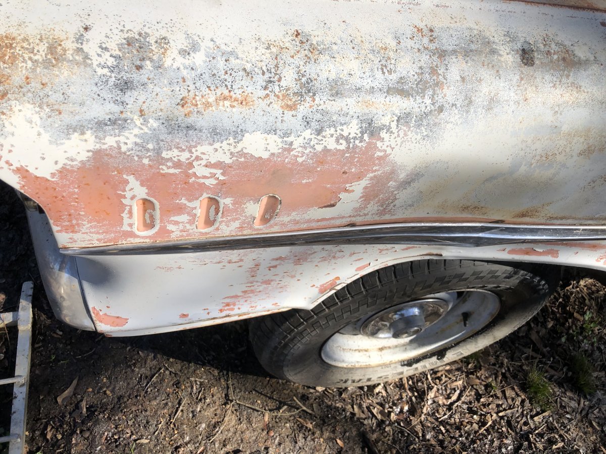

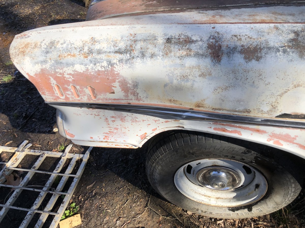

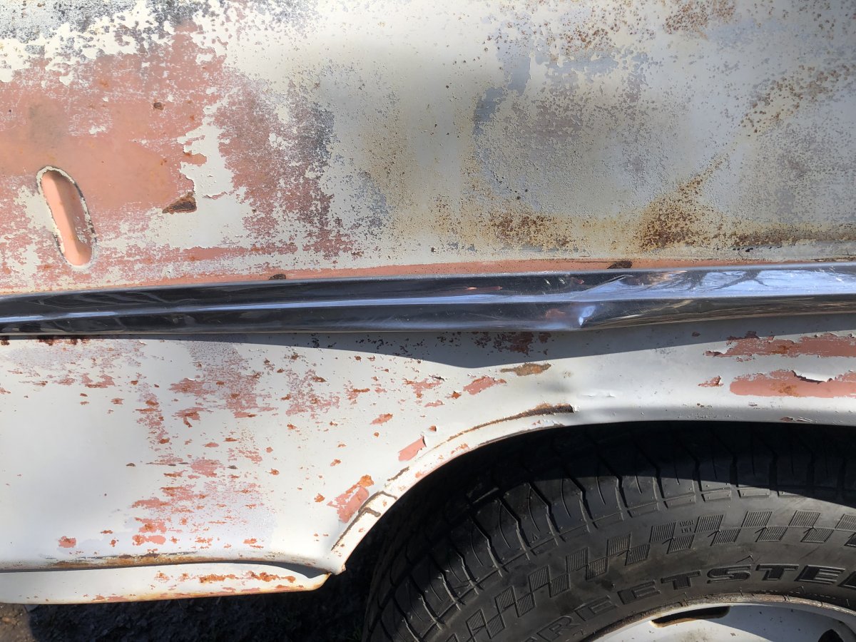

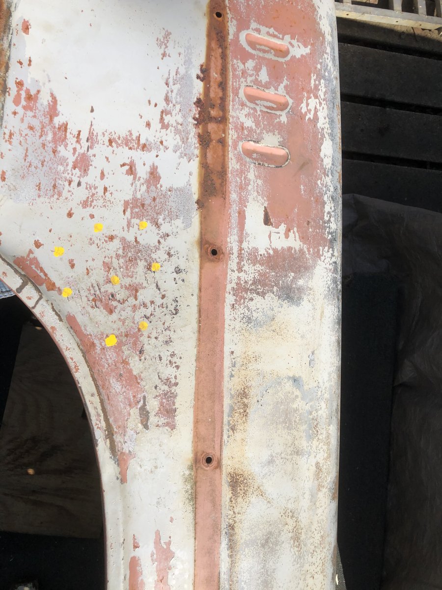

    Gonna look at that fender today. Wondering wether I should leave it on and attempt or take it off and use my plywood mat and try to gently walk it back out. I have no desire to paint /change anything on the car.
    I had not realized all the duct work under the fenders. Lots of bolts

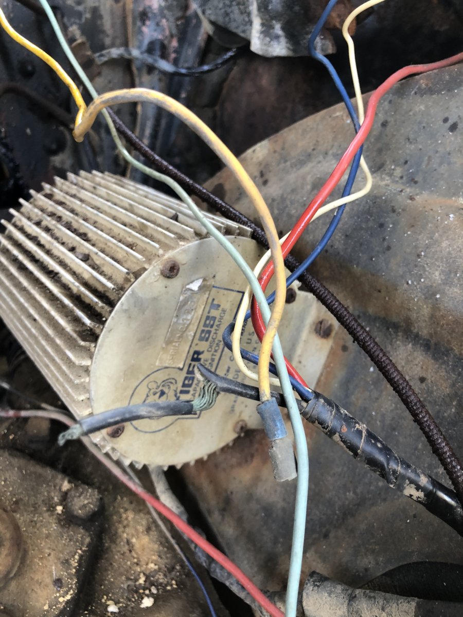

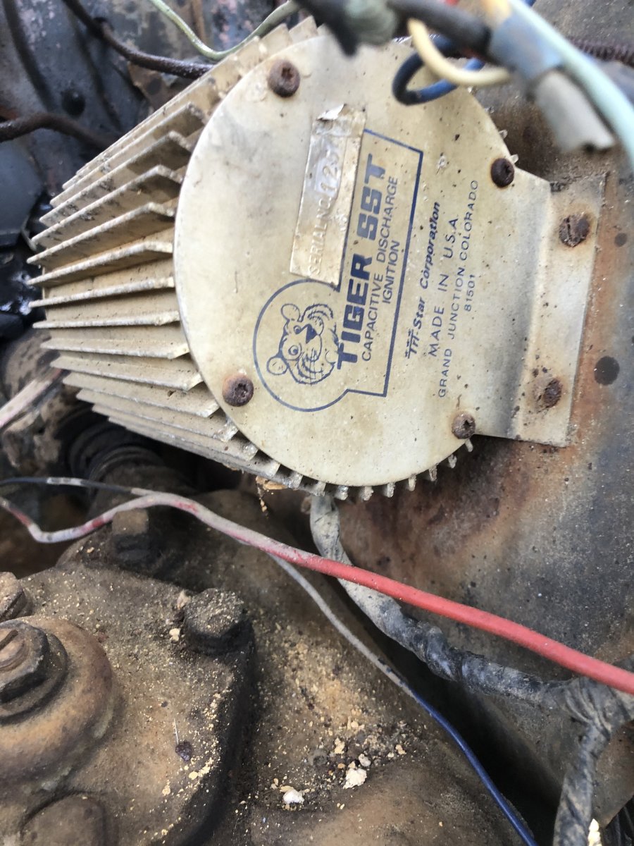

    Check out the ignition box. Think I m gonna leave it and even run a points distributor. Put a super coil on it and ride.

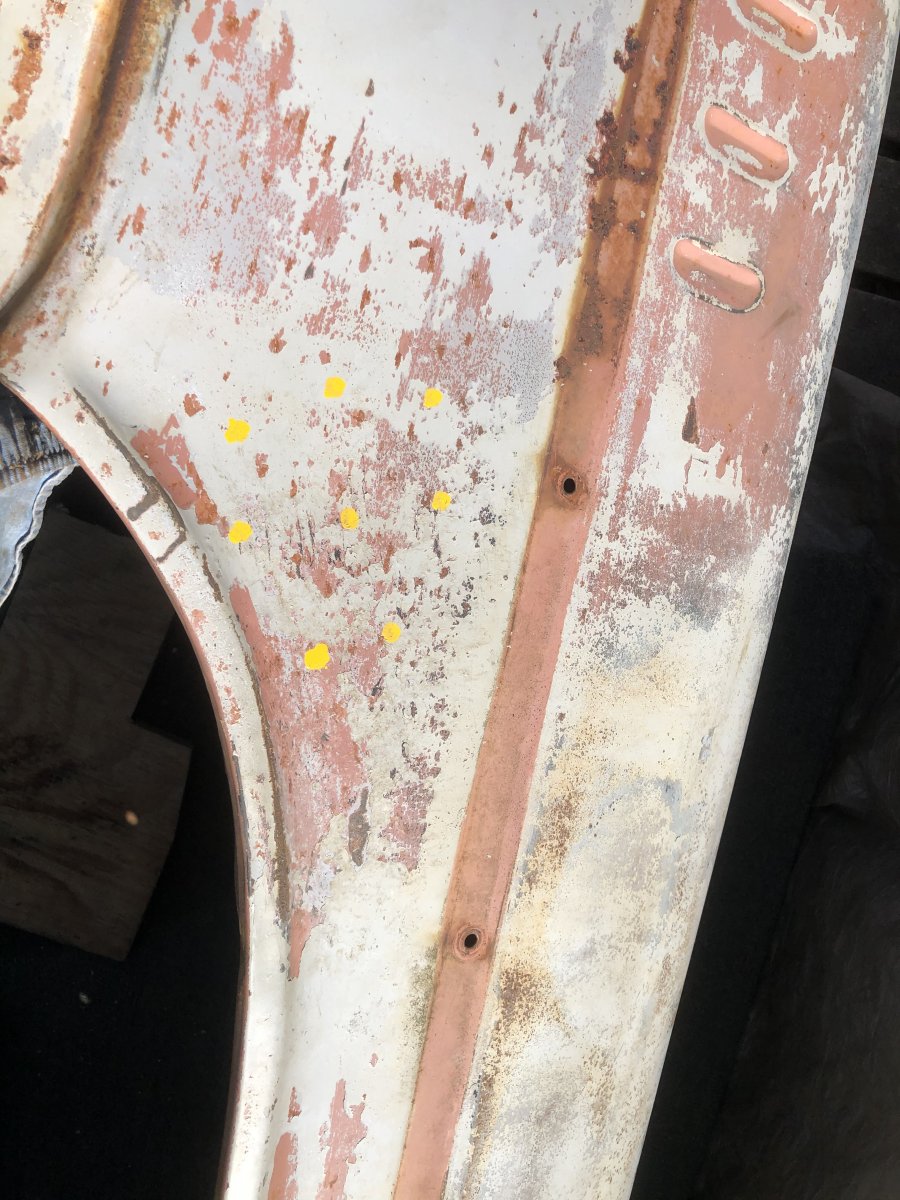

    Ok note to self. The idea of removing the fender quickly was a joke. 3 1/2 hours later its off. I got the air ducts off and now I can gently work it back as I Need(I hope). Beginning to see why fibergl***/ flip front caps were real popular-lol.

    Pretty close. Got a low spot/ I got about 2 hours of dolly workin it slow and easy .I’ll get my shrinking hammer out tomorrow. Headed to the other shop now.

    I would have been tempted to put some heavy gloves on, put both feet against the tire and just pull the wheel arch out, figuring the dent would push out once the arch was back in place. But your method looks like it's giving better results.
    Those front fenders have so much **** attached to them (even the front bumper brackets bolt directly to the fenders?!) I think buckling at the wheel arch is pretty common. The vent tubes don't do it any favors either. My '57 had a lot of similar issues, and not wanting to paint anything unless necessary presented some new challenges. Looks like you got the kink out without marring it up at all, that's a tough thing to do.

    I have a few dollies that I grind to fit the required shapes. I also have 3 wooden body hammers made from bodock and Walnut that are more forgiving. I also have several body hammers that are very old. Some are much older than me. Most came from pawn shops etc. I also have a Wooden Stump that has Astro turf on it. Can even grind the shape for the perfect dolly. If it gets to knarly I just burn it in the heater and get another.
