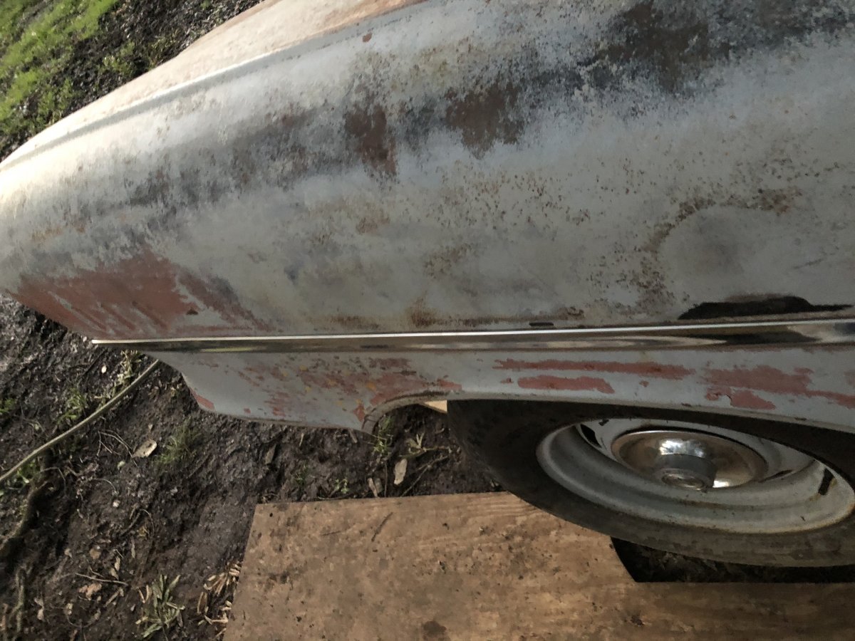

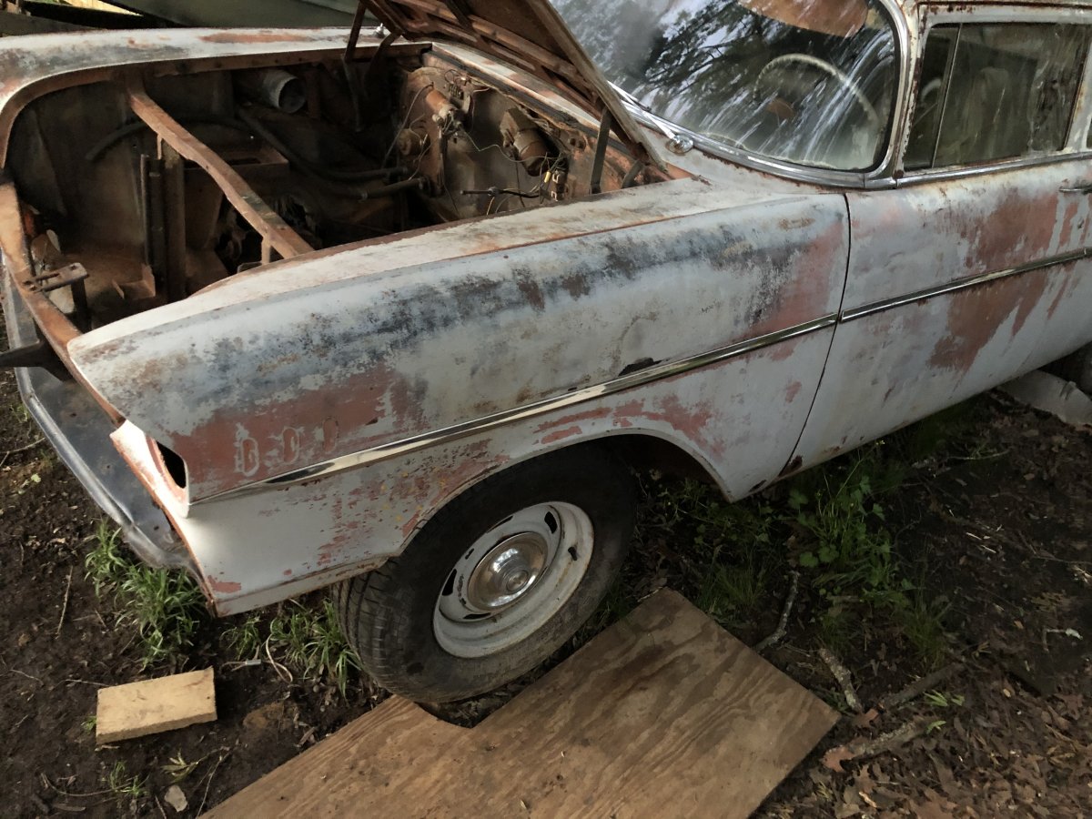

    Got the bottom bolt out of the fender that I broke off. Drilled a whole and tapped. Installed bolt and a lock nut and then backed it right out. Even saved the threads.
    I need to decide whether I am putting the air ducts back in. I truly wonder if it will make a difference. Man the 55 and 56 didn’t have all of this. The only 57 I’ve dealt with personally had a tilt front cap so I was actually shocked and how much was under /around the wheel wells.

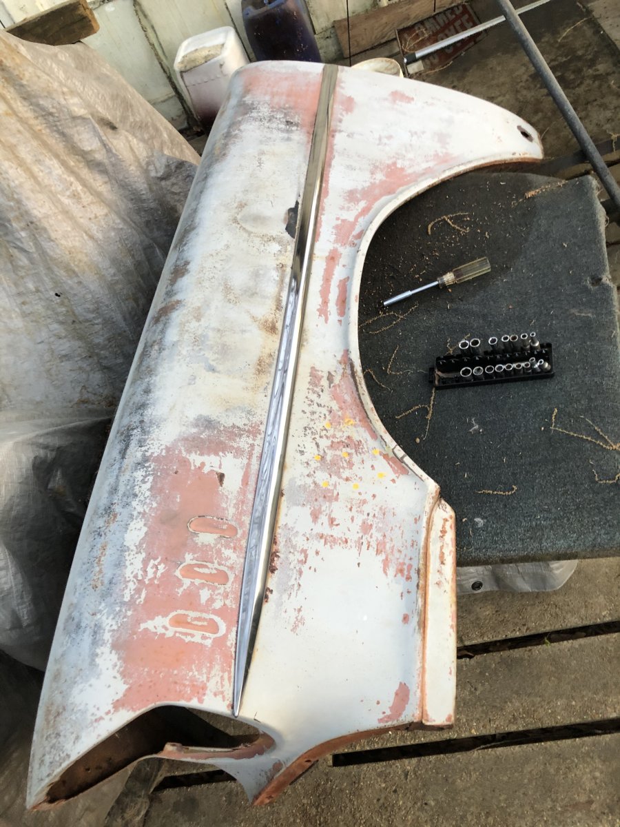

  7. Mitchell Rish
    Joined: Jun 10, 2007
    Posts: 2,335
    Mitchell Rish
    from Houston MS
    Trim back on fender. Looks pretty good. Gotta make a decision on wether to put the air ducts etc back in or block them off and install the support panels for headlights

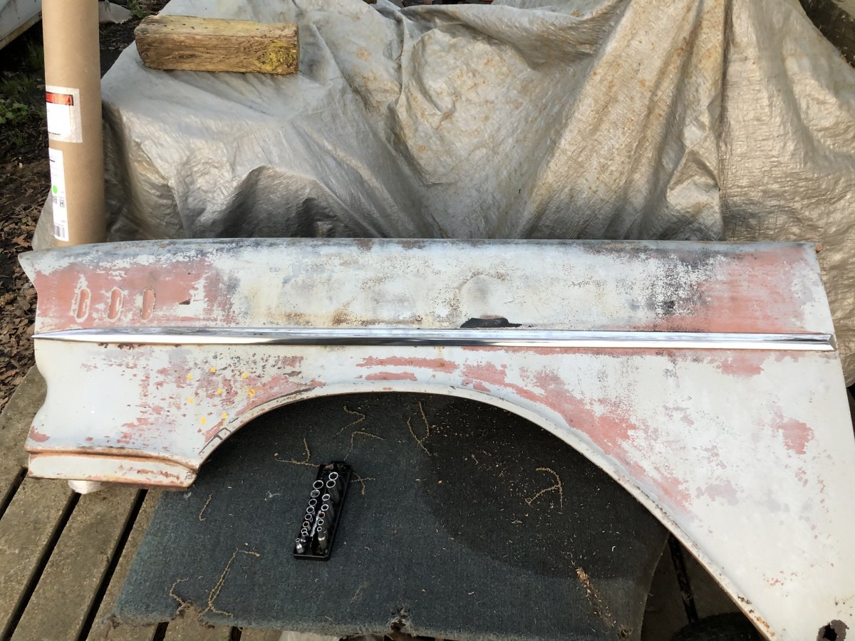

  8. Mitchell Rish
    Posts: 2,335
    Mitchell Rish
    from Houston MS
    Fender back on with the trim. Gonna be ok I think

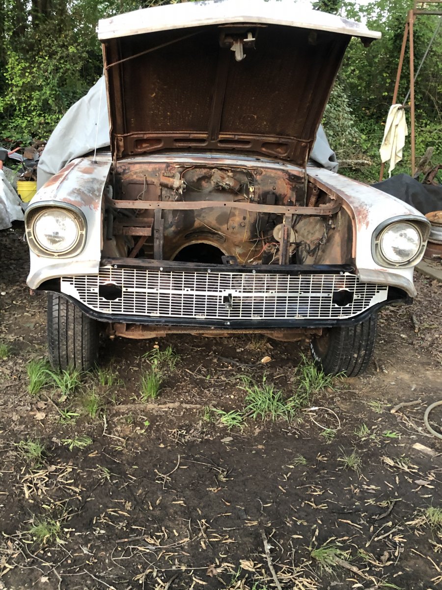

    Headlight bezels /grill insert and actually got all oxidation off the cross bar. Pits on the bottom are still there but if they can see them I have bigger concerns.
    CLR and a brass brush do wonders.
    Now if I can get the bumpers to duplicate lol

    Today’s work. I put the bumper and light bar /grill insert in today just to see how they would look.
    I have new lenses but I need to new pig tails for the sockets.
    I also need the following if anyone knows of these parts.
    The left front corner /driver side of the bumper is rust pitted badly. And so is the center section of the rear bumper.
    I need a used front corner part of the bumper and a center section of the rear bumper. I don’t want new and as a matter a fact that wouldn’t look right it would be out of place. Just not chrome peeling /or terrible rust pitted.
    I am leaning toward a early asphalt /stock car build. Six point style cage / widened stock wheels. 8 in maybe. And the rest be left alone. I won’t say black widow style but kinda. Just a 210 instead of 150.

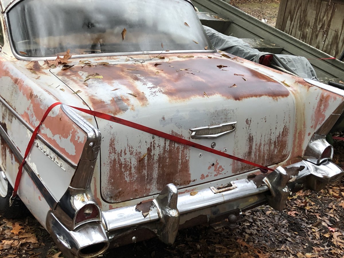

  14. Squablow
    Joined: Apr 26, 2005
    Posts: 18,446
    Squablow

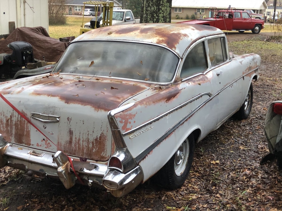

    How bad is your current rear center section? Got a pic of it? I have one left over from my '57 (ended up swapping to a wagon center) and it's got some old stickers on it that are neat, chrome has pits but isn't peeled off, I'd let it go pretty cheap and it might match perfect.
  15. Mitchell Rish
    Posts: 2,335
    Mitchell Rish
    from Houston MS
    Mine is horrible . Structurally its not bad. but when I say its literally coming off in sheets .Let me see if I have a pic I can post.

  16. Mitchell Rish
    Posts: 2,335
    Mitchell Rish
    from Houston MS
    enloe, 1Nimrod, AHotRod and 6 others like this.
  17. Mitchell Rish
    Posts: 2,335
    Mitchell Rish
    from Houston MS
    I can buff the ends. I have been using CLR and brass brush/scotch brite. Then polish /buff. Not perfect. But acceptable. The rear center and the front corner are pretty bad. As pointed out earlier I think the rear guards are some type of aftermarket deal. Jc Whitney or something.

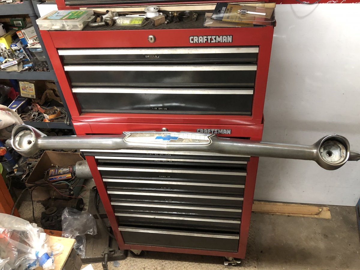

    chryslerfan55, loudbang and Thor1 like this.

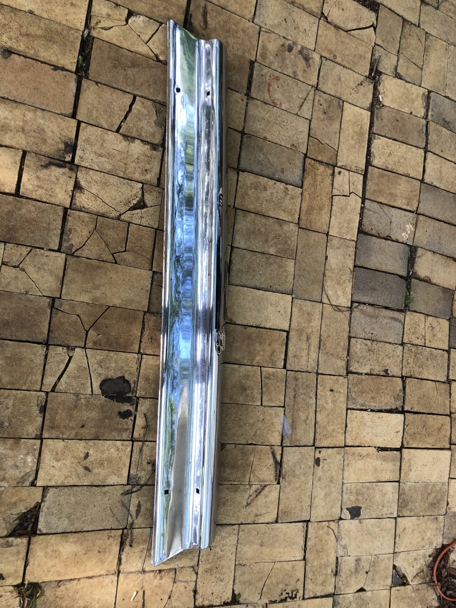

  18. Squablow
    Posts: 18,446
    Squablow
    I think I have the perfect rear bumper for you. I'll dig it out and post some pics. It'll be cheap.

    I have seen both with and with out. And those are leaving lol. They are pretty rashes up. Get a load of that trailer hitch. And they drilled right into that pretty chrome. Lol. No hurry I still have floor pans to do but just getting everything back together is pretty fun right now.
    I never saw it as a kid with the front bumper on it.

  20. Squablow
    Posts: 18,446
    Squablow
    Here's what I've got. Definitely shows some fine pitting and wear but not peeled anywhere, and very straight. Has a sweet old Cal Custom sticker on it, and the remains of a Gabriel Hi-Jackers sticker on the other side. The license light bezel is*****ty but that's removable, it does have a nice lens though. $40 plus the ride if you're interested. No rush on paying for it/shipping it, but let me know if you want it.
    I bet someone on eBay would buy those old rear guards as cores to rechrome, that accessory***** is really popular in some circles. I wouldn't throw them out. That hitch on the other hand, I think that could go....

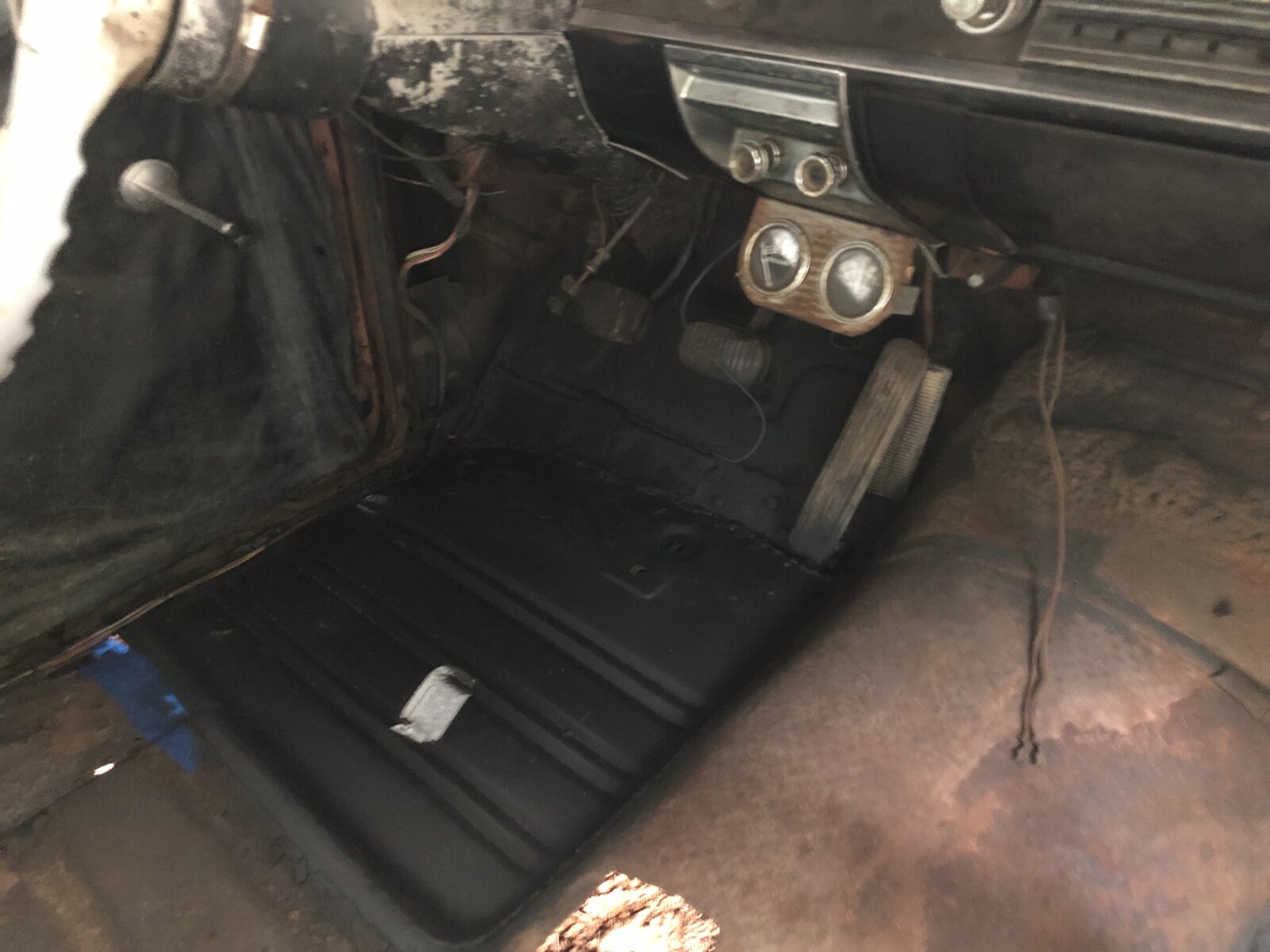

  26. Mitchell Rish
    Posts: 2,335
    Mitchell Rish
    from Houston MS

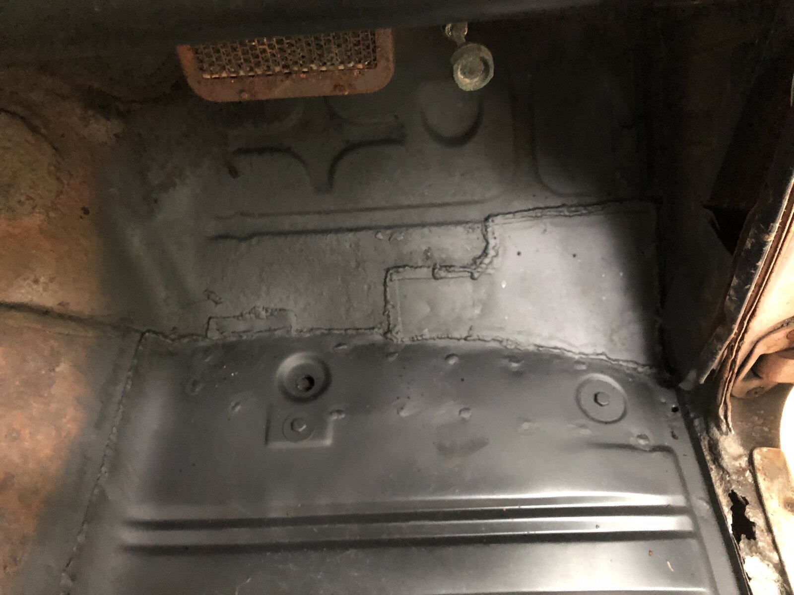

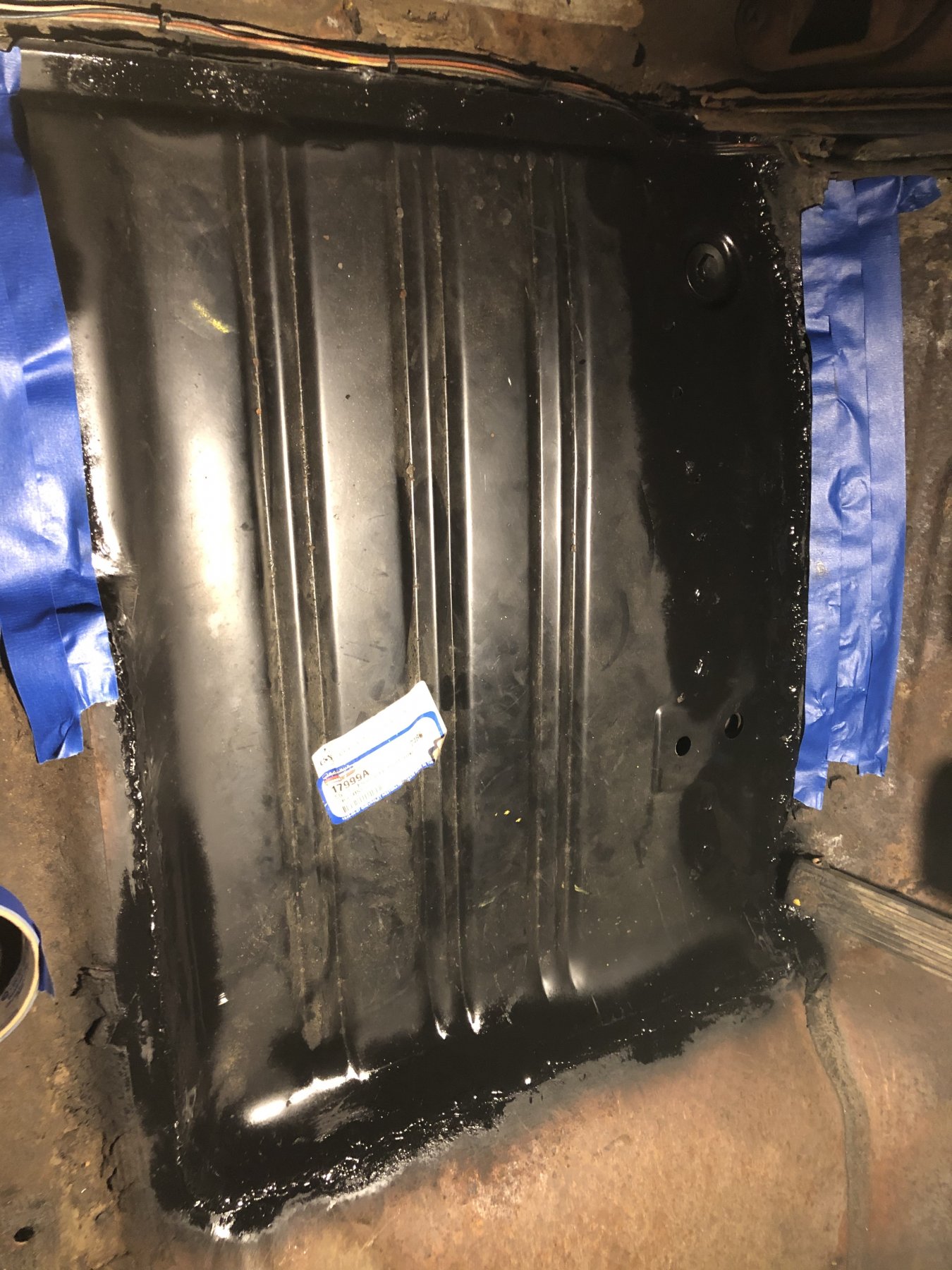

    Driver side floor pan in. I took my flanger/hole puncher and made a male female receiving groove /spot welded to position. Then***** welded and the laid another on top of that. Put some cheap paint on it to keep it sealed but am going to grind the welds down flush. I did the spot welds on the support brace also. But it as good as it was in 57. Even looks correct for the most part. Lol

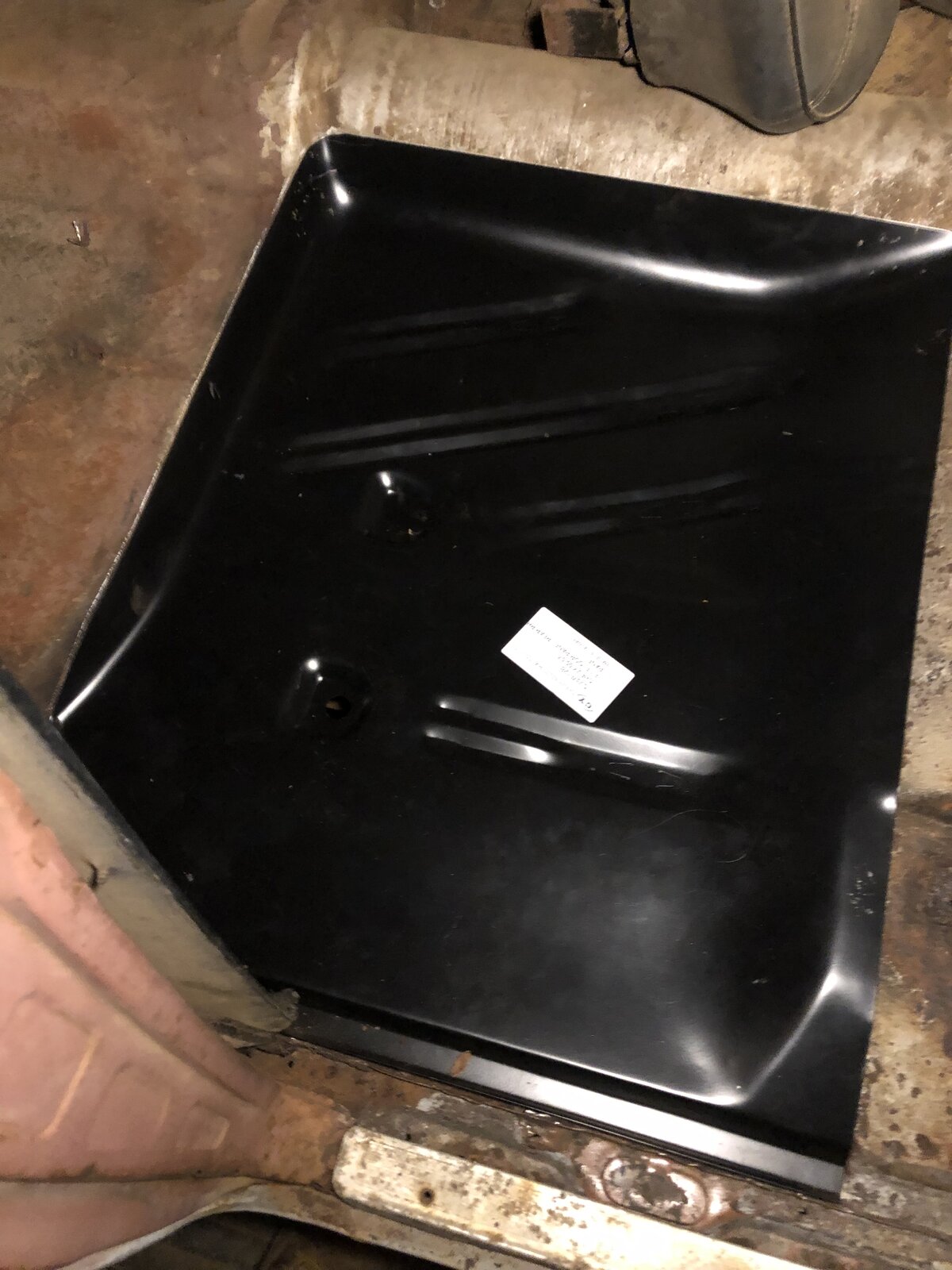

  27. Mitchell Rish
    Posts: 2,335
    Mitchell Rish
    from Houston MS
    Got toe board patches done. There were a couple of places didn’t warrant an total panel but were weak. I flange lipped the patch cut the weak area and welded it in. I dressed the welds down but I have always been cautious about over doing or under cutting the weld itself. I am going to us either good old fashion rustoleum or the bed-liner like coating I used in the Willy’s and am going to use in the Prefect.( inside and underside ) I can get it any color. The interior color was black kinda and it’s still up in the air about what the headliner /sail panel/side/door panels will be. I don’t like carpet /love a factory rubber floor mat look. This car will be driven not abused but driven. I will fix what is needed to be functional/the rest I have no intention of messing with.

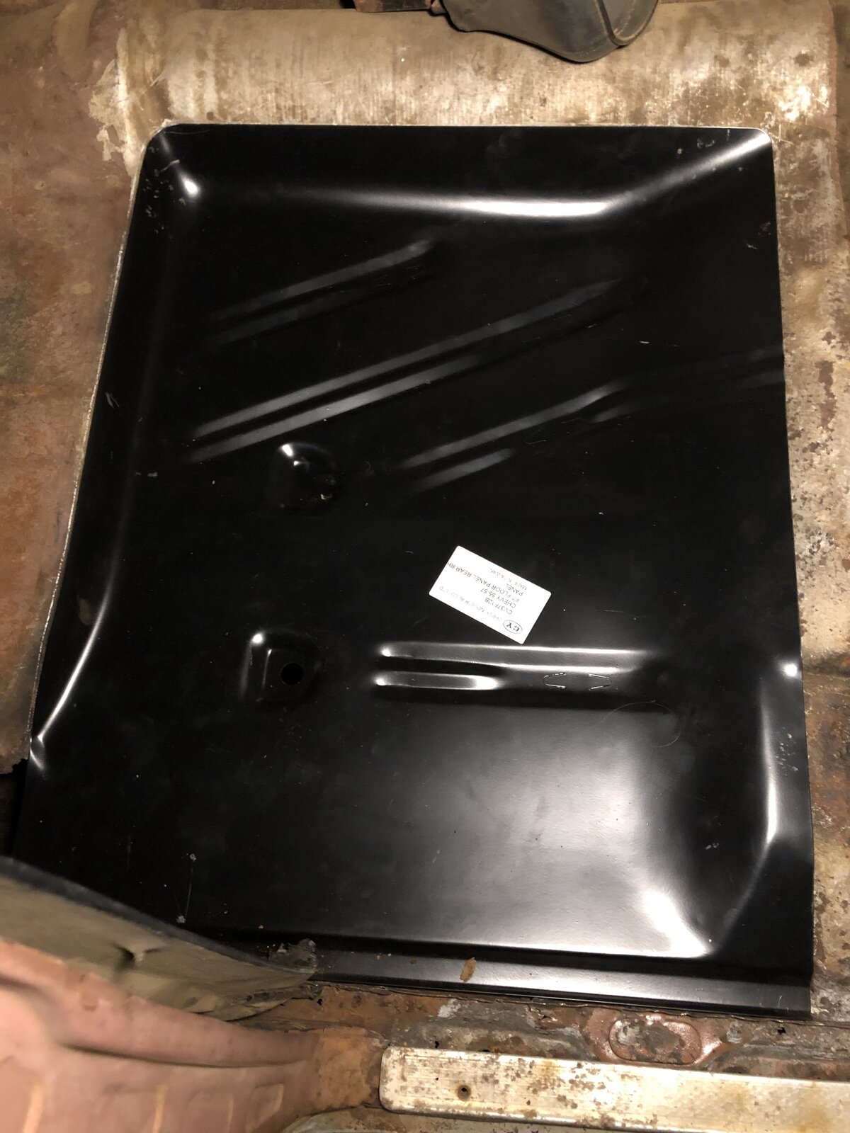

  28. Mitchell Rish
    Posts: 2,335
    Mitchell Rish
    from Houston MS
    Passenger rear floor pan is fitted. Can’t say that I’ve ever had one fit this good before. Will trim parent metal and female/male flange and back off edge a quarter inch weld and seal.
