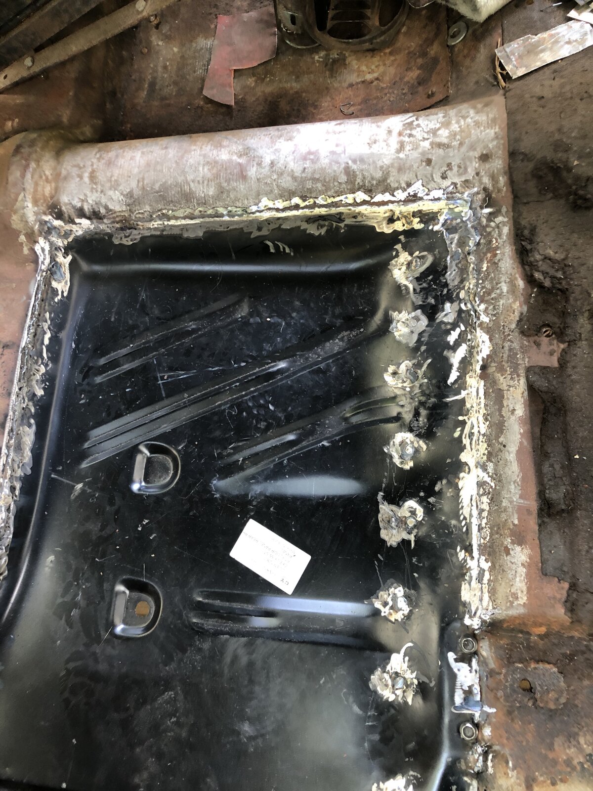

    Got pass/rear floor pan burned in. Need to do a little more clean up and get it ready for paint and coating. Like to have never gotten it clean enough to weld. There was some /what I thought was silver paint under the first patching between the original parent metal. Text and asked the original owner. He used silver seal as in roof sealer for Mobile homes and campers. Two things to say. Number one it doesn’t come off easy. Number two what ever it coats doesn’t rust. Makes you wonder if we are not over thinking this floor /under costing question sometimes. I know a situation where it was used to seal a boat as a kid. That boat still exist. It was put in in 78. Note to self

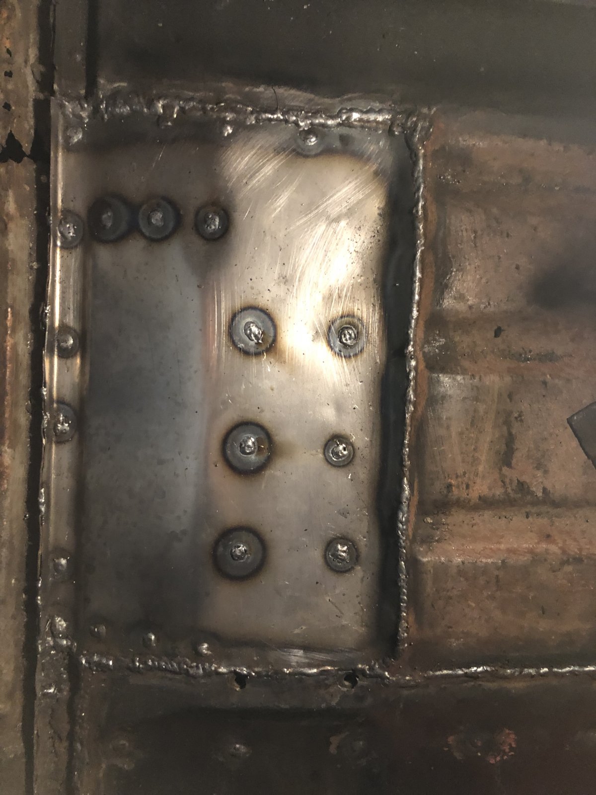

    I did a receiver lip /flange.I turned the welder up and let it burn in. I drilled holes into bottom brace and welded into it like the factory. Think mine are a little bigger but I didn’t want it breaking loose.

    A quick check. It’s made of asphalt and aluminum.wow that explains it.

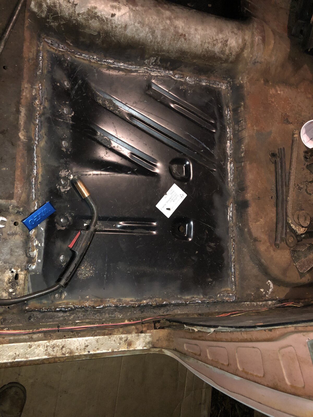

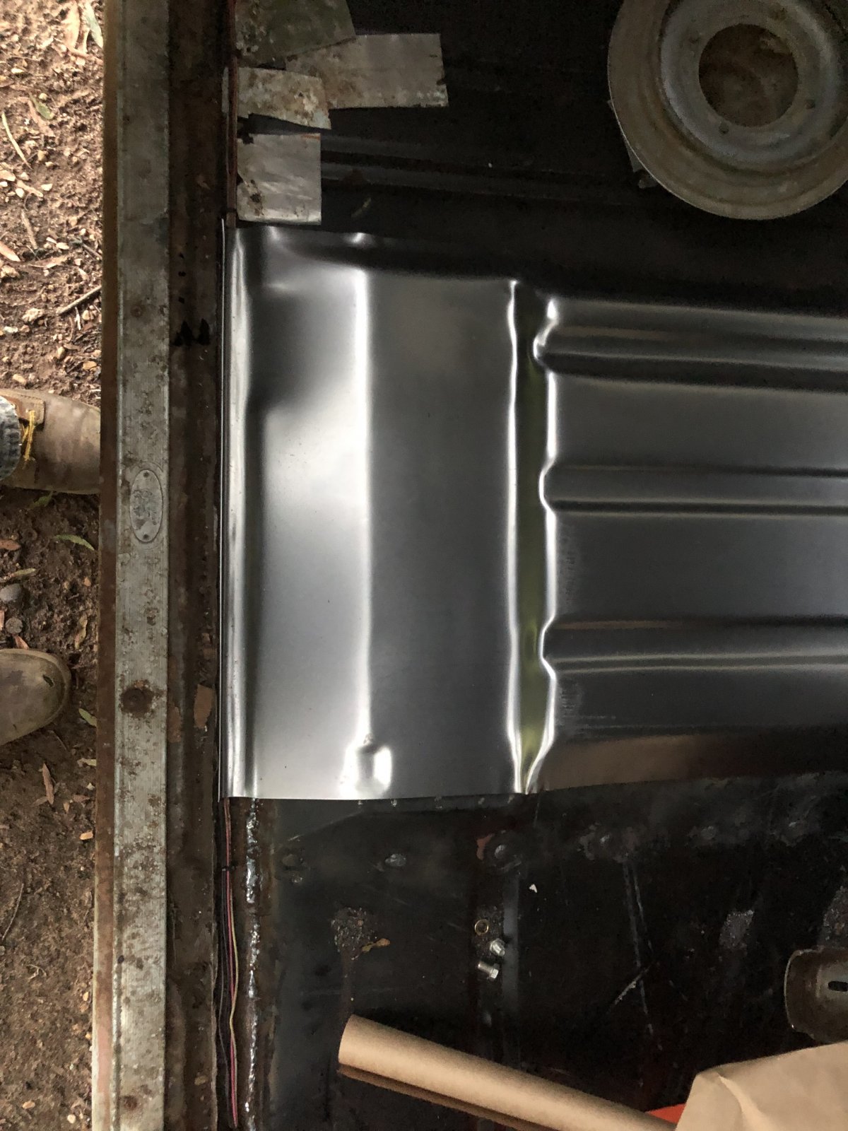

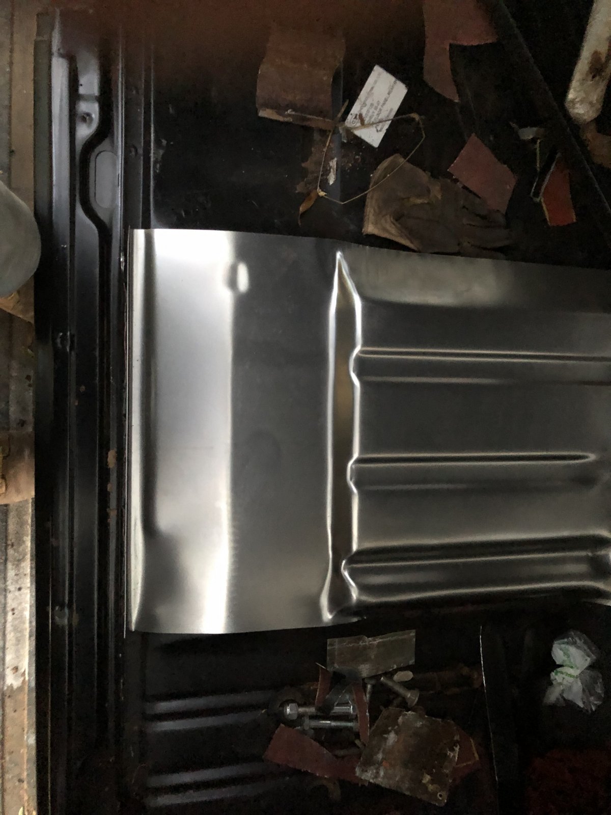

    Last pan in. I haven’t ground down/cleaned up the welds. It’s 1:45 this morning. Going to shower and sleep.
    I have the side panels next to the seat and a small section behind the rear seat mounts. I am swapping back over to the Willy’s /and Prefect tomorrow. Hoping to get short block and heads ready.

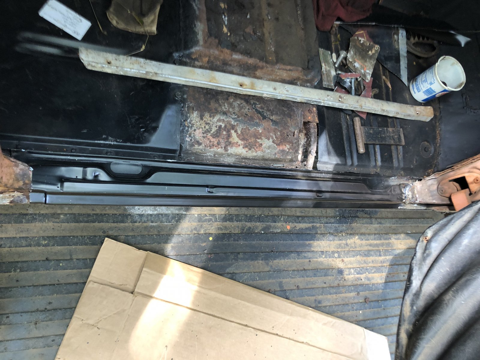

  5. Mitchell Rish
    Joined: Jun 10, 2007
    Posts: 2,335
    Mitchell Rish
    from Houston MS

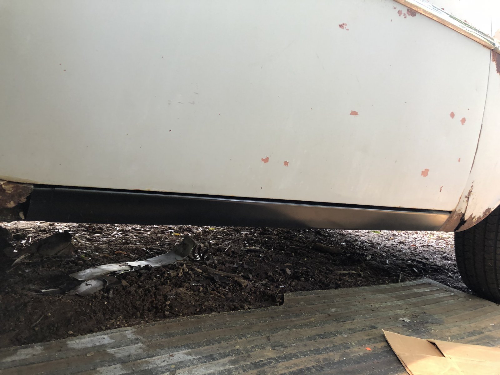

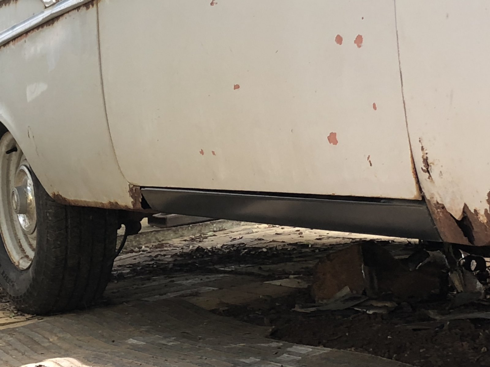

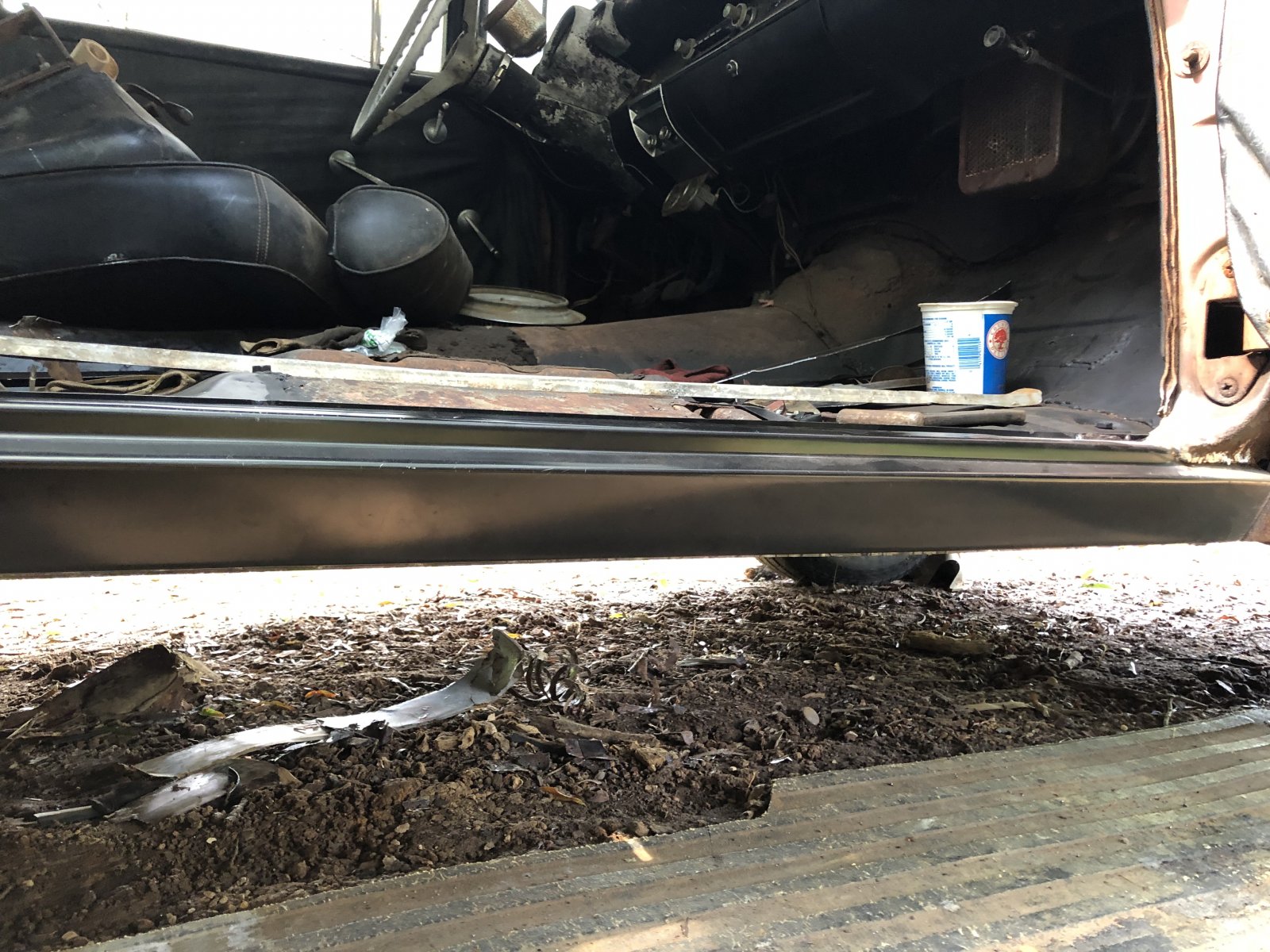

    Passenger rocker is in. Seat side panels are next.
    enloe, 1Nimrod, chryslerfan55 and 8 others like this.

    Beside the seat replacement panels came in this morning. They beat rust, but I’ve seen better fitting panels. I am only going to use half of them but wow..

  7. Squablow
    Joined: Apr 26, 2005
    Posts: 18,446
    Squablow
    I ended up making pieces to fix the seat bracket areas on my '57, luckily they weren't completely gone yet. Those aftermarket panels are a starting point but not very accurate. Rockers look good though.

    The part closest to the door and the rocker trench are the only things I need. The top and tunnel will get cut off-I’ll use these as a patch***** welded. I had gotten spoiled with the floor pans. They were literally drop in measure surface prep and weld.
    No big deal if it was a track/race car only as I usually do all that would be history anyway. Lol

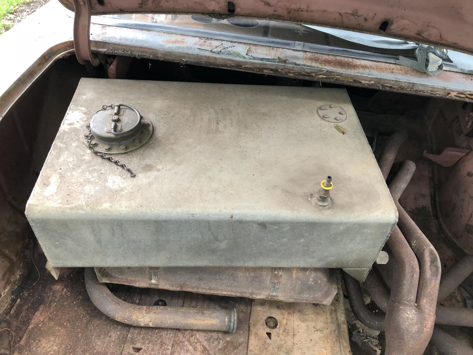

    Oh yea look what Wes brought to me yesterday. Yep it’s gonna get used. It’s got sensor bung/ nd I can get the bolt in filler neck. I’ll do a half submerged half above mounting door and lip. Plus I hate the spare tire sump.

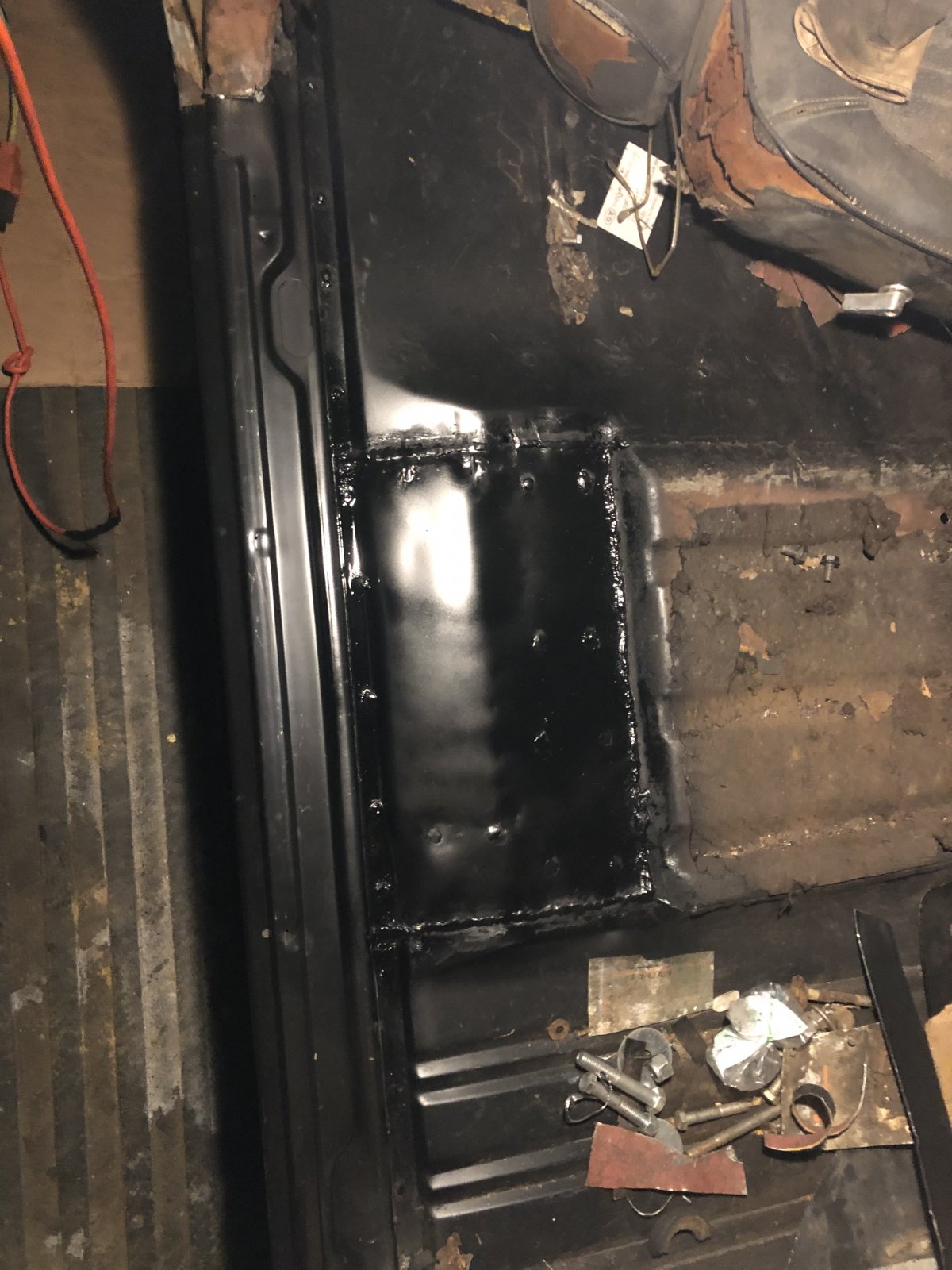

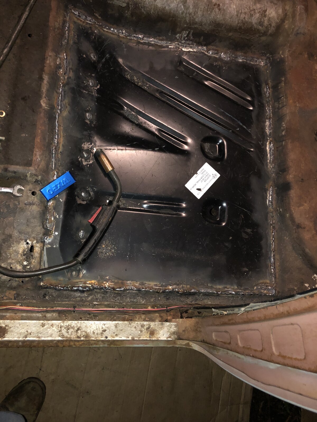

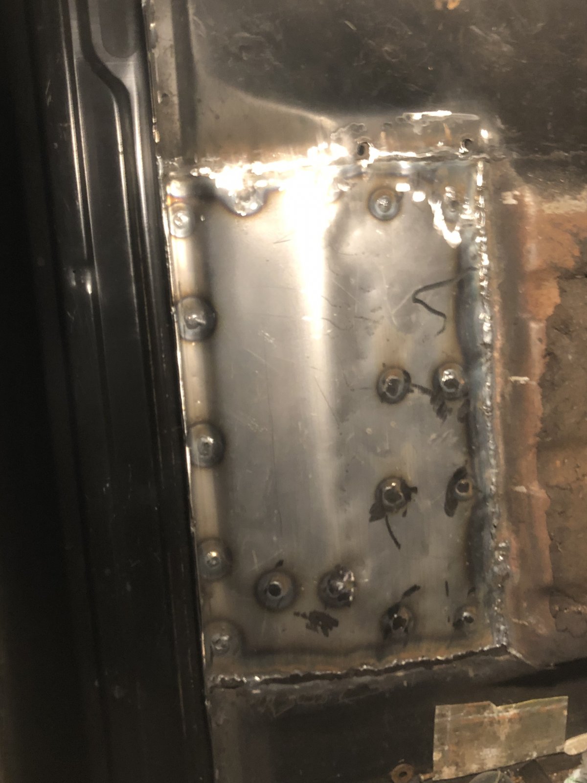

    Passenger side seat to door floor panel is in. Sorry about the photos. It’s dark outside and I also need to clean up Grind the welds some more. I put a quick coat of epoxy primer on it to protect from moisture. Suppose to get rain this weekend.

    Last floor pan beside the seat driver side is in. Need to grind and clean up a few welds and give it some epoxy black , but the floor pans are in a ready for the final coating. Got some lower front rear quarter edge (pass side) damage / rust to tend to. Then go to the trunk to set up the floor /ditch the spare tire sump and mount the fuel tank.

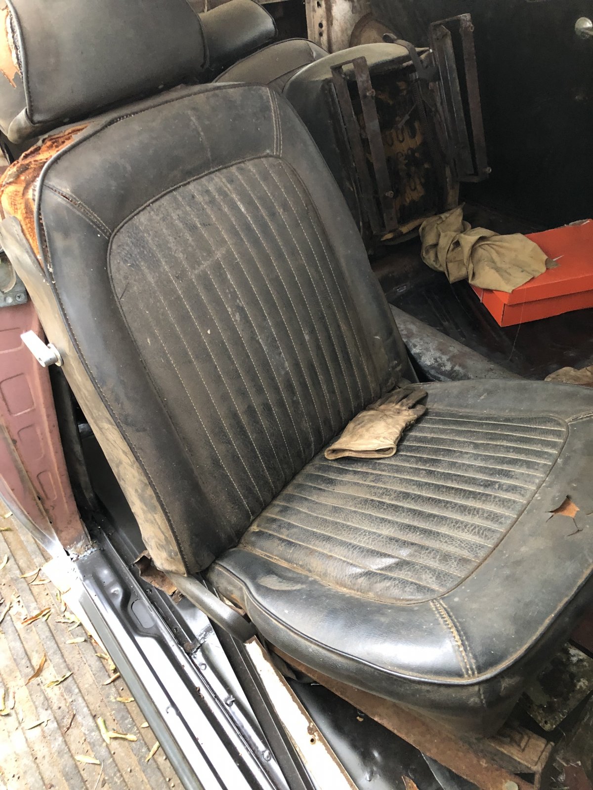

    Doug here is the mustang seat. I suspect 67-69 ish.mine will need a recover if I use them which isn’t likely. Got a couple of guys on here that have inquired but the shipping will be stout. I suspect pick would be better but I really doubt I am gonna use them.

    Look like 69 Camaro.. People killun for metal frames.

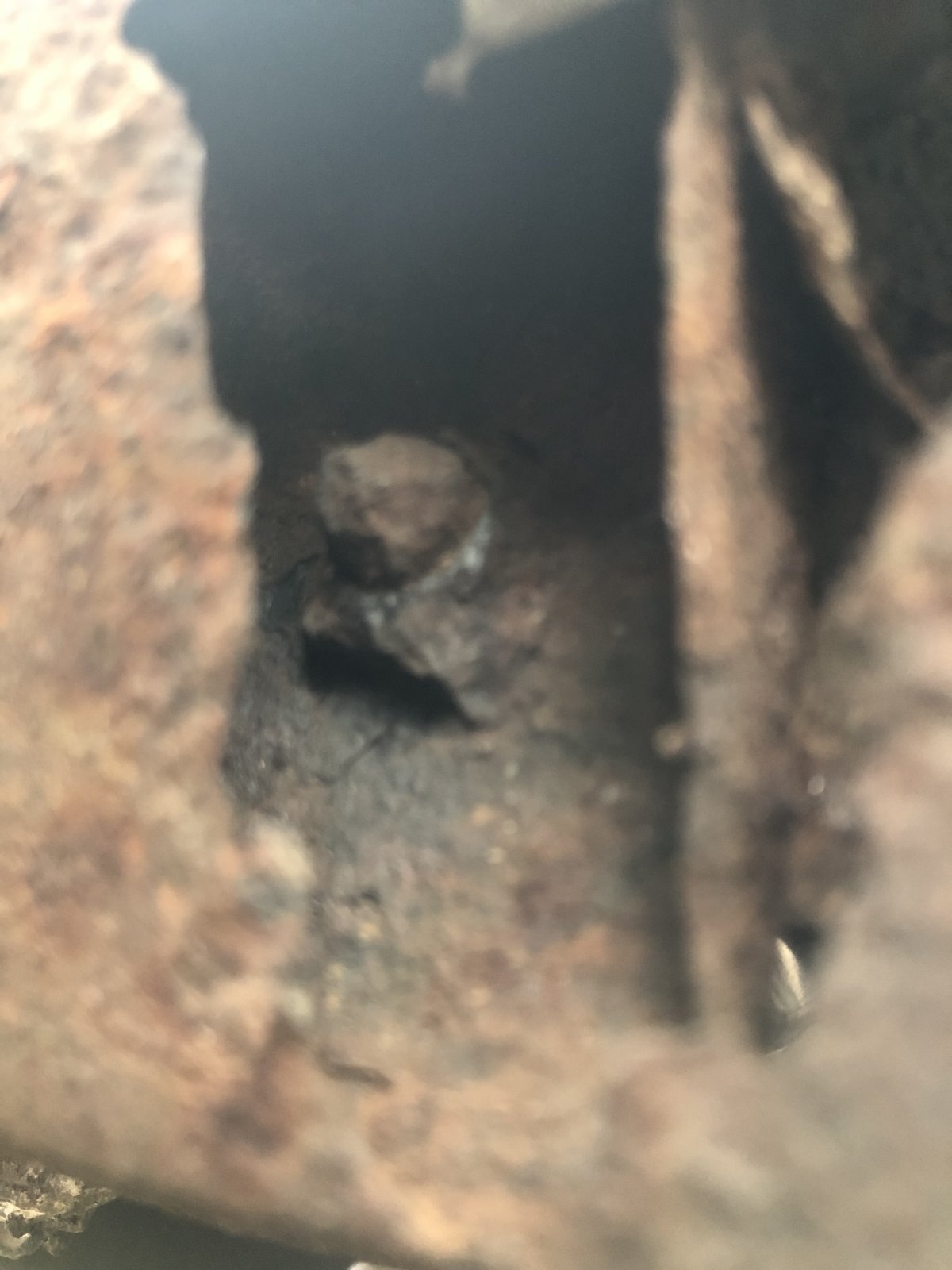

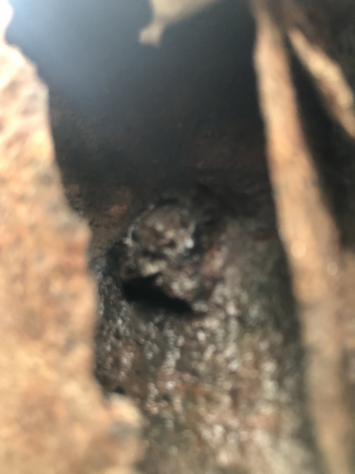

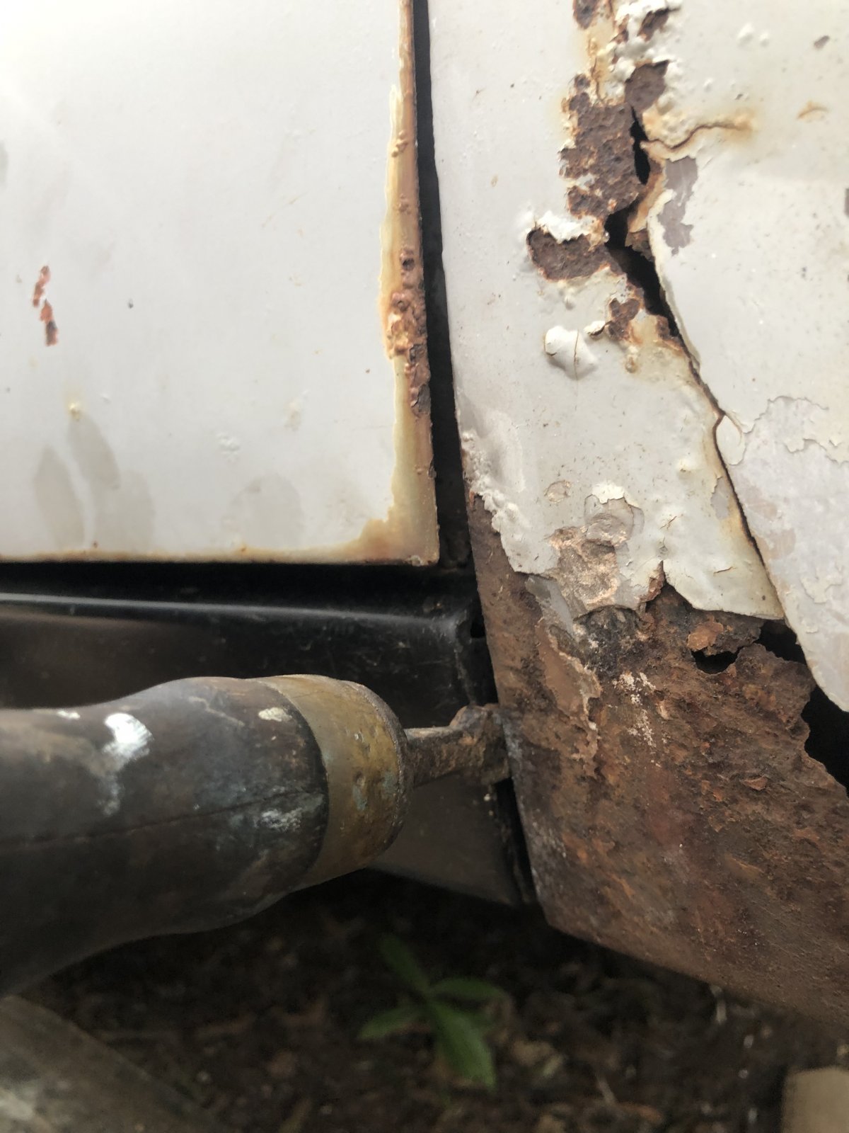

    Took some time this morning and looked at the bottom bolt rear on the front pass fender. It usually breaks off, rounds off , or breaks the nut lose and spins. As bad as this looks ( half the nut is rusted away and you couldn’t see where the nut /bolt /begin or end and yes the fender has the natural lightning /weight reduction treatment ) would you believe it loosened up and then after adjusting the fender door gap ( they were slightly scraping at the bottom ) tighten back up and did not break off. Deep Creep is some whodoo stuff. I know If no pics it didn’t happen. Well then here you go. God is good. And he loves crazy people too

    Posts: 40,346
    Hey everybody has to get lucky sometimes. :)

    Squablow
    That's shocking the bolt actually loosened up and that nut held.

    I worked for a dairy farmer, had this stuff called "Nut Buster" green lettering, white can from the farmers exchange, stuff never failed to loosen rusted bolts. You'd swear the bolts back themselves out ..

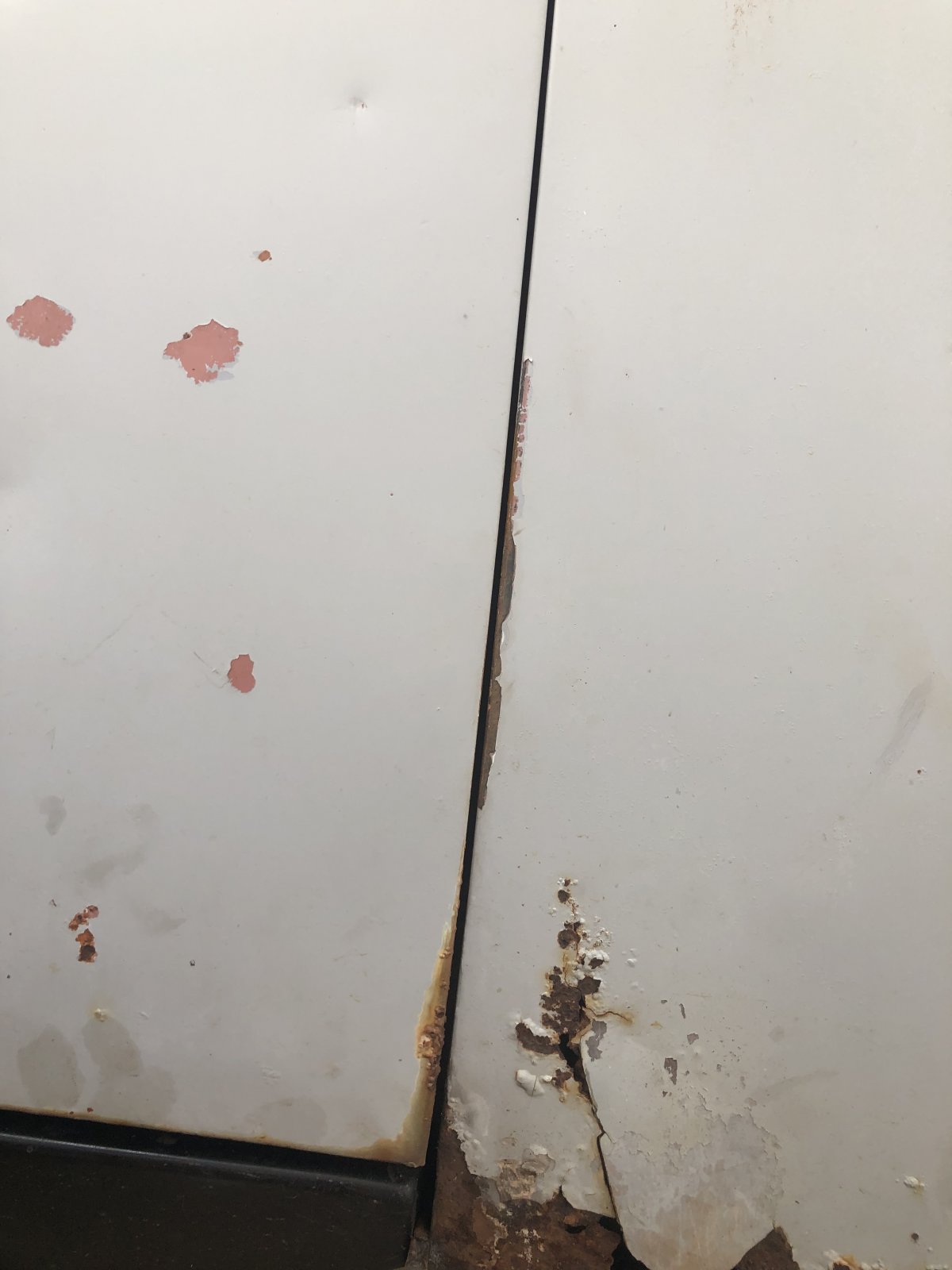

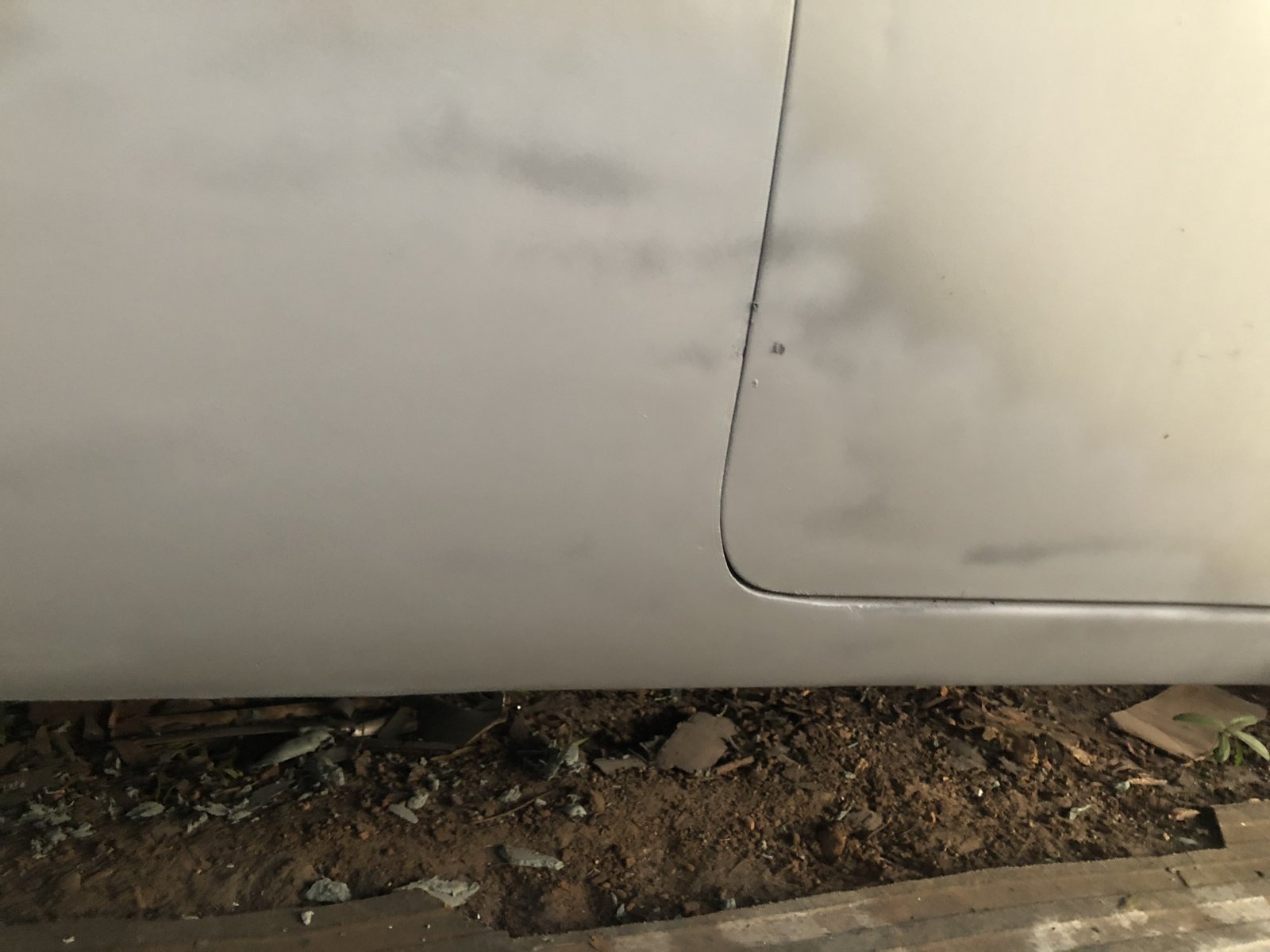

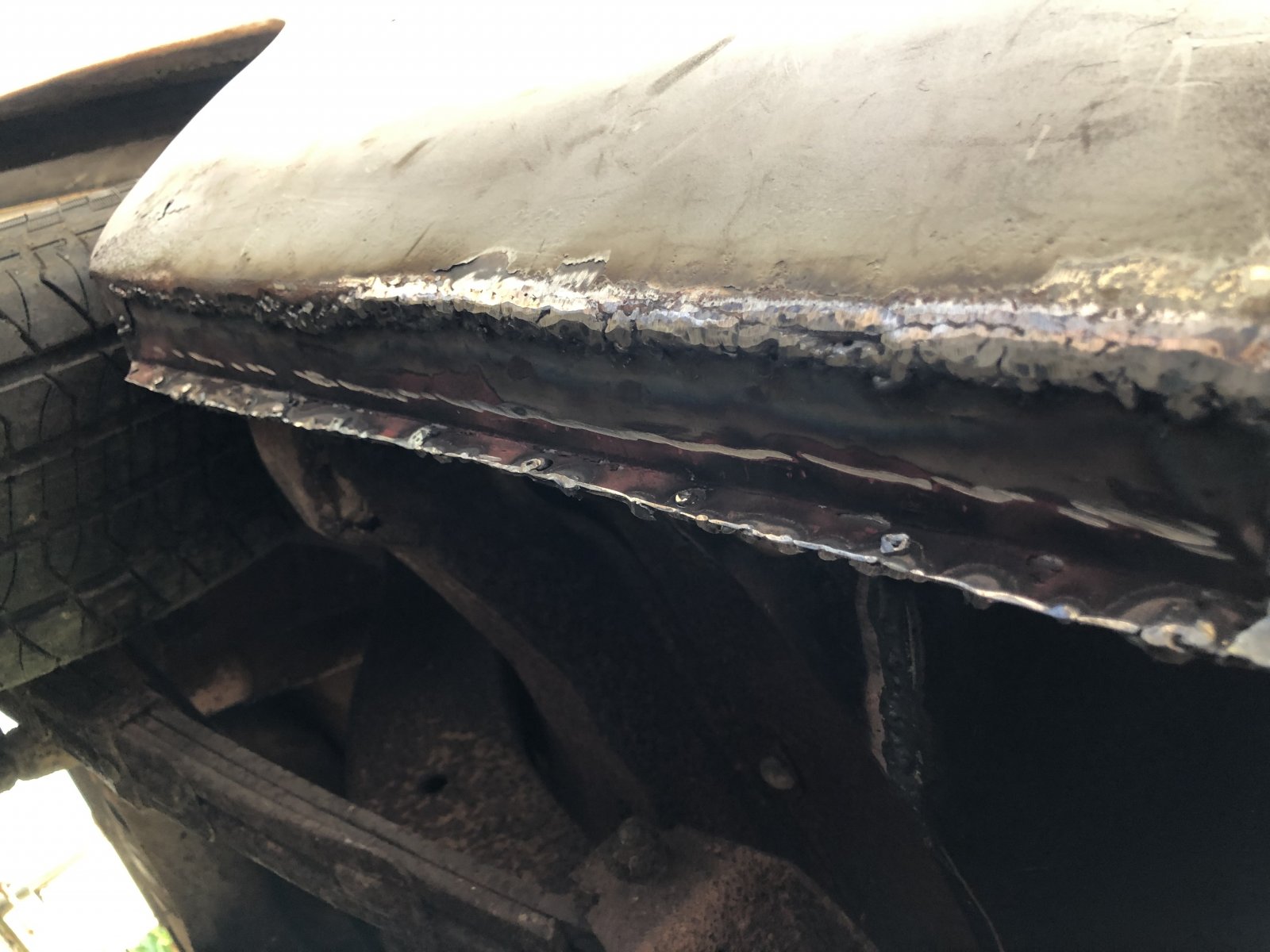

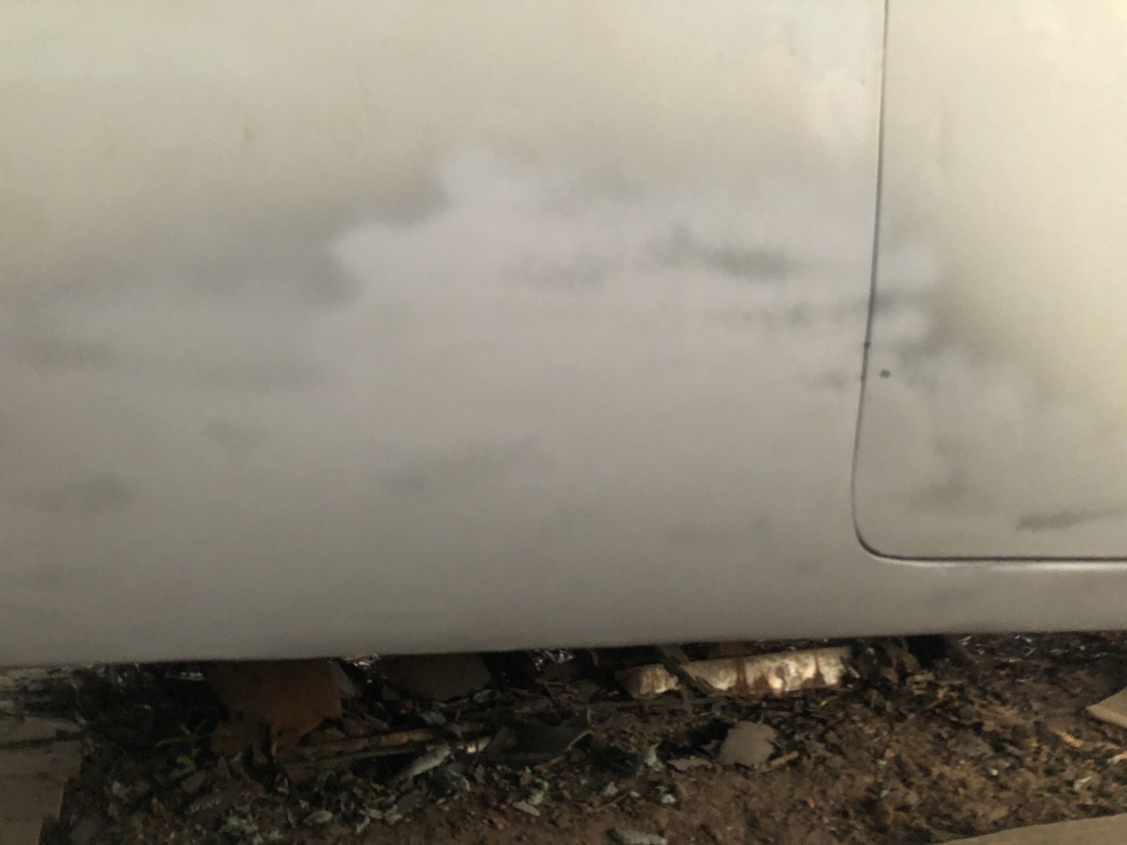

    Patch for front rear lower quarter on pass side is welded in. Gotta grind and clean up then hammer and dolly a little. Probobly take a little filler when time.
    Would you believe that I got the door locks cleaned and deep creeped and they are working now. Like wow.

    Got the rear quarter welds ground down and did the basic filler work. Will block and look tomorrow and see. It’s almost dark.

    Another idea for the gas tank. Mine is 25 X 25 X 10, I think. Anyway it is deeper than stock, but not any wider or longer if you include the flange around the stock unit. Made a mounting bracket and filler through the floor to the stock gas cap location. I wanted to keep my spare, and this tank holds 22 gallons!
