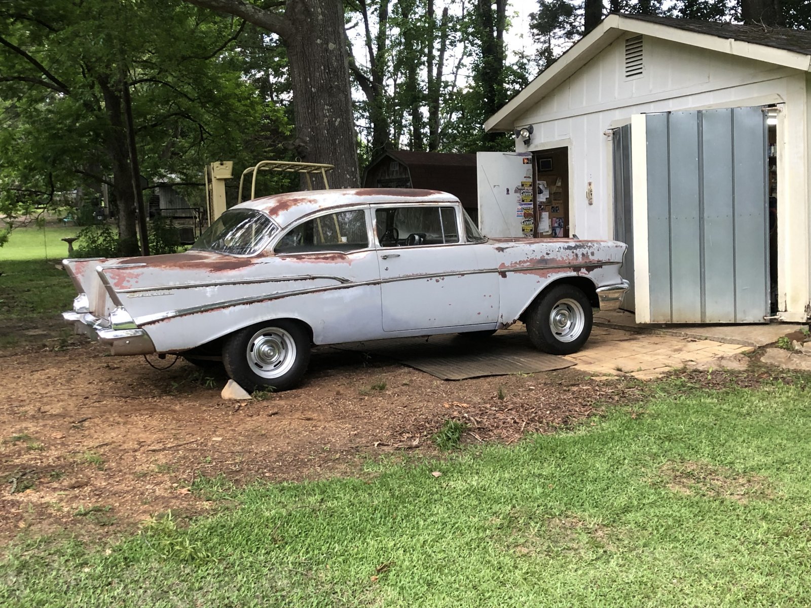

    Managed to turn 57 around today and get rinsed off. Getting ready to put drive train in /disc brakes on front. Just starting to take that look. Now if I could just come up with those ****er bean steel stock car wheels I like. Lol

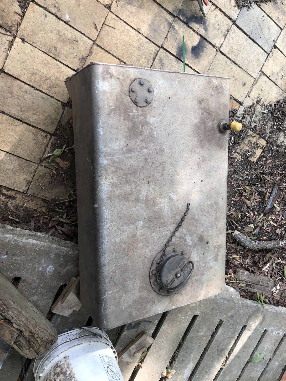

    I also have a 56 fuel tank( decent but needs to be cleaned etc )/ and the front and rear bumper sections that I pulled from this car - FREE to who ever can use them.

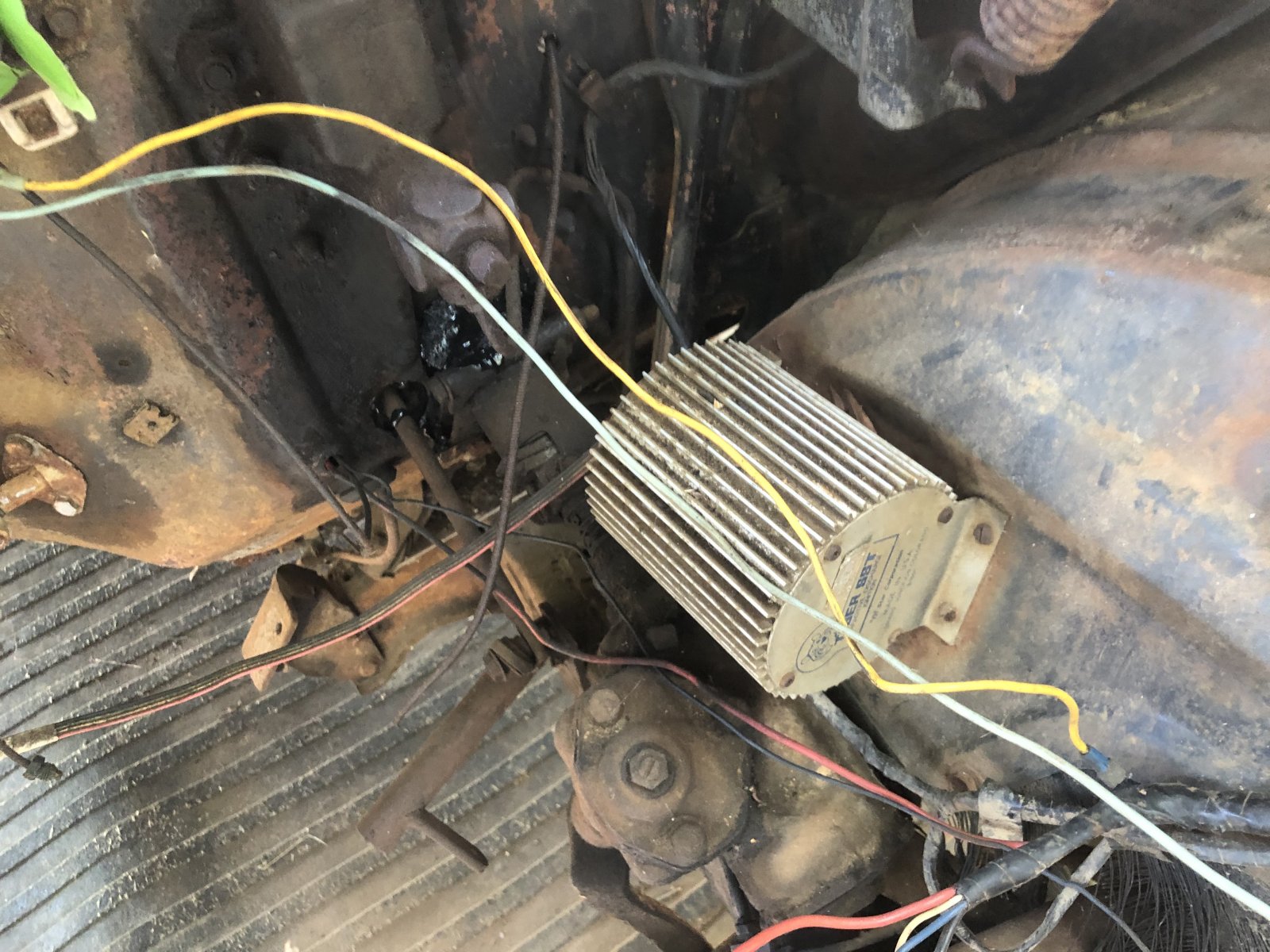

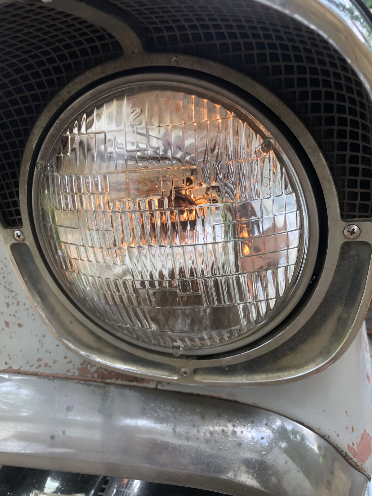

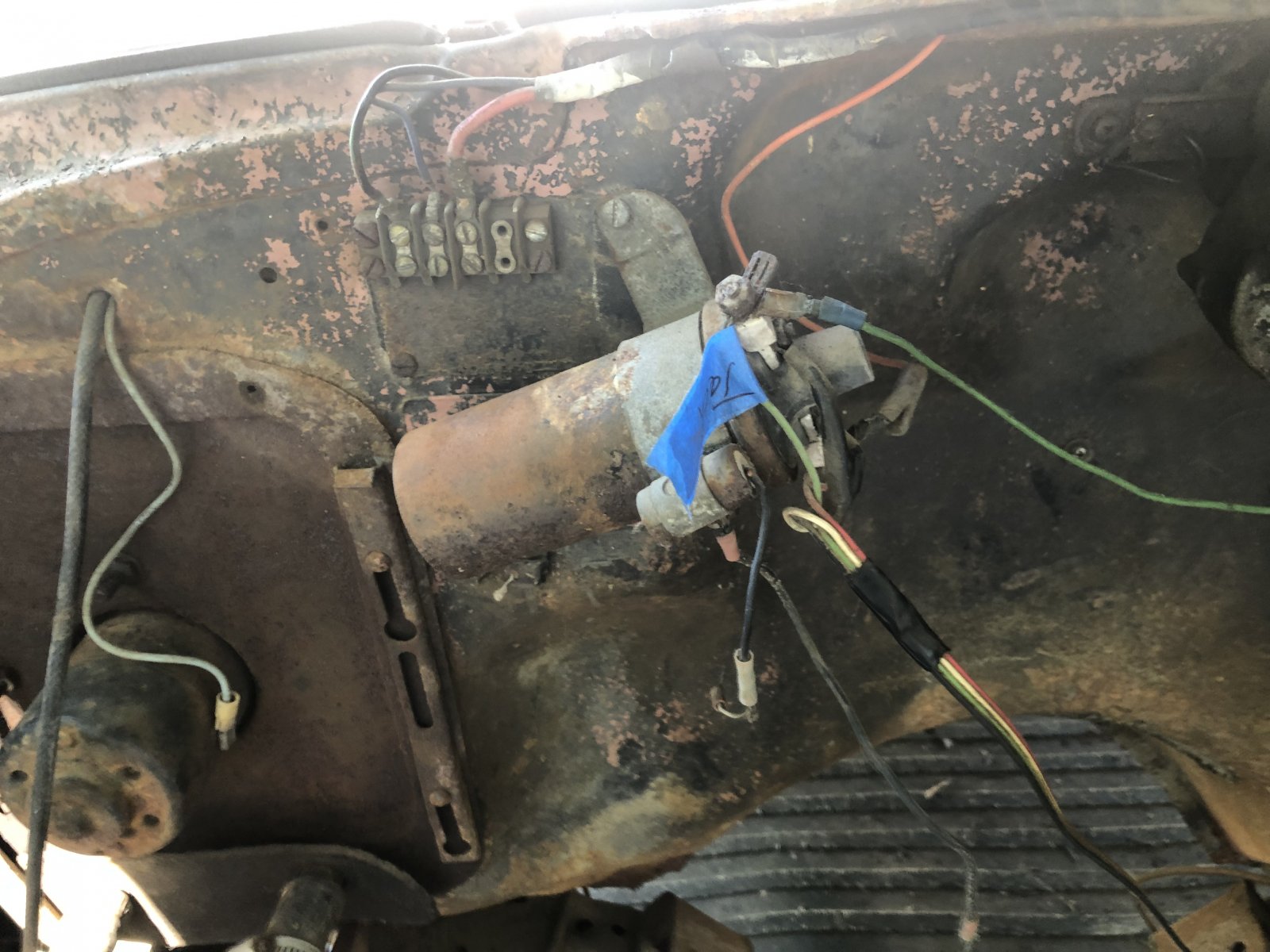

    Played around with the internal wiring etc yesterday. Hooked up a battery charger and here is the update.
    I was shocked in a good way. Please remember that this 57 has been sitting since 79 or so.
    the headlights work. Fuel gauge works. And the Tiger/ SST ignition box and coil are still pretty hot. How do I know?
    Threw the ignition switch a few times and kept hearing a pop. Looked out side under hood while wife through the switch and the bluest spark I have ever seen jumped to the side post.
    Wow. I will Probobly leave it completely alone. The engine will get a points distributor and away we will go. I must admit I was impressed.
  18. Squablow
    Joined: Apr 26, 2005
    Posts: 18,457
    Squablow
    Cool that stuff still works, also a pleasant surprise whenever the wiring in an old car is intact and functional.

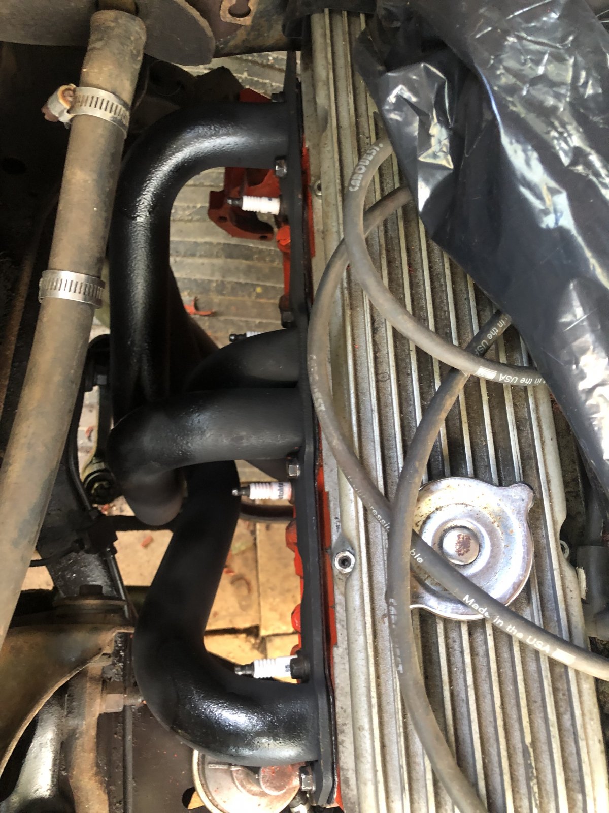

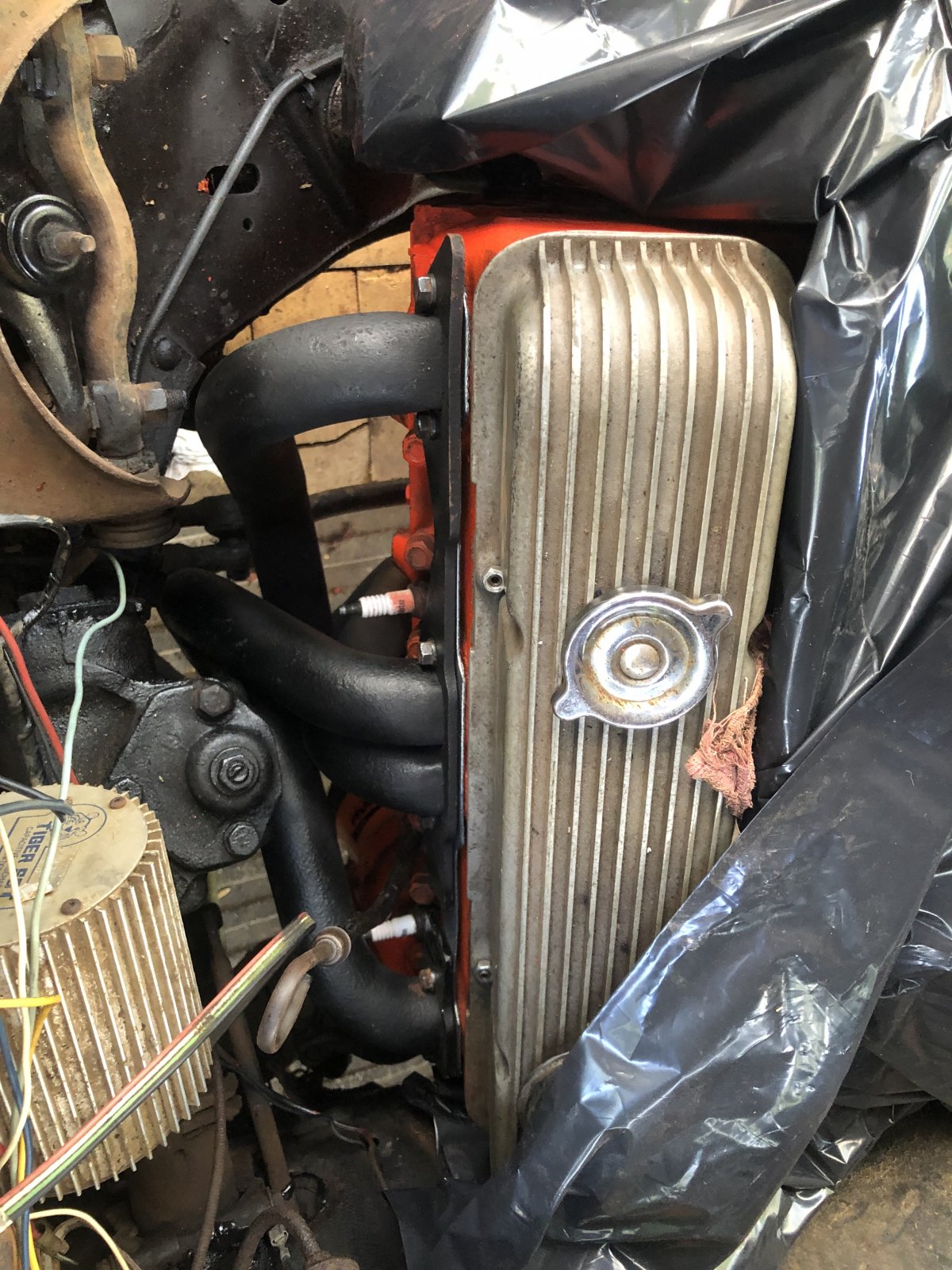

    Engine and headers in.
    Considering the age of the headers they fit very well. They are full length in frame headers first set I have personally had. All other tri five stuff I delt with was fenderwell headers.
    They don’t hang down low like some of the complaints I’ve seen on line. Maybe an inch below frame rail.
    Now here are the only numbers I found on them anywhere 1002 R and L for obvious reasons. These headers would have been late 60s early to mid 70s anyone got a clue. I would just like to know.

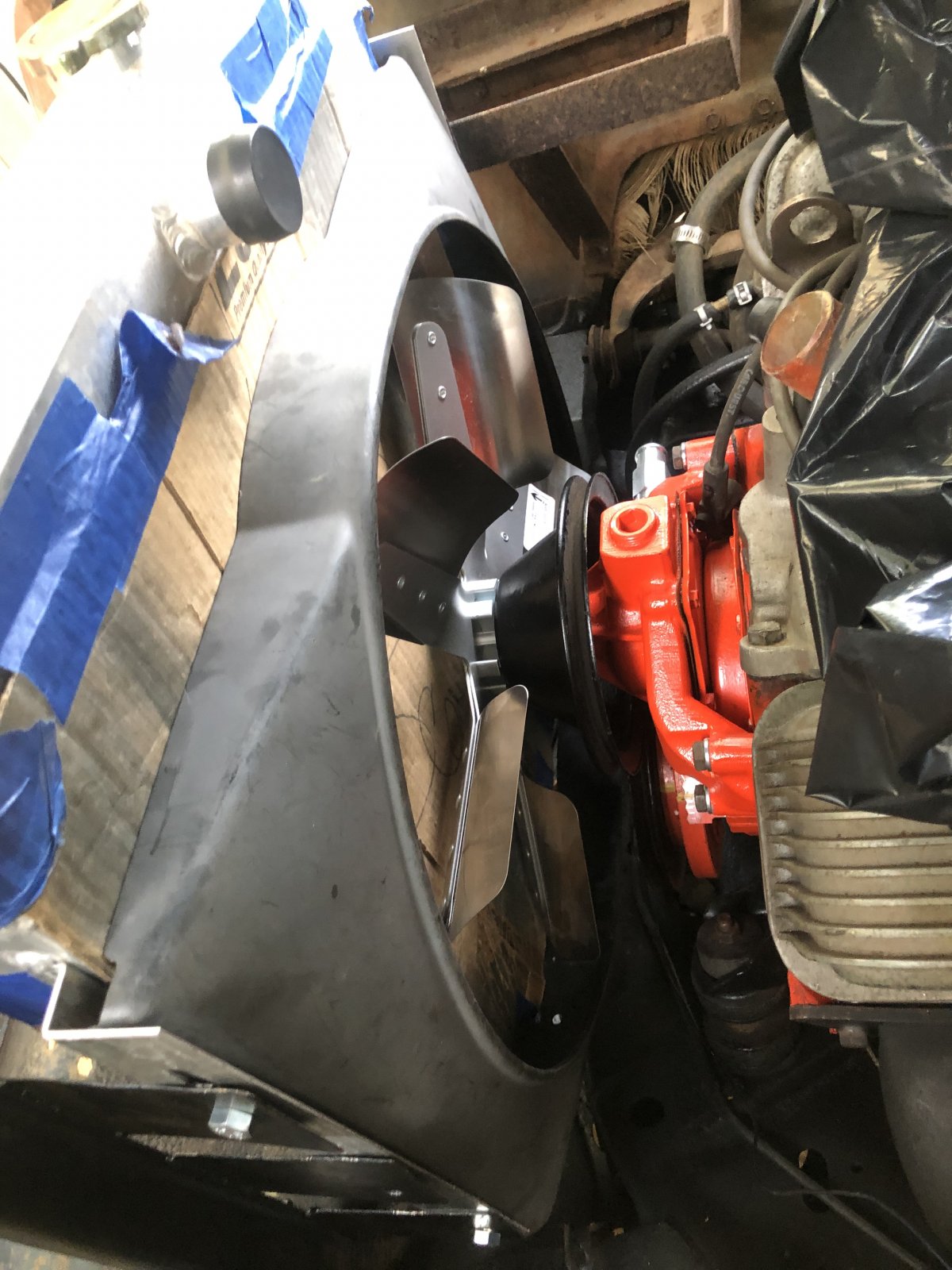

    Fan/radiator and shroud fitted. Yea that’s cardboard on the radiator if you ever mess one up you’ll never for get to do that again until your finished.
    Pleased with how it turned out. I had the shroud in inventory and have no clue what or where it came from. It even fits around the bottom radiator hose. The radiator will get a coat of epoxy black when it goes together for good.
  27. DDDenny
    Posts: 22,301
    Shots of the collector flange may help people ID the headers.

  28. Mitchell Rish
    Joined: Jun 10, 2007
    Posts: 2,335
    Mitchell Rish
    from Houston MS
    Collector shot. It’s not round or square which I about half way expected when Wes first told me he had these for this car. Again not an issue I’d simply like to know. Did good. And don’t hang down terribly.

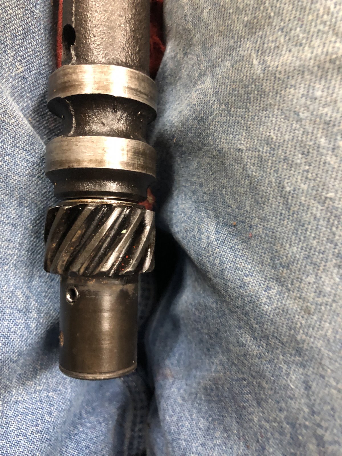

    Gonna use a stock (385) series GM /cast iron distributor in the 57.Set end play tonight. I have it a .024. Closet I could get to .020 with the shim kit I got and I took out over .030. Should be way better than it was anyway.
    Got a BIg Accel coil but may use the stock one that came on it. When I turned the key on /remember this thing has a SST tiger cd box also from way back /it would still ark a blue spark about an inch and a half to the mounting bracket. Don’t figure it’s to bad.
    Got to get a spring curve kit and do some notebook retrieving. All my early years were with a recurved (time slip check and see method) single point distributor. I’ve seen a lot of really fast cars use that and that alone.
