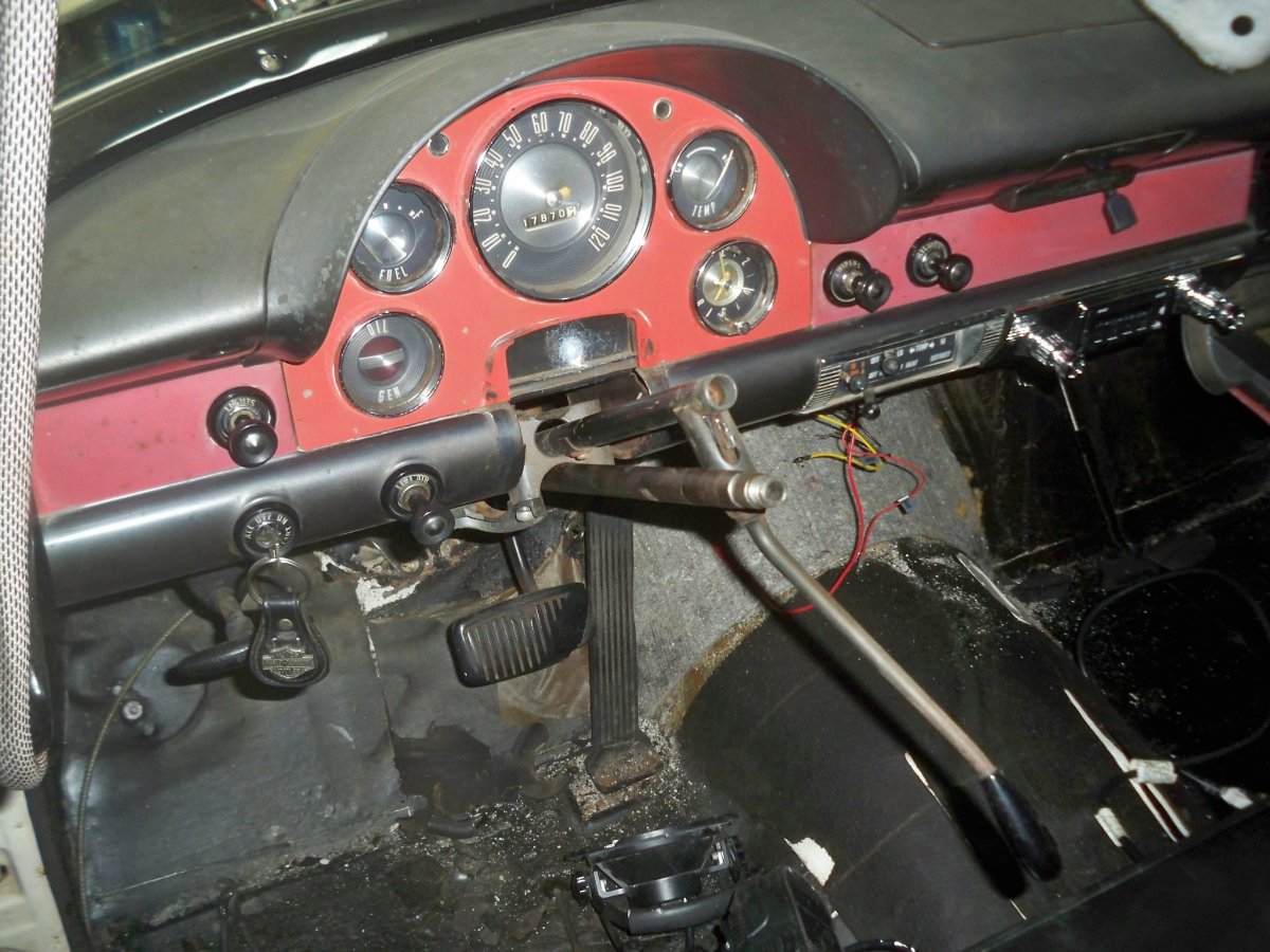

    It's been cold out in the shop and I don't do well in cold weather so I have been doing more parts buying than parts putting on for the past month or so. I have been addressing the interior and steering for the most part...

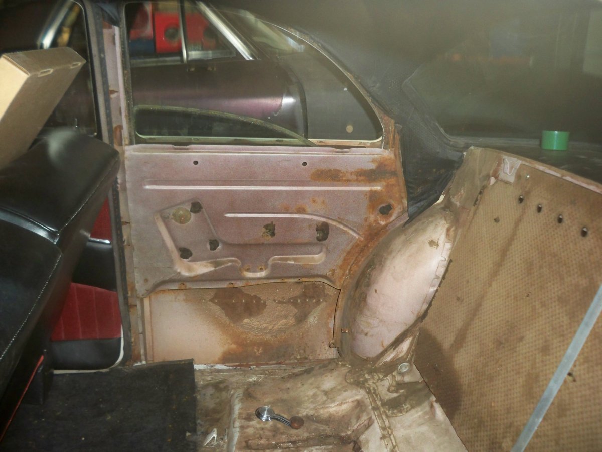

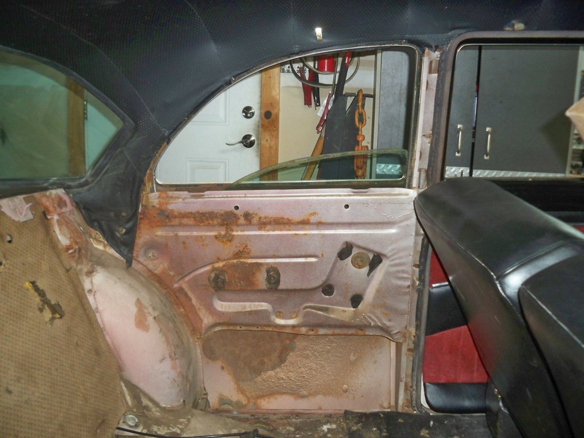

    All the side gl*** is either cracked or bubbled so it's all getting replaced. While I am at it I will rebuild the window regulators and replace the door panels since they are water damaged. The upholstery is in good shape so I am going to attempt to remove it and put it back on the new boards.

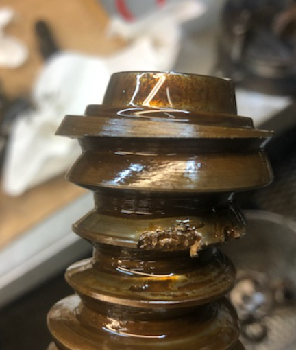

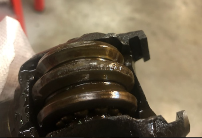

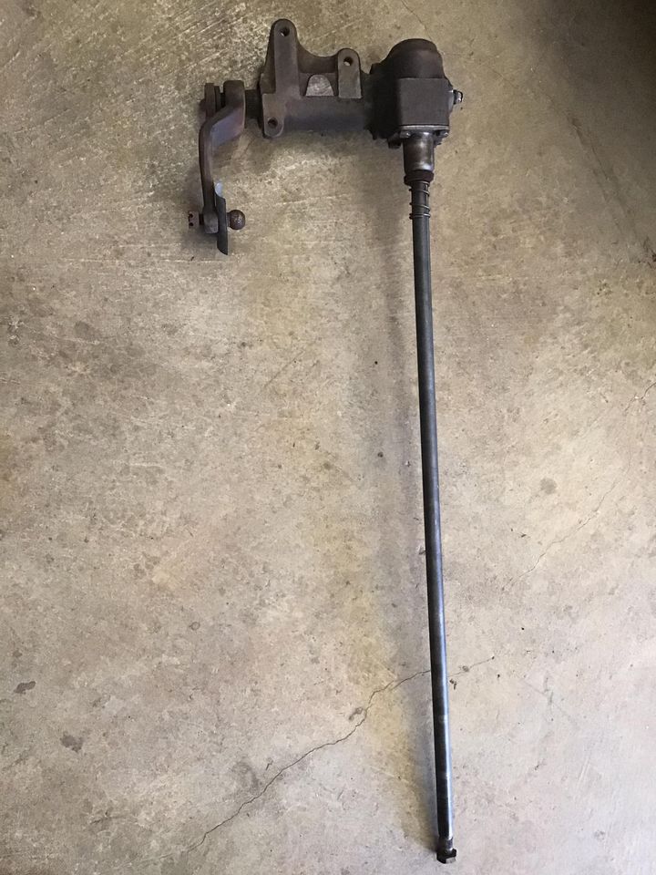

    Since my steering box was completely shot, I decided to pick up this used steering box that was said to be in good condition and have it rebuilt.

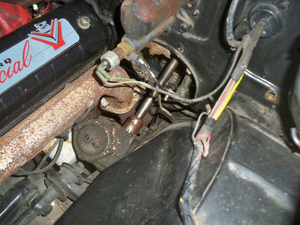

    but as you can see, it wasn't. Being that this is a 3 tooth box and the sector shaft gear that I need is not reproduced, I am pulling my original box out in hopes that it can be gone thru...

  24. The one thing that usually goes bad in these is the worm gear inner bearing races. These are part of the worm gear and not replaceable. Ford machined the races onto the worm then hard-chromed them and final-ground them for fit. The plating wears and then starts flaking off. As the gear was welded to the shaft, it used to be you needed an exact replacement as the shaft length changed every year but they are making a kit now with a weld-on worm gear.
    1956-1957 Ford P***enger Car Steering Box Repair Kit (macsautoparts.com)
    This kit is off-shore sourced (Argentina) but it appears the worm inner races are only flame-hardened. Do ask your rebuilder how they deal with this.
    I've always wondered why you couldn't find a separate inner race for these and machine the old races off the worm and press new ones on.
  25. I had planned on buying one through Summit, they had the best price, but like Rock Auto they didn't have any in stock. I talked to Lares, they had one but said that they wouldn't accept my box for exchange because of the sector arm gear. I would have to pay the core charge plus the cost of the box, that would have run over $1000.00 with the shipping.
    Powersteering Inc cost is $279.00 plus the cost of any hard parts like the worm gear. They are only a couple hours north of me so there isn't any shipping involved. I have talked with them on several occasions and they strike me as stand up people. Told me if I didn't want that other box put back together that there would be no charge, $35.00 if I did.
    I 'll take the box out of my '56 up there next week and pick up the other one. Hopefully, there won't be any problems with that one.

    That's really good to know. I can only imagine what my worm gear looks like, I measured 270 degrees of backlash in the steering wheel. I'll have to reach out to them.
