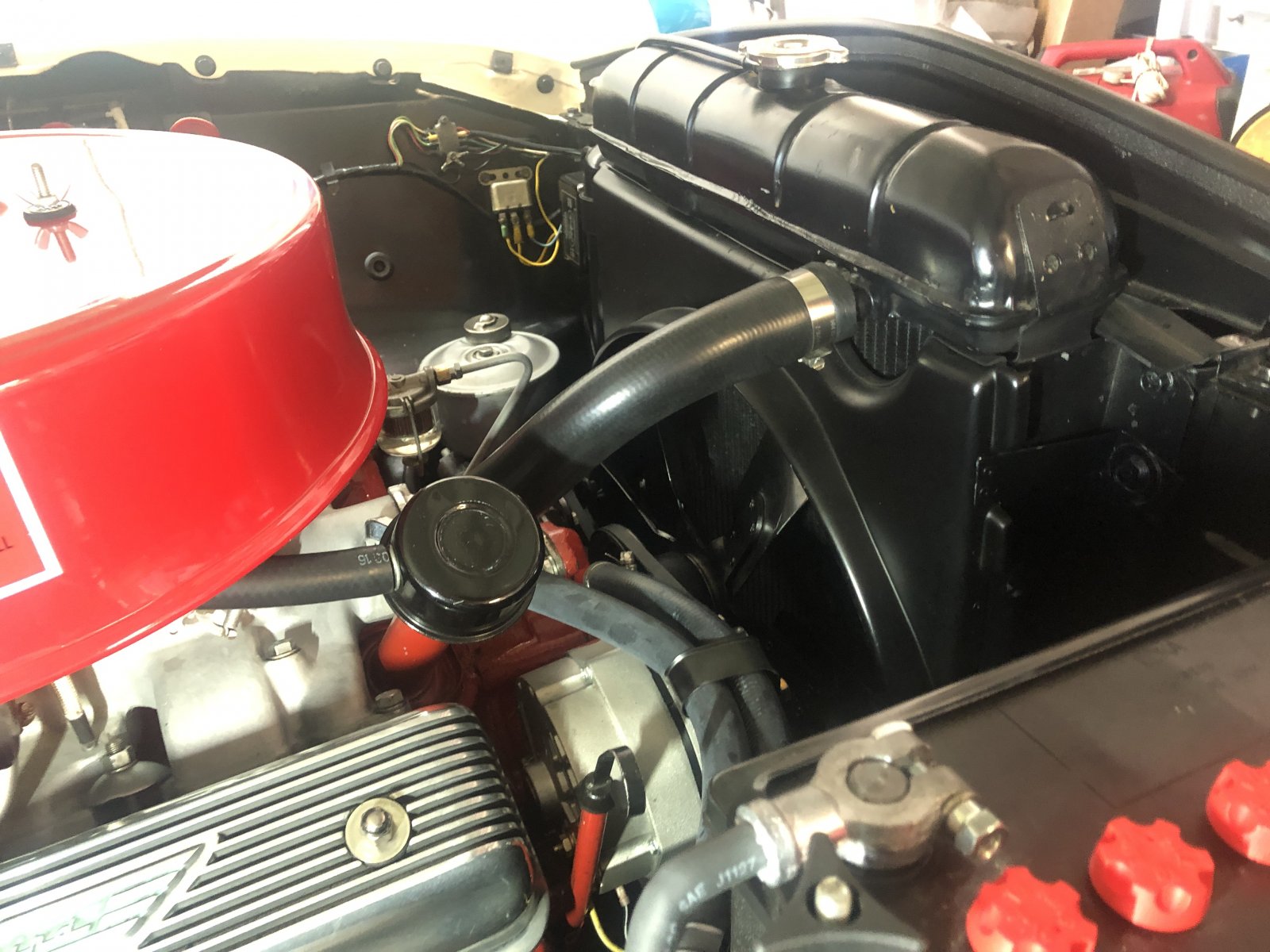

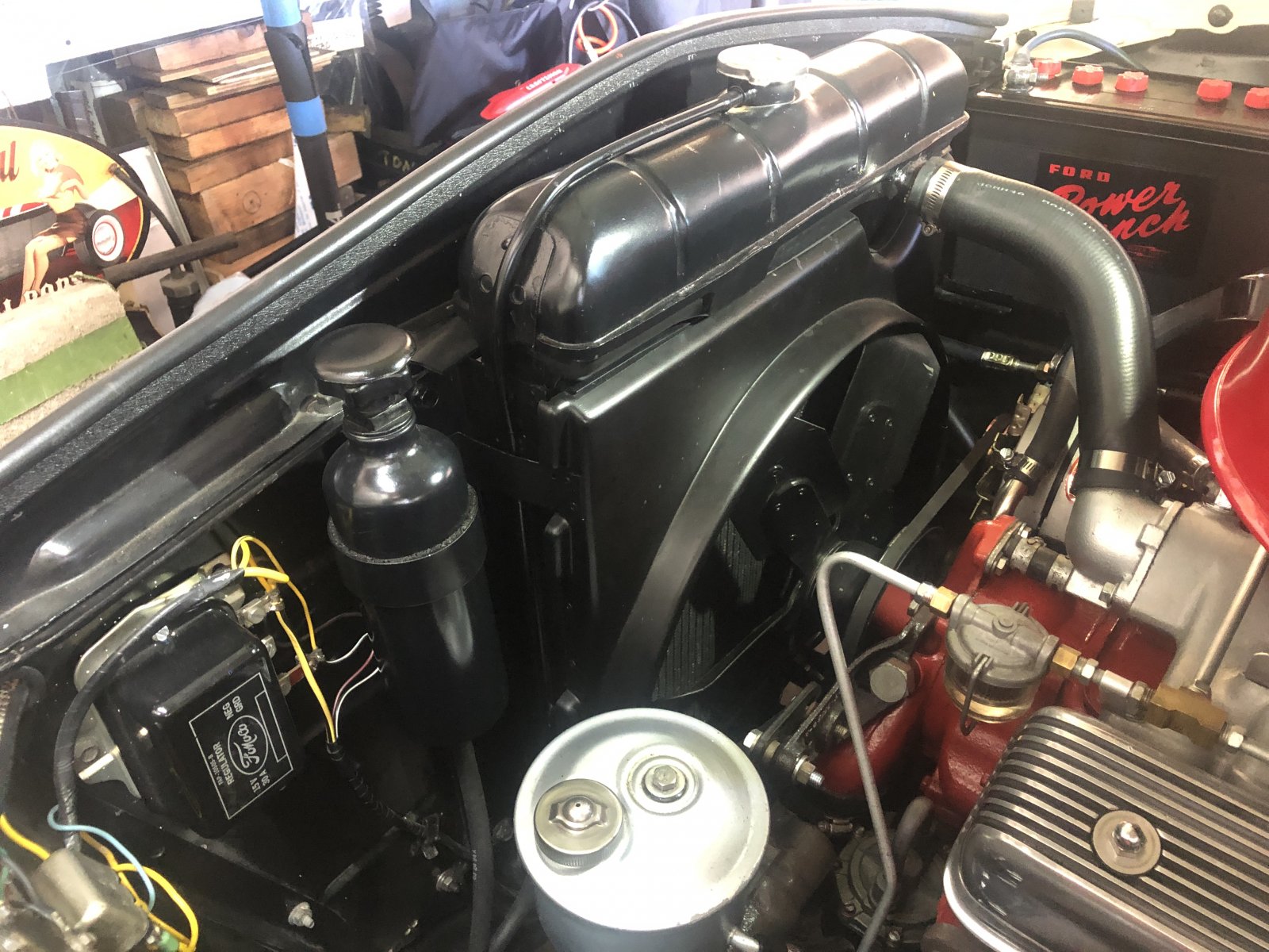

  8. jimmy six
    Joined: Mar 21, 2006
    Posts: 17,403
    jimmy six
    This what mine looks like now. I could not find where I purchased the shroud for a 55-56 Ford car but it was in Texas about 8 years ago. It’s 2 piece and I had to cut about 6” out of the center bottom to clear the trans lines. You can see it I placed it about 3/4” low. Don’t remember why. They were made for V8’s only. There were no factory shrouds on cars. I believe the fan was about 3/4” from the radiator. Tough to put on with the radiator in place but doable.
    You can also see my overflow recovery bottle on the left side and the factory hood seal above the radiator and it’s cross support. this forces most of the grille air thru the radiator. There are louvers under the battery on the radiator support for that side but nothing on the other.
    I currently do not have on the lower front frame to engine shields. I haven’t put them back on since I had the pan off for a piston/ring problem. But will install them on the next oil change.
    We ran the AC this weekend on a short trip. Temp needle almost made center at intersections. 2 widths under when on the hyway same as when it’s off.
    I change oil once a year at about 1000 miles. I’ve had the pan off 3 times and the heads once.. never ever found any evidence of sludge starting to build up. I’ve always used a high flow 160* thermostat even when fighting the cooling problems that were caused from little to no flow of coolant at idle. Greenbird from Tucson put me on the pulley. 7487616F-580B-4C3E-9F6D-A670E555C630.jpeg 299BAD0E-EA2F-426B-9040-73F21BBCDE44.jpeg
  9. jimmy six... Thanks for posting the pictures, pictures always help. I like the looks of that shroud and the fact that it's two piece.
    Sancho likes this.
