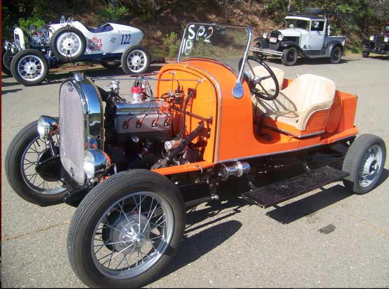

  1. Photos by Jim Brierley taken at the Auburn Gold Country hill climb they were/are posted on the Barn 32 B was a barn find. I think the green car was fastest it has a Stan Vermiel built Gemsa

    Us offshore love seeing photos like these more of engines please.

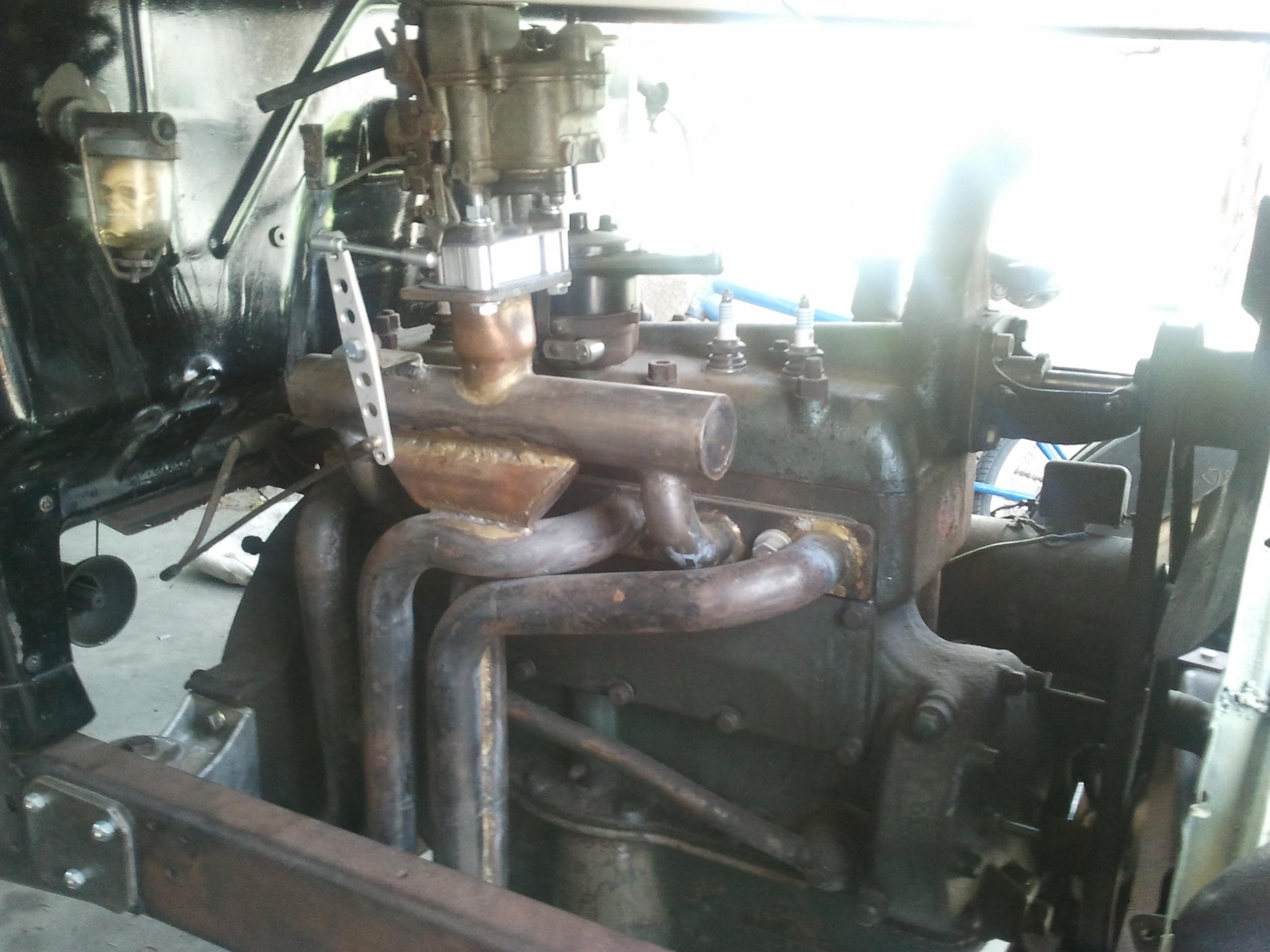

    This is where I belong. Hey guys, check out my ride!
    Im finishing the tailpipe today hoppfully driving this weekend.
    Im aslo haveing fuel delivery problems. Might be the regulator? Im going to try it without it.

    Nice looking Coupe.
    Are you running a fuel pump? Those carbs don't like more the 3 lbs psi fuel pressure.

    Yeah, that BIG electric one with the BIG angle bracket. I picked that one cause it was rated at less psi. Turned the reg up to 5.5max & the gas just trickles in when working the throttle by hand looking down the carb.

    It's not about trickle but more about the constant flow you can't see because the pump's pressure overides the float and turning the idle jet into a crude and uncontrolled fuel injector ( big leak)

    Its when I floor it, that there is no squirting from the upper squirters. I had the regulator at 2.5 & 3 & it was starving for gas, cuting off, Thats why I cranked it all the way up to 5.5max & it stays running. Maybe the regualtor is bad???

    Just got my 94 figured out. Newly rebuilt by a pro and had a bad accelerator pump. Had overflow issues and would not squirt. Changed the accelerator pump and set the float at 1 8/32". Lowered psi to 1.5. Solved all the problems.

    Thanks now I got to figure out if it has a bad accelerator pump. DId the pro rebuild it with a bad one or did he find that problem & fix it?

    I used a pro because I didn't want to learn a 94 inside and out.
    When I mentioned my issues he told me of a bad batch of AP's and to ship it back.
    I decided to by a kit at Napa for $32 and go into the belly of the beast.
    Then with some phone help from the guy and some trial and error it was figured out in 2 hours.
    Best part, I now know the beast and the fear is gone. :- )
