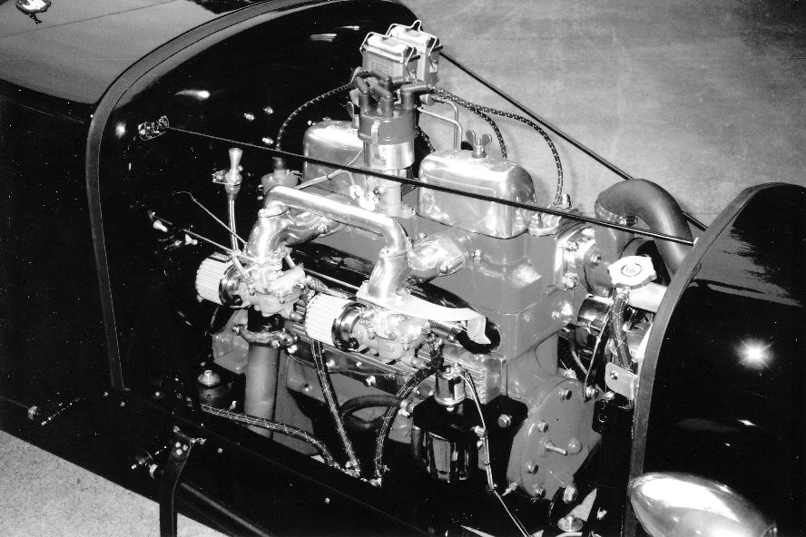

    Flash babbitt steel backed main bearings is one reason. Full pressure oil to rods and mains another. The deep block secure location of the main caps a third. The first car in the Hop Up Magazine 100mph club was PB powered
