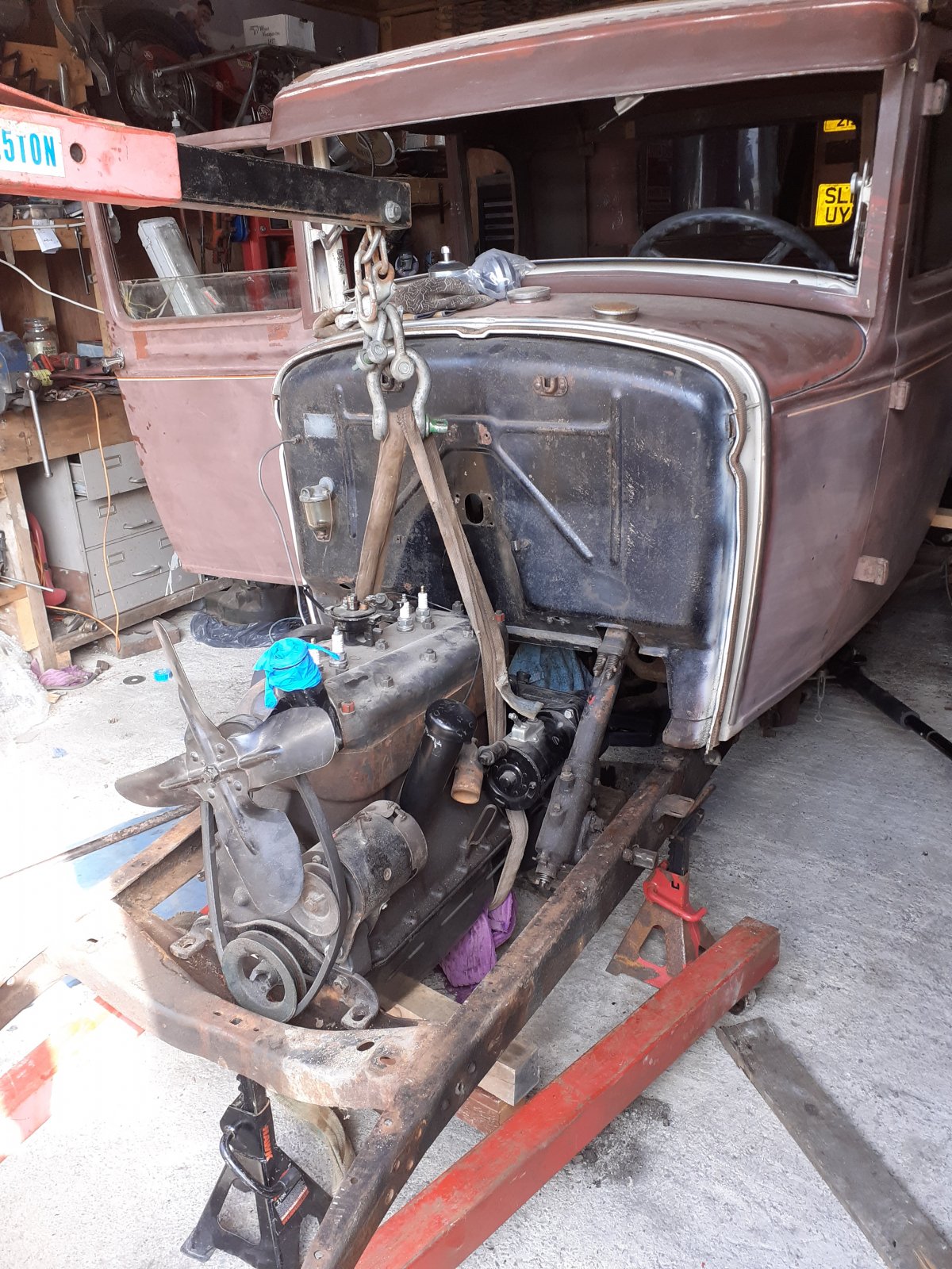

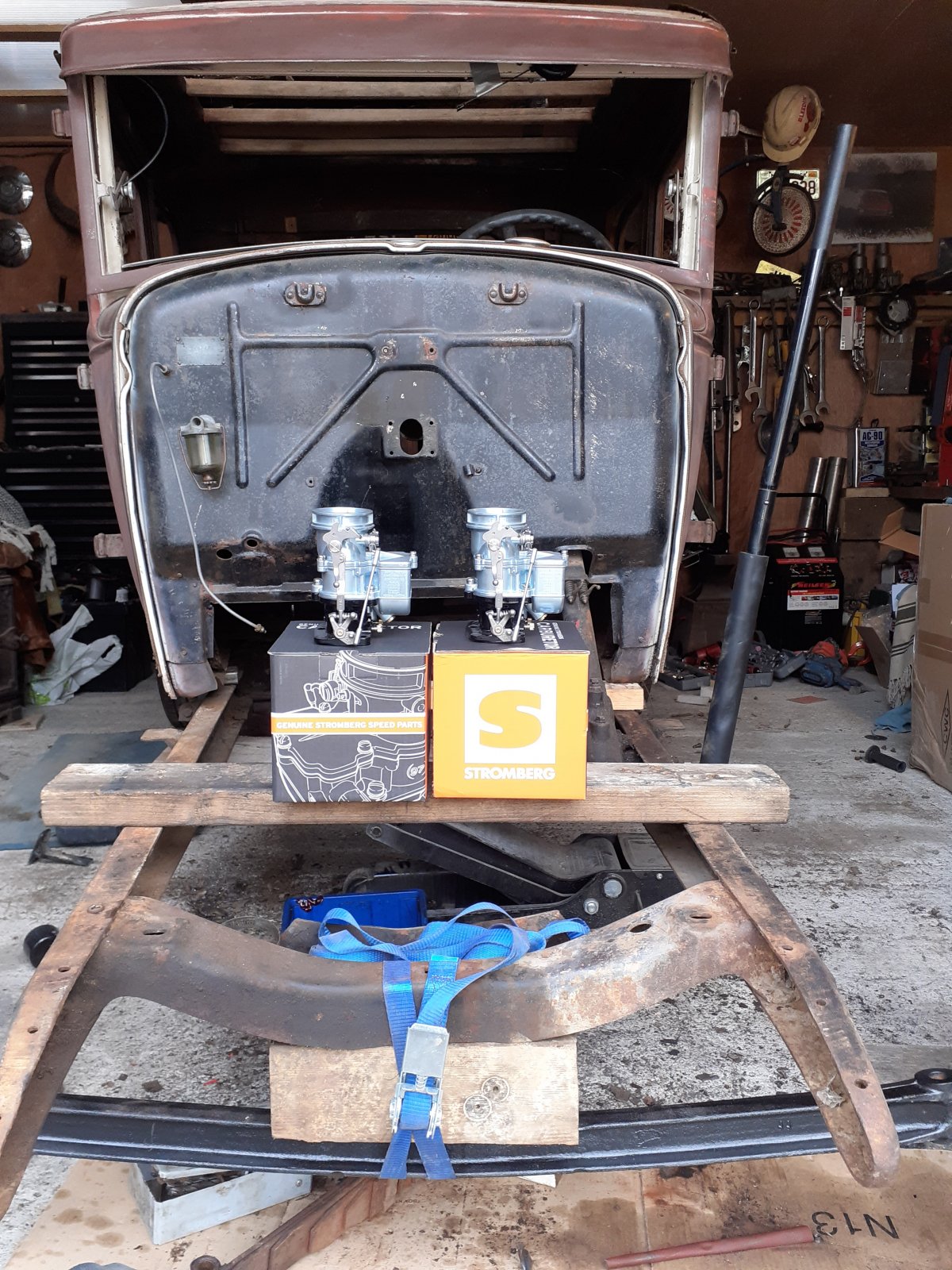

    This is the start of the engine install and the dropped axle initial slot in,2 new Stromberg 81`s to fit. 20220601_141843.jpg 20220601_105204.jpg 20220601_170250.jpg

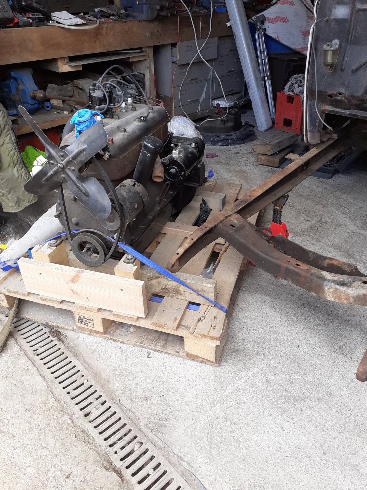

    I have a bit of an update on the Sacramento Coupe - I am still working on my house so time is limited but I am making sure I get it done! I popped up to see "Redoxide" and he kindly sold me a 37 ford gearbox mount and a handbrake lever ( much appreciated Ian)I have cut and welded plugs into the front wishbones,I tried to fit the front spring to get the front end on but found out that I had bought too short a spring ( I`m new to old hot rod stuff!)so I ordered the correct length-whilst waiting on that I have bought my tyres ( direct from Coker in USA-cheaper than buying them in the UK) ,had my Kelsey Hayes wheels dipped and blasted( found 3 cracks- all "v ed"out and welded now) they are sitting etch primed ready for paint.I am now at the point of fitting the "B" engine and gearbox -feel free to correct me if I am going the wrong direction! I have mated it to the torque tube (pics later) and am supporting it via a temporary crossmember on screwed rod ,I also plan to make a frame to support the engine onto the chassis to allow me to set the suspension in with the weight of the engine and transmission on the chassis then get the engine mounts made so the engine is level when the "rake " of the chassis is sorted . I have set the engine height at the front using the model A crank bracket and all looks well at the moment-opinions are welcome on this set up. 20220706_160515.jpg 20220706_164235.jpg 20220706_201749.jpg 20220706_210519.jpg 20220604_143036.jpg 20220604_143036.jpg 20220704_205035.jpg

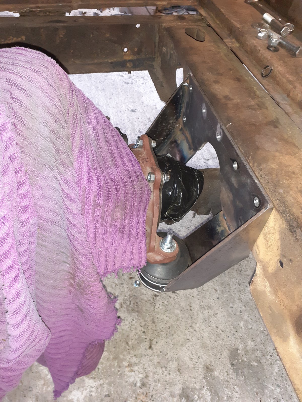

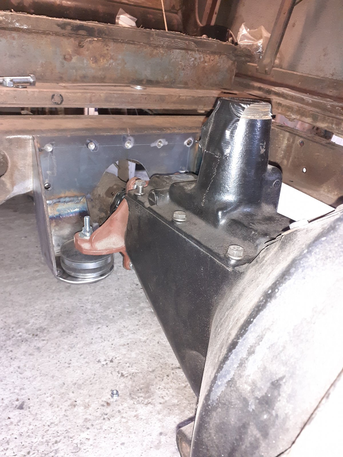

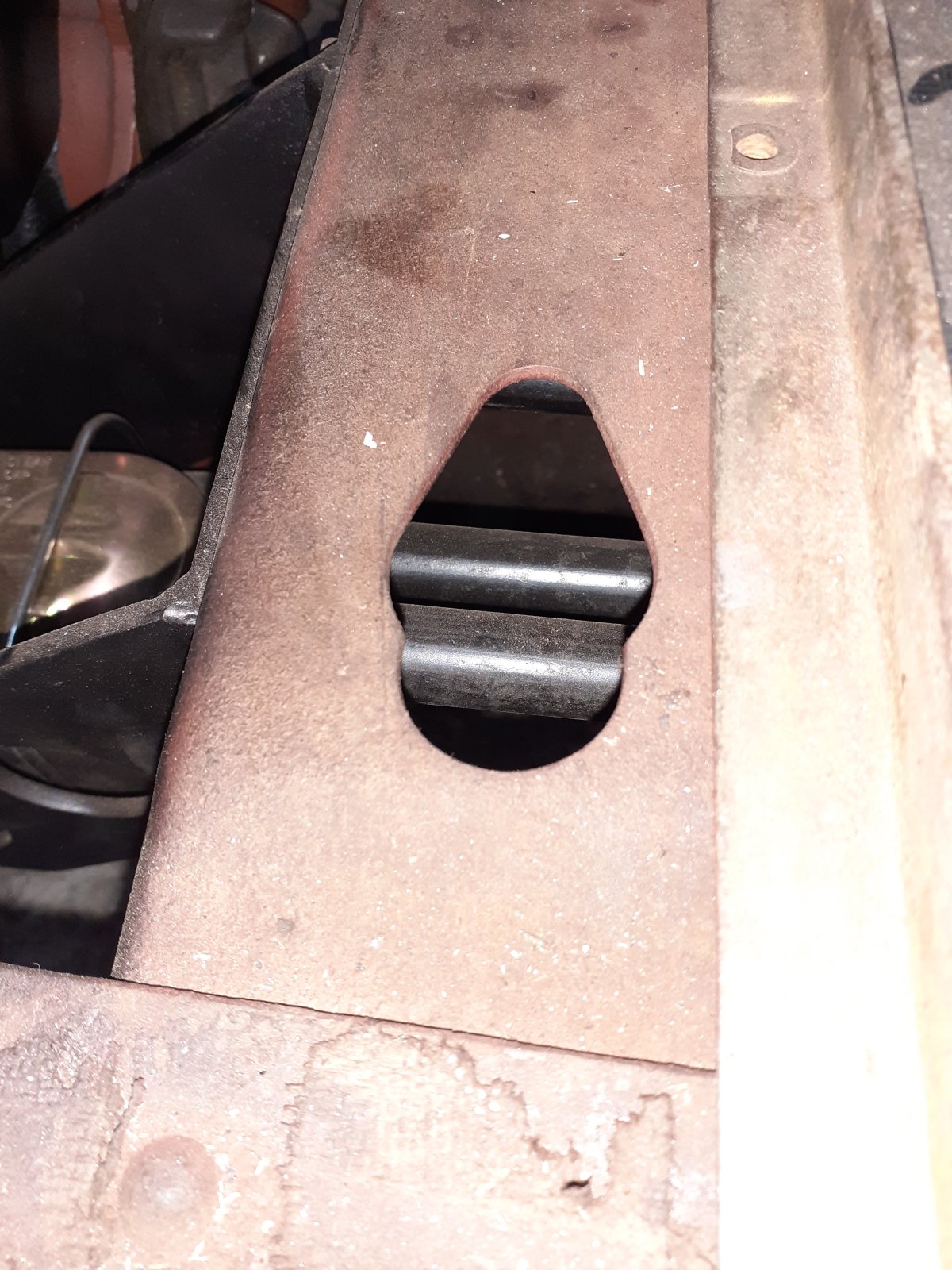

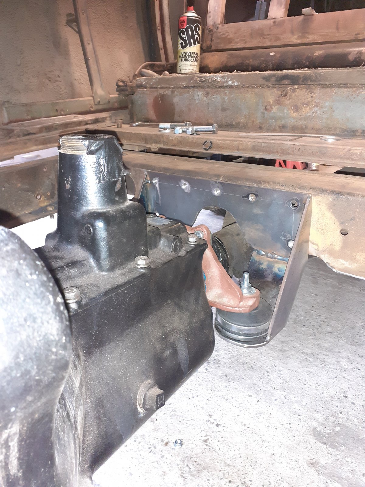

    I have been hard at it with cardboard templates, a grinder and various spirit levels! I have my engine and gearbox mounts made to bolt a 32 4 Banger in to my Coupe -here are a couple of pictures, please excuse the bolts as I am waiting on the correct imperial thread ones coming. I have yet to slice the lip off the front cross member -it is clear but I know it will rub when running . 20220721_180132.jpg 20220721_180143.jpg 20220721_180206.jpg 20220721_180231.jpg 20220721_180132.jpg 20220721_180143.jpg 20220721_180206.jpg 20220721_180231.jpg 20220721_180231.jpg 20220721_180206.jpg 20220721_180143.jpg Tomorrow I will be making the rear gearbox mount - I got a 37 rear gearbox mount from Redoxide ( thank you) so I can make a bolt in one for it. 20220721_180132.jpg 20220721_180132.jpg

    Great progress Jim, neat solutions to the engine mounts and a clever temporary trans mount ,that beats balancing stuff on a jack. Have you managed to source a clam shell for the torque tube coupling ?

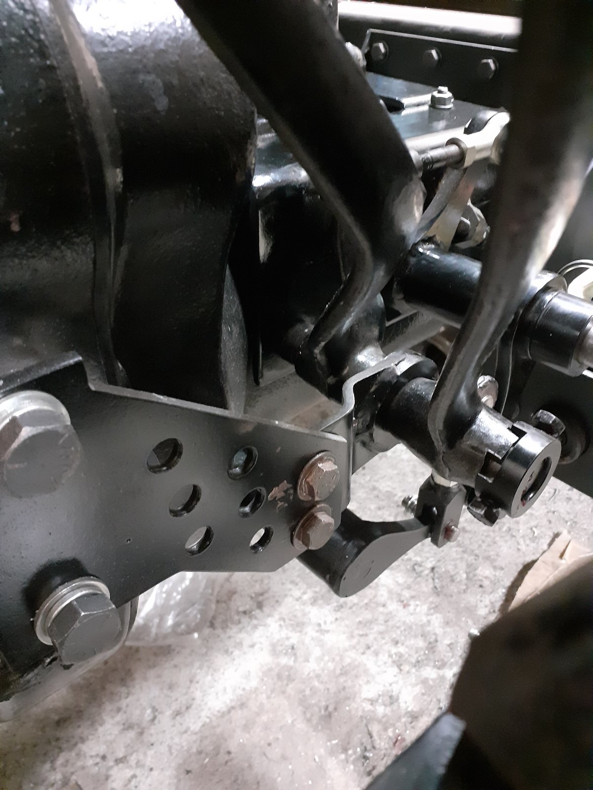

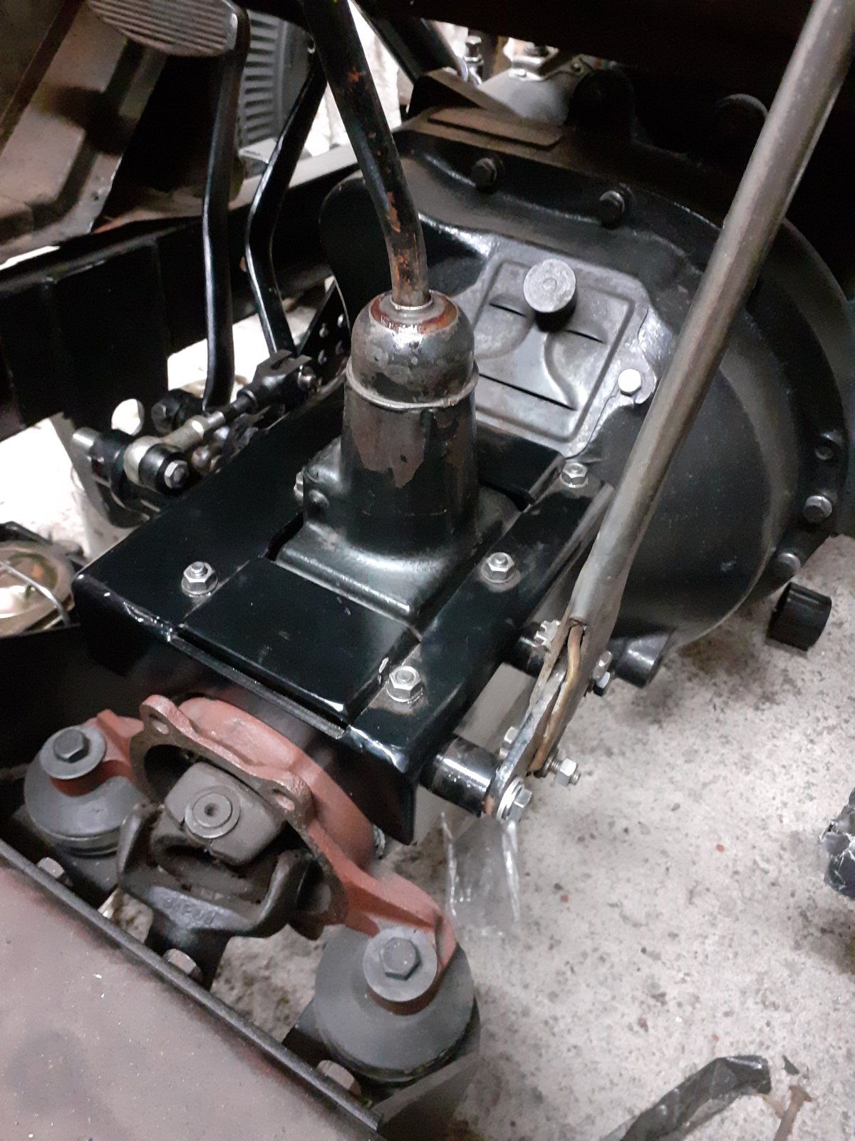

    Here is a quick update on my engine/gearbox mounts. As a side question-who would have done this ? would you fabricate the brackets etc yourself or bought a "kit from a known supplier" 20220722_173137.jpg 20220722_173208.jpg 20220722_173227.jpg

    In my opinion, with motor mounts in front and mounts on the flywheel housing, you don't need a third set of mounts at the transmission, You will be taking flex out of the frame and adding it to your engine and transmission assembly which increases the chances of breaking the flywheel housing or the middle or rear mounts. You also need to think about your pedals and whether or not the driver side flywheel housing mount will limit the travel of you brake or clutch pedal. Ask me how I know..............

    I do agree with you ,but Ford had the three areas mounted so I just went with ole Henry ! I do realise that there may be pedal interference but I didn`t have pedals and an A mounts there so I just risked it- if it interferes I will work around it I have made worse mistakes in a build lol.

    The A's have a front & bellhousing mount & 35 on had front & rear such as yours & no middle mounts.
    Your mounts all look great, I pinched pics for a mate of mine who wants rubber mounts.

    Yeah, its either end and front or mid and front, not all 3.. you may find that henry was chasing clutch chatter through the years, and he did things to try to resolve it.
    I do like the front and mid mounts though... that's deff the way to "float a motor"

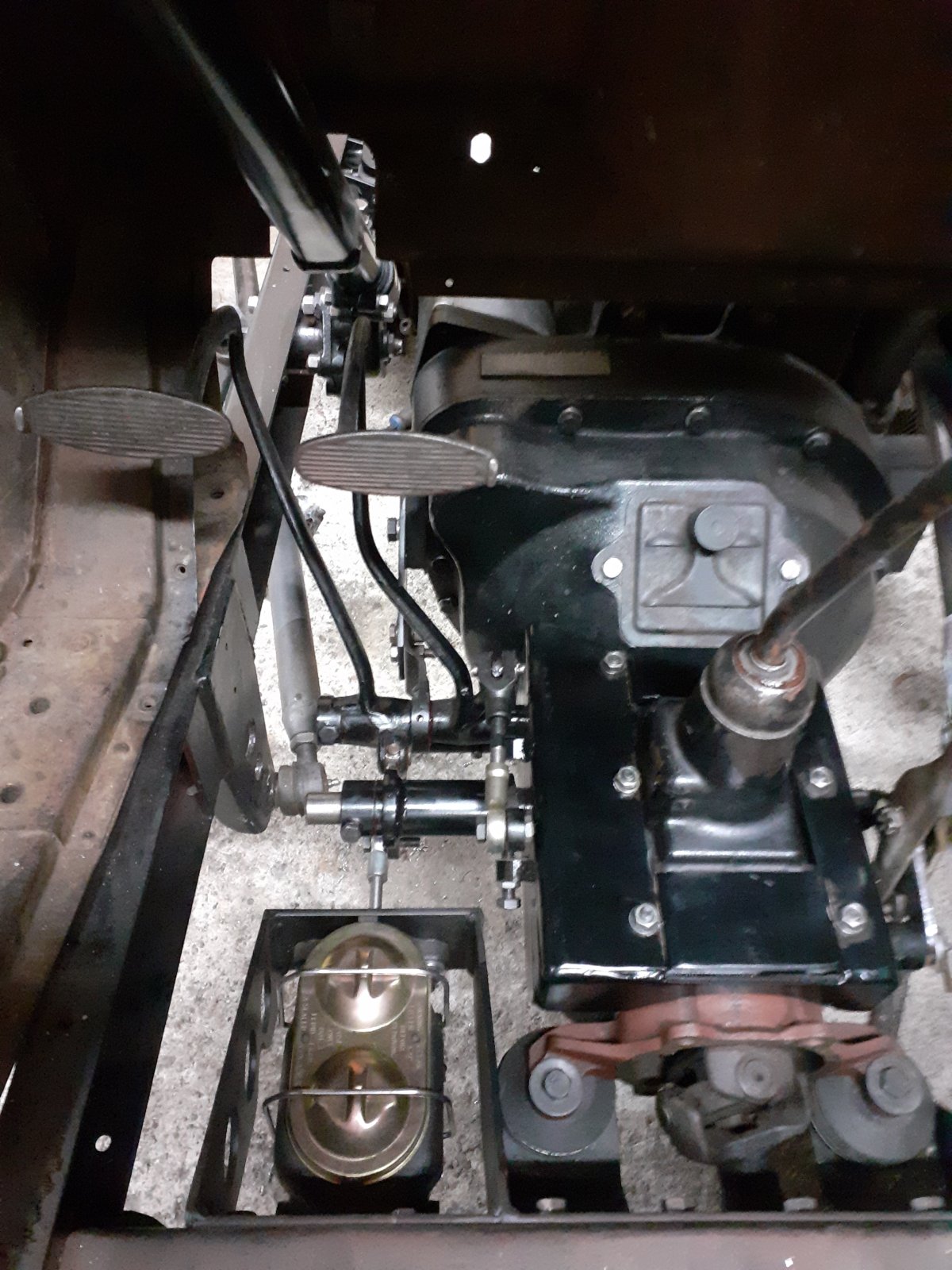

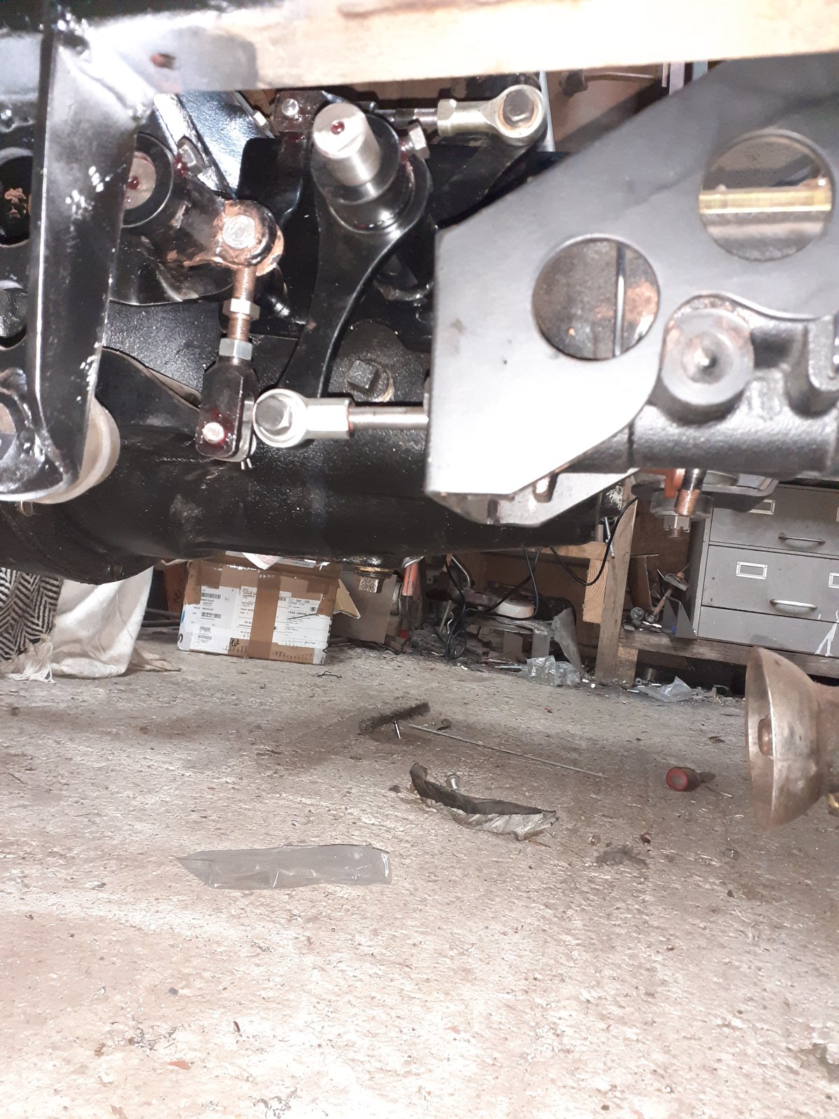

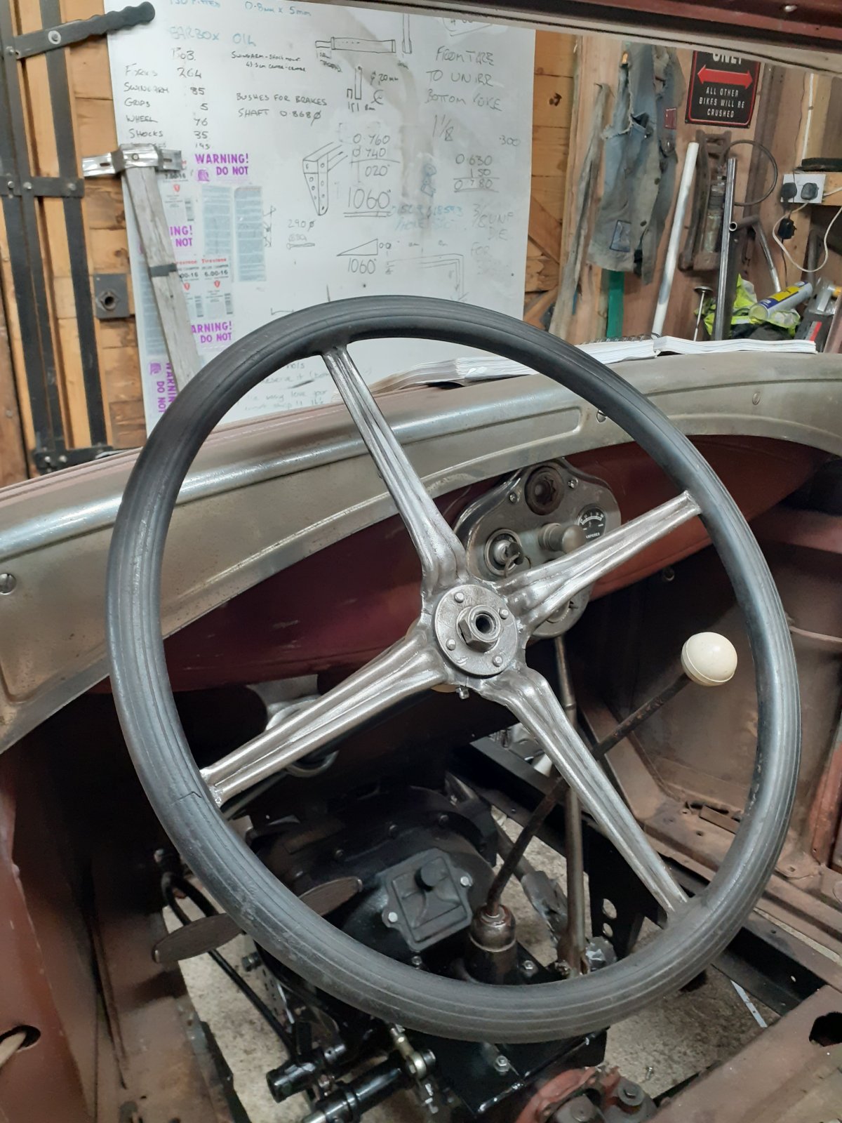

    A little update on my Coupe -engine and gearbox mounted,front end on and steering sorted (I used the original box and modified the column a little)As we all like pictures -here are some of my version of getting pedals on to a 32 gearbox.Here is the link to the youtube video for a better explanation- feel free to comment 20221201_184323.jpg 20221201_184323.jpg 20221201_184334.jpg
