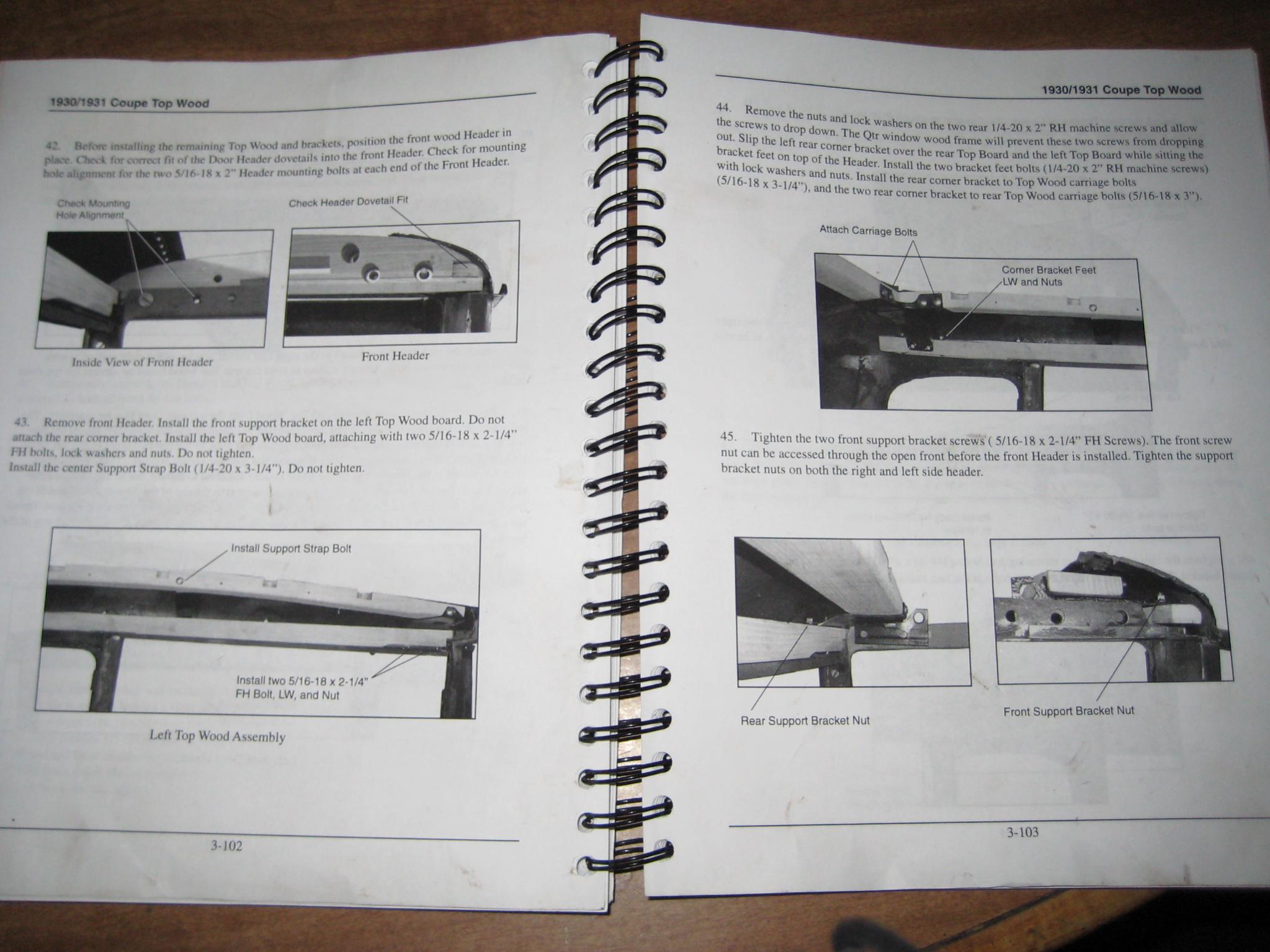

    this may help:)

    Tony,
    What book is that?

    xmacx
    from illinois
    I own that book but it doesnt really help with my problem i just took all the wood back out tonight to start fresh. Something in the top has spread out over time but idk what to do to get it back where it needs to be. It just seems to be way high on the top and pushing that down spreads the sides out I am beyond frustrated so i hope starting over may help. Still though any ideas would be great to hear. Thanks again.

    Whats the name of that book if u don't mind me asking? Thanks

    What's the ***le of that book ? ....it would help me out.

    the book is ***led model a ford mechanics handbook vol 2 you can get it from macs or synders for like 30 bucks. And i have adjusted pieces made holes bigger all of that but for some reason those sides seem to have a way high arch to them and are not as flat as they should be.
