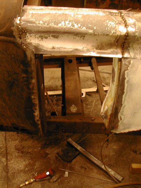

    I had a gap between the Olds quarter and the model A cowl that was about 12 inches wide that needed filling. There was a little bit of a contour change so I needed a curved piece of metal to fill the gap. Here is the opening all cleaned up around the edges with a 3 inch roloc Disc for welding.

    I grabbed my back door. And cut off a chunk of it to fill the hole. I left it a little big so I could "sneak up" on it like my main man Jesse James does.
    I think I have to quit calling this the back door buddy now because my plans have kind of changed and this is the only part of all those back doors I am going to use.

    Now the Curve of the A panel diidn't quite meet the curve of the Olds panel so I had to manupulate it on my fancy patella roller to get it to fit (that's my knee by the way).
    I cleaned up all the edges of the patch and tacked it in place. on the top, I worked it with a dolly a bit to get the flow down from the Olds door top to the Model a door skin.
