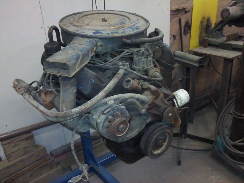

    Got the FE on the new engine stand I built, the old one wasn't strong enough to hold it up. Now I can start the tear down to see exactly what I got. It's supposed to be a 68 390 truck motor.
    I was able to get some work done to the right floor pan also.
