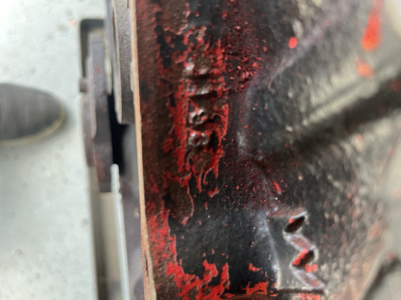

    My buddy is clearing out some stuff from his shop. He has two complete small block Chevys that came out of previous projects that he wants to sell but he doesn’t know what they are. He’s way down in SoCal so I can’t take the pictures, I’m trying to coach him to get what we need. HAMB crew is the best at this stuff so here’s what I have so far.
    First engine ….

  3. I believe that’s a 400

    1509 is a 400 small block
    ctc is a 74 400 175hp

    Here’s The date code…. Can we get more specific?

    Those heads are pre 69's, the casting numbers will be "461, 462 or 291".

    Sept 19 1973? that makes it a 74 at least I think the last digit is a 3.. Denny is right it has earlier heads

    14C means Chevy car 1974 ***embled at the C (Southgate, CA) plant which built full size cars. The CTC code was used for Chevelles and Monte Carlos as well as the big cars, but they weren't built at that plant.

    The engines aren’t stock, both have aftermarket intakes and other mods done before he got em. Both ran fine. I’m just trying to give him a little ***urance so he’s not lying to prospective buyers. All of his projects have been H.A.M.B. friendly until he ran off the tracks with a couple el ess conversions. He’s recovered from that.

    It was ***embled Oct 30th, 1973, and painted orange and black in anticipation of Halloween the next night.

    That crank flange chart will help. The other engine has a 3970010 casting number and a C153 date code. The front pad is blank, probably decked at some point.

    not much to say about this one, it most likely started life as a truck 350 in 1973. Whatever was done to it since then is more important than what it started out as.

    Every real HAMBer should have at least one and preferably three first generation Chevy small blocks in his shop. Check the number of freeze plugs on each side, that usually indicated weather the 400 is a 2 or 4 bolt block. Some machine shops like the 2 bolt so splayed main caps can be machined. As I recall 2 plugs per side is a 2 bolt.

    It's got 2 core plugs per side. First thing I asked him.
