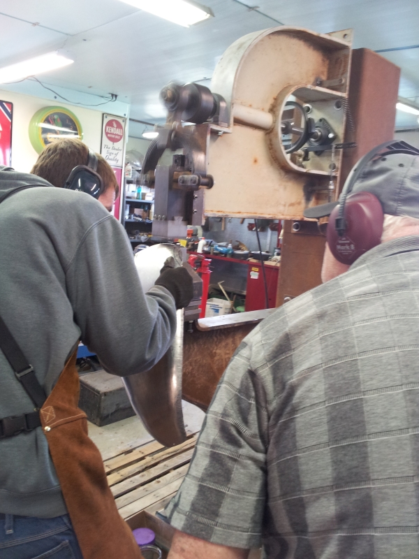

  17. oldgoaly
    Joined: Oct 22, 2004
    Posts: 562
    oldgoaly
    37Kid,
    You can try my Metalcrafter's power hammer out, it gets most of the attention when people visit.
  18. monster
    Joined: Feb 1, 2008
    Posts: 209
    monster
    neat pic oldgoaly
  19. oldgoaly
    Posts: 562
    oldgoaly
    you know that guy????
