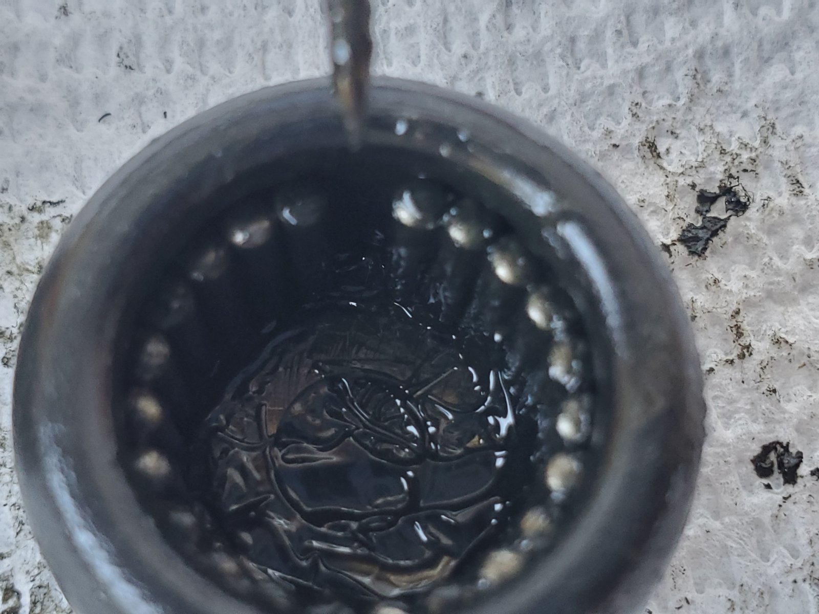

    How many needle bearings should a yoke have? As many as will fit? Or should there be one missing? I know I didn't lose any, it's what was in there. Both are this way.
    Tri-5 rear end in a 53 Chevy.
    The needle retainers (or caps) say ****er on them.
    Sorry for the most likely wrong names for parts, this is the first time I've dove into a traditional RWD rear end.

    Looks to me like your missing 2

    Just one. I took one from the other unit, just to make sure another one would fit. One fits, but not two.
  4. It should be full, you're missing one.
