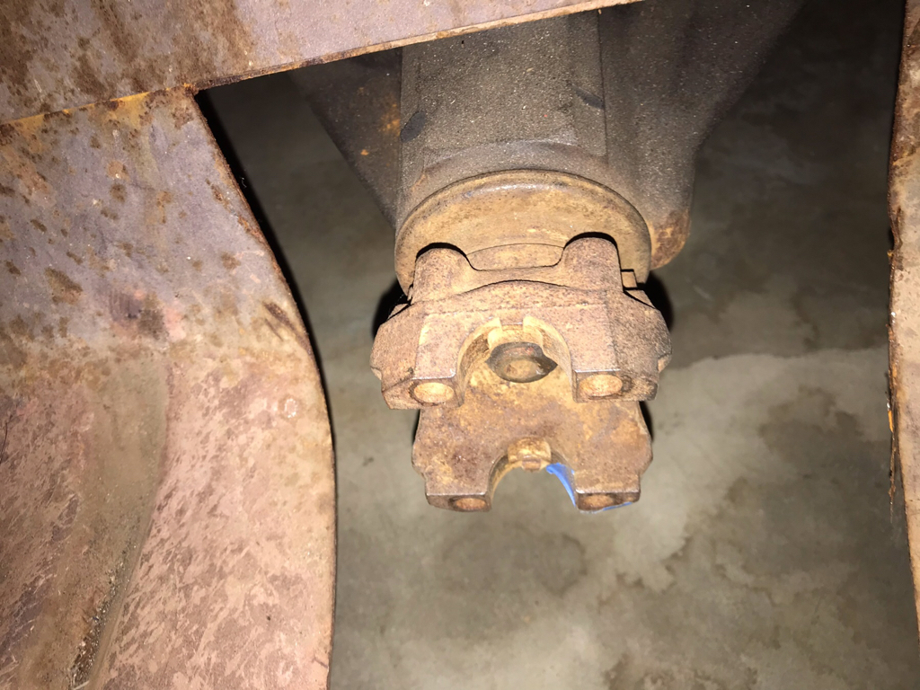

    I’m trying to piece together my 54 Chevy project and ran into some unknowns I’m struggling to identify.
    My main question is: Is this a 1310 style diff yoke? Or how can I tell?
    It has locating tabs and they are about 3.22-3.23 inches apart. There is not a groove for snap rings.
    [​IMG][​IMG][​IMG]
    The rear end is a GM 8.5” 10 bolt. Based on the code JB G230 I believe it to be a 1972 or 1975 car rearend. The gearing seems to match at 2.73
    When I bought the car it had this rearend but had a Buick 300 with an auto trans. The engine was seized so I got a 350 SBC and a Saginaw 4 speed. I bought a 1310 slip yoke to mate with the Saginaw but now that I’m at the point of having the driveshaft cut down I’m realizing that the U-joints on the shaft don’t match a 1310 style.
    I’m now planning to go get a 1310 style driveshaft from the junkyard but I’m not sure if I would have to change the pinion yoke or possibly use a combination style U-joint.
    I’m hoping that the pinion yoke is a 1310 style and I can just get a driveshaft to match so I don’t have oddball U-Joints.
    For what it’s worth, the drive shaft has inside C-clips on the U-joints and was installed on the Buick auto trans. I think it’s possible that someone mismatched the rear U-joint. The car came out of a pasture and I don’t know if it was on the road with the Buick drivetrain.
    Any suggestions are appreciated!

    I work in a driveline shop. Your differential yoke IS a 1310 series. Your driveshaft is a GM 3R series. From experience, I can tell just by looking at your pictures. You can get a conversion u-joint to mate your driveshaft up to your pinion yoke. ****e part number 5-3022X is what you need. I hope this helps you.

    You're missing a couple caps on that rear u-joint from the looks of it. You wouldn't need clips on the rear pinion yoke, those tabs keep the caps from coming off the u-joint and keep it centered in the yoke; all you need are some caps and some u-bolts.
    Oh, and u-joints that aren't square are called "******* joints" and there's lots of them. A parts store where you know the guy behind the counter will have a book you can look through to get exactly what you need, though I'd start with what 78Magnum said up above.

    Thank you for the responses. I was out in the garage last night with the Denny’s Driveline info measuring my parts (car) with a caliper and the 1310 seemed to fit the diff yoke. 3R looked like my driveshaft u-joints.
    Wanted some confirmation from folks with more experience than me. As usual, I now have a lot more info than I started with!!!!

    This is exactly what I was hoping for, someone with daily experience to kick me in the right direction. I hadn’t removed any of the 3R joints yet so my measuring was a little limited. The rear joint caps disappeared when I removed the shaft back in 2015.
    Looks like I have two good options. Since the shaft needs to be shortened I can have that done and use conversion u-joints at both ends or try to find a 1310 style driveshaft in the boneyard, with any luck, the correct length.
