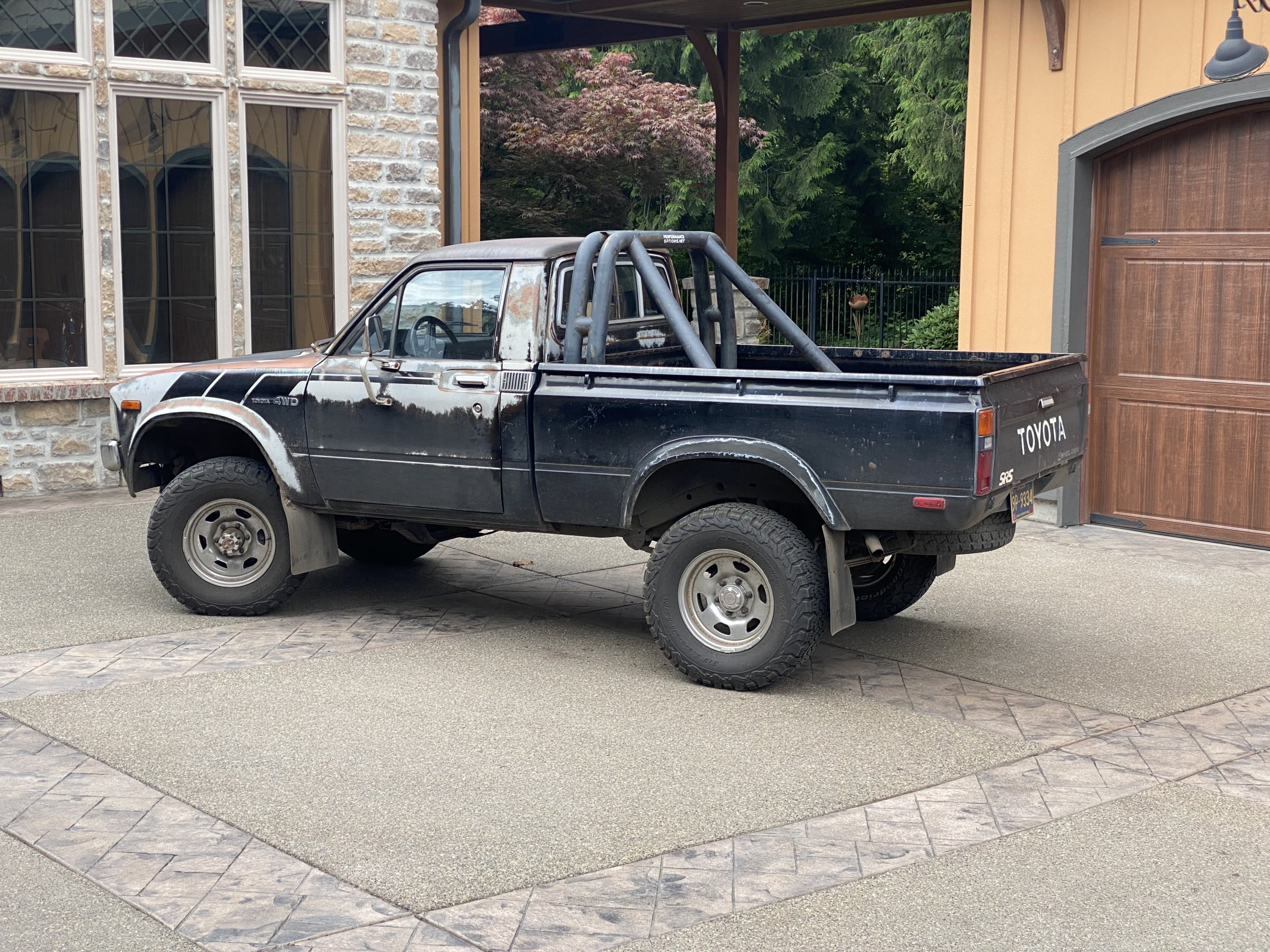

    My daughter has roped me into helping her restore her pickup. Fun father daughter thing. I’ll post some picks as we work on it
    The majority of the work will wait for spring as this her daily up on Mt Hood (major snow board bum). But before it goes home I had a few projects to attend to do it doesn’t deteriorate further.
    The truck is a 81 Toyota SR5, 4x4, short cab/short bed. Factory black with very thin paint…let’s face it, rust. She wasted to apply pappy’s patina to it. I told they would great as the metal rots out from under it. Soooo, we are painting it. We will go base/clear gloss black, factory decals unless dad gets a hair and paint them on.

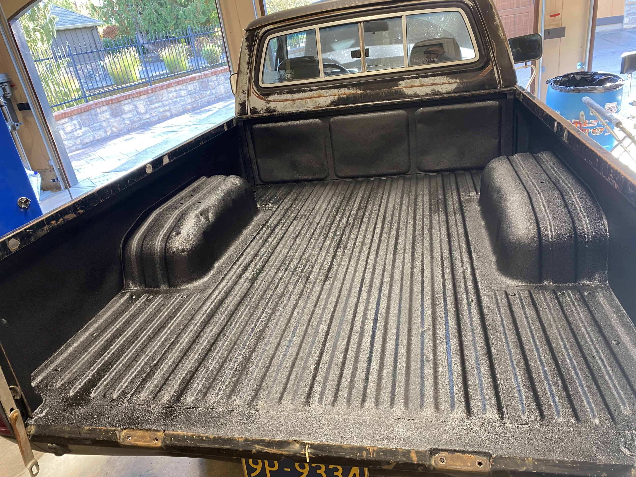

    The bed is rusty but it’s just surface rust.

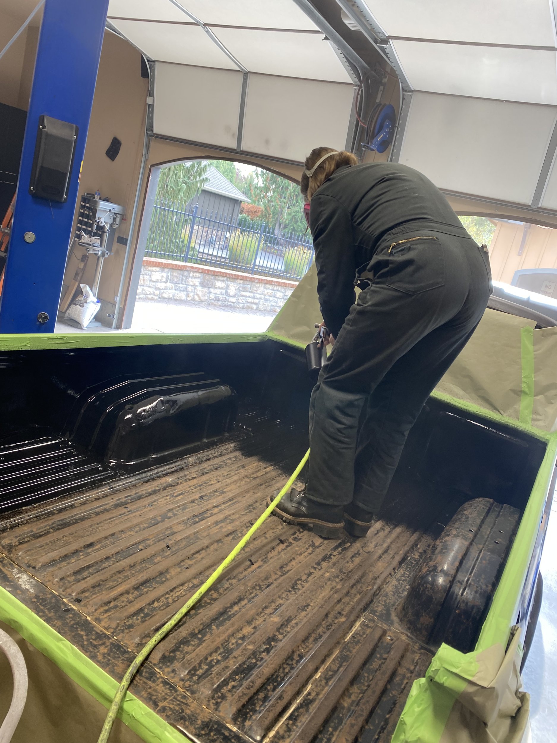

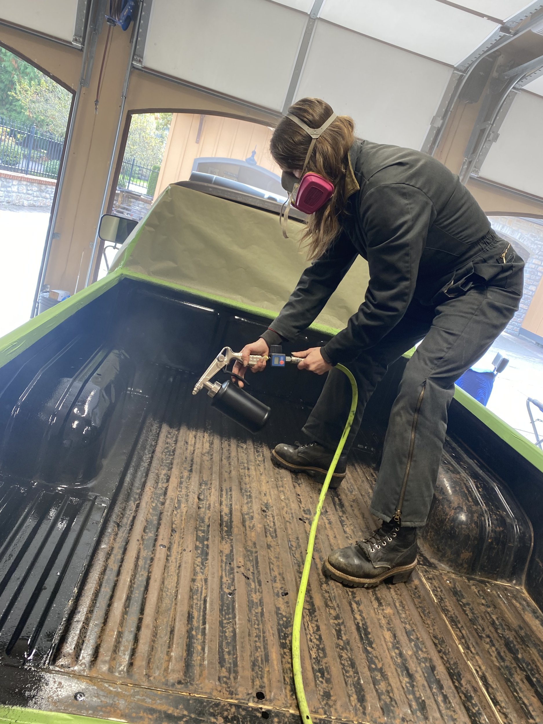

    my daughter jumped up in the bed and applied Por15 bed liner after wire wheeling it. She said it was her new favorite tool.

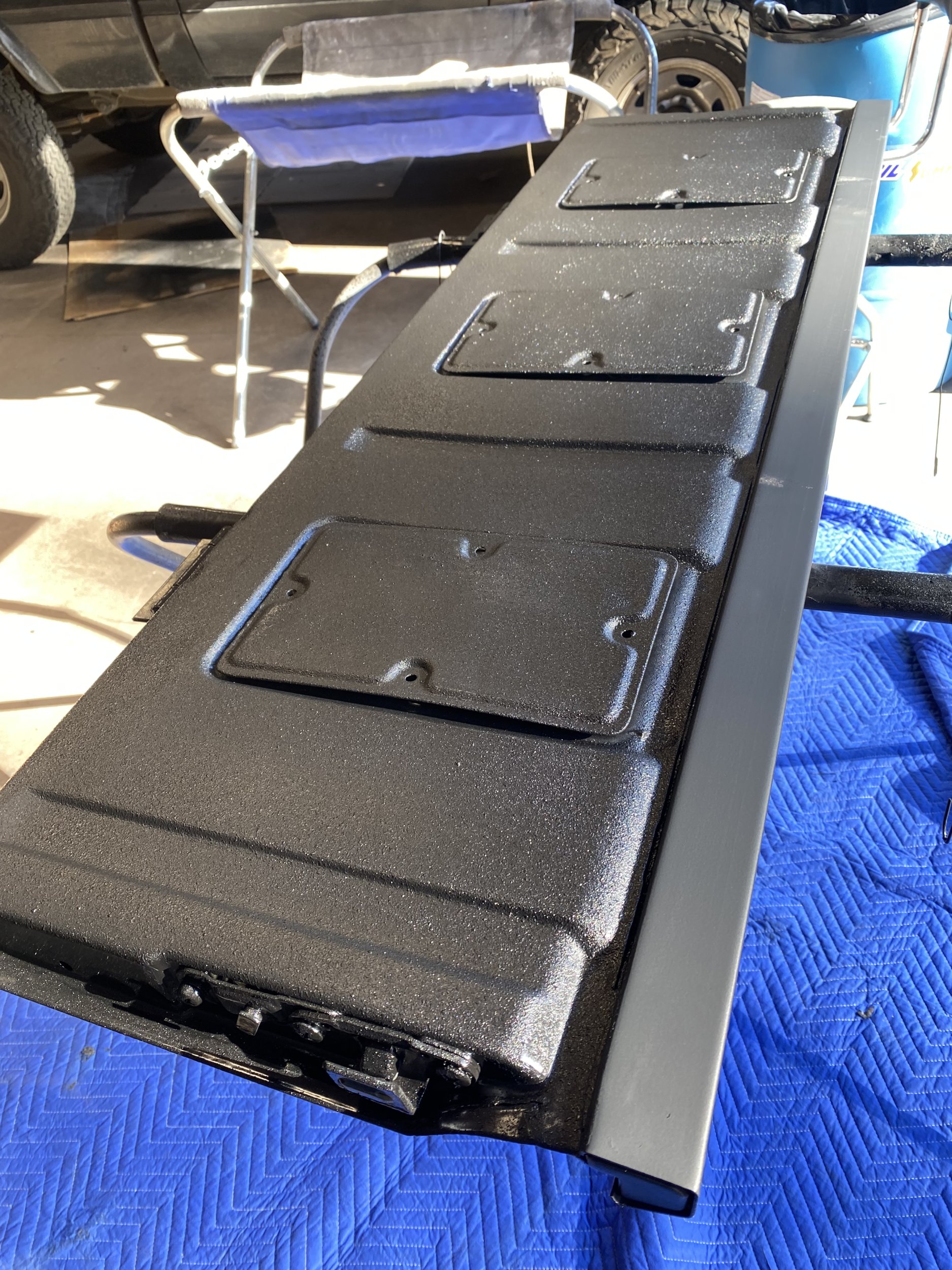

    Dad was not happy with the Por15 finish (too shiny and blotchy) so I wait the 24 hours recommended and top coated it with Raptor Liner.

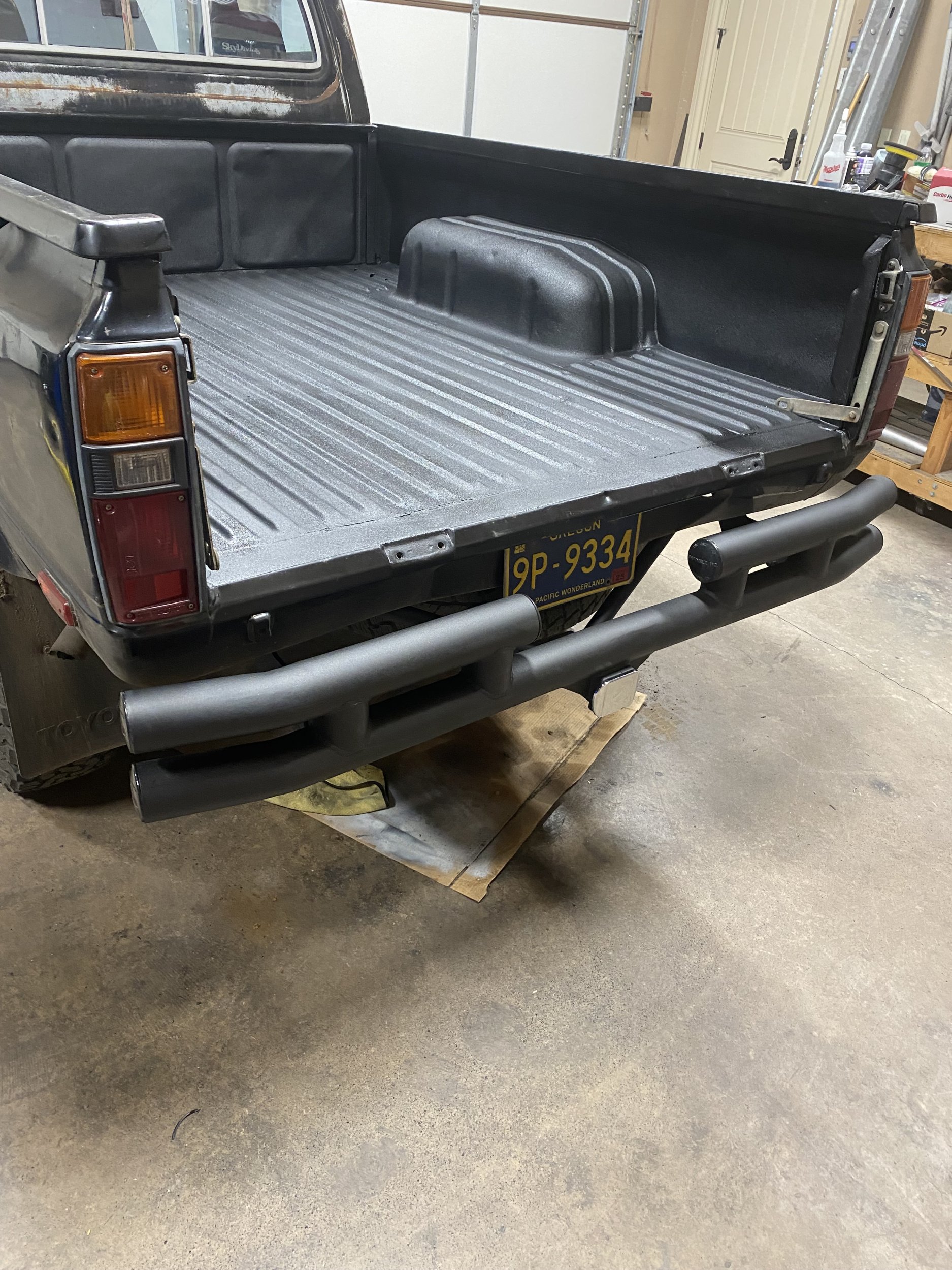

    I recommend it highly. I applied with a schutz gun, turned out nice. The truck has aSmittybuilt tube bumper in back but it was rusty and dented. I spent some time welding on new end tubes and had it power coated.

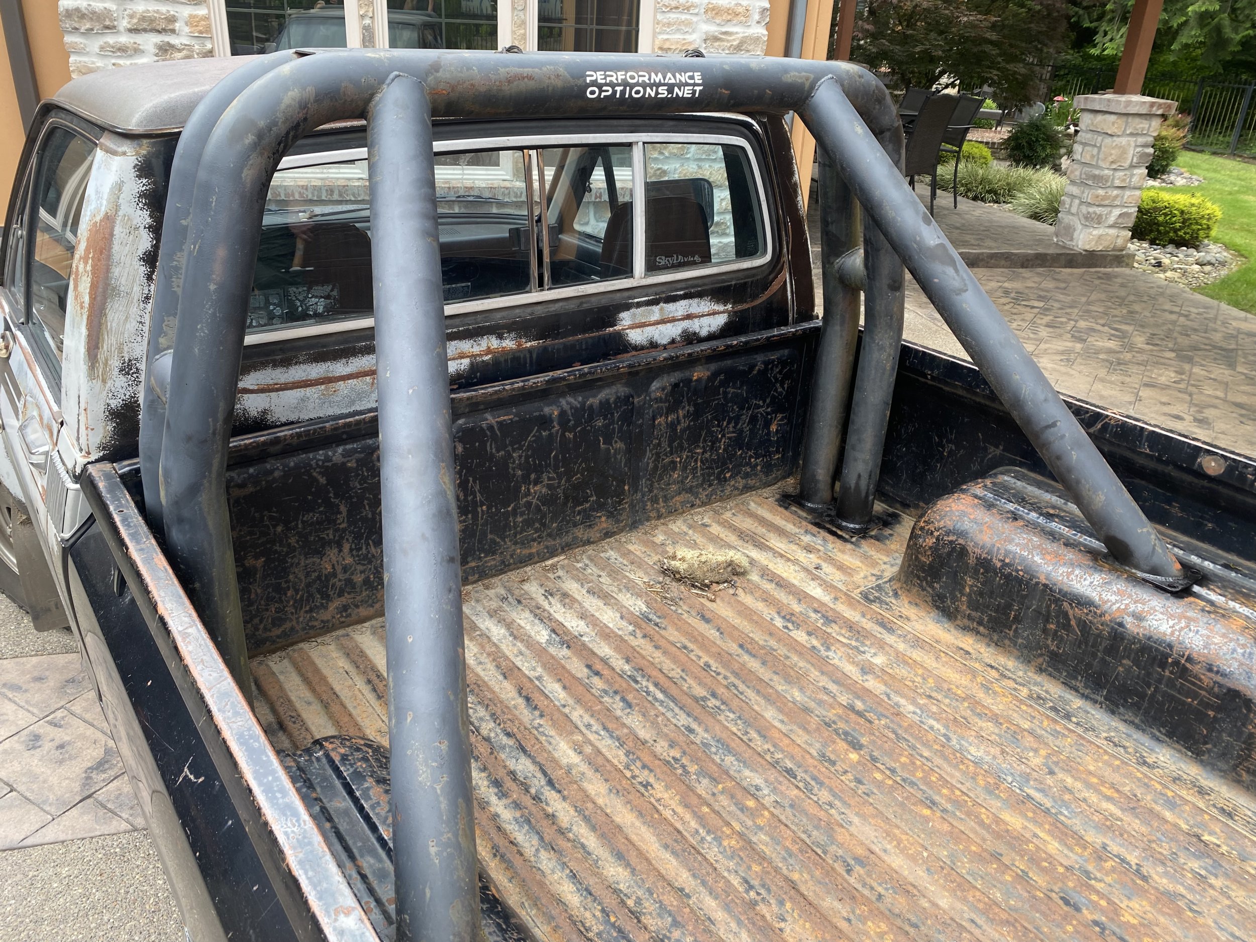

    And while I was at it I found her a roll bar on FB marketplace that matched the bumper.
    it also had a bit of rust on the tube bases that I had to weld up and it too got powder coated semi flat black wrinkle like the bumper.
    And I picked up some old school KC Highligthers for the bar. Not those new LED lights, she likes them old school as well.

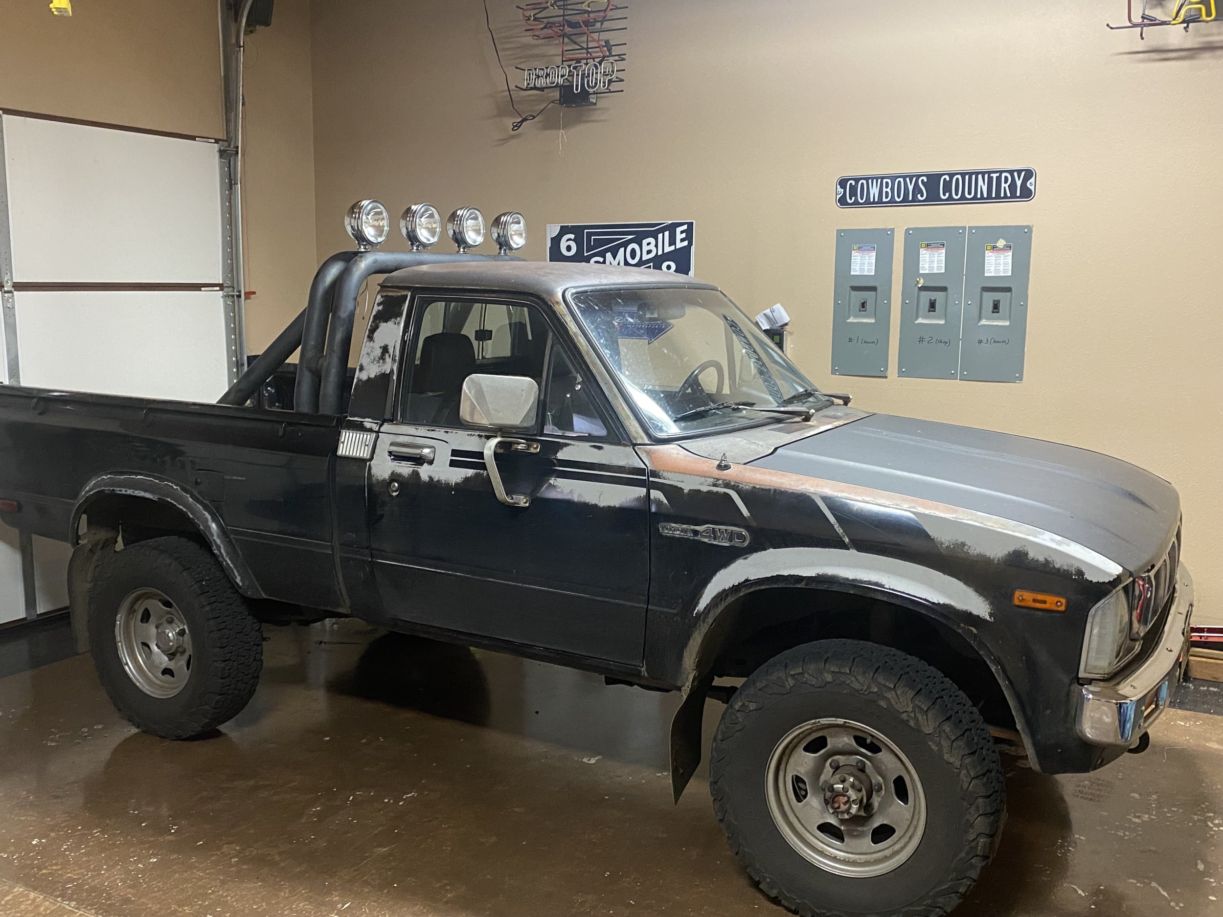

    The plan is to have her pull out here in a couple weeks with the roll bar mounted, lights wired.
    I already worked the tail gate over and it is in heavy epoxy primer for winter. I need to top the front fenders and the roof still. I applied rust mort to those areas, just need protection from the PNW rain and snow on the mountain.

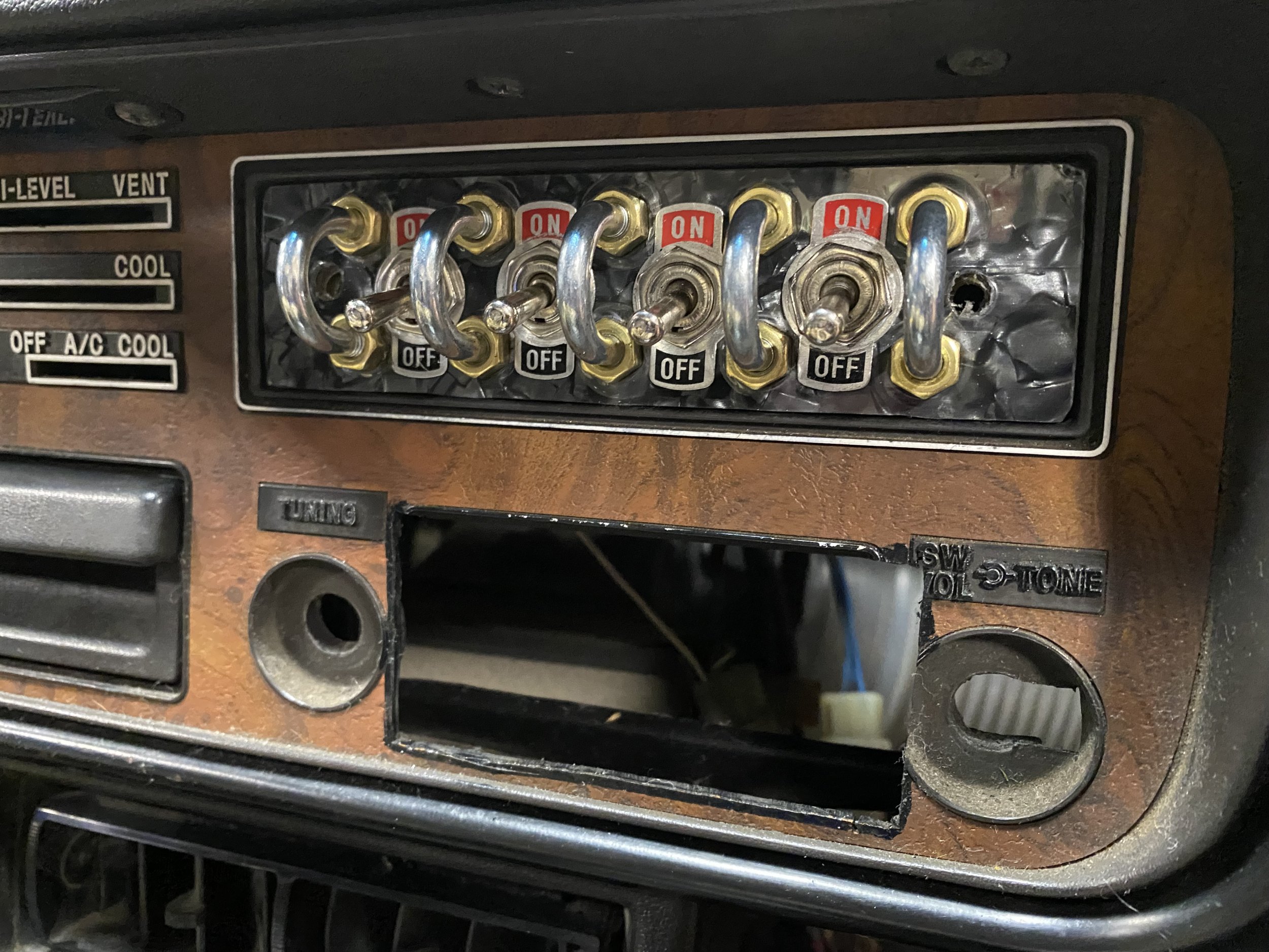

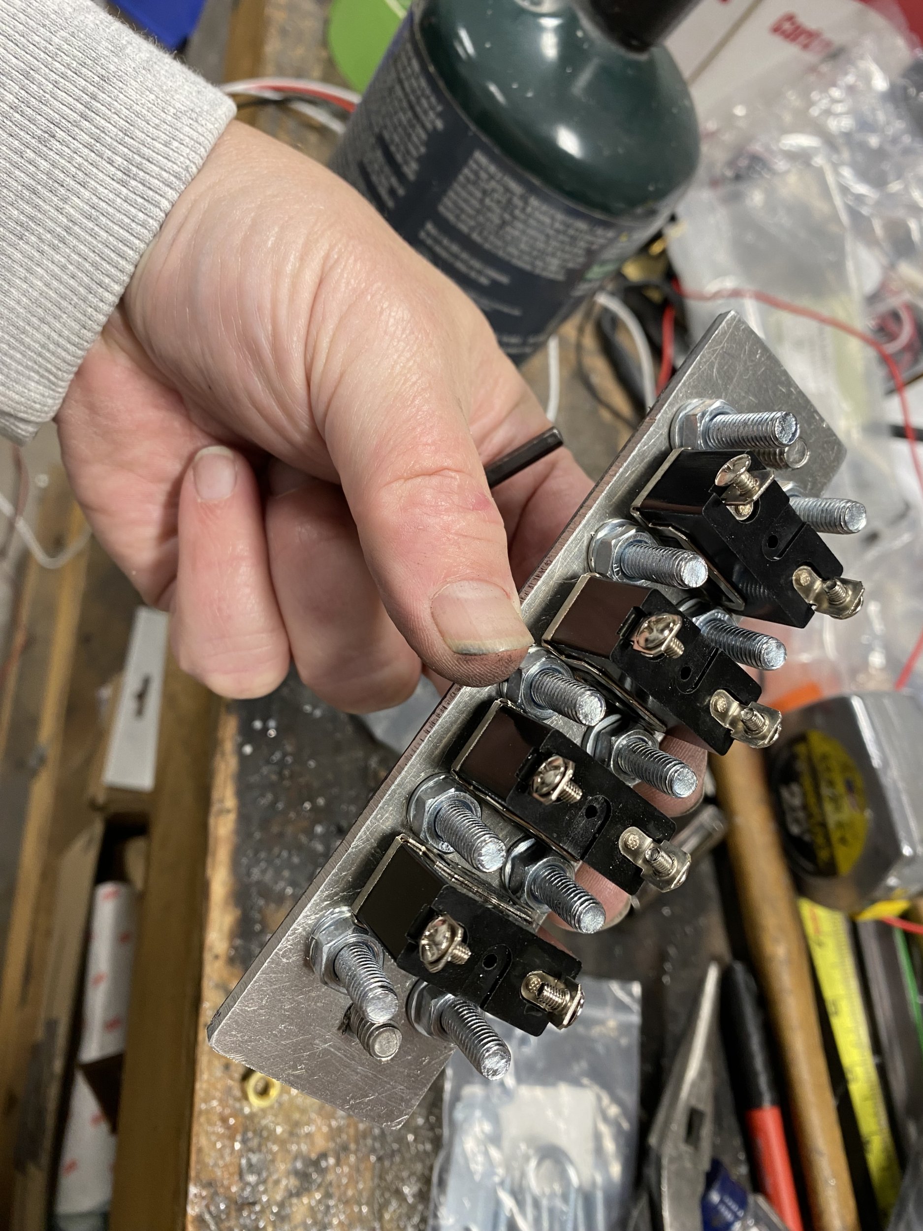

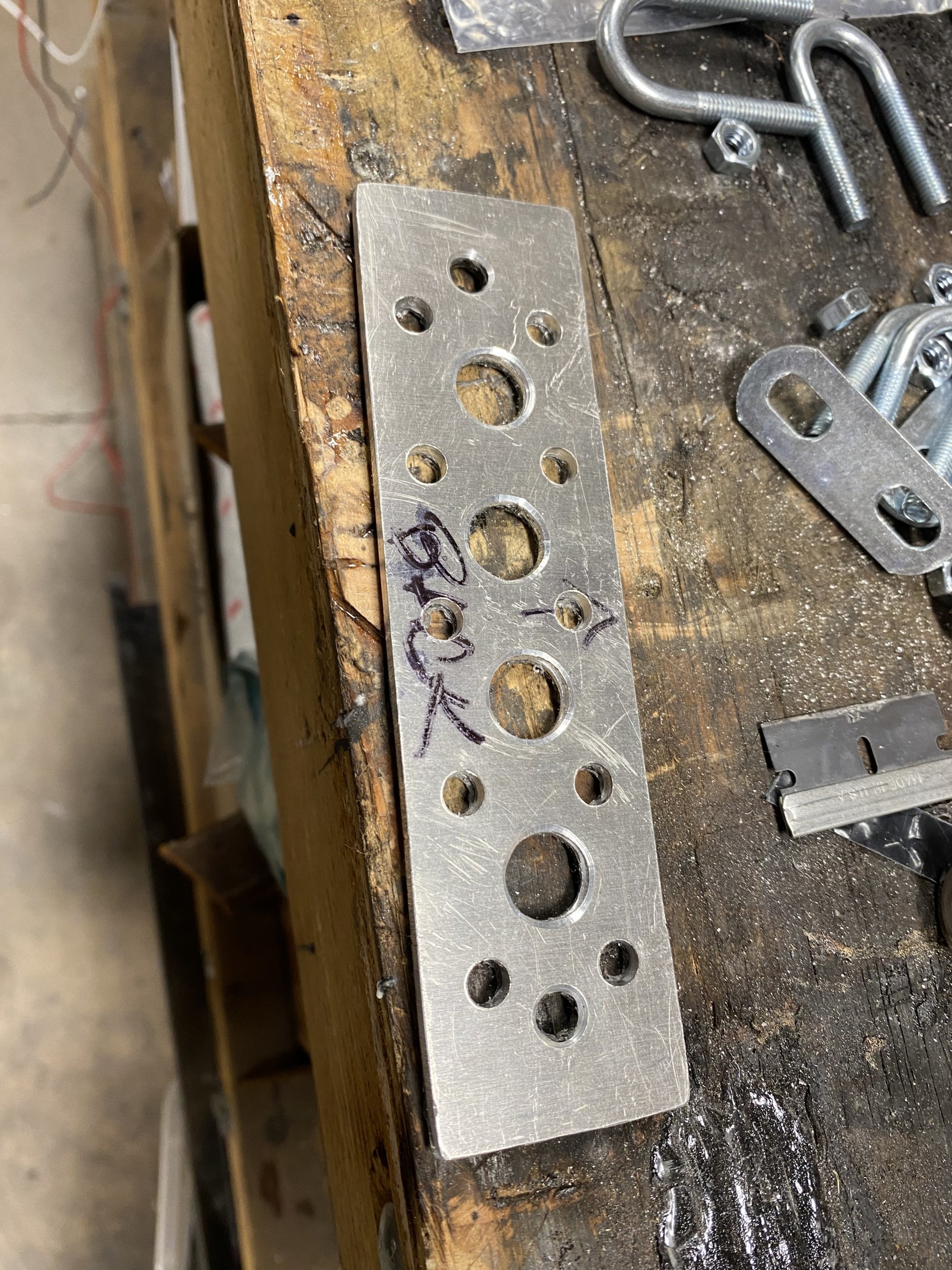

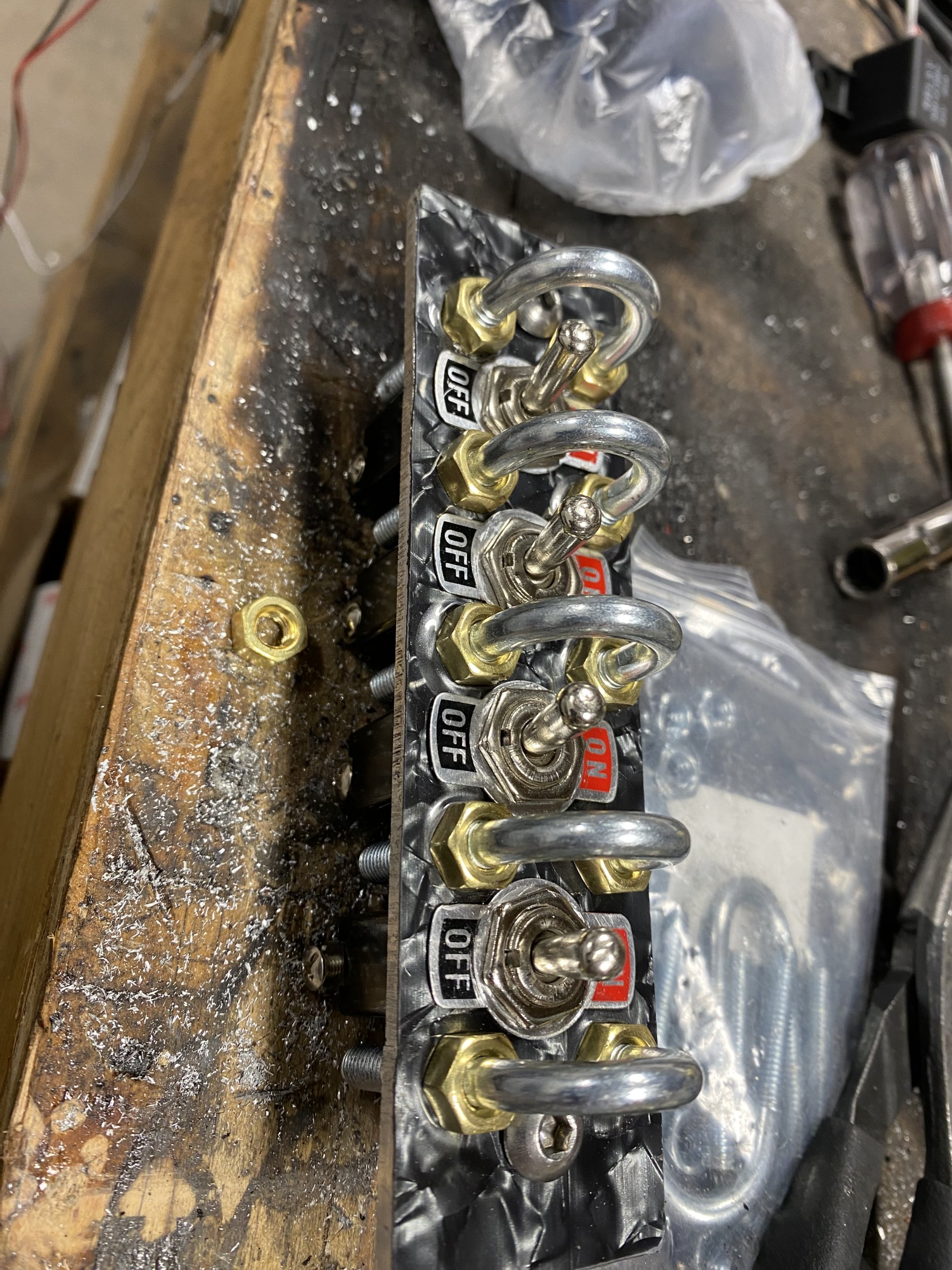

    But back to the wiring, I needed to build a switch panel inside the truck for our accessories. There was a plastic pocket above the stereo (that didn’t work) so I chose that spot and fabricated a couple little brackets and rivnuts to secure it.
    I had some aluminum plate with I cut to size and drilled a shot ton of holes in it.
    For four toggles and those little u bolts in between them. I had never done that before and I wanted to do I did.
    she plays guitar so the pick guard was apropos. I bought some br*** nuts just to dress it up a bit.
    Tight across the back. I had to index the nuts to get the toggles to clear. Note to self: leave more room next time.

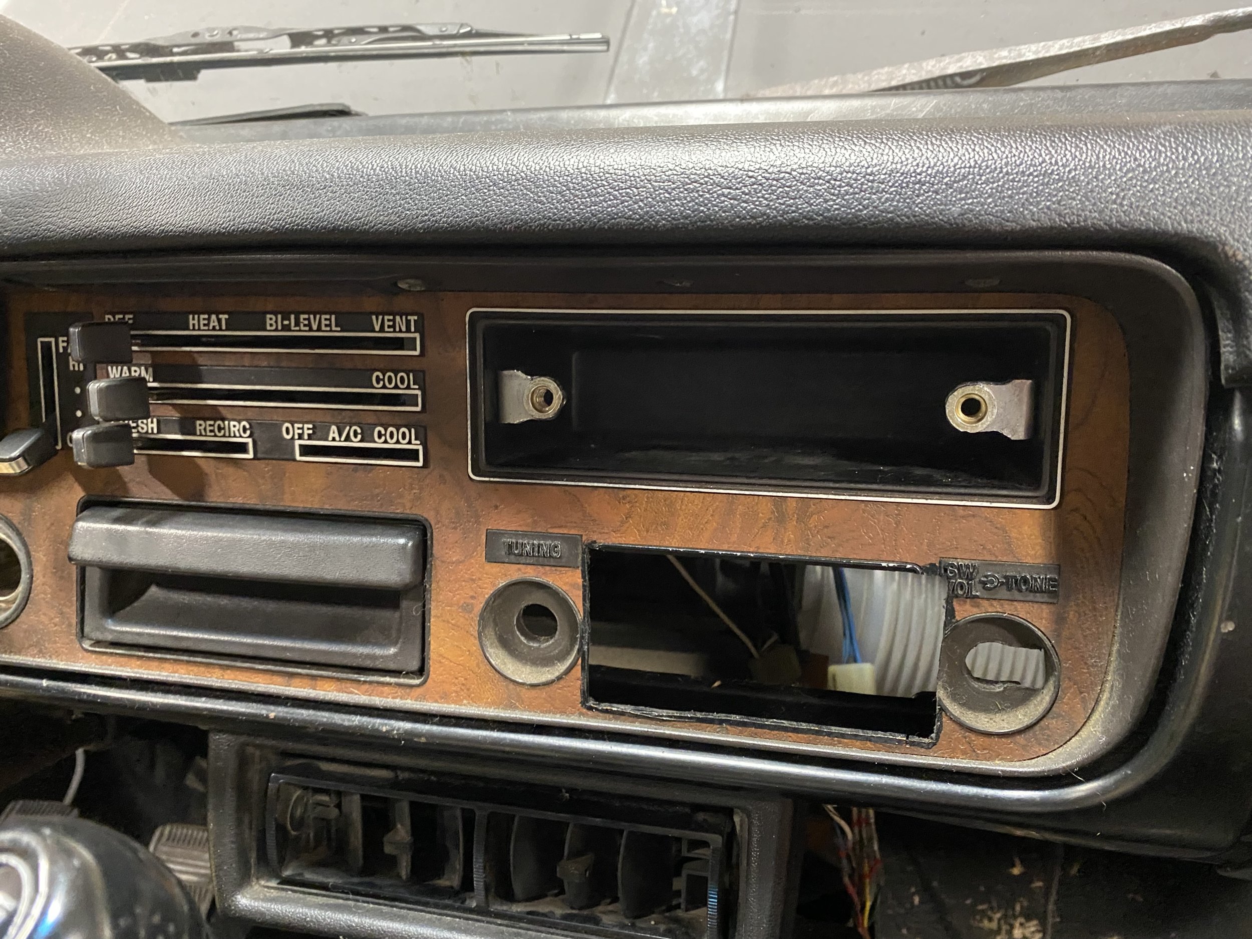

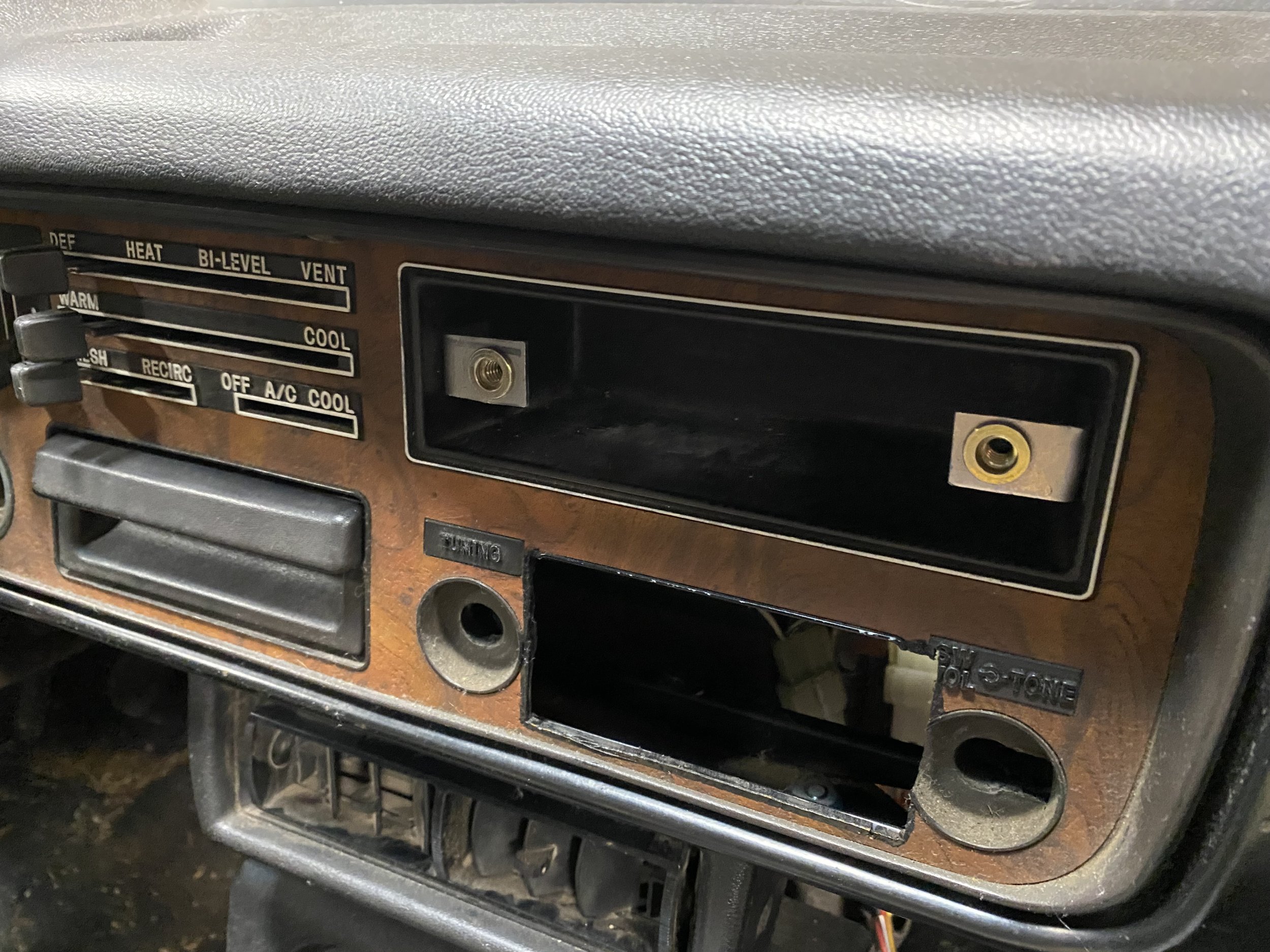

    But, a cool looking panel to run her off road lights from. To fill that hole below it I sourced a Sony c***ette deck (with shafts) that had never been installed (the plastic "carriage key" was still inserted in the deck from shipping). I found it on CL this summer for a C note. I’ll throw it in real quick while I’m working on the wiring.

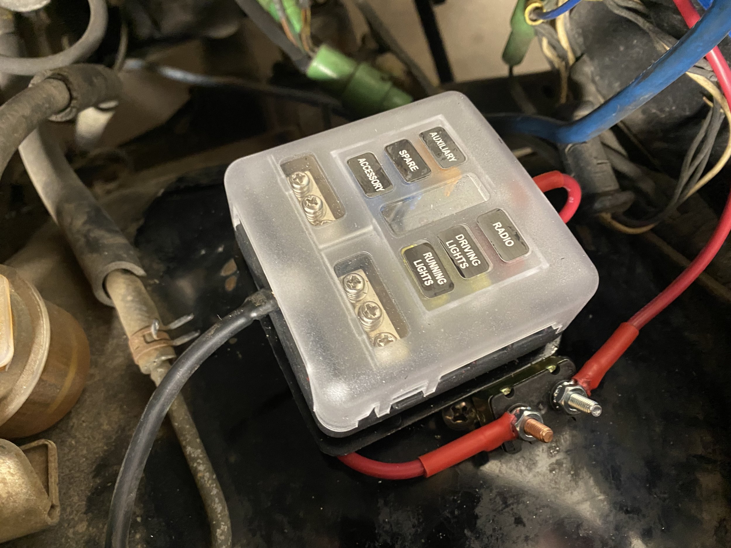

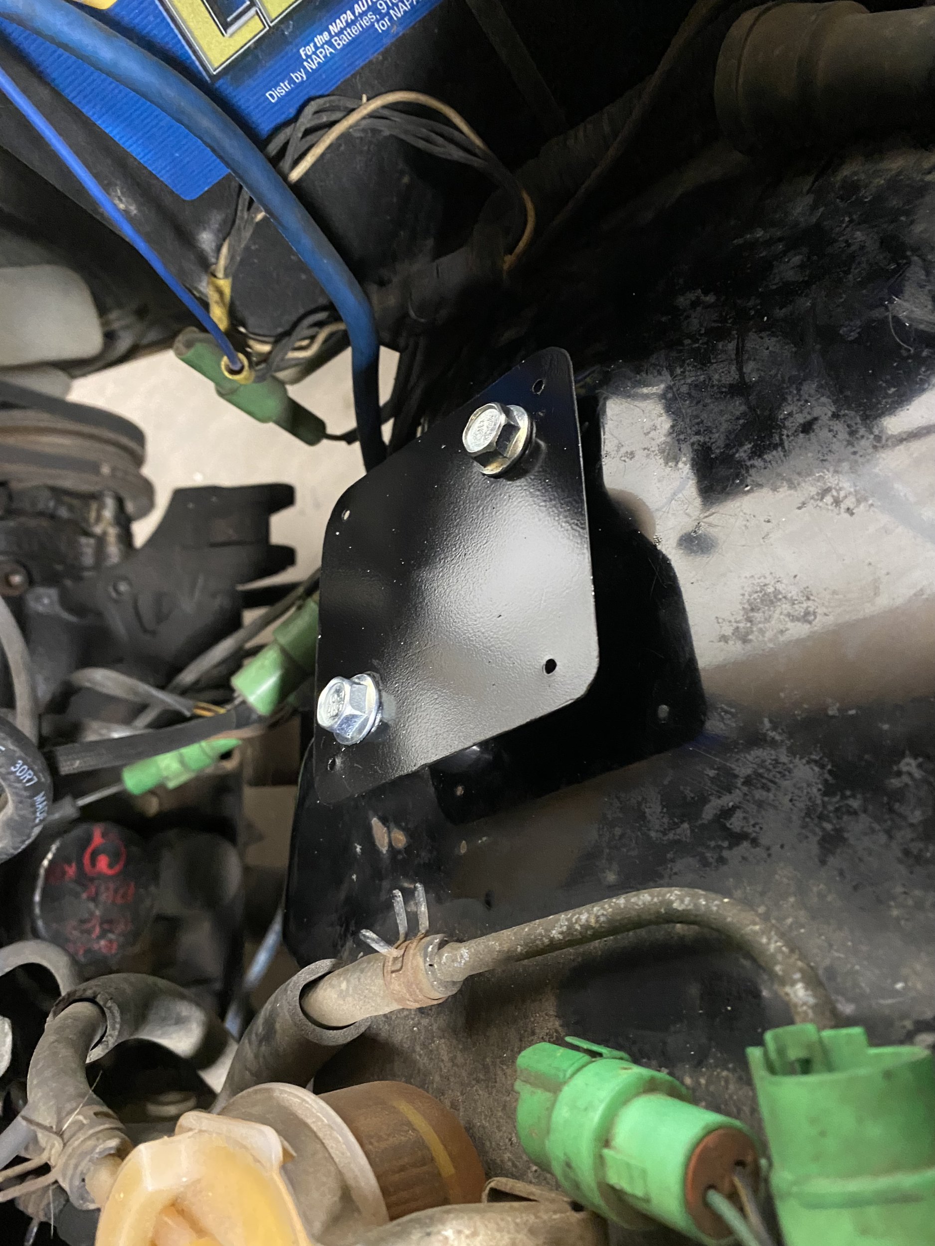

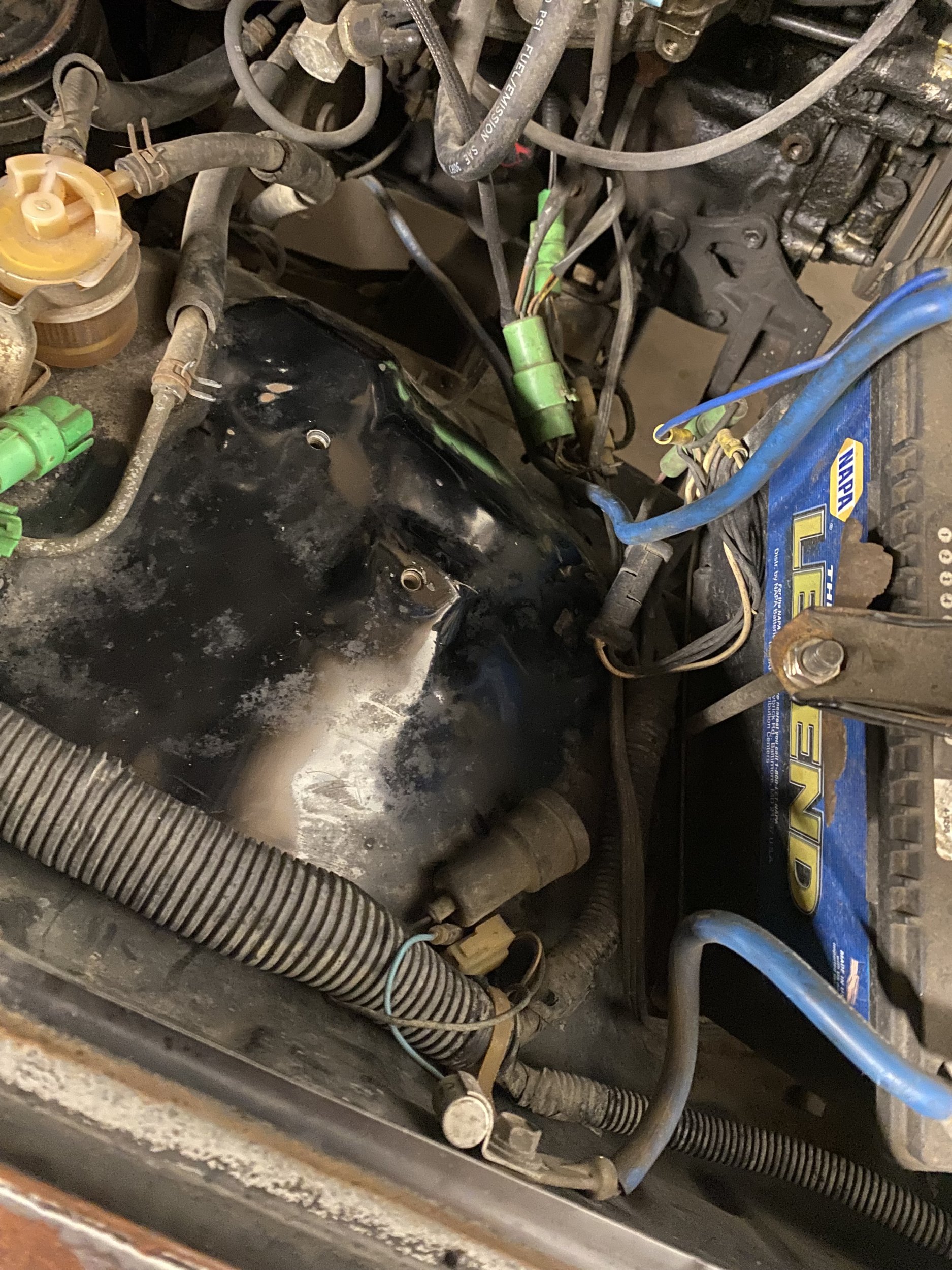

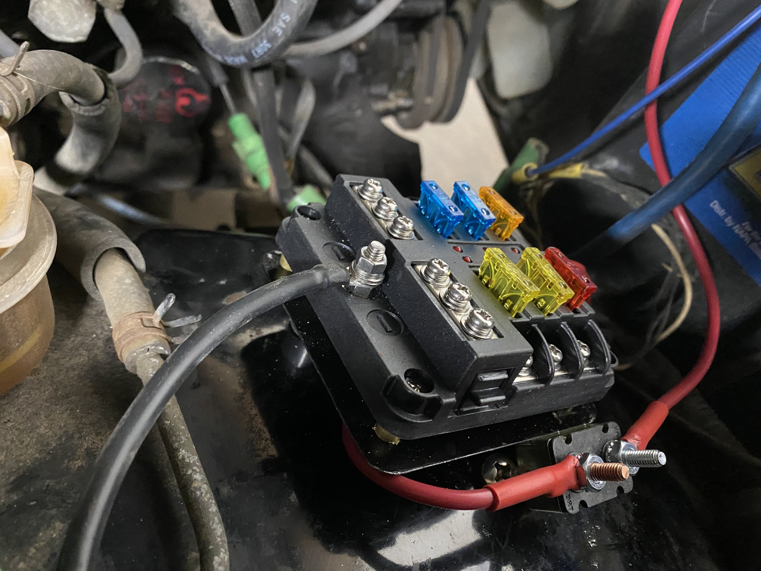

    Added the accessory fuse panel I was thinking about. There was a nice bit of real estate adjacent to the battery.
    Two tapped bolt holes sitting there. I made a steel plate and some spacers
    That will elevate it so water runs under it and I cut up some spaces to elevate the panel as well mainly due to the heads on those mounting bolts. I didn’t have metric flat heads so I danced with what brung me.
    Added a breaker for protection. This little panel has a ground buss so I’ll run the ground here from the lights to make it easier to diagnose future issues.
    Even came with a plastic cover, not Weather tight but Ito keep some dirt off it.
    Next up is to do some cabling My daughter is under the weather herself so I am taking care of the minutia of wiring details.

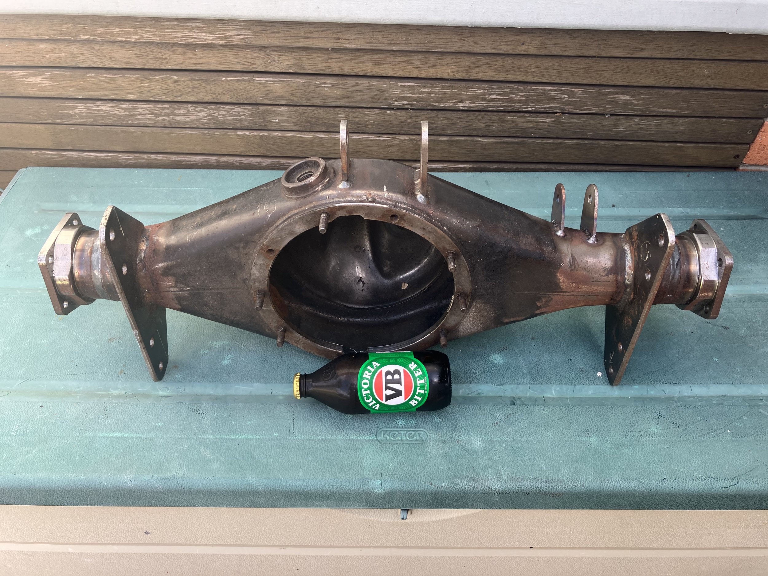

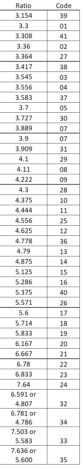

    The Toyota G-series diffs are well built. In Australia, they start out like this:
    We then feed them VB and Bunnings snags* and they grow into full size Hilux diffs :D
    In all seriousness though, they are a good diff for moderately powered racing (up to about 500hp). This one I had cut down from a full size Hilux/HiAce unit for my FED. It ended up with 4.7 gears, Moser axles, full spool and Wilwood disks. Should be fun.
    * Bunnings is an Aussie big-box hardware store. They are reknowned for supporting local charities/sports clubs by allowing them to hold BBQ's in the hardware store car park. A "Bunnings snag" is a grilled sausage on white bread, with onions and either ketchup or BBQ sauce. Debate rages about whether the onion goes over, or under, the sausage.

    In Australia we are indifferent to politics or religion, but are polarised by sport and the correct order for onions. Attached below the factory G-series diff ratios for interest.
    Cheers,
    Harv

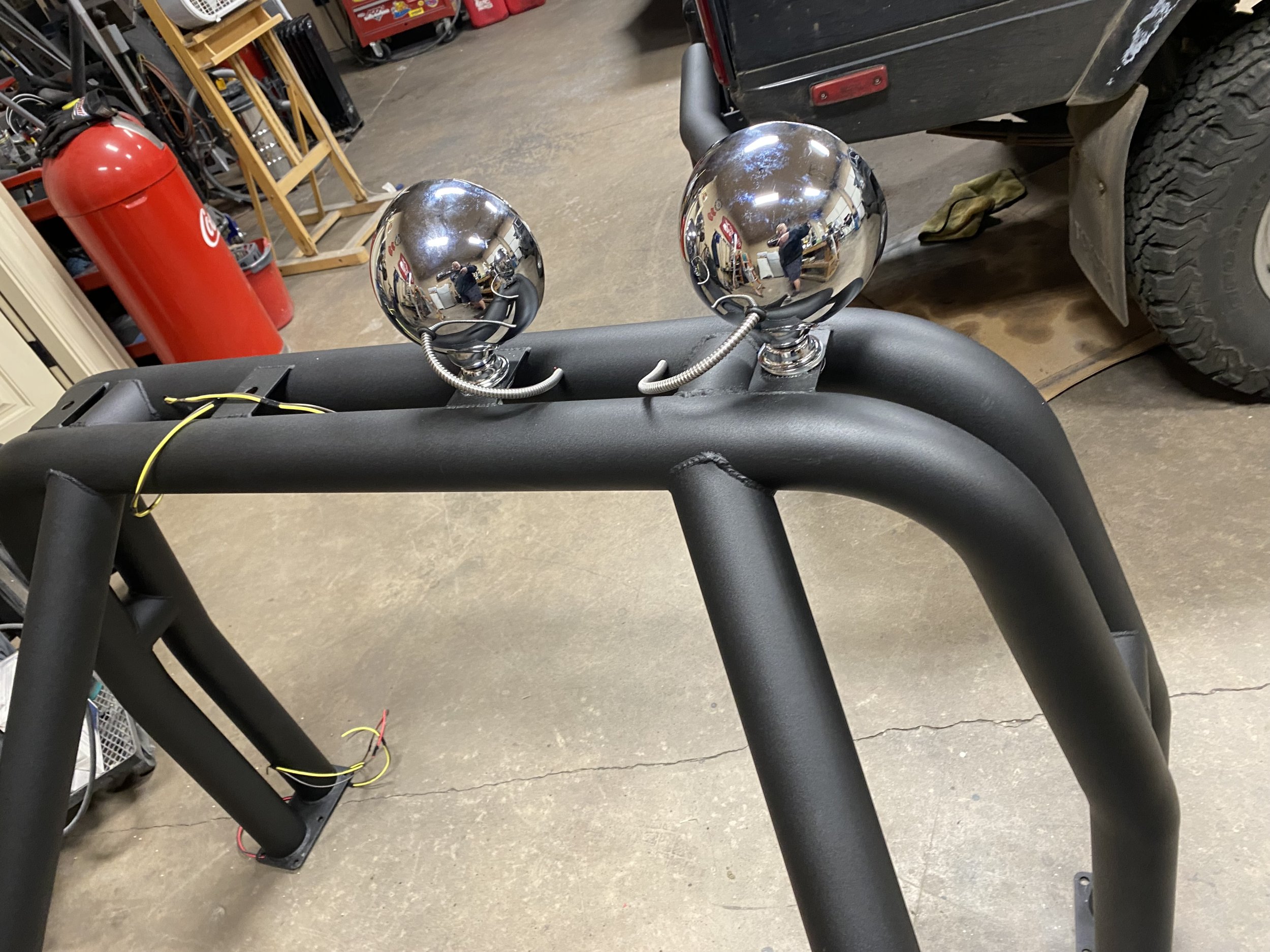

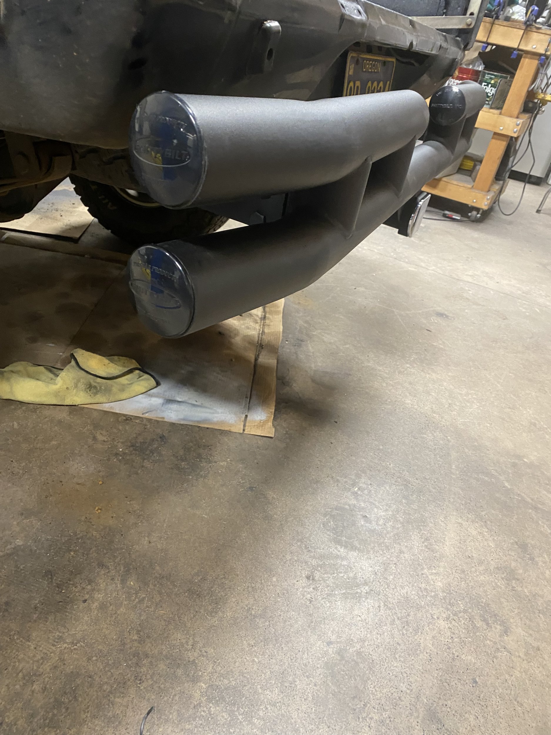

    I had a little time after work to lug the roll bar around to the back garage for wiring and comment of the off road lights.
    The lights ran the wire down the inside the install bolt which made install a PITA! So I installed them the way I did on my dune buggy, drilling the back of the reflector and running the wires inside SS conduit.
    It looks nicer, looks old school, easier wiring inside the bucket with bullet connectors for easy bulb replacement.
    2 down.
    My powder coater knocked these pieces out! He had them out the door in 2 days for hardly more than 5 cans of spray piss.
    I ran out of grommets. Always something. Oh well Thursday night football is on and there is ice in the house.
