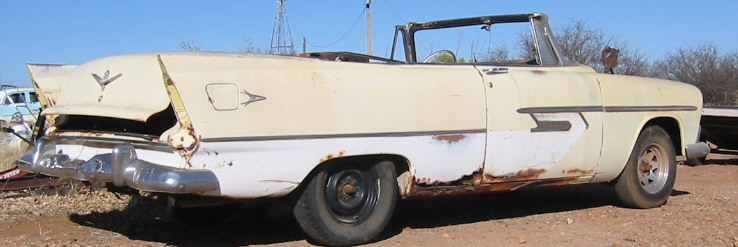

    yeah, I DO know how good we have it!
    the only cars I've seen from here that are in that bad of shape are convertibles that set out in the desert for a few decades. here's one I had and sold to a guy in illinois who figured it was restorable. this is a shot that makes the car look nice, the whole floor is gone out of it
    also a friend restored a 54 olds convertible, same situation, he had a donor to replace the floor, rockers, trunk, lower half of the firewall and quarters, etc.
