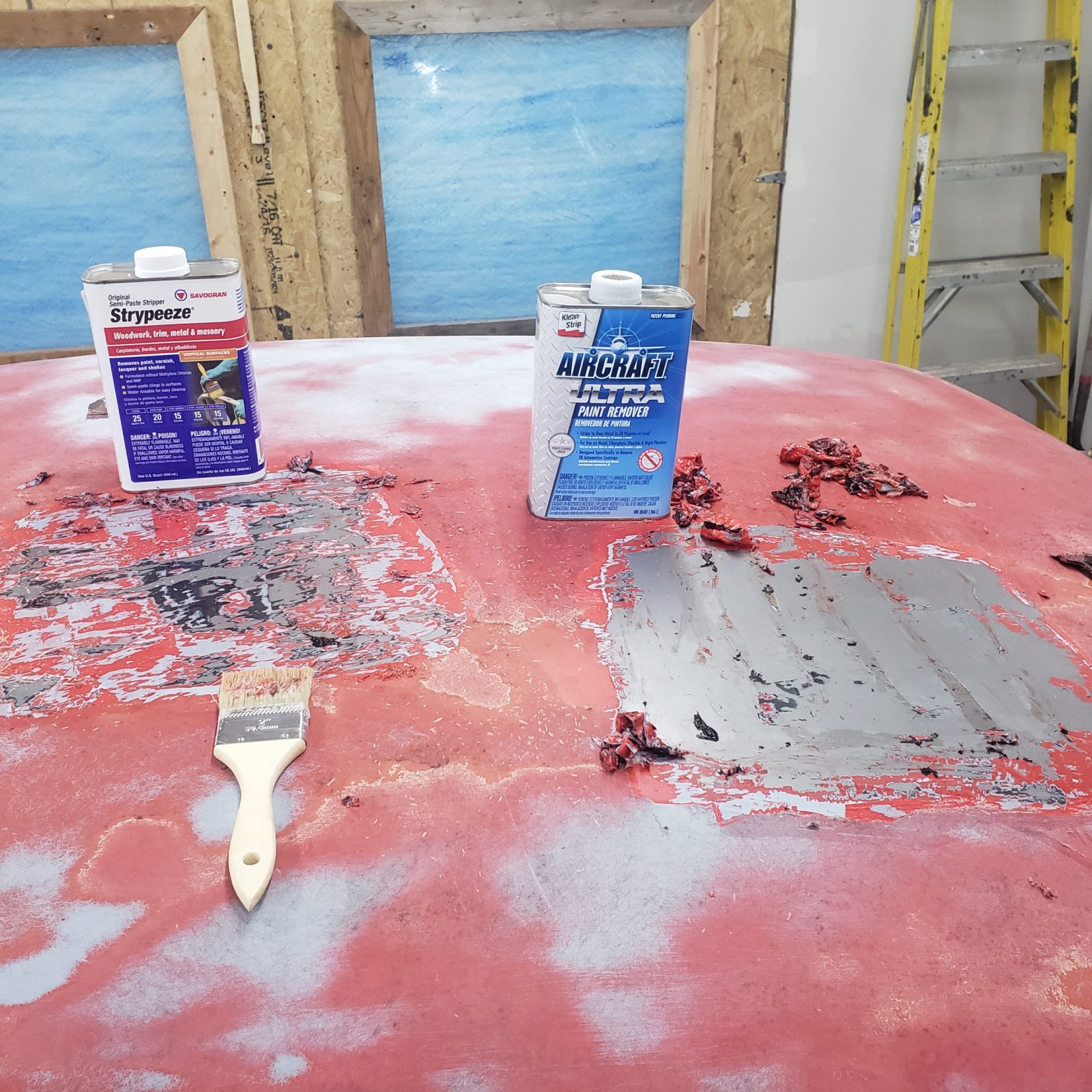

    OK I have somewhat of an update, the powder coating stripper is $415 plus hazardous shipping for 5 gallons. Well worth it if it works as well as it's said to. I didn't order it, yet... but I did stop at the paint supply store today, and he has the ultra aircraft stripper, I laughed and said yeah I'm sure that **** works! He ***ured me that it does. So being the ****er that I am, I popped $25 on a quart. Well I'm here to say it works. It works great. It burns your eyes and you've gotta ventilate. I'm here to tell you, I'm happy. Here's a picture. The left is the strypeeze, 5 applications, and the right is the aircraft, 2 applications. This car has had 3 paint jobs, and the last was base/clear. Somebody back in this thread mentioned this stuff, well, bygod it works. 20240312_161425.jpg

    That looks good, Lloyd, thanks for the picture. FWIW, I like Bambi and the saber-tooth mosquito. I don't have anything against Californians,either. Apropos of nothing, I just got a headhunter ad for a job paying twice what most areas do plus a $90,000 signing bonus. But the jobs are in San Diego and LA and I'm probably way better off here!
