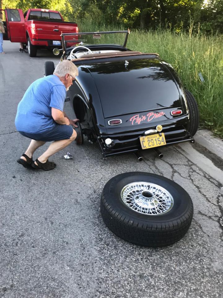

    So, this happened. Evidently, it's a good idea to:
    A. Use a lead mallet rather than a rubber mallet to tighten knock-offs, and...
    B. Retighten knock-offs after the first 100 miles, and periodically thereafter, and...
    C. Shorts and sandals makes one look goofy putting a wheel back on your car by the side of the road with a borrowed jack, and finally...
    D. Carry a jack and a the aforementioned lead BFH in your trunk.

    do the right and left side knockoffs have left and right threads? and are the on the correct sides?

    Yes, per the markings on the hubs and the knock off's. RH on the left side, LH on the right side. That seems backwards to me, from the perspective of having snapped a couple lug bolts on early MOPAR cars...

    When I worked at a restoration shop, we used a lead block and a rubber mallet. That way it still got tight, but you didn't wreck the paint if the mallet touched the car.
