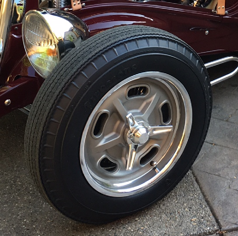

    I'll just leave this here. No, wait, I'll put it back on the car.

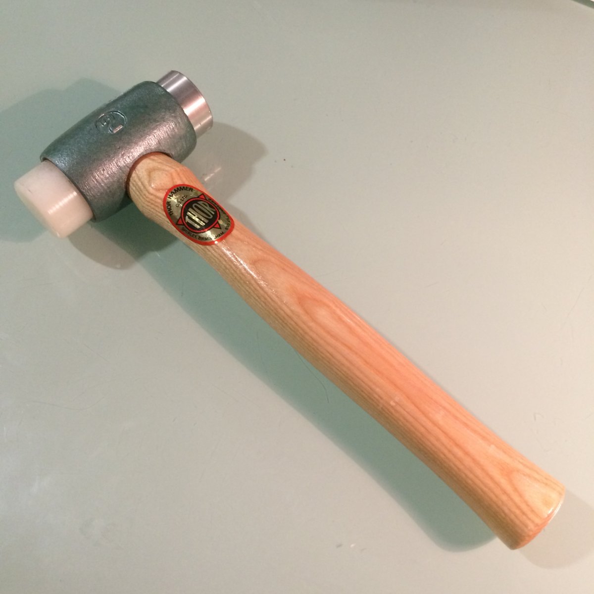

    This is what we had at jag for doing knock offs a THOR HAMMER
    one side raw hide one side lead.
    Beat those basterds on, 2 days later have the customer come by and recheck
    And any time they wanted or oil change etc. After that
    Never had one come looses but smart to recheck periodically

    Posts: 26,948
    Stogy
    Van that's nylon...or some other hard plastic...
    Heck these knockoffs are a lot of work...mind you installing and torquing wheel nuts ain't exactly speedy and not without it's own grunt factor...​

    Forgive a dumb question, what are these "hub clips" of which you speak?
    Bandit Billy likes this.
  5. flynbrian48
    Joined: Mar 10, 2008
    Posts: 8,647
    flynbrian48
    Answered my own question. Looks like the pin drive hub extends beyond the center of the knock off when in place, the clip snaps over the hub center. My knock off's aren't open, so I think some drilling holes in one end of the knock off and some safety wire is in my future. ;

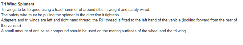

    @Atwater Mike , doesn't this instruction mean the righty tighty spinner on the left (passenger) side?
    That is contradictory to what @sliceddeuce just posted isn't it guys? Or am I confused? I would really like to know I have them mounted correctly.

  16. flynbrian48
    Posts: 8,647
    flynbrian48
    Per Dayton Wheel, and the stamps on the hubs and the knock offs: the drivers side (left side standing in back of the car facing forward...), use the RH threads. The passengers, right side, uses LH. The spinners are tightened, wing up, by driving them to the rear of the car. The key thing I didn't do was to re-torque (i.e. smack them with a BFH lead hammer) after the first several miles.

  17. Hey stogy
    That’s a pic of the interwebs, the one we had was old and looked like a cartoon hammer it was so big
    One side was raw hide
    And not sure if it was a jag tool or something that was made as a shop tool, but it was a big hunk of aluminum that was cut out to fit on the knockoff perfectly and had to wings coming off either side to hit on ( looked like a giant wing nut ) so you got a bit more leverage with your hits and did not mark the Knockoff
