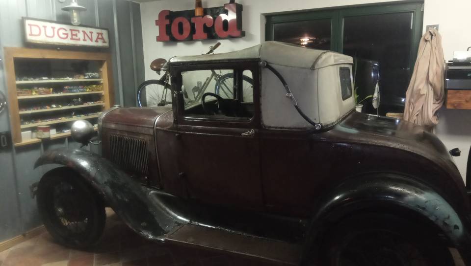

    Hello fellow Hot rodders!
    My name is Axel, i’m 21 years old and live in southeast Sweden. I own a 30 model a coupe and wich im about to turn in to a traditional av8.
    So first some background history. I bought the car in winter of 2016 maybe it was january 2017 i cant remember the exact date. I had been looking for a model a roadster or coupe for awhile when this popped up. Filled up my daily driver with gas and my wallet with money and one day later i had myself my first old car.
    The car was bone stock except for hydraulic brakes.
    It didnt stay stock for to long. I think two days after i got the car home i started taking things of that i wasnt gonna need such as fenders and so on..
    Bought a setup of 16” Ford 35 wire wheels with firestones 7.50 in back and 6.00 in front.
    Put two stromberg 97 on a Riley intake, modern style distributor from an old Volvo,
    Reversed eye spring front and back, and a pair of 39’ taillights.
    Had lots of fun with the 4 banger for a couple of years until late this summer when i decided to drop a 59’a in and turn it in to a ”real” hot Rod.
    And that is where i stand right now, more pictures to come.

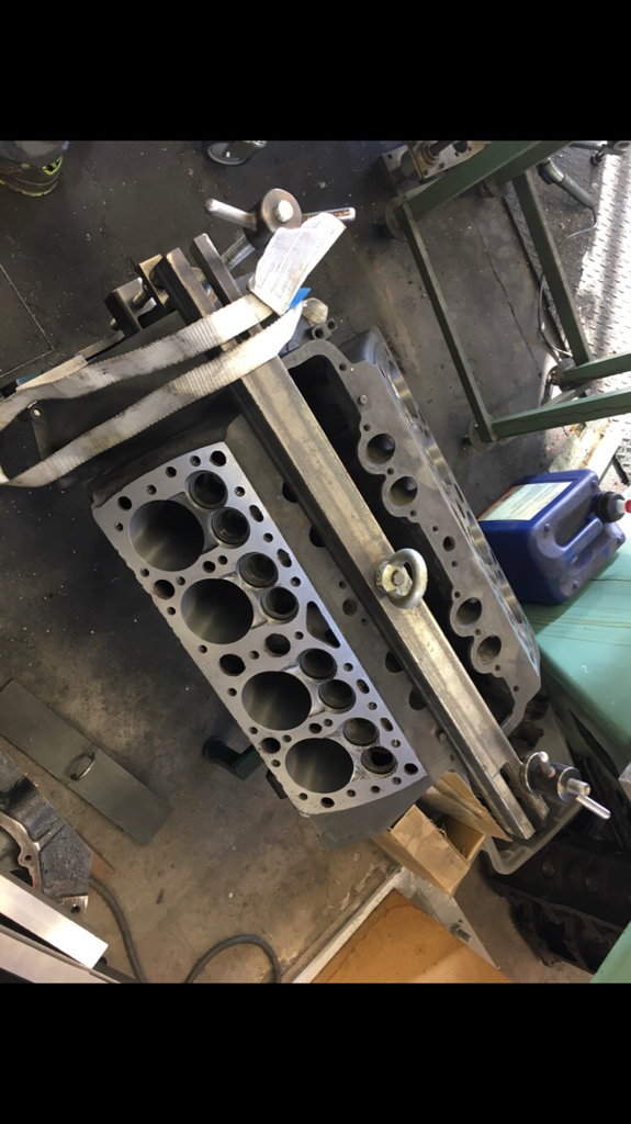

    So time for next update.
    I bought a 1946 59ab engine before i actually bought any car to use it in. I let it sit till early this summer when i started to rebuild it.
    6 of 8 Pistons were stuck, there were heavy rust in some of the cylinders, but no cracks. It needed to be fully rebuilt.
    Along with the engine came a 38 transmission in good condition.
    The engine has gotten a full rebuild this summer, new pistons and rings, bored 0.60, relieved, new valves, adjustable lifters, new valve springs and guides etc etc..
    The engine is basically all stock except for adjustable lifters, and the valve/valve springs is from an 8ba, lightened flywheel with a 10” clutch instead of 11”. And Also, two stromberg 97’s that is left from my banger Will be paired together with an old Edmunds intake.

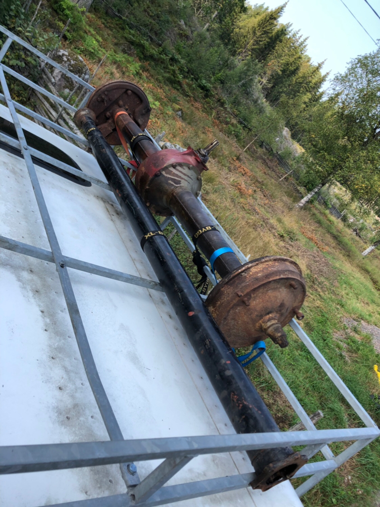

    Bought some things a couple days back!
    A dropped model a axle
    A really Nice model a wishbone, wich Will be splitted.
    39 rear axle that unfortunately needs a rebuild, but was too cheap to say no to hahaha. 35-36 torque tube and a 41-48 driveshaft.
    Im also looking for a Ford f1 steering box, wich is ”more or less” the last peace of the pussle, atleast when it comes to the crucial parts, there is still plenty of smaller ”less important” things i need..
    As you some of you probably already figuered out, im looking for a late 40’s to early 50’s style build. Most of my inspiration comes from don Montgomerys books and stuff like that.
    Cheers Hot rodders!

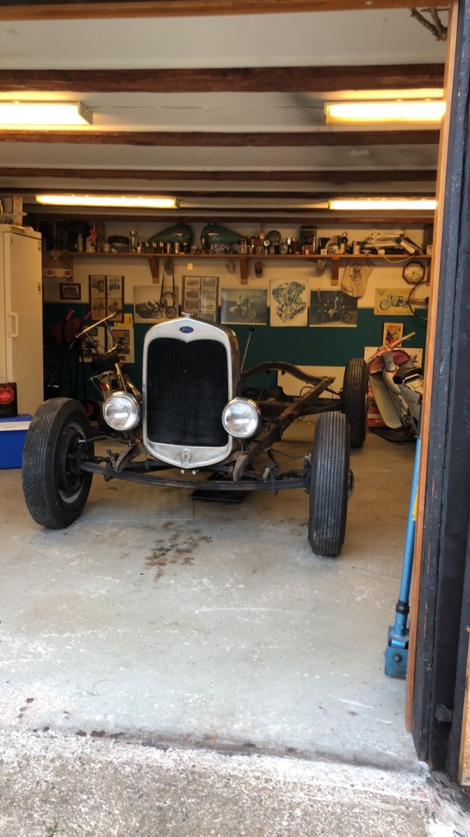

    Time to update you guys again!
    A couple of weeks ago i lifted the body of the frame, i gotta say, it isn’t that hard working on these old Fords, a couple of bolts and the steering wheel had to go and then the body was free! I used my dads carlift to lift the body of, and i put it down on my trailer and drove it of for storage, since i won’t be needing it for awhile
    By the way, the little blue mga roadster is my dads, it had to move out the free up some space for the lift.
    48fordnut, ct1932ford, brEad and 10 others like this.

    After the body was of, i could finally get down business. The engine and trans flew out just like that.
    To be continued..
    And as always, Cheers!
