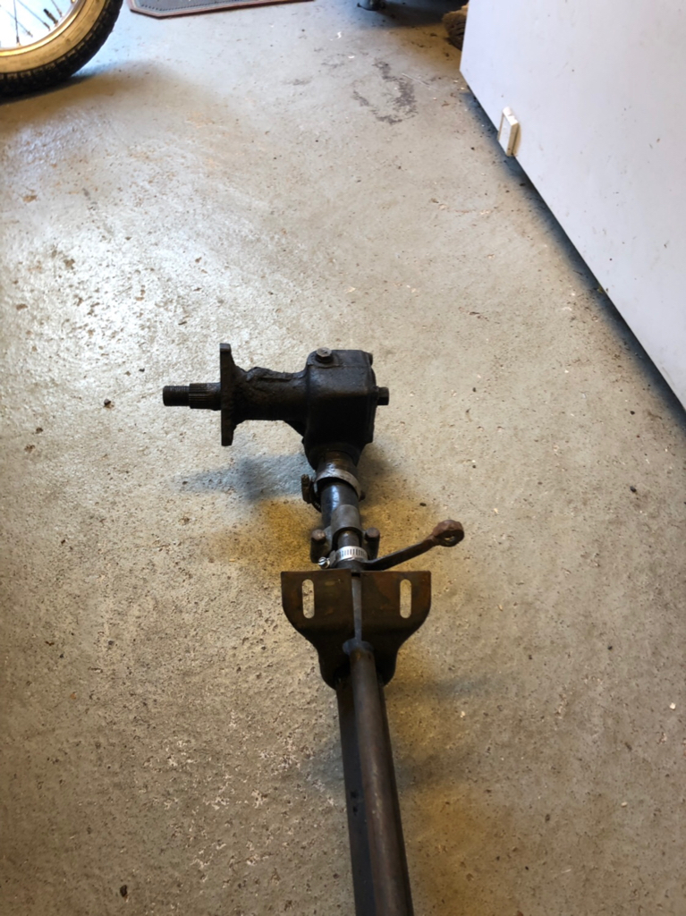

  12. Axel de Groot
    Joined: Dec 7, 2015
    Posts: 107
    Axel de Groot
    from Sweden
    So i mentioned the swap meet, right?
    Well the swap meet turned out real good.

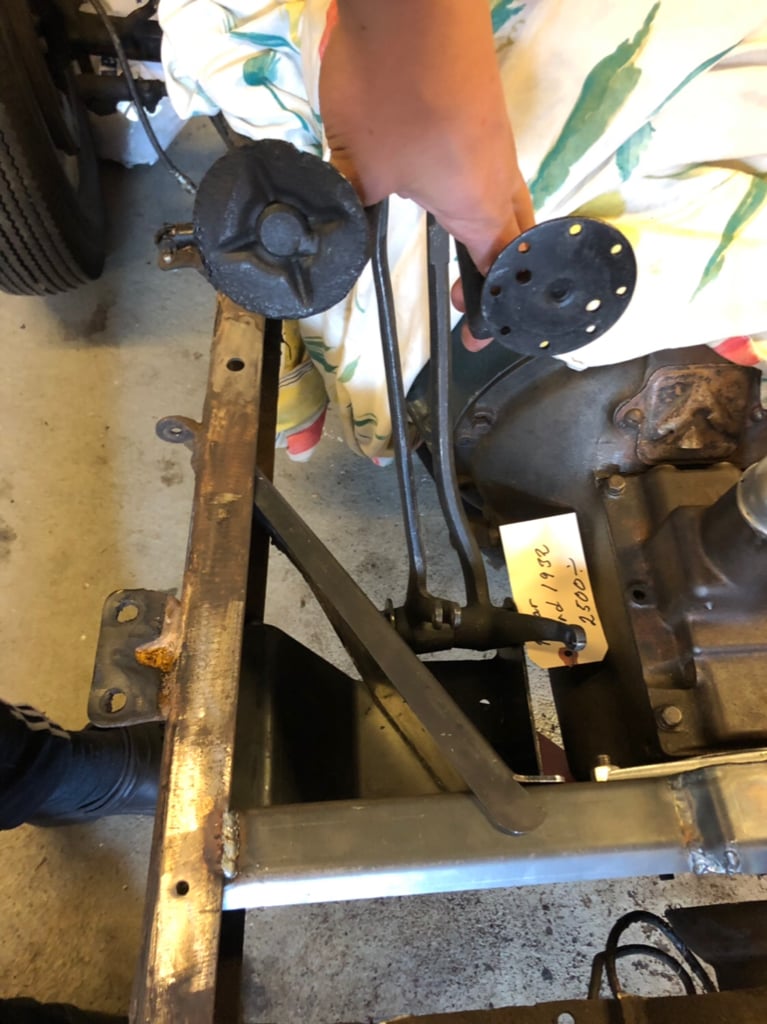

    I bought an F1 steering box with steering wheel and shaft, also found a clean 32 pedal ***embly. 42-48 spindles too.

    if you look at the picture where i did a quick ”mock up” of my pedals you can see that the k-member, transmission and engine is in place, but more on that later...

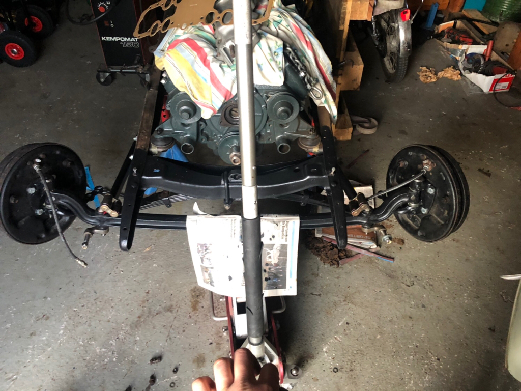

  16. Axel de Groot
    Joined: Dec 7, 2015
    Posts: 107
    Axel de Groot
    from Sweden
    Time to update you guys again.

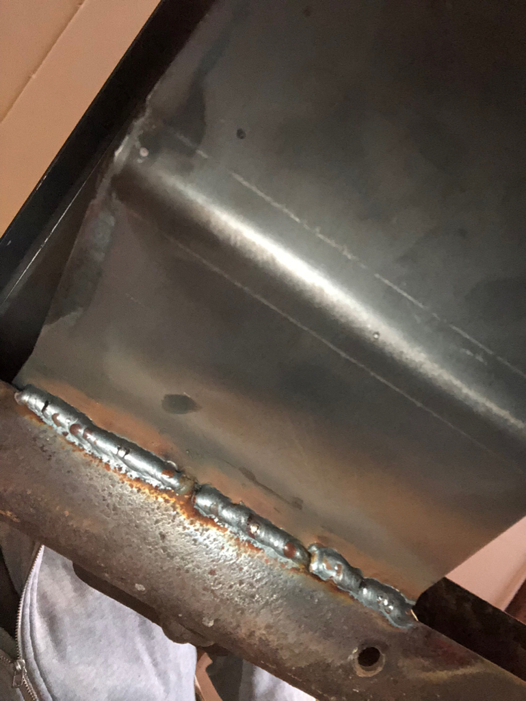

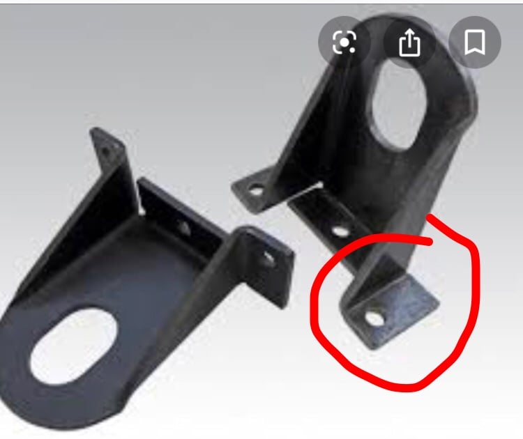

    After hours or maybe egen days of taking the engine in and out, moving the borrowed firewall forwards and backwards, putting my radiator on and of i finally decided on where to place my motor mounts.
    They are about 5.5 inch center to center from the radiator mounting hole.
    As i mentioned before i am using the motor mounts that vern tardel sells.
    The ”ear” on the engine mount (see picture) is all the way upp against the front crossmember, wich equals about 5,5 inch from the radiator mount.
    I replaced the original transmission mount with one from 32 since i am using an k-member.
    The k-member has been welded in place, but not the ”legs”, i Will wait with them at least the left one,until i start with pedals.
    Rolled the ch***ie outside to get a look at how it turned out, and also to dream away about hot swedish summer nights cruising around in my future av8 coupe!

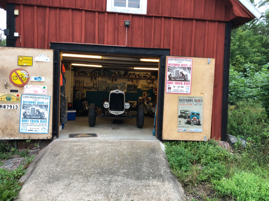

    I am doing some of the grinding and welding (unless windy weather) outside since my garage is rather small, as seen in picture, my dad has two bigger garages but they are filled with customer cars.

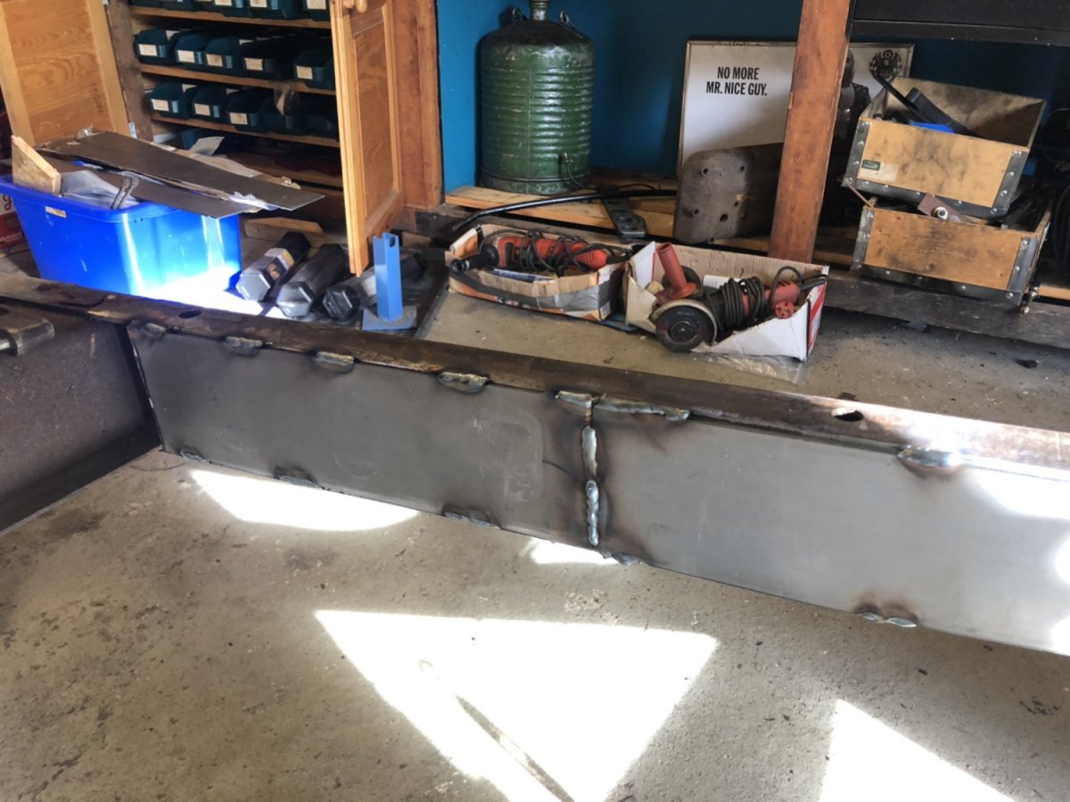

  23. Axel de Groot
    Joined: Dec 7, 2015
    Posts: 107
    Axel de Groot
    from Sweden

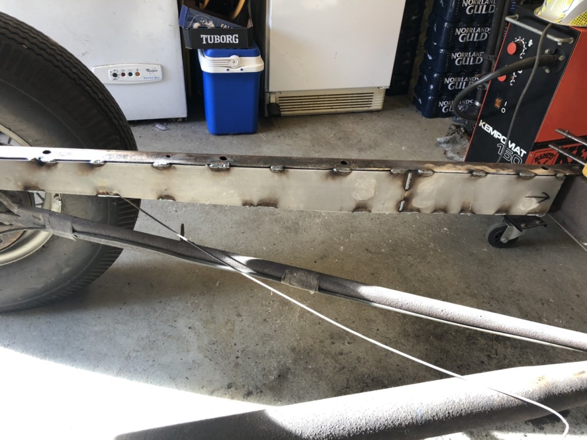

    I boxed the frame last weekend. I Will not box it all the way, just from the rear crossmember up til the middle crossmember, as the k-member also provides additional strenght to the frame.
    And now the recap stops, and for now and til’ the car is done, it Will be an day to day build [emoji16][emoji1303]

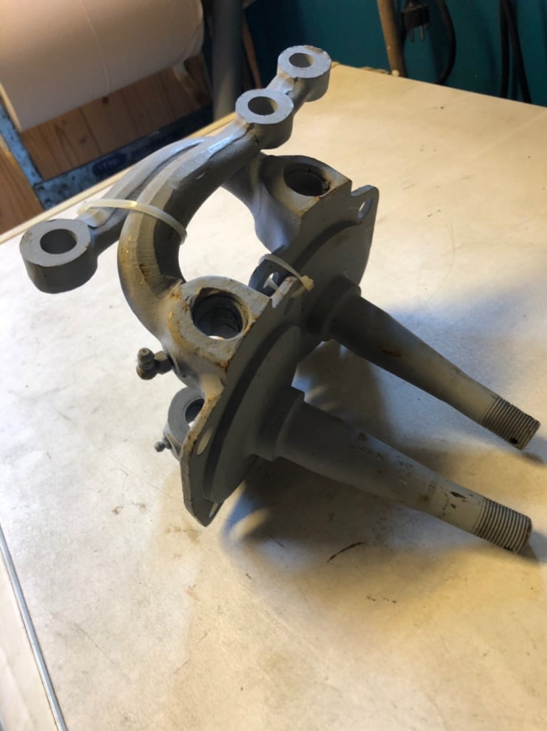

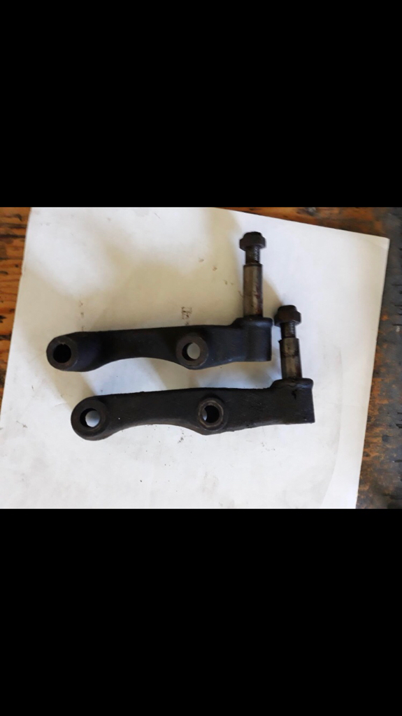

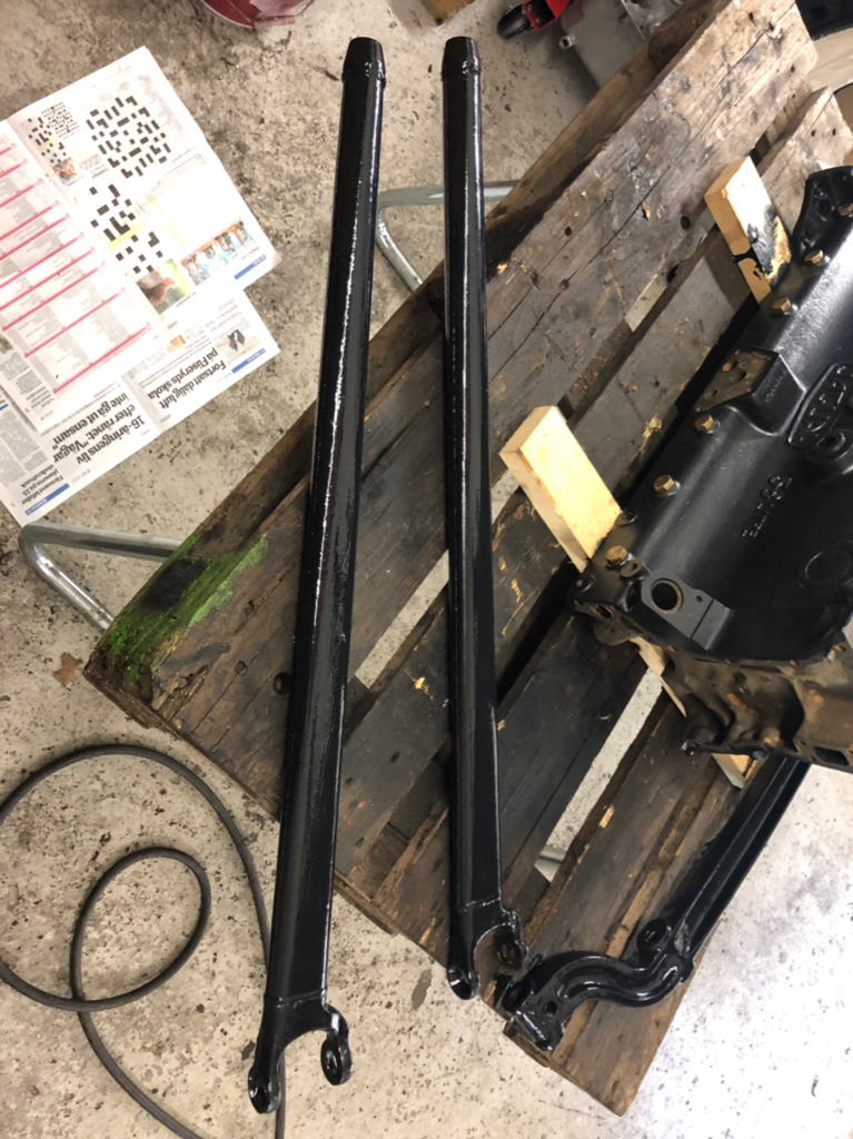

    Made a little progress on the av8 today.

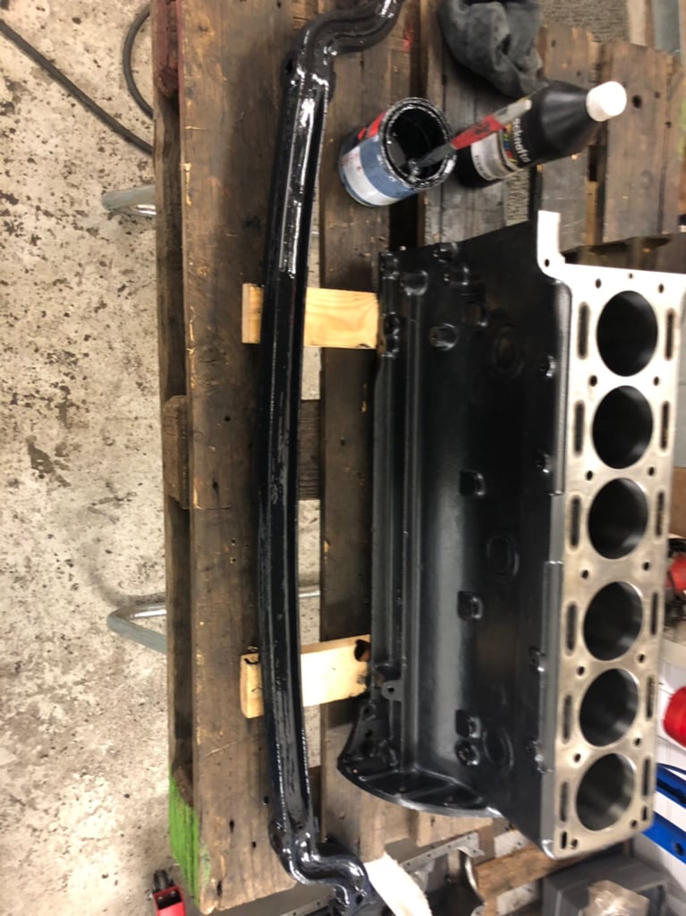

    I split the wishbone, and i have to say, even though im building a hot Rod, Cutting up a very nice and solid model a wishbone feels kind of wrong. But hey, it sure was fun!!
    Now you guys probably wondering why i didnt cut of the wishbones already on my car? Well some jack*** has welded the whishbone to the axle, around the perch bolt. And instead of trying to rescue the original wishbone and axle, i bought an orginal model a dropped axle and wishbone, with new perch bolt.
    I also painted the axle and wishbones today.
    Next thing to do is to mount the dropped axle with perch and spring and spindles to the ch***ie!
