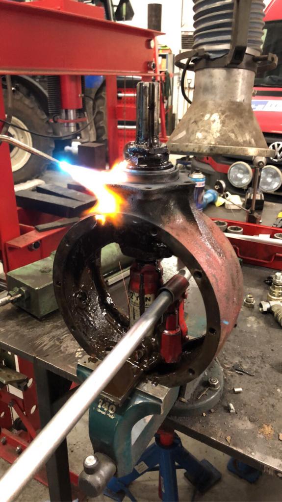

    Rear axle Sunday!
    As i mentioned before i bought i 39 banjo, in need of some tender love and care.
    So today i took the axle apart to see how it all looks. It Will most likely be a full rebuild, but the axle was cheap so still a good deal
    After some calculation i came up with the conclusion that it had 4.44 gear ratio, 40 teeth crownwheel and 9 on the pinion.
    Since im not building a tractor, im most likely to change gear ratio to 3.25 or maybe 3.54[emoji1591]

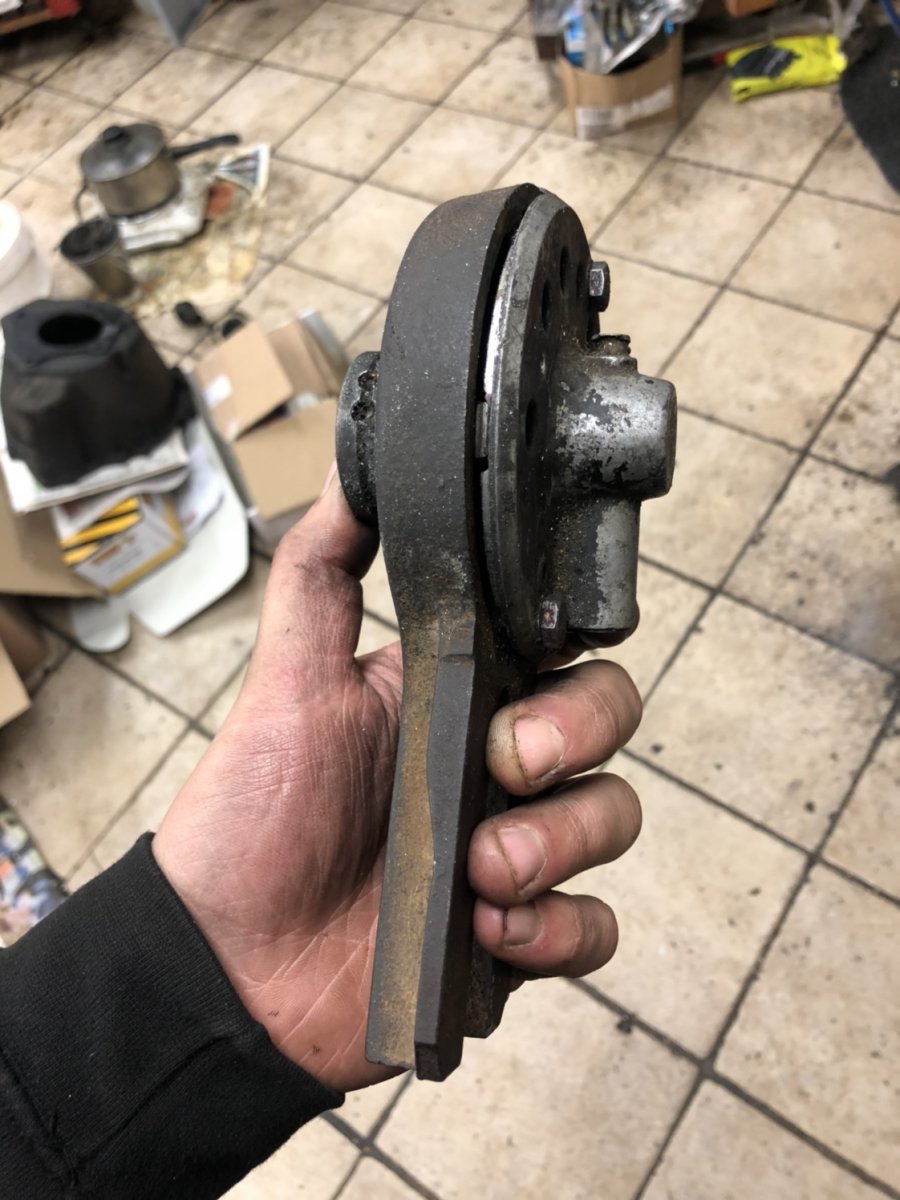

    Made this this little thing today! An old generator, cut down to hold a fan. As i mentioned before i cut the outer pulley of my double crankpulley to clear the front crossmember so that everything will fit, wich also means i cant use the stock 59a fan wich is supposed to run on the outer pulley..
    Electrical fan is not an option, so this seems like a good way to do it.
    I got the tip of a friend of me. Its a nice short setup wich will hopefully clear the radiator!
    As you might see its not done yet, i will have to shorten the axle that runs through the generator and of course also mount the pulley and fan, perhaps paint would be a good idea to give it a better finish[emoji23]

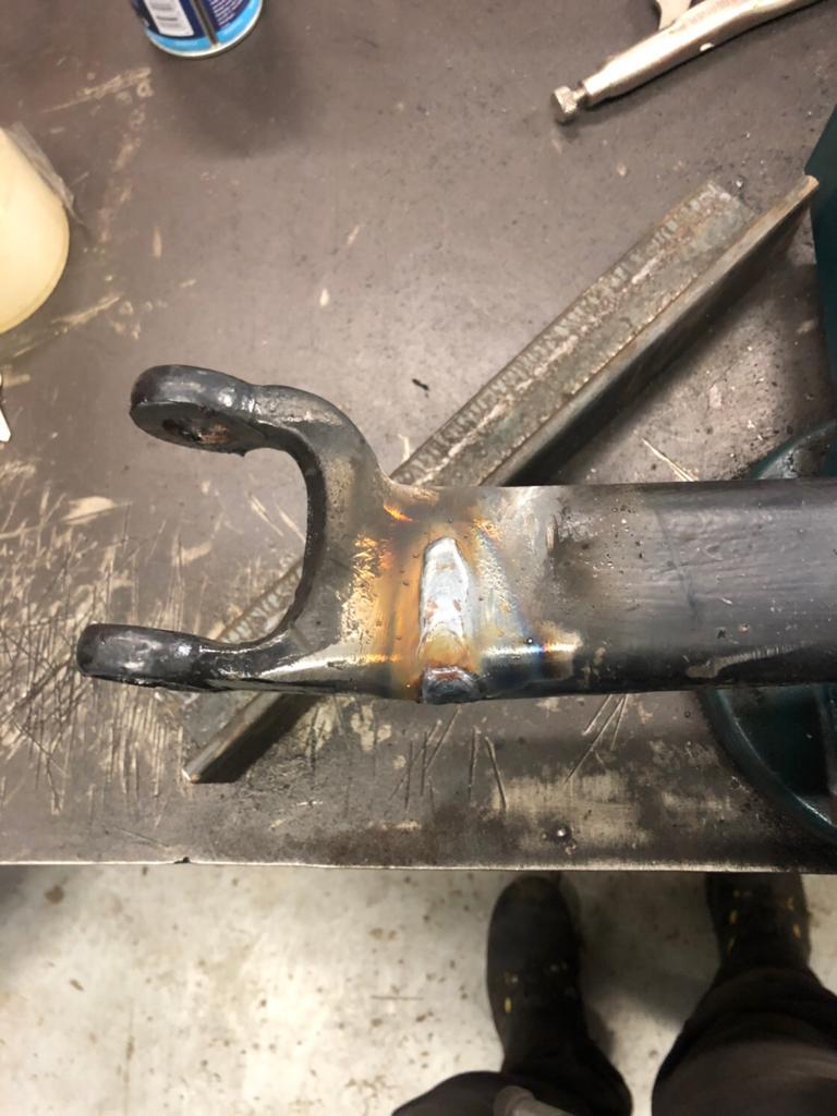

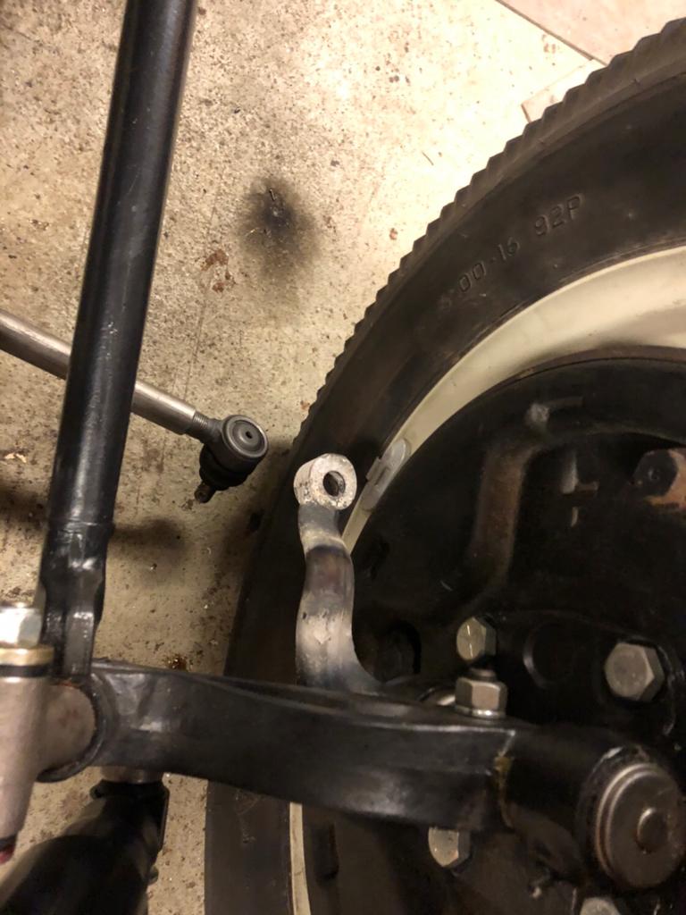

    I had to pie-cut, heat and bend my front wishbones to get the correct caster angle.
    I also did some heating and bending on the spindles so that the cross-over steering shaft could clear the front crossmember and the wishbones[emoji1303]
    Cut of the f1 shock mounts and rewelded them to line the mounting holes on the shock mount with the two rivets on the side of the front crossmember, knocked the rivets out and put two bolts there instead.

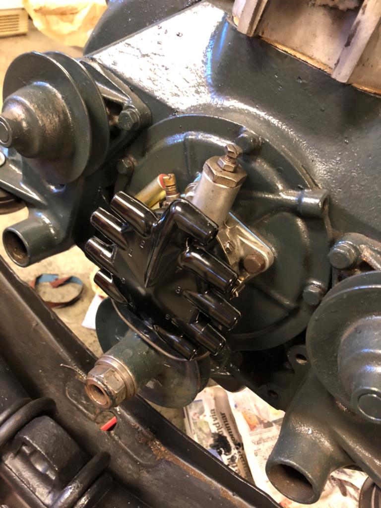

    I also changed to a crab style distributor cap as i prefer the look of it, and it is a bit easier to service and inspect if you Ask me.

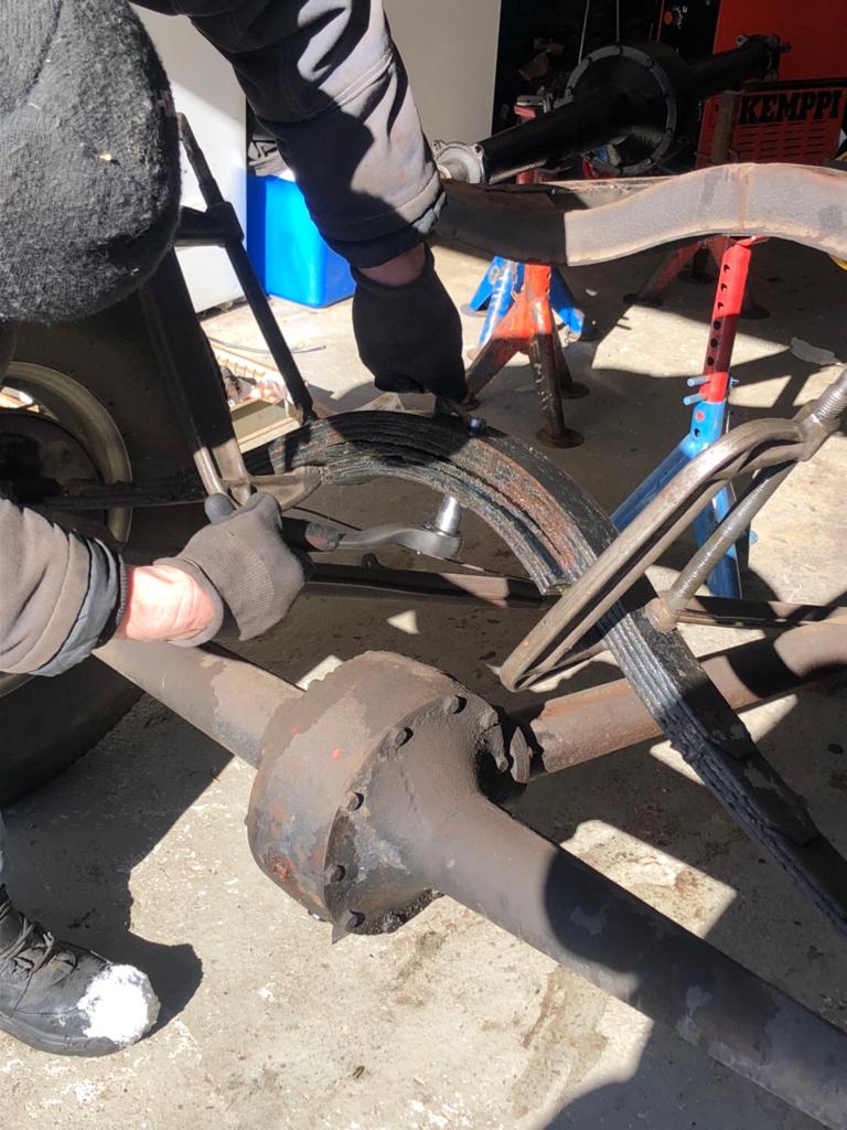

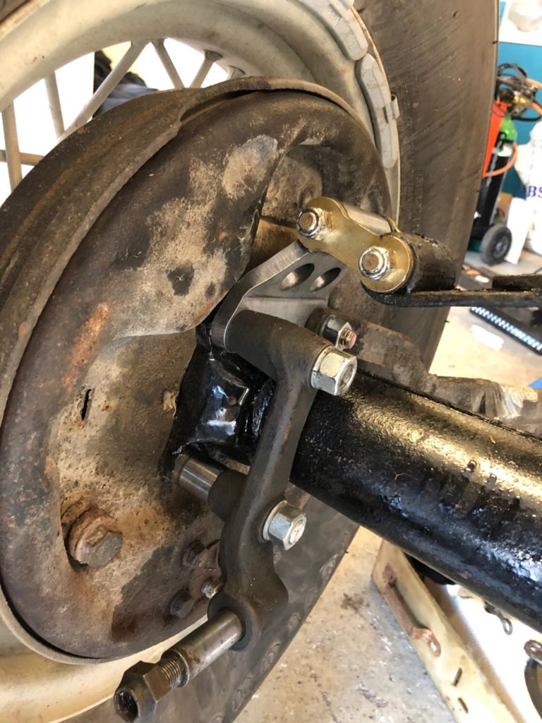

  23. Axel de Groot
    Joined: Dec 7, 2015
    Posts: 107
    Axel de Groot
    from Sweden
    Rear shock mounts on!
    Gonna be a whole different car driving it with flathead and all, but one thing i think im gonna appreciate the most is proper shocks all around. It didnt have any shocks before, not even the old original ”dog leg” type. It was really bumpy, and when going in greater speeds and hitting a bump in the road it felt like the whole car bounced sideways![emoji28]
    Axel.
