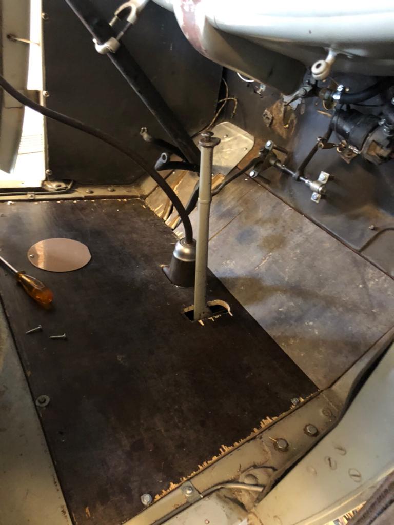

    I have built a floor of some simple plywood,wich will have a rubber mat and some fabric/clothing later on.

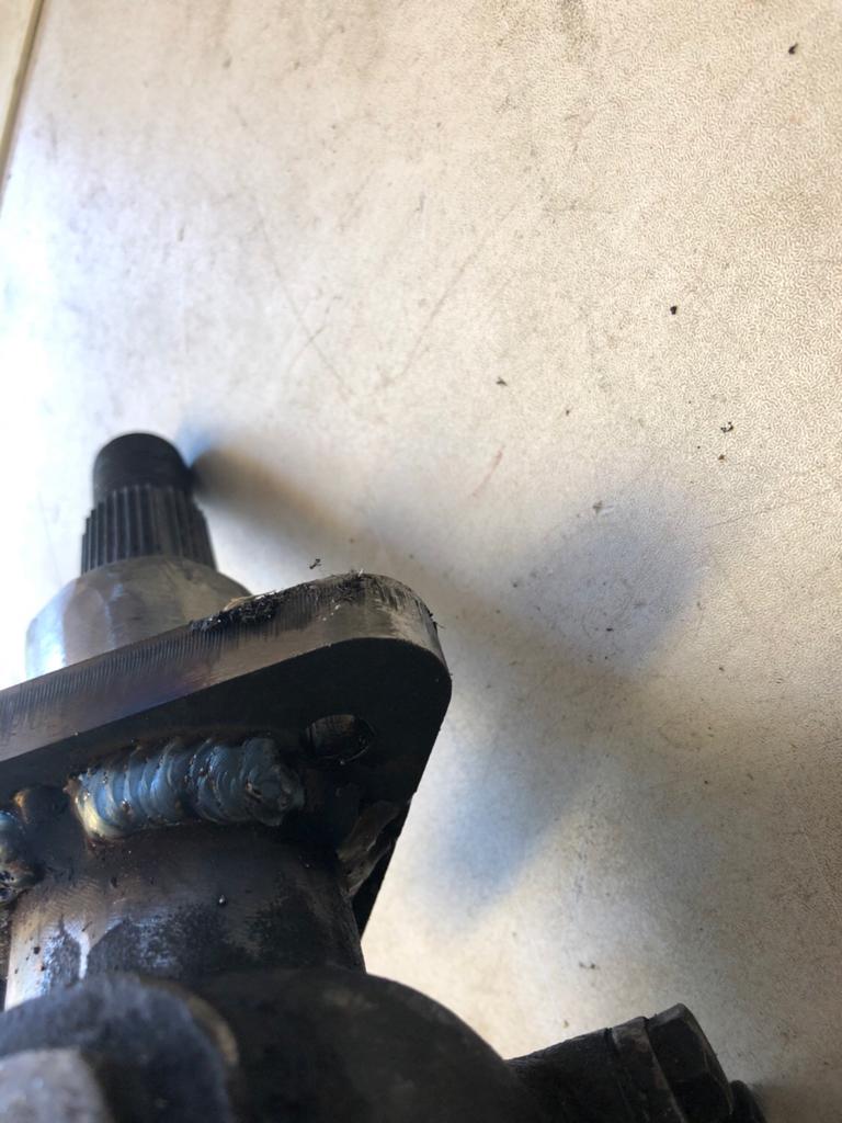

    I welded the tardel flange to the f-1 box and mounted it. Also Made a Simple reinforcment to the outside of the frame to stiff it up a bit. I had some troubles getting the f-1 steering wheel of, it ended up being completly thrashed.
    So as i had to get a new steering wheel, i had a friend Made a bit steering shaft for me, instead of the splined steering shaft that is originally on the f1 shaft he Made me the earlier type wich uses a woodruff pin (i think its called woodruff?!) so that the earlier wheels fit. I was looking for a 37-39 banjo but couldnt any, so it ended up being a Ford 40 wheel![emoji16]
    I heated and bent a 37 pitman arm to clear the wishbone, and Made a drag link out of and old pipe and two tie-rods i had laying around. Also heated and bent the steering arm on the spindle so that the drag link is a bit more paralell to the wishbone!
    I used the original model a column support, atleast the upper half, then i took the f1 column support, bent it and bolted to the stock A half of the support (No picture, sorry)
    I have no pictures of it, but i Made a simple bracket to hold two extra gauges, water temp and oil pressure, the extra gauges is placed under the original instrument panel.

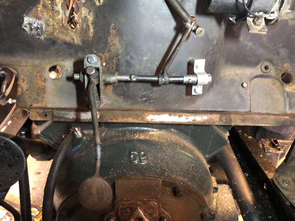

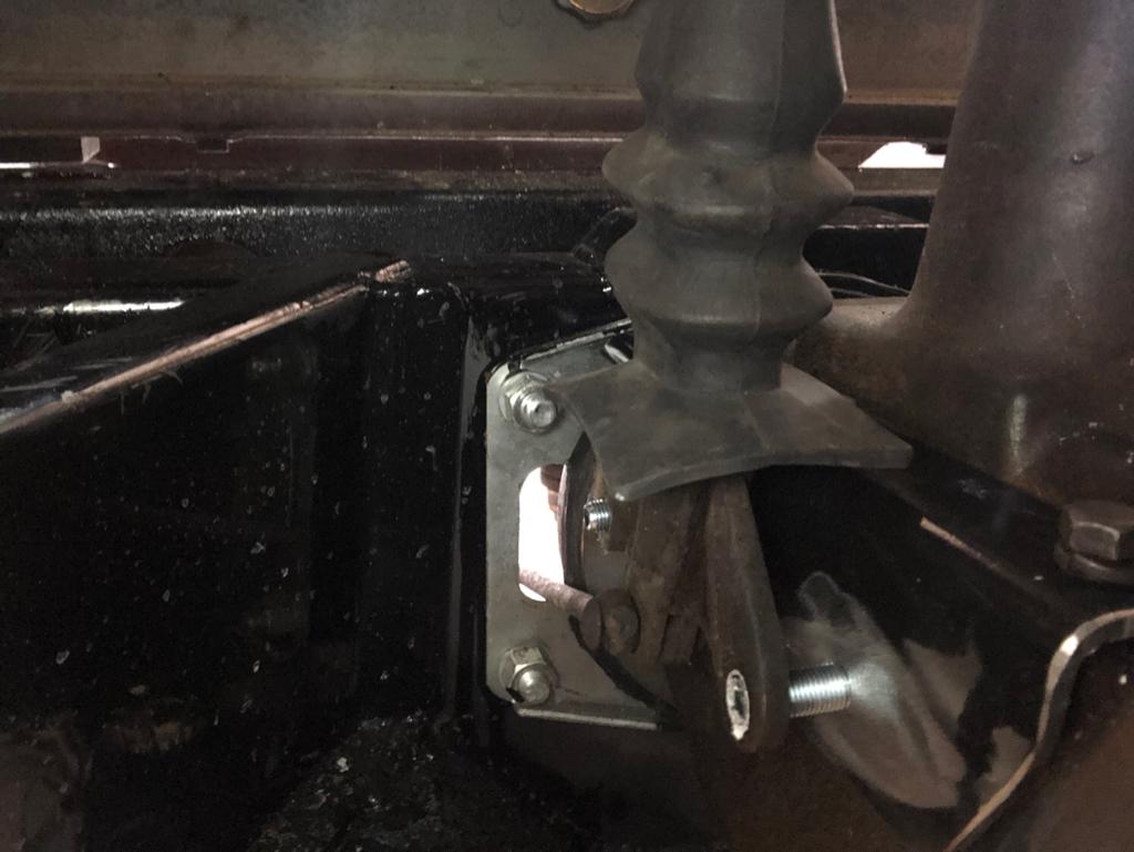

    Also mounted the parking brake on a simple angle iron using three bolts on the transmission cover, there is a rod going from the parking lever through a hole in the k-member back to the wire.

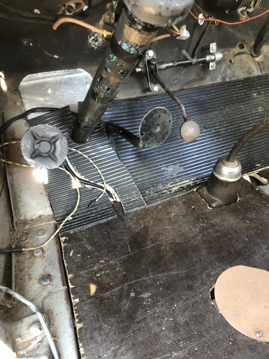

    I promised some more pictures didnt i?

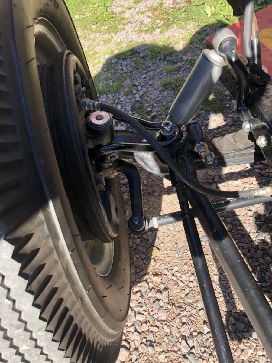

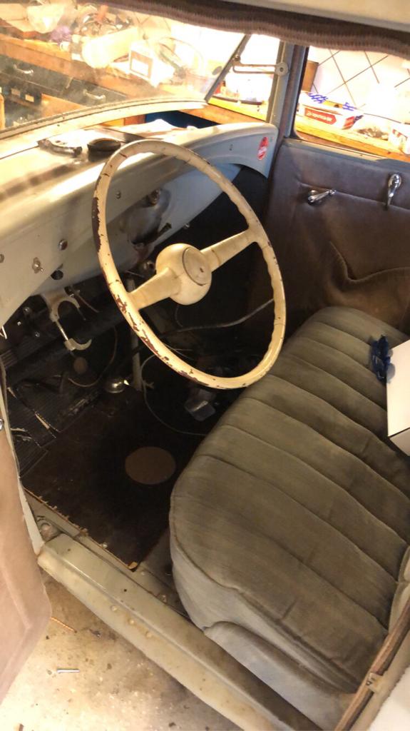

    I used the ”U bent” steering arm from speedway, dropped it down a little to lign up with the drag link a bit better.
    You can Also see my pedal set up, im currently working on the floor mat, wich explains why it looks so crappy in the pics haha! There will be some sort of mat or fabric on the floor, i dont want this thing to look too much ”rat Rod”, Also to give me more comfort i guess.
    You can see how i used the original f-1 column support, just pie cut it and bent it to fit the original model a support on the tank. Not the nicest thing ever but it gets the job done.
    Please ignore the ugly/crappy wiring, it was just to get this thing Rolling on the streets.

    Had to change wheel cylinders since i had poor brakes.

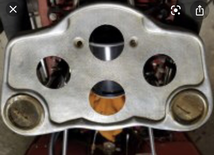

    Anyone following this thread that has an model a aristocrat dash panel?
    Im looking for one for my av8 so that my temp gauge and oil pressure gauge blends in a bit better.
    Hit me up if any of you guys have one!

    I would love to find an Aristocrat dash panel too. I’ll see them every once in a while but they’re getting harder to find. Especially if you’re particular on the speedo (round or oval). Good luck!
