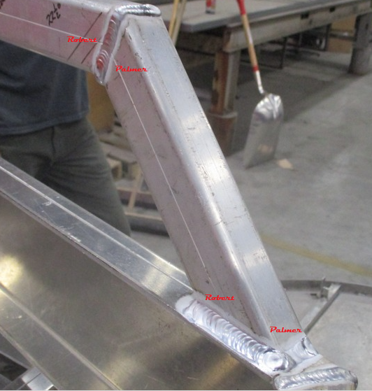

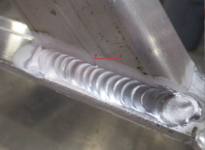

  8. I have a Miller Maxstar 200 - just for steel and stainless. I have had it for over 10 years - have used it a lot for mostly chassis related fabrication. The high-frequency start isn't quite up to snuff anymore - so I have to scratch start it, but I'm going to either get that fixed (as it is really important for thin stuff) - or get another welder in the near future.

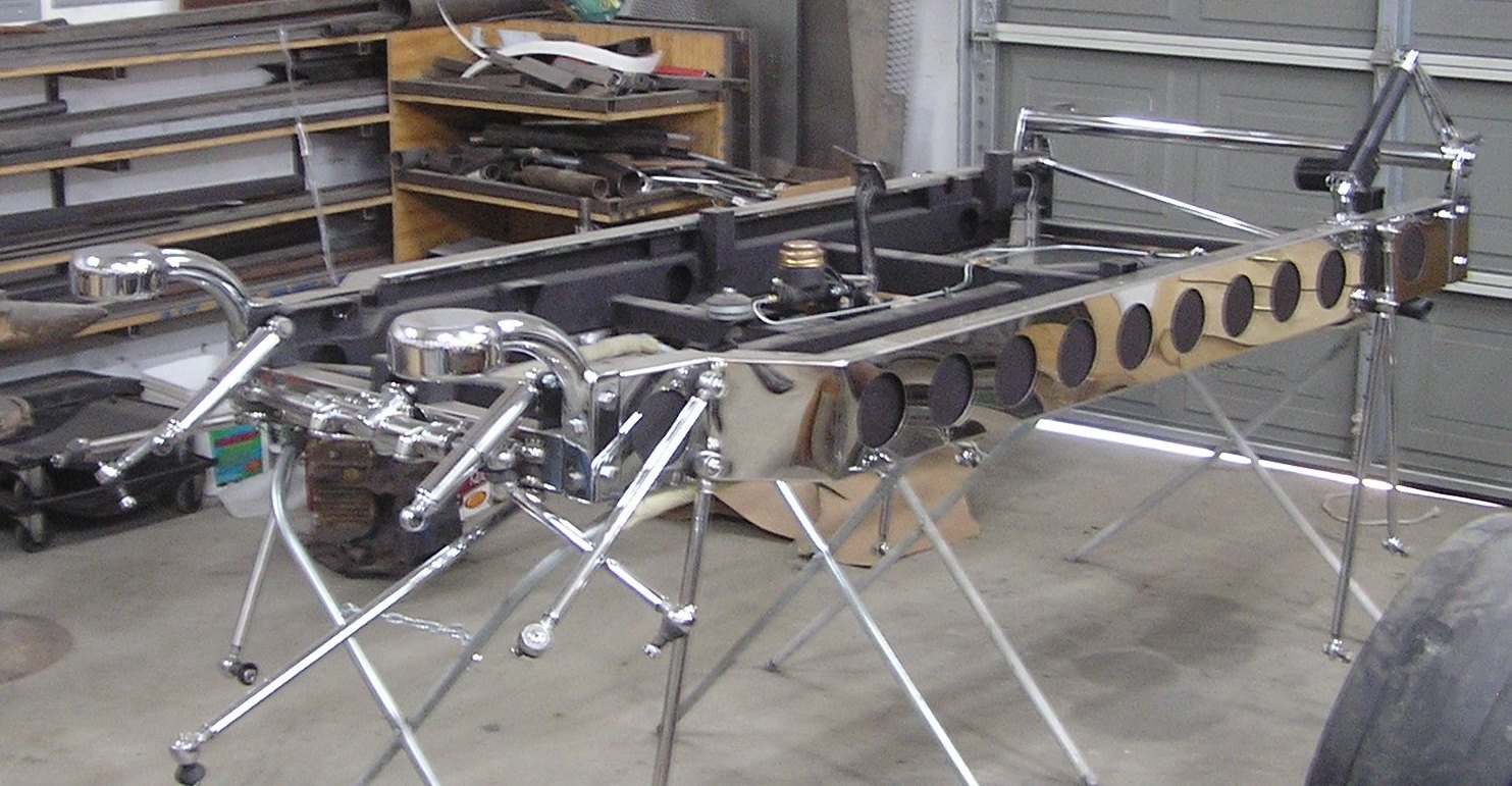

    Of all the cars I have built, this Bonneville car had the most welded joints and Dzus tabs, took a long time Tig welding. IMG_4404.JPG IMG_4414.JPG
