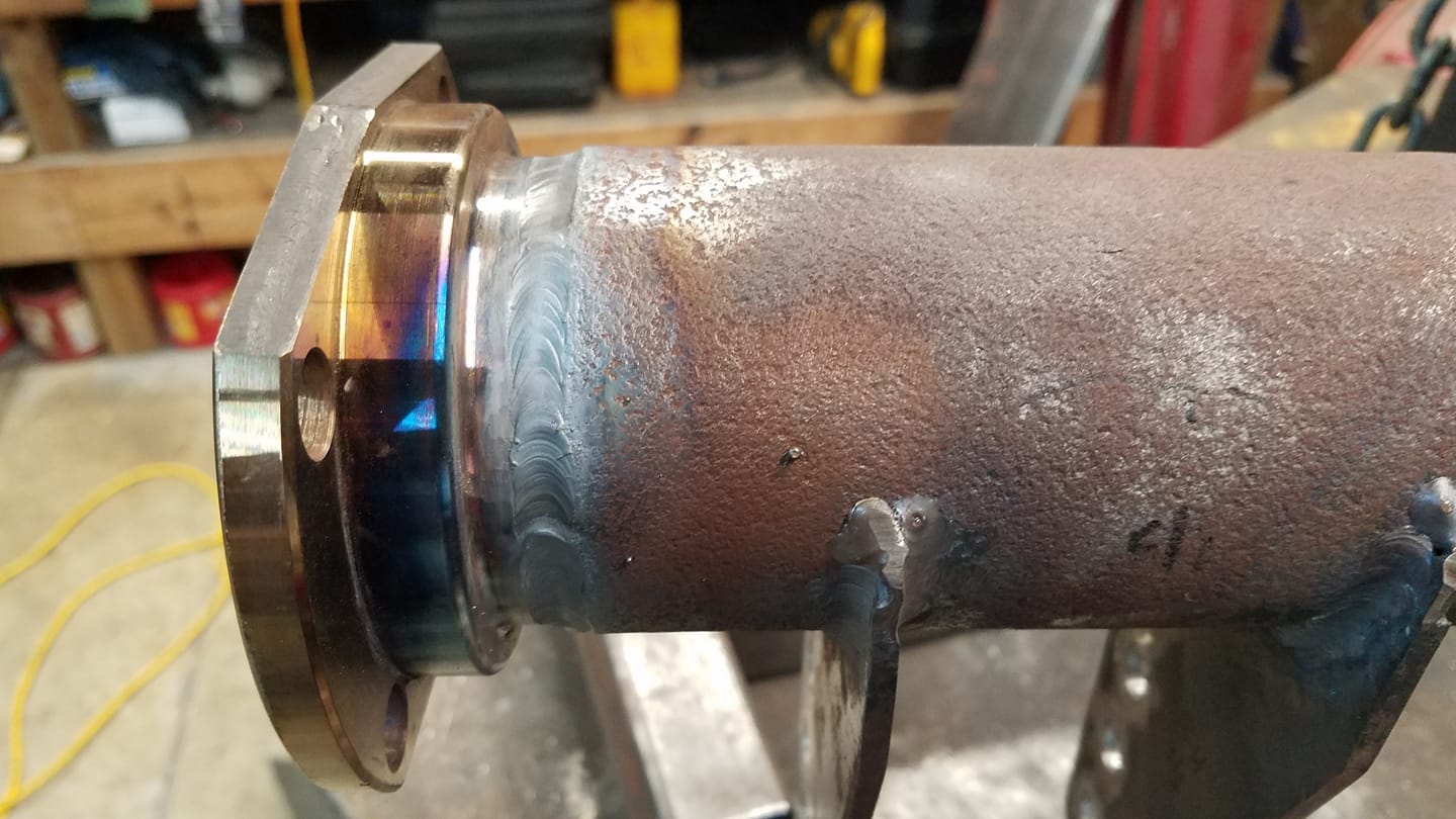

  9. Yeah, that's why it was cheap. I just want to weld my stainless exhaust system and make it decent looking. I have over $1000 in exhaust tubing, v-bands, x-pipe, mufflers, and resonators. I have two Eastwood MIG welders, the 135 and the 180, and they're great, but I didn't want to MIG weld the stainless. This TIG was $129 on Amazon and had great reviews. No on the fly adjustment of amperage, but the Amp dial is pretty good for a range of different thicknesses and types of welds. It does have HF start, and post flow setting. So far, I can't complain. I figured this was an affordable way to learn TIG while also being productive. I can upgrade to a better machine down the road if I so choose. I also found out last night that a 40cf argon cylinder doesn't last long when you leave a regulator hose connection loose...damnit.

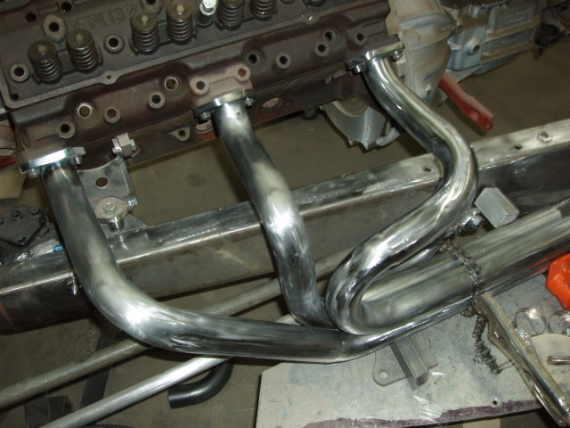

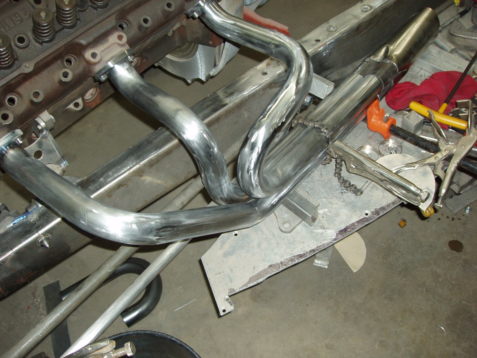

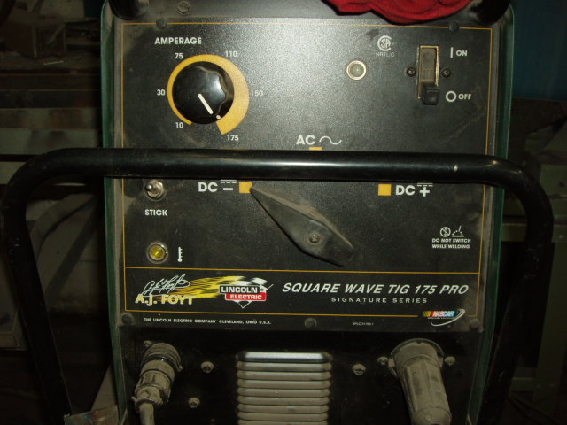

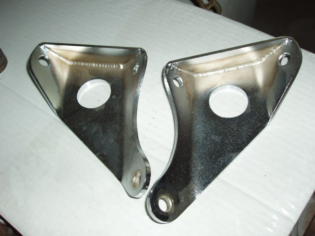

    Been T I G welding since 1972. I built my late model stock car racers with the T I G. The stock car guys really put me down for that. I have built a lot of headers too. I like to use 308 or 312 stainless filler rod. I have a 300/300 Lincoln. The Lincoln square way 175 is a real good machine for the money. Now I have a problem. Welding up these headers I want to have chromed. Porosity in the welds. I never have had to use argon inside the tubing. Never had that happen before. Using Speedway Motors combo bends from Taiwan. I never had to use acid copper to fill imperfections prior to chroming. I dread building the other side headers. It's not fun anymore. 2024-07-20 18.11.04-1.jpg 2024-07-20 18.11.04-2.jpg 2024-07-20 18.11.04-3.jpg 2024-07-20 18.11.04-4.jpg

    The stainless rod that you are using may actually be a liability here.
    With no back-purge you will have contaminated stainless steel welds. The only way to "accidentally miss" this outcome is to inadvertently not have full penetration. Once the stainless bead hits free-air, it is contaminated.
    Build that one side again and use regular old ER-70S.

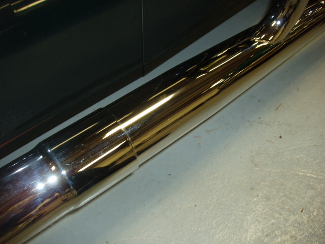

  30. Frames
    Joined: Apr 24, 2012
    Posts: 5,289
    Frames
    Thank you very much for the reply. I was thinking maybe the Taiwan metal is garbage. Years ago I went to using S/S rod but I used MIG ER 70 S wire for the duck bill ends at the bottom. I welded and smoothed the slip on ends and turn outs. Never a problem. Check out the nice transition of the 1st pipe to the megaphone. I have never seen anyone else do that. Pretty sure I used S/S rod on every thing else. I think the last headers I built 2007. At 89 years old I won't swear to what rod I used. 2024-07-21 19.09.54-1.jpg 2024-07-21 19.09.54-3.jpg 2024-07-21 19.09.54-4.jpg 2024-07-21 19.09.54-5.jpg 2024-07-21 19.09.54-6.jpg 2024-07-21 19.09.54-7.jpg 2024-07-21 19.09.54-8.jpg 2024-07-21 19.09.54-9.jpg
