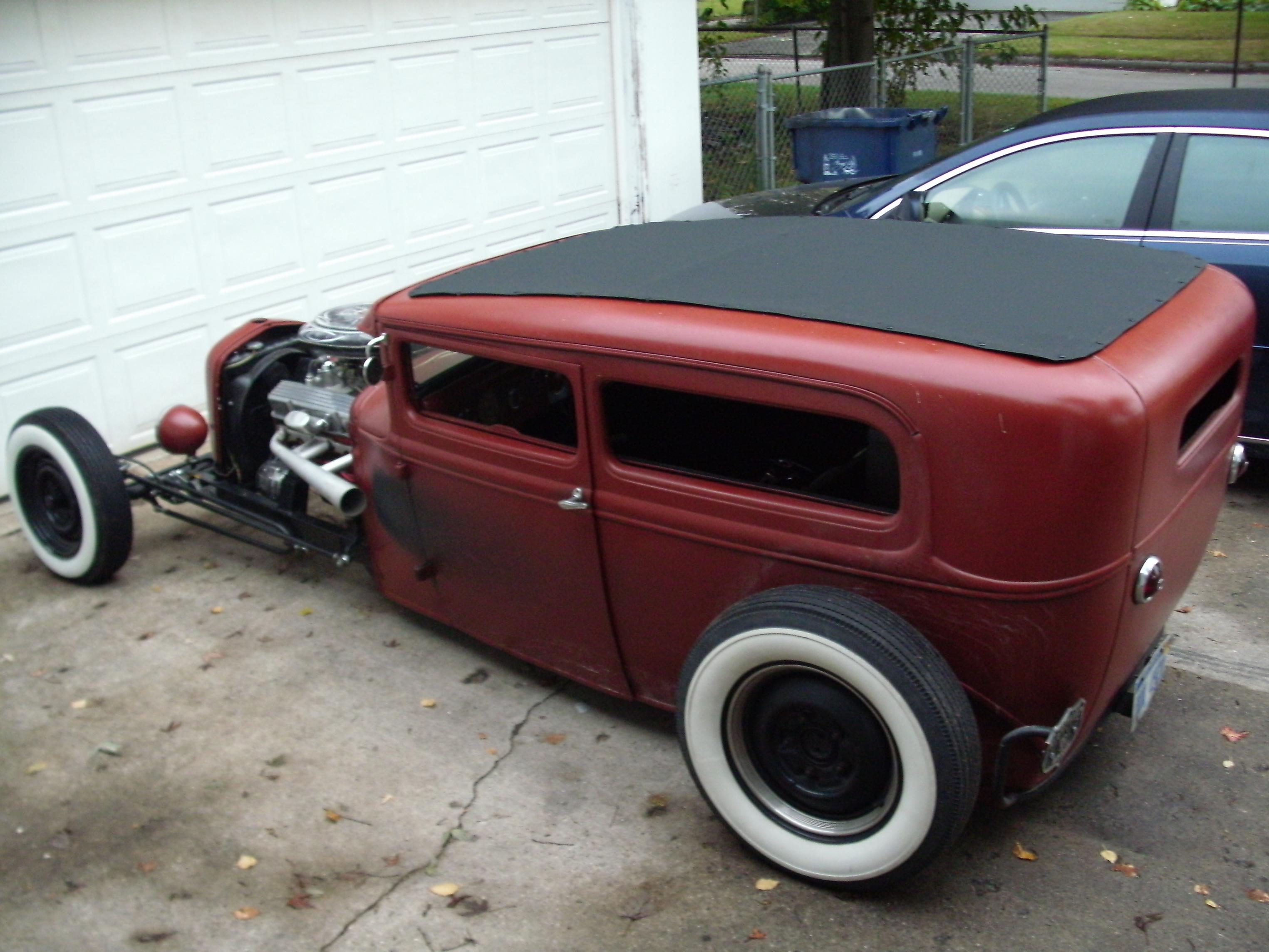

    Im thinking about doing an extreme reverse Z and channeling the body 5" from the ground so that the frame rails also act as a frame for my headliner.

    Looks like *** imo. The trucks cowl covers the step up so it looks ok ish..............

    Well my 30 tudor is within 5" of the ground at the cowl and 5.5" at the rear quarters and I only have a 4" Z. There's a lot easier way to go about things than what you're doing. PM me if you want and I'll try to help.
  11. panhead_pete
    Joined: Feb 22, 2006
    Posts: 3,733
    panhead_pete
    Was thinking about this on the way home tonight. Mine is swept 4" and has a 4" drop axle and is 5" off the ground.
    So if you ran tyres two inches taller (sorry cant remember what size they were) and put up with being 4 " off the ground and used a std axle with no drop etc it would be about the same.
    PLEASE Get this mocked up and pics. I dont care if when you do it doesnt work, I just think its great someone is trying something.

  13. The radius rods look really short. How do you plan to mount them?

    Is there any particular reason WHY you built your frame like that? Did it solve a problem maybe we're not aware of?

    if it dont work try flipping the front axle upside down and gain a few inches. old hotrod trick
