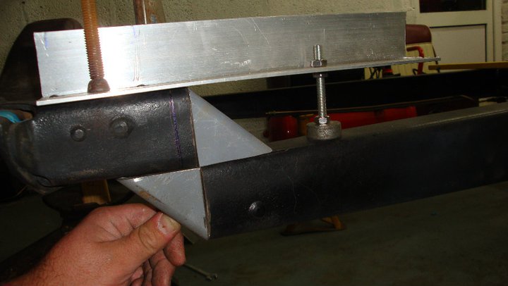

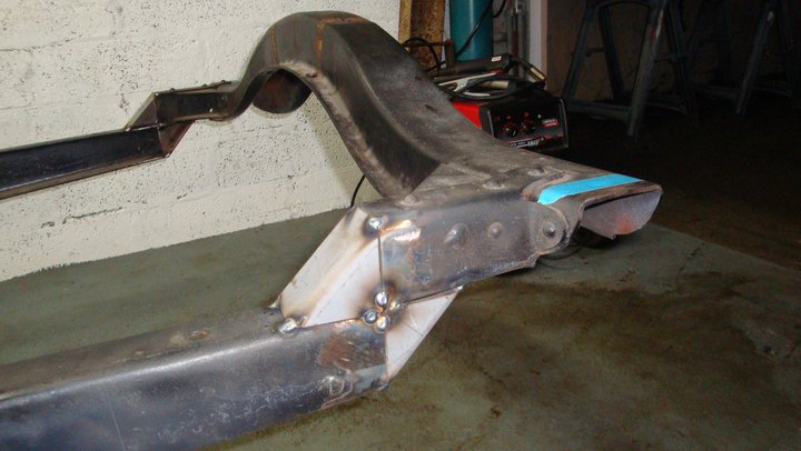

    Something like this:
    This is fishplated on the inside, wherever there is a seam, and fully boxed.
    Where the kickup is done is largely a factor of what suspension you are using, so it does not interfere with suspension operation, or prevent you from installing it.
    This was done with sections of another Model A frame, selected to match the taper, to replace the removed section, as to not lengthen the frame.

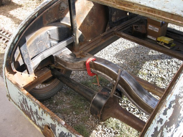

    Stepped mine the width of the frame, the only distance requirement I see would be the amount of the Z and room to keep the wheelbase the same. I'm running a flathead and didn't box the frame since I cut the frame at an angle and welded the rear section on top the frame and then closed in the ends.

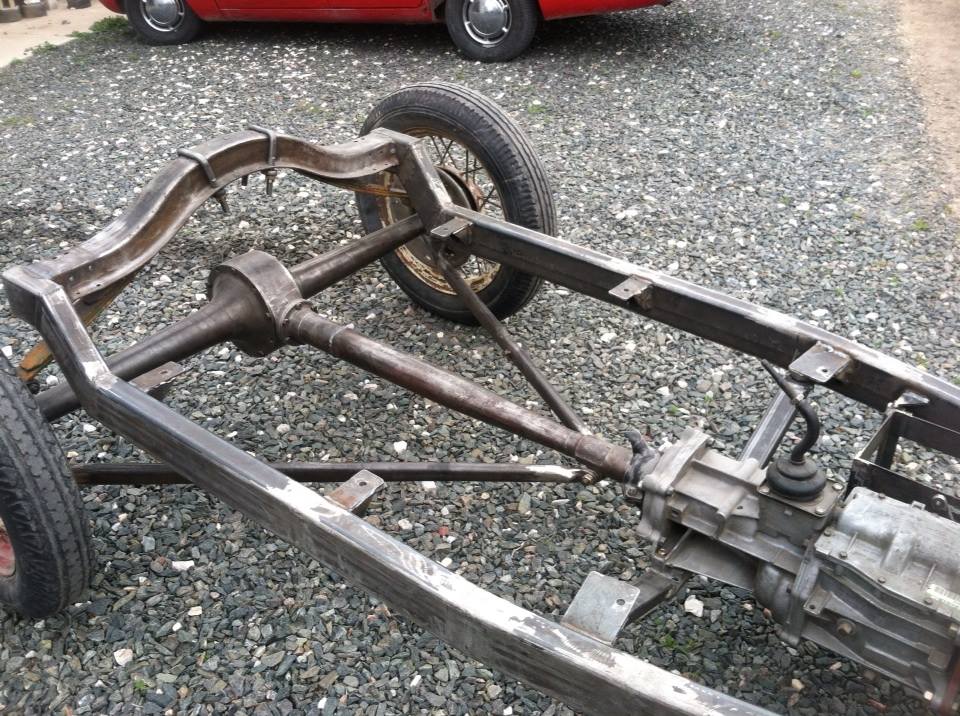

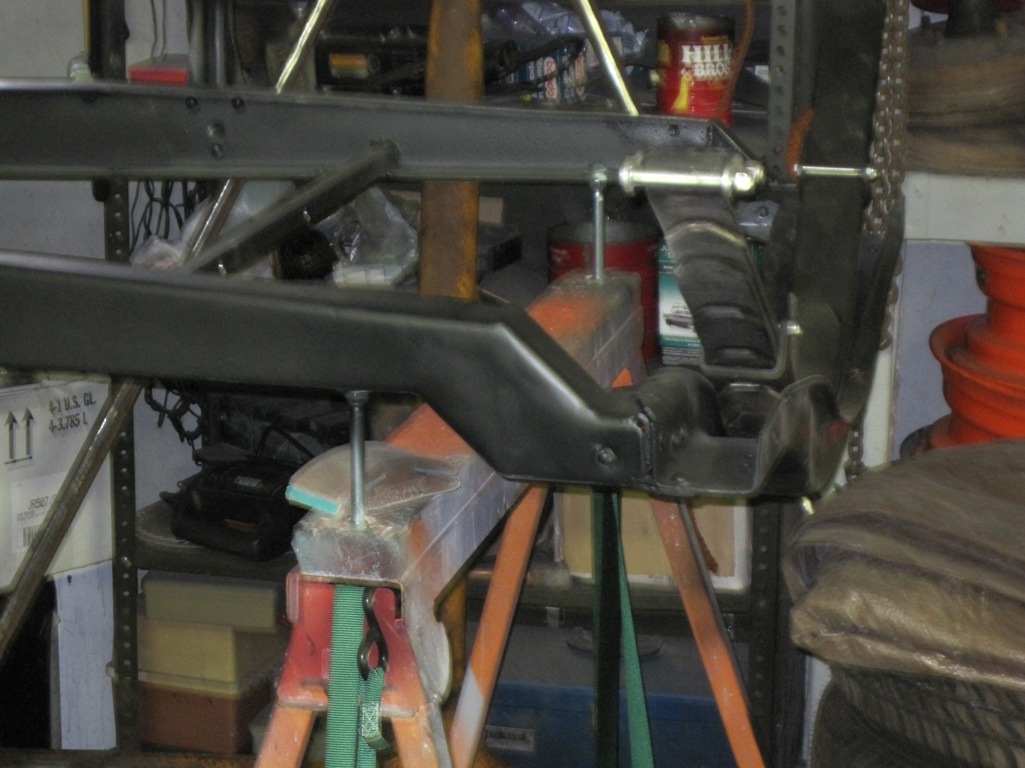

    I built my frame pretty close to model A specs. I would think that where you make the cut would depend on rear suspension you are going to use and how much you are going to Z the frame. I made 6" Z in mine and used about 45 degrees on the kick up. I would also consider where to Z the frame based on where you might want the subrail to be cut.

    The "easy Z" on a Model A frame is to just cut and lower the rear 6" of the frame down to the lower level of the rail like The Bishop-Tardel book, and Model A Gomez shows above. This will allow you to use the stock subframe in your body with only a small notch removed from the inside edge. And you just leave out the wood block that was stock back there.
