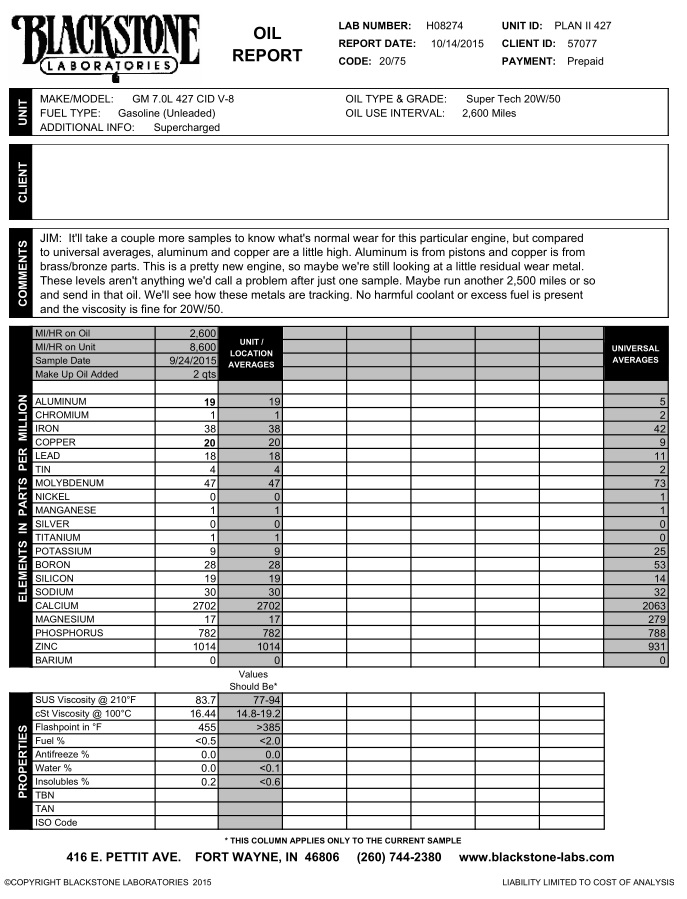

    So, perhaps a guy ought to get an oil ****ysis done occasionally, to see how the zinc level is holding up?

  30. Blues4U
    Joined: Oct 1, 2015
    Posts: 8,221
    Blues4U
    from So Cal
    Well, there's a problem with that. What used oil ****ysis looks for is the element Zinc, not the compound ZDDP. As I described, the fresh ZDDP plates out on the surfaces to form a film, it is chemically activated, and its changed in form. When it is worn off due to rubbing action of the parts, it ends up back in the oil, but it is not available to be re-activated again. It's done it's job and now it's used up, but it still exists in the oil. And when you ****yze the oil via spectroscopy that used ZDDP is still going to show as the element Zinc. So you cannot use oil ****ysis to measure zinc depletion, it doesn't work like that. Anyone telling you otherwise doesn't understand used oil ****ysis properly. (I'm also a certified Oil Monitoring ****yst and a certified Machinery Lubrication ****yst, more ***les, blah, blah blah...)
