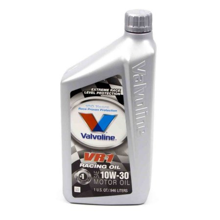

    $4.59 a qt 10 w 30 vr1 with zinc 34e7889c-e0b3-42a1-8497-b11ffd6477e1_1_135821c6270d03b4c088f2f7f3dde0d8.jpg
