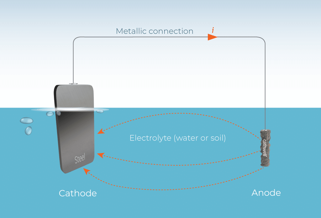

    If a zinc sacrificial anode is screwed into a plastic radiator drain plug, will it have its correct effect? Or must there be a metal to metal contact between the anode and the aluminum radiator?

    There must be an electrically conductive connection between cathode and anode.

    https://en.wikipedia.org/wiki/Galvanic_anode
    For this protection to work there must be an electron pathway between the anode and the metal to be protected (e.g., a wire or direct contact) and an ion pathway between both the oxidizing agent (e.g., oxygen and water or moist soil) and the anode, and the oxidizing agent and the metal to be protected, thus forming a closed circuit; therefore simply bolting a piece of active metal such as zinc to a less active metal, such as mild steel, in air (a poor ionic conductor) will not furnish any protection.
