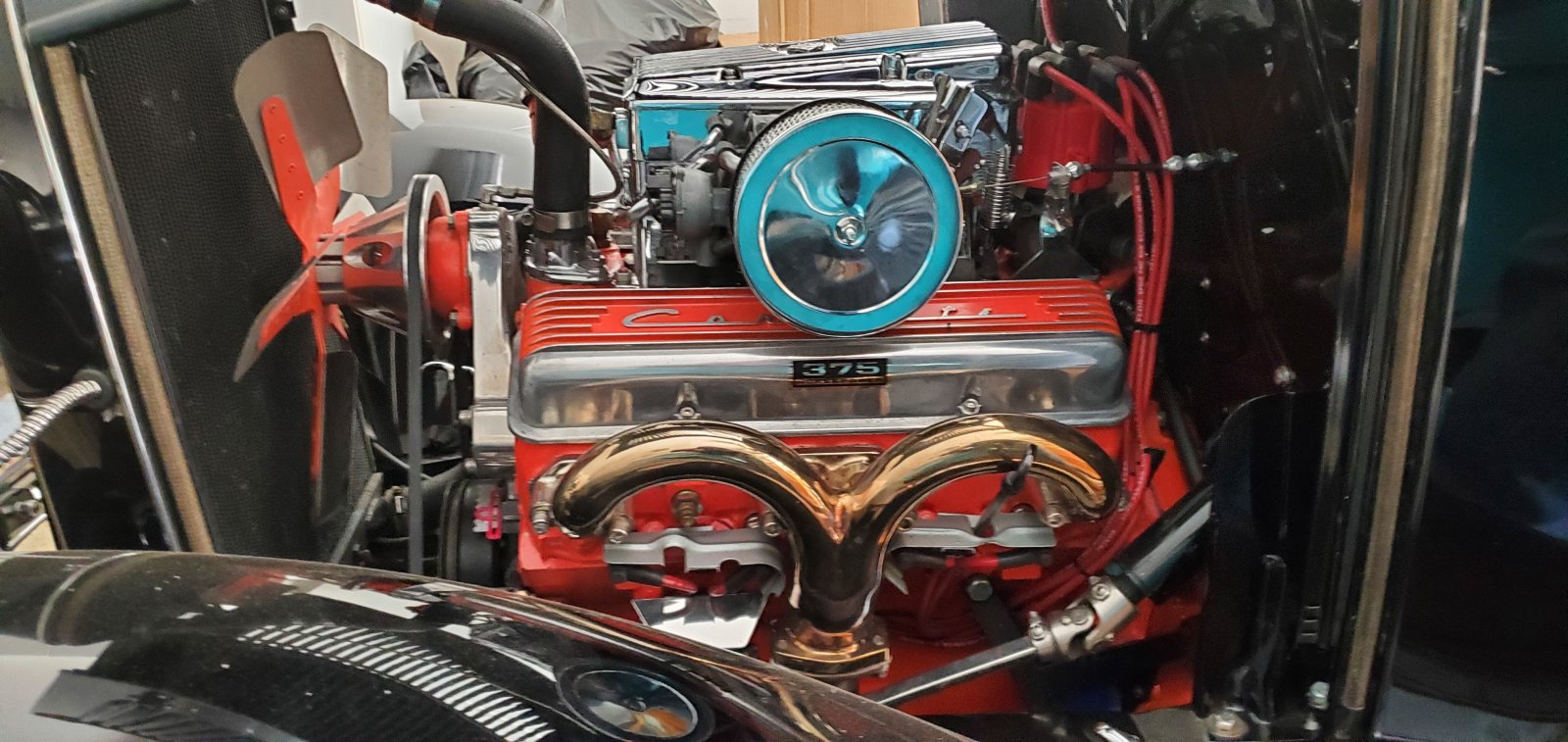

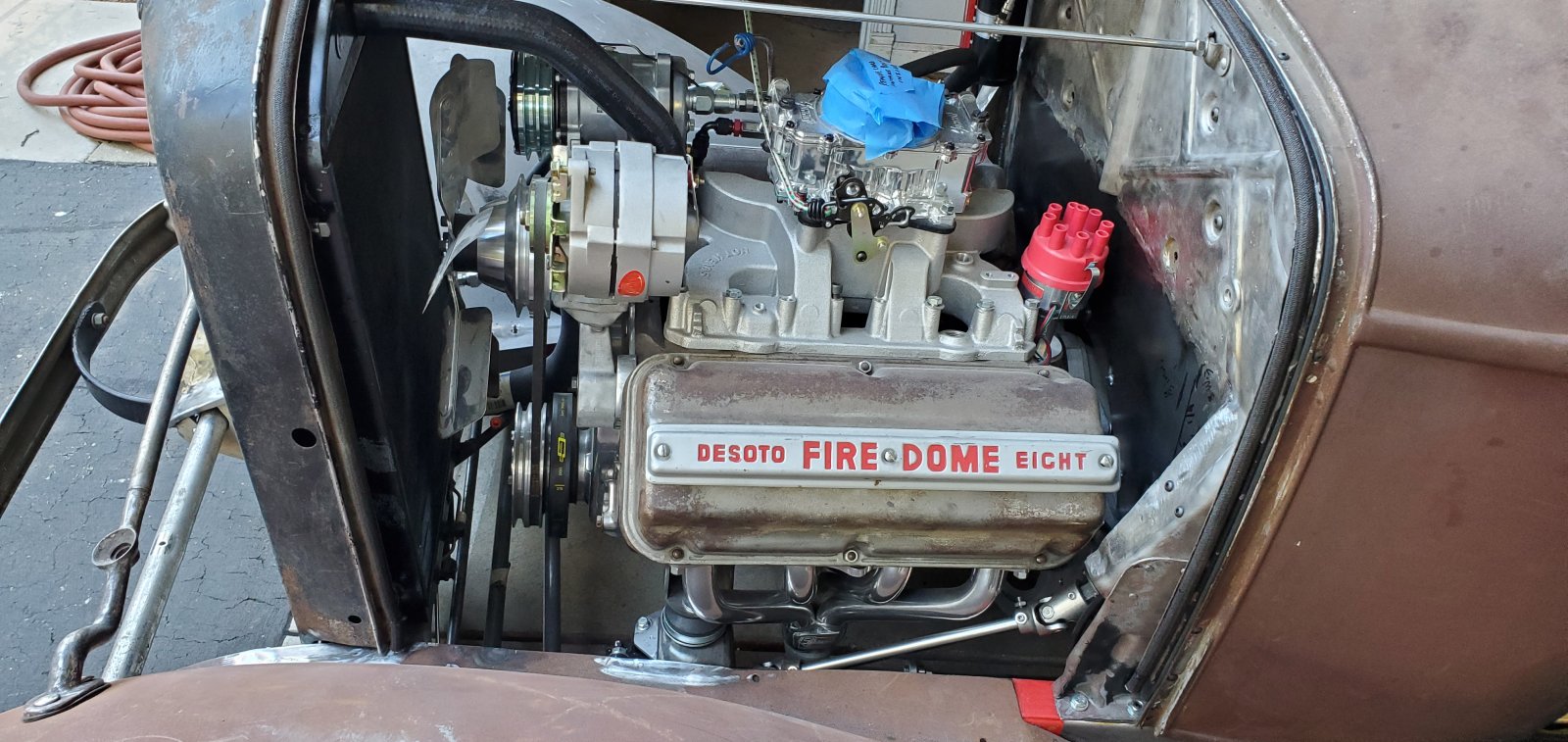

    Mine all worked fine. 3 of them. Even put one on a Desoto. Did cut some ears off though. 20200501_122316.jpg 20220823_173618.jpg

  5. ALLDONE
    Joined: May 16, 2023
    Posts: 4,193
    ALLDONE
    thanks for the pics,...makes it a lot easier to look at what you did rather than amagine.....
