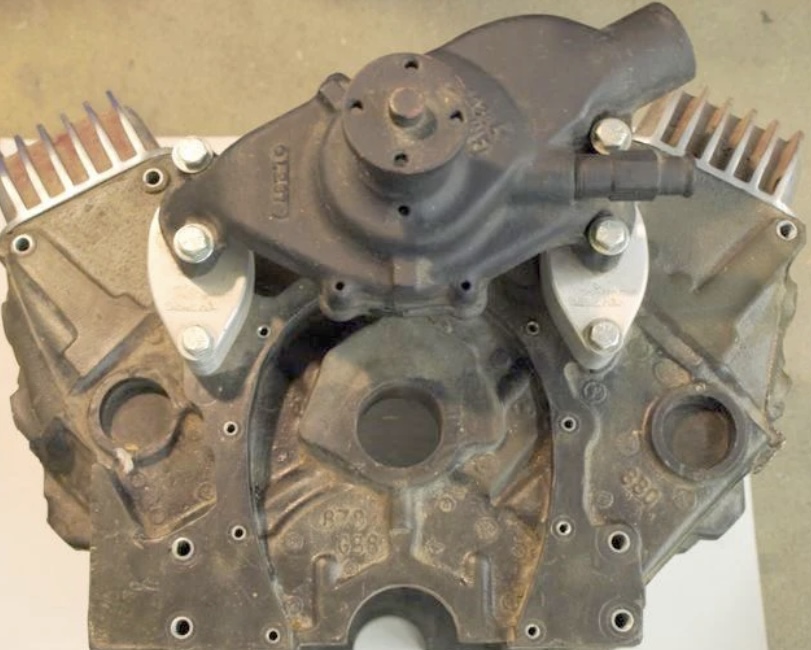

    on installs , all the pics i've seen... the fan ends up in the center of the rad..can't amagine why that wouldn't work... if it works on some and not the others... sum ting else wong....

    Couple things.
    Dorman bleeders work better than Zips screw.
    If running a heater with a Zips, the use of a byp*** heater valve which will allow the coolant to circulate when the heater is off.
