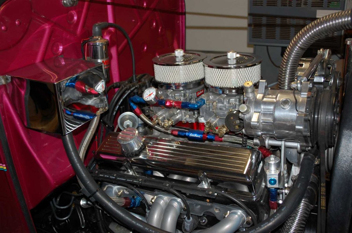

  12. Hoptup32
    Joined: Aug 21, 2007
    Posts: 70
    Hoptup32
    I'm running AC on my 32, so it was convenient to just use an adjustment bar from the top of the alternator over to the top of the AC compressor.

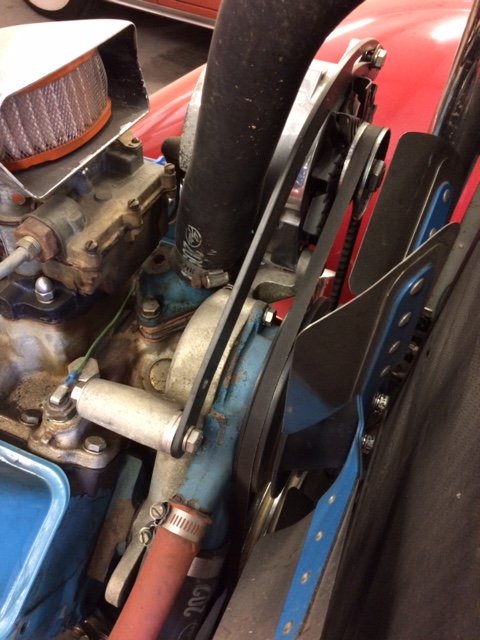

  13. Dennis D
    Joined: May 2, 2009
    Posts: 857
    Dennis D
    This fits on mine. Not sure what the bracket is off of. It is a GM bracket.
    Not much adjustment, so fan belt selection is critical. IMG_1308.JPG IMG_1309.JPG IMG_1309.JPG

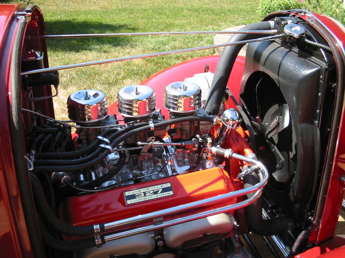

  21. 48stude
    Joined: Jul 31, 2004
    Posts: 1,395
    48stude
    Not that great of a picture , but if you look you can see how I did mine CXNW1844.JPG P1020689.JPG

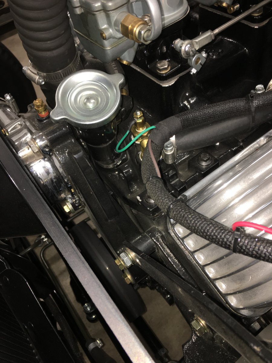

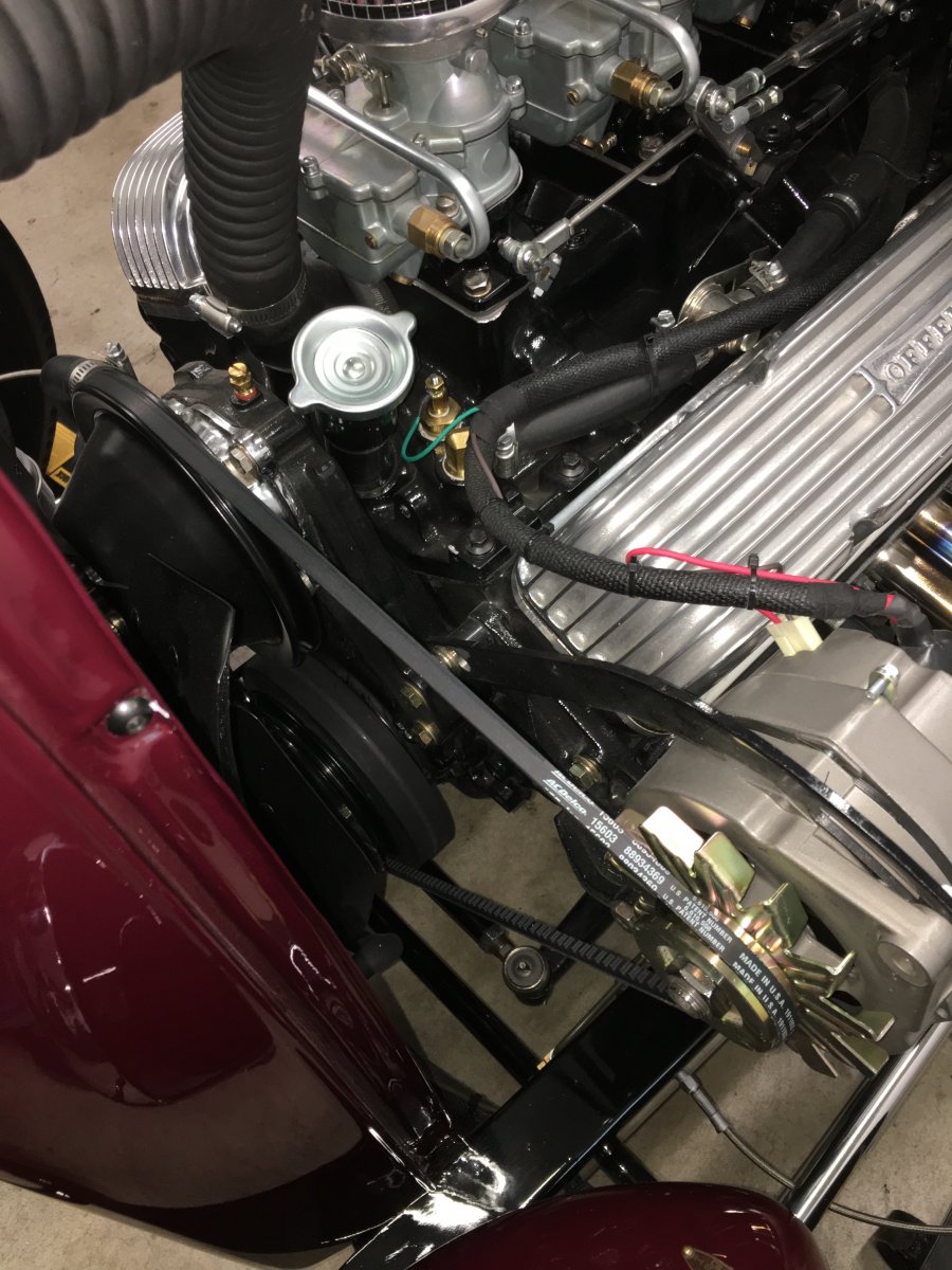

  24. I’ve got one in my ‘32 with hood sides. The front filler tube was mitred and rewelded for clearance. I’m running a chromed generator off of a 1962 Corvette. I’ve got a photo of the mitre around somewhere. I’ll try to find it and add it.
    4CB9EC09-B931-477D-B681-F6842760C5A0.jpg 317C3061-5ECC-4BB9-9B6A-52E97BDEE99B.jpeg 994AA564-C8AA-4AE5-B0A1-30E81B01F542.jpeg
    hot-rod roadster and lurker mick like this.
