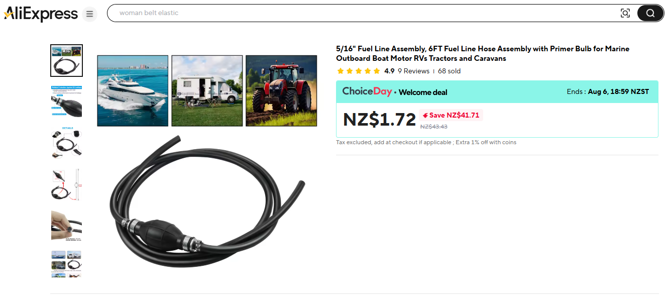

    @steve hackel
    If you don't want to spend $$$ or changing your car....
    You can temporary rig up a Marine Primer bulb [before the fuel pump] to test the theory.
