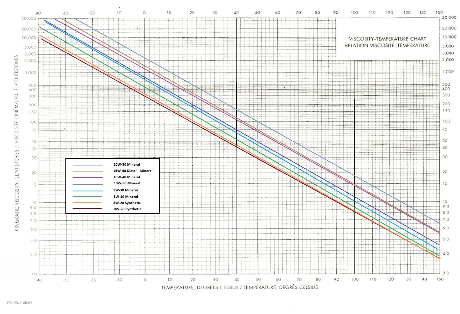

    Not to be argumentative, just in the spirit of good discussion and expanding our collective knowledge here, but I don't perceive Motor Trend as an unfailable gospel of mechanical engineering; or the Engine Masters guys as the ultimate arbiters of horsepower truths. I couldn't watch the video of the dyno testing because it's behind a paywall, but I ***ume they ran multiple dyno pulls on an engine and the only variable was the thermostat opening temp. Correct me if my ***umption was wrong. Tell me, did they also measure incoming air temp? The loss in h.p. was about 2.2%, which is a pretty small percentage and could be the difference seen in any 2 dyno pulls really. Were these averages of multiple pulls, or the best results of multiple pulls?
    In any case, if the results are accurate, and higher coolant temps do result in a slight h.p. loss, what accounts for that loss? Just another ***umption here, but I ***ume the change in power is a result of a change in intake charge temperature, right? A cooler intake charge is more dense, carrying more potential energy. If this isn't the answer, what is?
    And to get back to the discussion, how does this affect wear rates? Tribologists have broken down the mechanics of wear into 3 modes, Abrasive, Adhesive, and Corrosive. Which of the 3 is aggravated by higher operating temps? Abrasive wear is caused by particulate contamination (could be 2 body or 3 body contact); adhesive wear is the transfer of metal from one surface to another, caused by contact between moving parts resulting in micro welding due to high hear from friction and tearing of metal as it transfers from one surface to another; and corrosive wear includes not just corrosion from acidic compounds, but erosion, like from cavitation.
    Elevated temps could result in decreased lube oil viscosity, and decreased film strength, potentially allowing 2 closely separated parts to make contact, resulting in adhesive wear. And particles that break off from the adhesions can migrate to other parts causing 3-body abrasive wear somewhere else. So if the change in temp is sufficient to cause excessive thinning of the oil this could lead to wear. That is true. But is a change from 180* to 210* enough of a change to cause excessive viscosity loss in the oil? That is the question.
    On the other hand, as pointed out earlier, cooler operating temps can lead to ac***ulation of condensation in the oil, which leads to the formation of acids and corrosive compounds in the oil, leading to corrosive wear.
    I think both scenarios are the extreme's, 2 ditches on either side of the road, so to speak. On one side we have an engine that operates too cold leading to condensation buildup and sludge and deposits and corrosive wear; and on the opposite side of the road we have engines that operate too hot leading to thinning of the oil and contact between moving parts. But is this really an issue at temps between 180* to 210*, or slightly on either side of those temps? I tend to think not. I think if an engine gets fully up to 180* and maintains that temp for probably 15 to 20 minutes or so, the oil temp will be higher than the coolant, and should be hot enough to volatize any condensation that formed when it was last shut off. And even if an engine hits 210*, or even up to 220*, a decent quality modern API licensed oil should maintain sufficient film strength to keep moving parts fully separated. But that does bring to mind the conversation the other day about using low viscosity oils, like 0W-20 & 5W-20, which theoretically would be more likely to allow contact under extreme high temps. So something to think about there.
    Anyways, just my thoughts on the subject.
    Just for my own amu*****t I put together this viscosity comparison graph using info from tech data sheets of common engine oils on the market. The data sheets are available online if you search. I left brand names off as that's really not important, just the typical viscosity characteristics of various SAE viscosity grades. Visual aids always help me grasp concepts better. 100C = 212F, so the oil temp ranges we're interested in with this discussion would be on either side of the 100C line.
