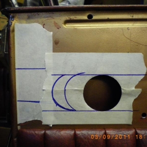

opu27

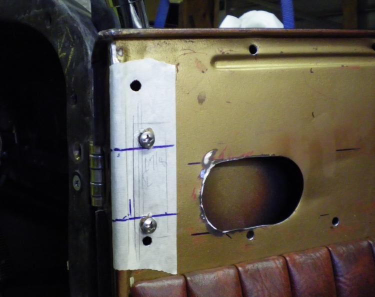

27 roadster upholstery
open for hand room to put nut plate behind for door check strap. strap is on top of door as not to be in the way of feet getting in and out

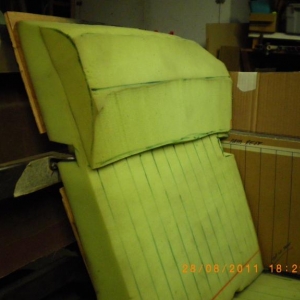

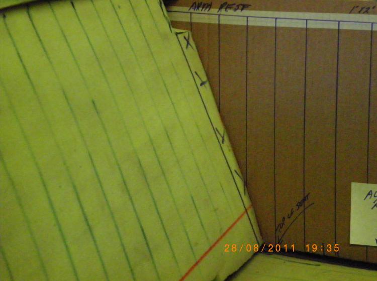

opu27
seat backs will need notchs this will be hard for me to do

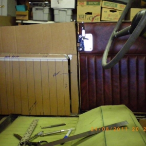

opu27
full body brace lines up with upholstery roll and top of door panel

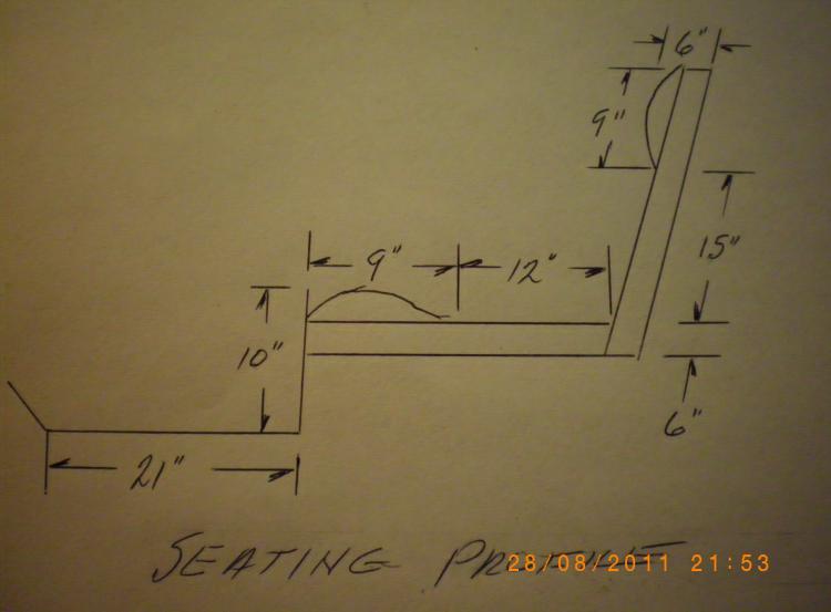

opu27

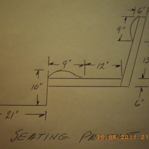

drawing of of seat profile

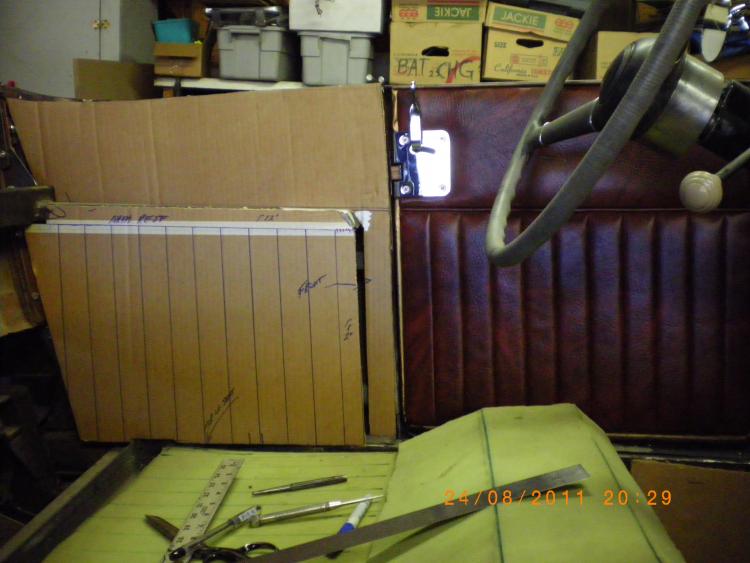

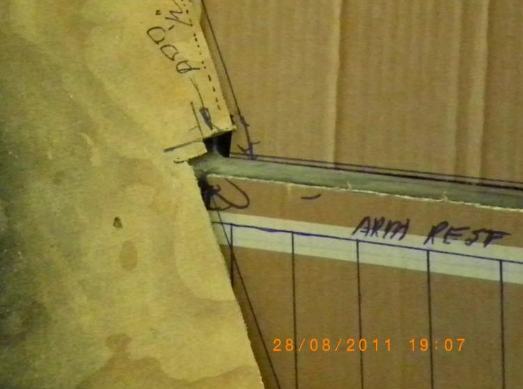

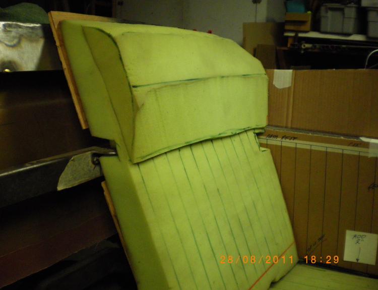

opu27
mockup, chassis brace, arm rest and side panel

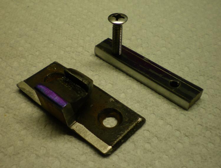

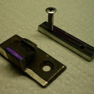

opu27
latch catch and nut plate. holes in door are reamed to 1/2 and nut plate makes it easy to adjust.
